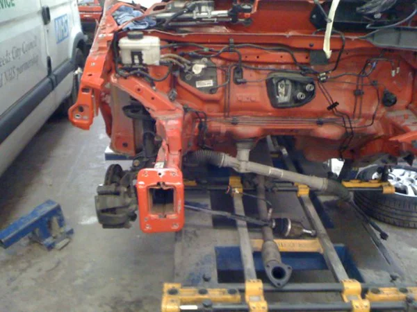

Drivers side leg, bent to f**k, but saveable

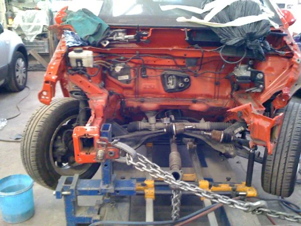

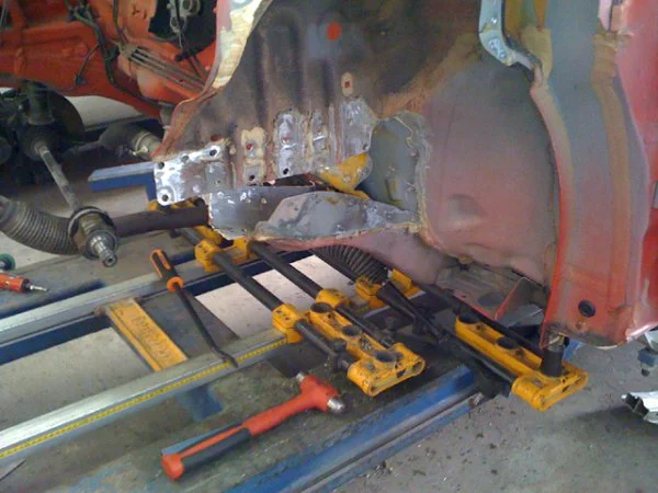

So i pulled drivers leg over, with help of a brace to tweak the front of it that little more
All straight

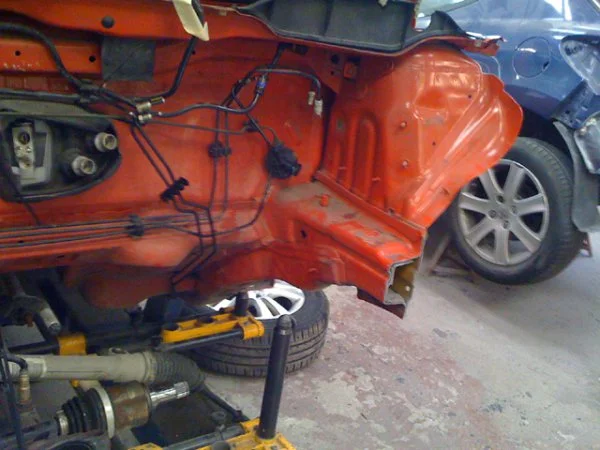

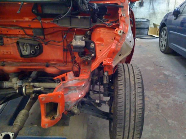

Passenger leg again

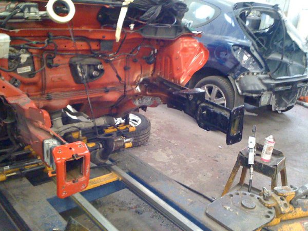

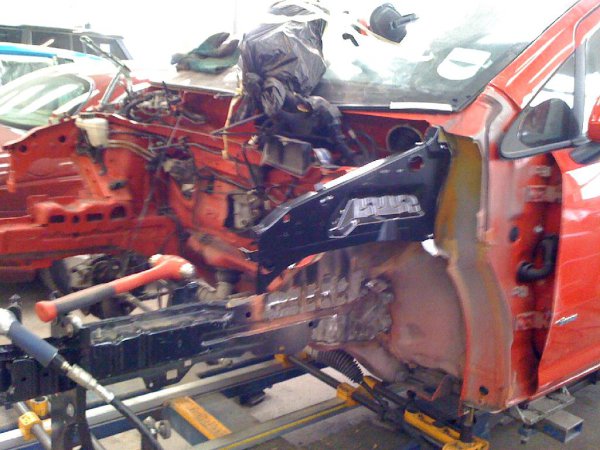

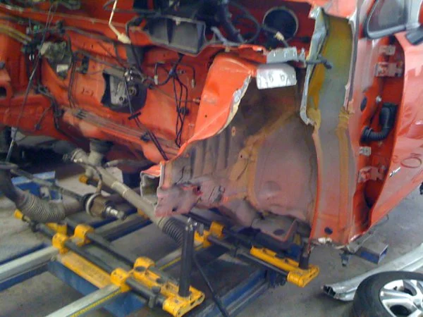

As you can see ive now removed the inner wing, i have also had to strip a lot more off the car to do the next process, subframe, passenger suspension, brake pipes and ABS unit.

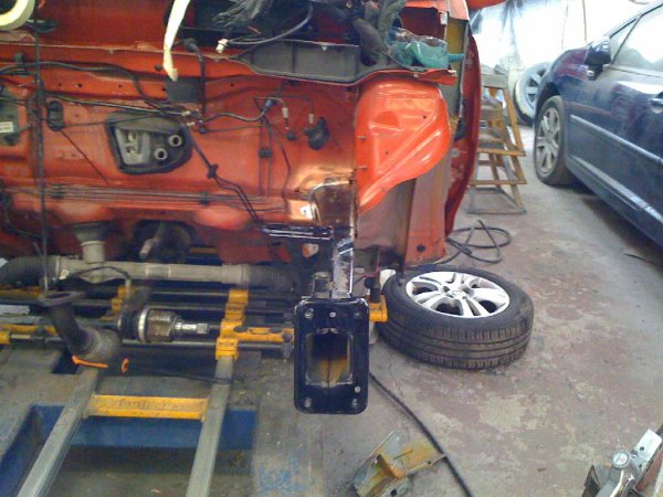

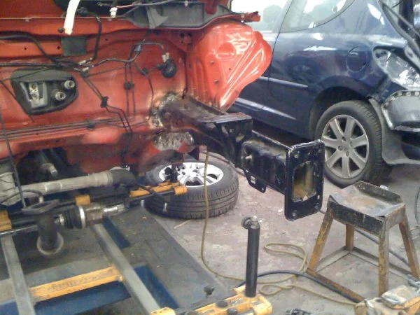

Now time to cut off the passenger chassis leg
Cut off the end:

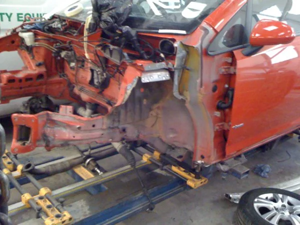

Inside view

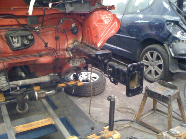

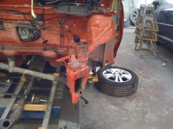

Then remove it all back to the bulk head - NOT easy:
Outside view
Thats as far as i have got so far, ill get more pics along the way

Typically they can be bought new, but the guy who owns this car, also owns a scrapyard, so this particular car is having a chassis leg from another car put in. Which is the same as a new one really, just obviously hasnt cost him anything, where as a new one would have.

Just out of interest, when you pulled the OS chassis leg over do you have a jig for it... or just pull it until it's what you consider straight?
The Blue part its bolted to is the Jig Bed, basically line up parts to get measurements of the car, then measure the front by measurments on paper, hard to explain really.

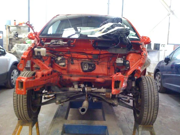

UPDATE:

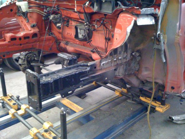

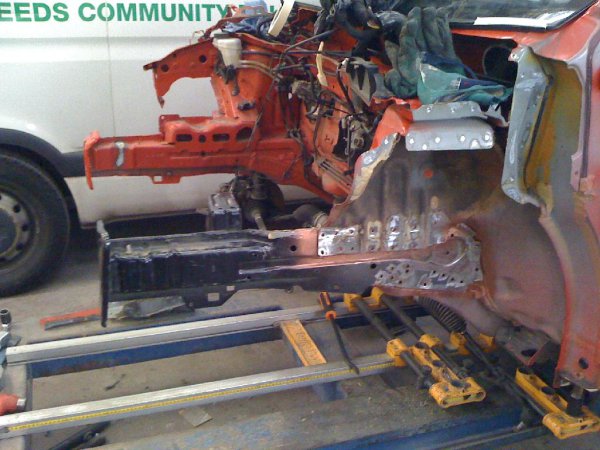

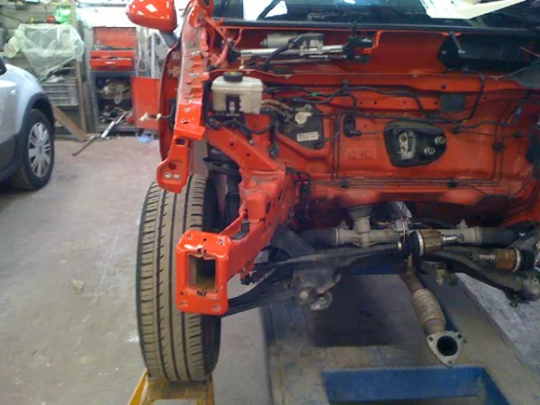

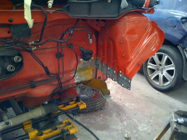

Chassis leg put into place freely
Welded in

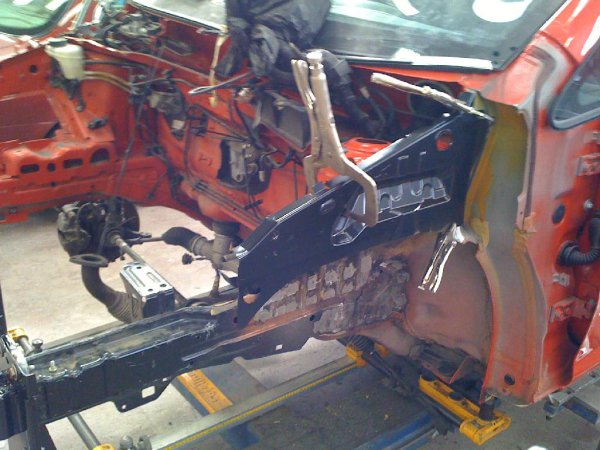

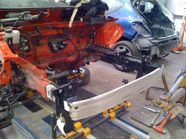

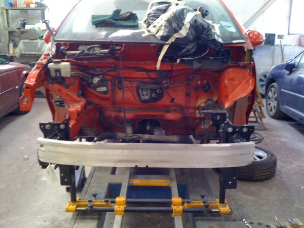

Front beam tried on, perfect fit after some minor adjustment :P

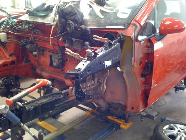

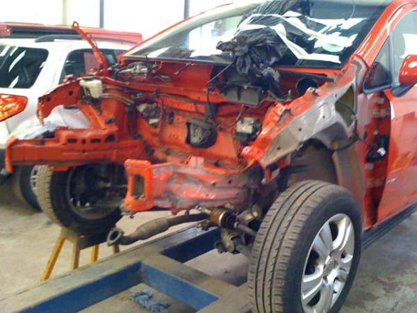

Trial fit inner wing
Screwed on tempory

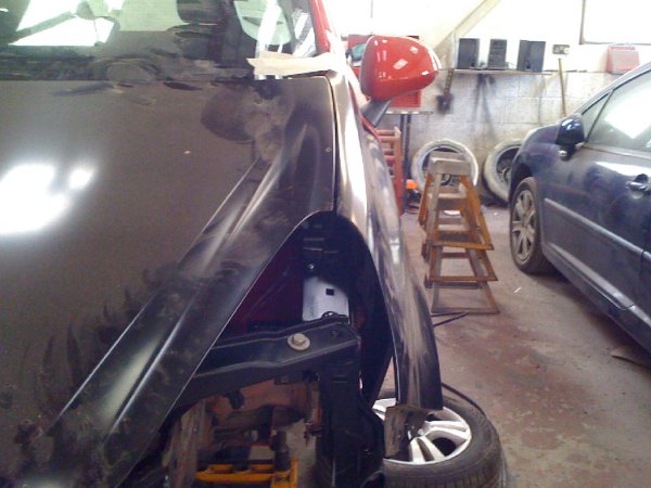

Trial fit outer section

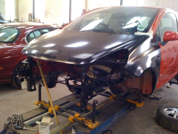

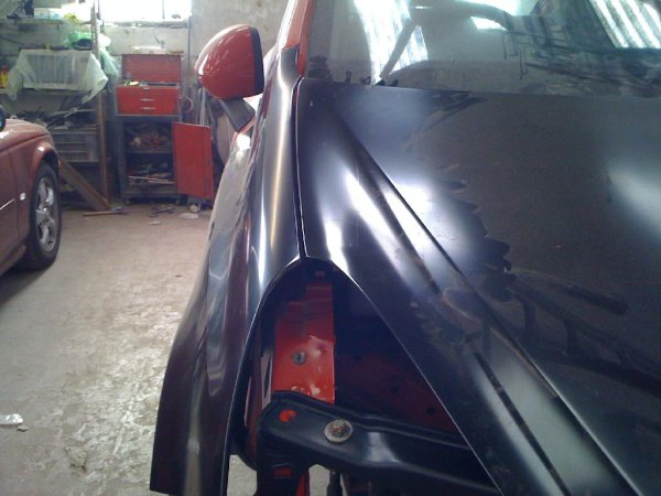

Bonnet and wings tried on
Gaps somewhat near (bear in mind the wings and bonnet are non-genuine also)
Thats all from me folks, sealed it all up now, ill stick subframe and suspension on tommorow, then they are collecting it and finishing the rest.
