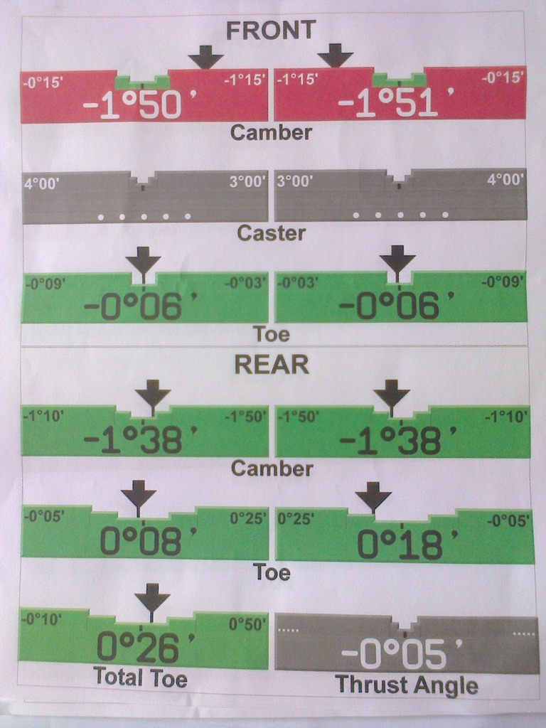

Can the suspension gurus please share their thoughts on my cars current geo setup.
Background info is, track-only 172, cup shocks with cooksports (currently, will be coilovers in the future), all polybushed, camber bolts, strut braces, sticky tyres etc.
I love the way the car handles atm, but am wondering if this is more of a fast road setup? Could more aggressive geo be run to improve the car's handling? Or does this look pretty good?

I'd stick at least another degree of neg camber up front apart from that looks good to me unless you can even out the rear tow with a shim
