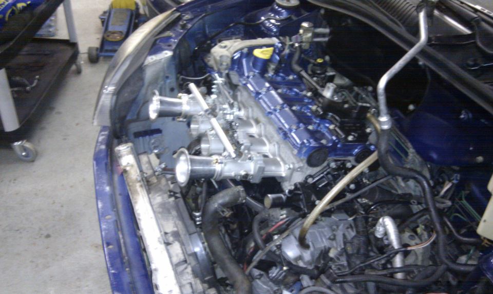

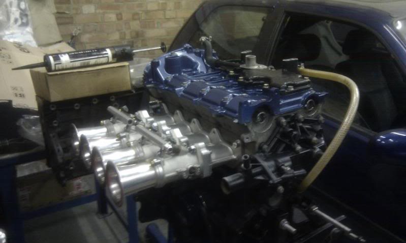

going to throttle body my 172 at some point, and i know alot of people use the ITB bodies (Sf) ones.Just got chance of some 91mm long, 45mm dcoe's and was wondering can i use these with the jenvey sf manifold and the adaptors they also sell to change from sf to dcoe??
will 90mm trumpets be ok with this considering the length with the adaptors, also will be ok to run this with a dta s40 ecu? will everything still work inside the car... e.g clocks etc... as my local friendly mapper prefers dta.
thanks for your help in advance. stu
like this you mean?
It's been done a half dozen times or so, you need to do a bit of work to the adaptors but it works :)
thanks guys! just what i was after, and doesn't it look bloody lovely...

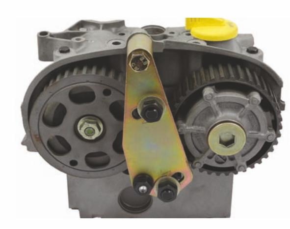

Horse shoe alone isn't enough to lock the cams. Even the Renault one is weak as! It's more a timing tool rather than a locking tool surely? Pulley tool is a must
Horse shoe alone isn't enough to lock the cams iirc. Even the Renault one is weak as! It's more a timing tool rather than a locking tool surely? Pulley too is a must
Yes thats absolutely correct, you need to physically lock the pulley end, the horseshoe is only designed to time the cams in, not to look the pulleys when you tightening it all up.
He should have something like this in his locking tool set:
although personally I would always stick to the genuine renault tools.
oh s**t, i was meant to say ive got the timing tools! which is the horseshoe and crank pin but need to buy the locking tool for the pulleys. sorry guys.
Thanks chip mk1 for the pic, so when i put the new dephaser on and finger tighten the exhaust nut and dephaser bolt i then fit the pulley locking tool to torque up the nut and bolt as he horseshoe has the cams timed..am i correct here???
