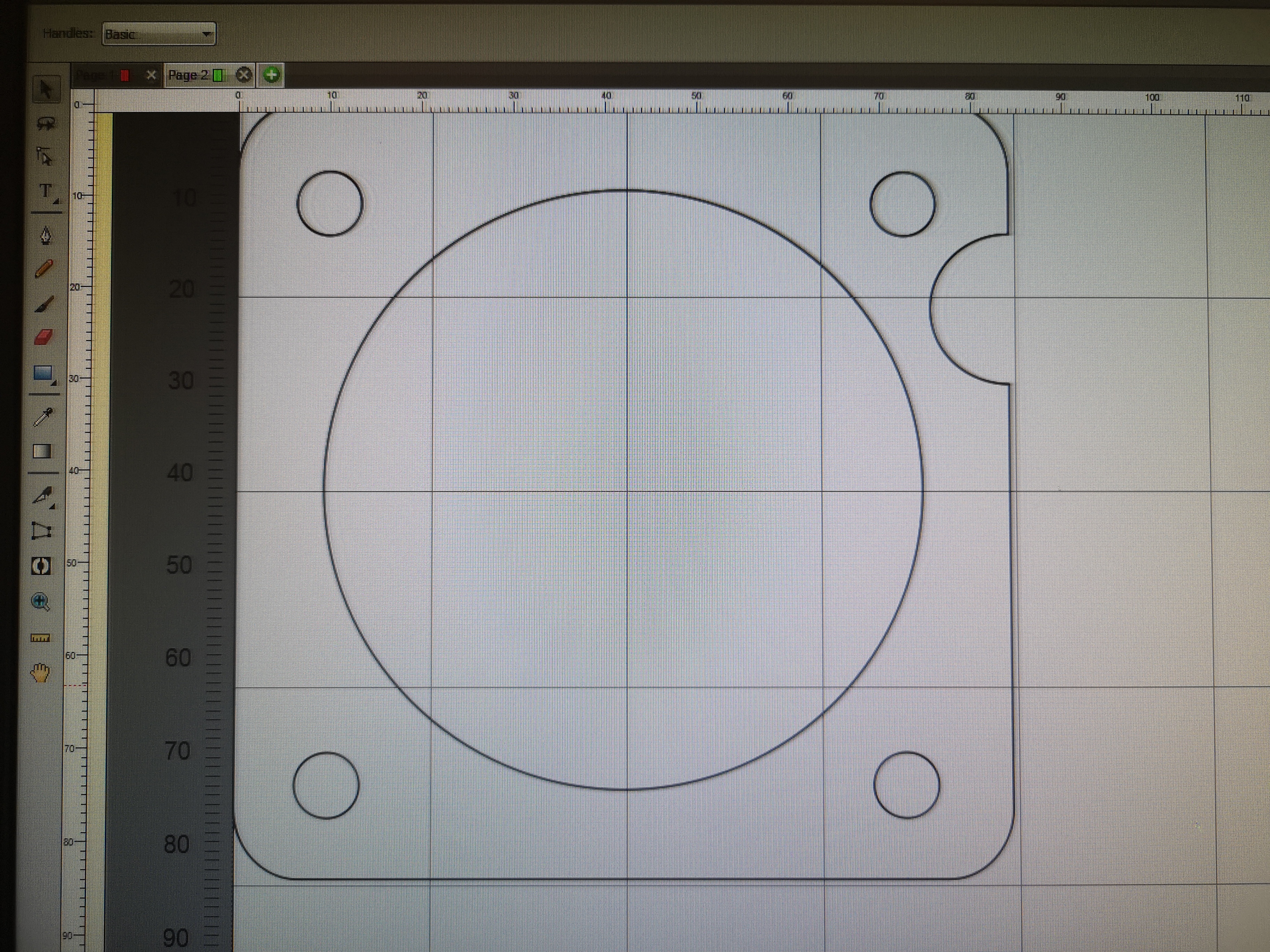

@Yorl
Does this help at all? I made some throttle body gaskets last year and this is what I knocked up. Was only rough sizing but they fitted ok

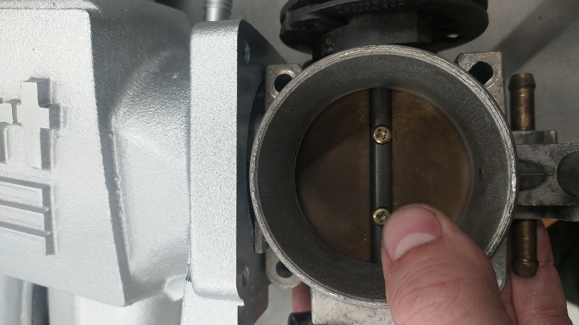

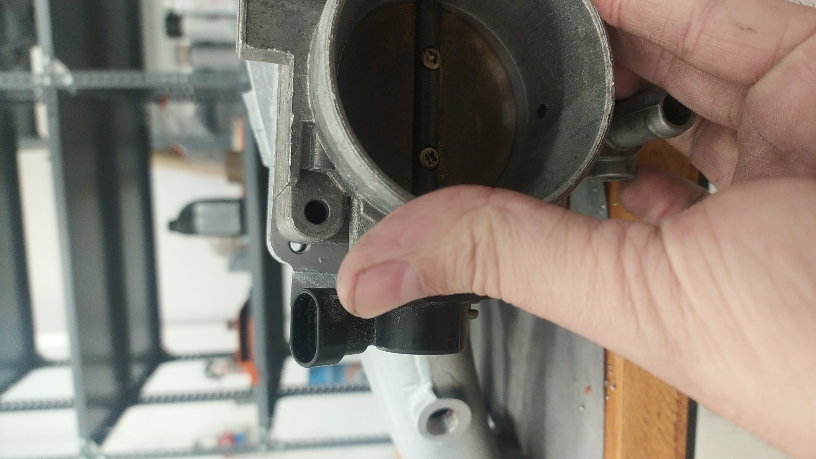

Well, I went out and bought a Ph1 intake manifold with throttle body. The throttle body bolt pattern is NOT the same between DBW and DBC, and as added bonus, the Ph1 DBC throttle body and the Megane F7R throttle body are the same. Same part number, same sensor... So completely interchangeable.
I'll post some pictures later on
