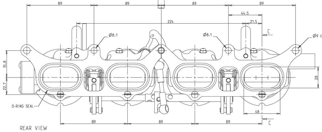

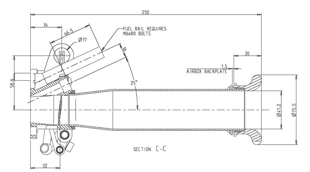

Looks good, is the inlet length adjustable for varying setups? or fixed? Will the slam panel have to be modified to fit them? Are you going to do them as a complete package?
They are not adjustable in situ, but there are options for length depending on whether you want to modify the slam panel or not, if you want to keep aircon (a hard task due to space mostly for the air filter), or if you just want to purely tune for peak performance.
It will be sold as a package as all hardare, TPS sensor, air filter setup etc etc.
Once fully developed a full kit with radiator, ECU, plug and play loom and optional aux system setup will be available.

basically a copy of the QED motorsport ones but adapted to a Clio. In effect they will be shorter and lighter due to not needing the inlet manifold... As for performance I cant see there being any difference to the typical setup... could be wrong, but only time will tell

Direct to head throttle bodies designed specifically for clios by a clio specialist.

The exciting parts is the increase in efficiency that allows us to run a much smaller throttle area for any given BHP potential, in english that means higher velocity and more torque earlier on. Were at the point with the IC engine that people spend lots of time and money to gain percentage points, if i were to attain 15% increase do you think i would be living the life i am at the moment or reaping the rewards of selling the idea?
It is refreshing in that it is a complete and comprehensive kit, not leaving the customer to sort out issues on sundry fitment and poor manufacture.
