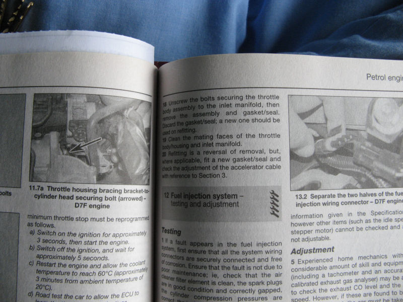

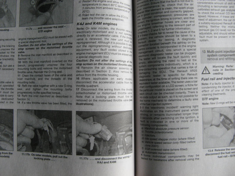

Alright guys, wanting to clean my throttle body, just wondered how i get it off due to it being a tight space at the back of the engine bay.
ta
josh
According to the old book of lies, was lazy and couldn't be arsed to use the scanner, you can just about make it out.
