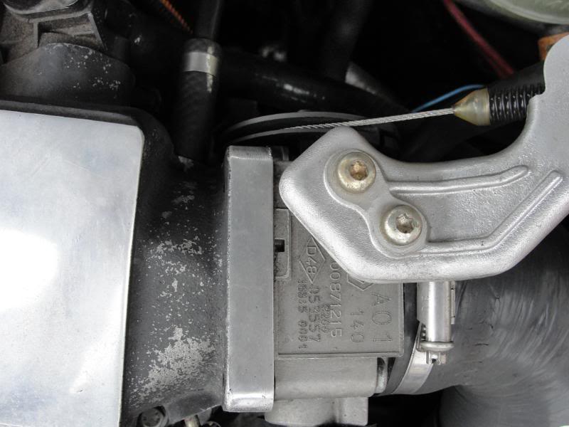

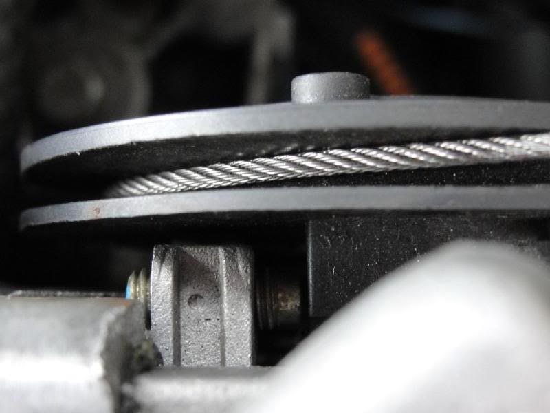

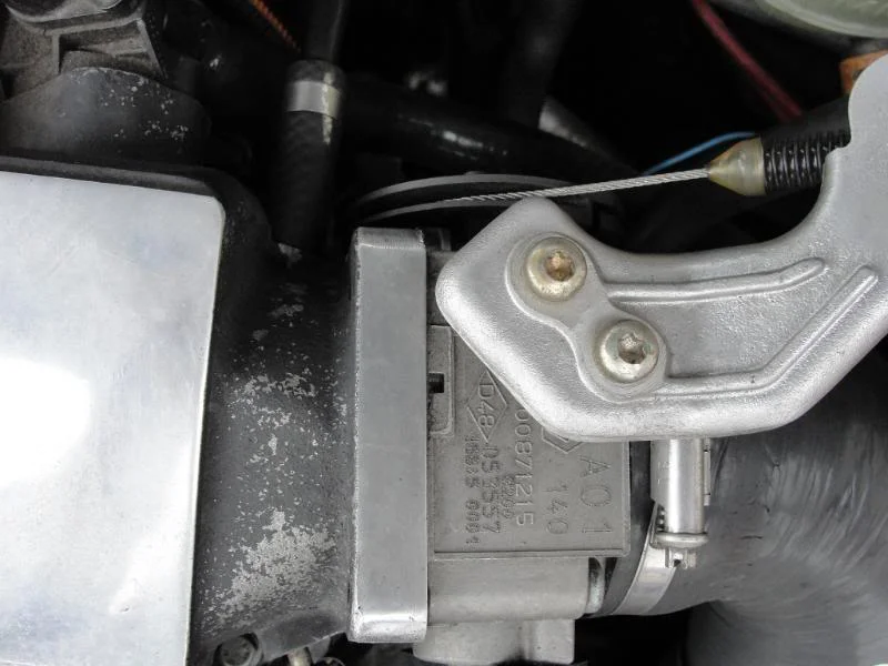

When the car idles high or sticks, open the bonnet with the engine running and you'll see the TB and black cable holder.
Turn the black holder anti-clockwise. If it stops the reving and there was a gap (repeat a few times) then its probably either the cable or the spring on the TB.
Bottom pic shows the gromit screw, the holder wants to be resting on this as here. Even a 1 to 2mm gap is enough to hold the revs high.

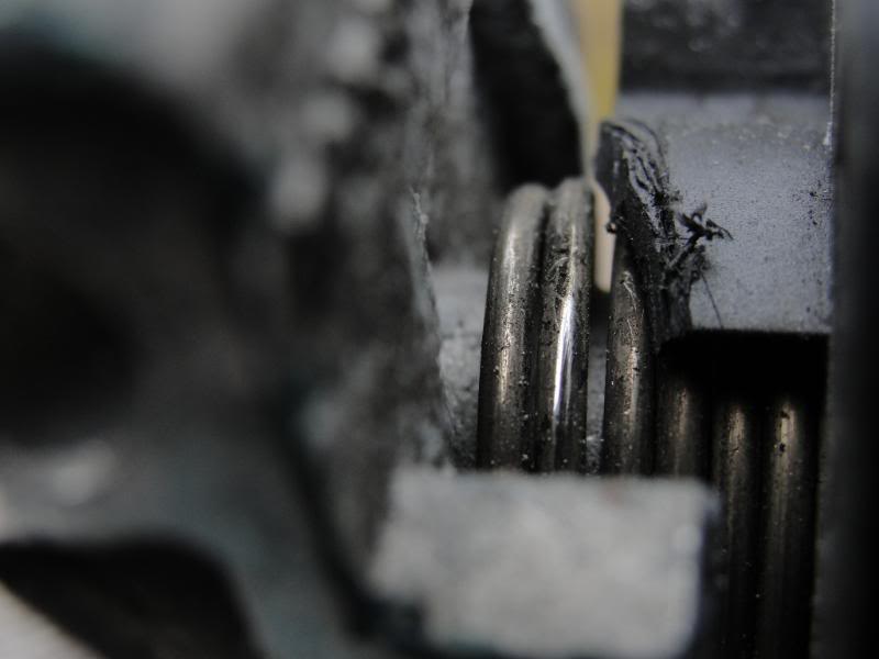

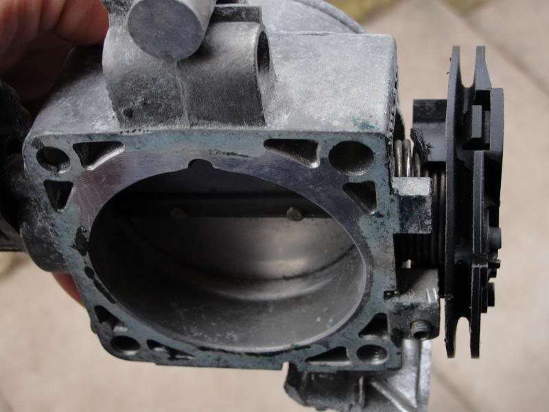

Depending on what you find above or you just want to just check, whip the TB off and turn it upside down.
As you can see below theres a shinny area on the spring where its been rubbing on the black holder thus holding the revs high at idle. The spring has lost its tension so this TB is only fit for the bin.
**NOTE** i cut the black holder back a bit as you can probably see.
A untouched one will be squared off so to see the shine / rubbed area you will probably have to turn the black holder to reveal the problem.
Even tho this TB spring has worn slack theres still a lot of tension there.
