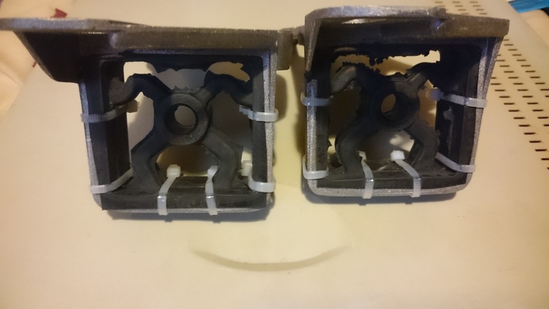

This is how I did mine and they're still going strong after 18 months or so .First of all I cable tied the rubber to the metal exhaust bracket , as they can come away after time . Then I filled it with this Everbuild silicone sealant .
http://www.ebay.co.uk/itm/141186068477?_trksid=p2057872.m2749.l2649&var=440253514064&ssPageName=STRK:MEBIDX:IT
It sets like firm like rubber but remains pretty flexible . I also drilled 3 x10mm holes through the selant after it had set , 1 either side and 1 at the bottom so It wasn't too rigid .
