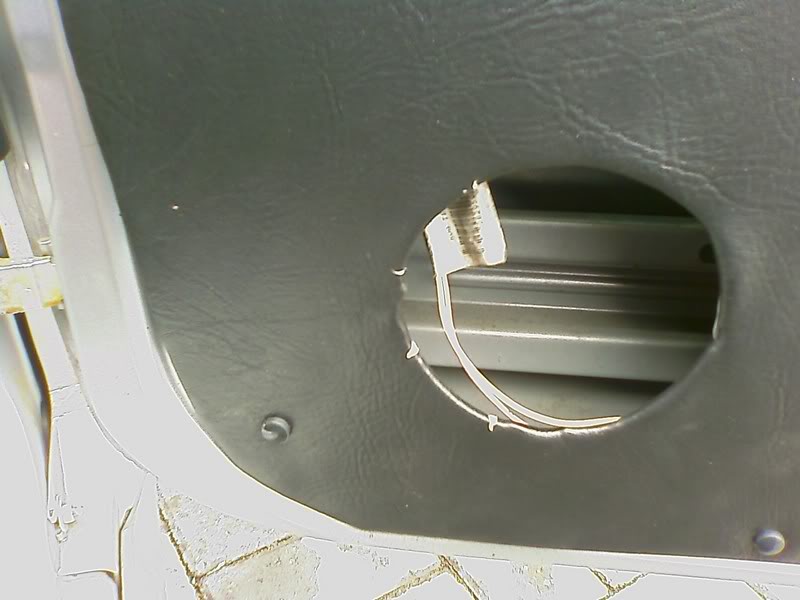

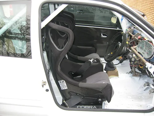

Looking top mate! How have you fixed the door cards? I've got a big sheet of 4mm stuff so I'm going to make my own. Square metre was £100 off Not Normal on here and iut weighs feck all so can't really go wrong................................He says :o
well these are light enough to be held in place with 25mm wide double sided tape. there is no chance the originals i got from PT would of stayed in place with that.
Tho having said that, the door isnt totally flush, so i did rivet it twice in the bottom corner.

This should stay in place with that easy enough. I did think velcro too though???
Also, with rivets I did'nt want to have to drill them out if I take them off.....

I thought about rivitting some plates on the inside so the velcro sits flat with the door skin as a pose to sticking it too the skin. If that makes sense?? lol.
there is a slight ridge infront of the speaker where the card wont sit flush
you could use a self tapper there which will just unscrew out!
there is a ridge around that area on the mk1 aswell
it got the hammer treatment to flatten it down lol :evil:
What about rivnuts in the doors and some nice looking anodised screws through the cards into the rivnuts?
Have you seen how i attached my door cards?
Just self tap screws and black numberplate covers.
Cheep, does the job well and easily removable
Elaborate!! :o
I thought about those actually as they wont stick out against the carbon!

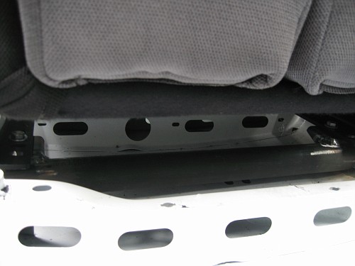

well picked car up from Mark Fish, he welded in my seat rails, which now allows me to sit central to the steering wheel, top job as always!

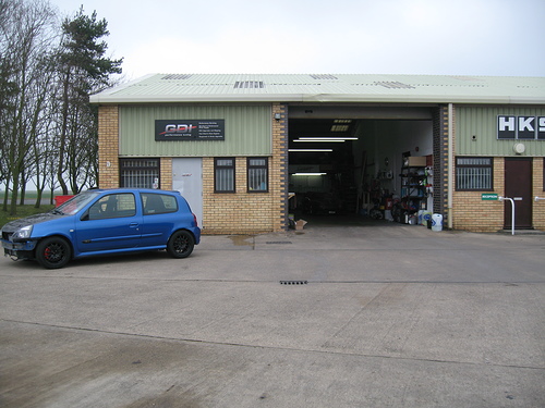

Then took car up to GDI to have engine fitted
so dropped off a few parts to allowed the job to get done, like a new set of engine mounts, oil cooler pipes and my freshly ceramic coated 182 manifold...

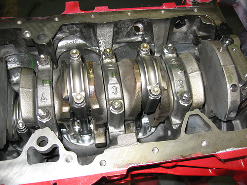

Whilst there took some pics of the bottom end (head is being fitted monday)

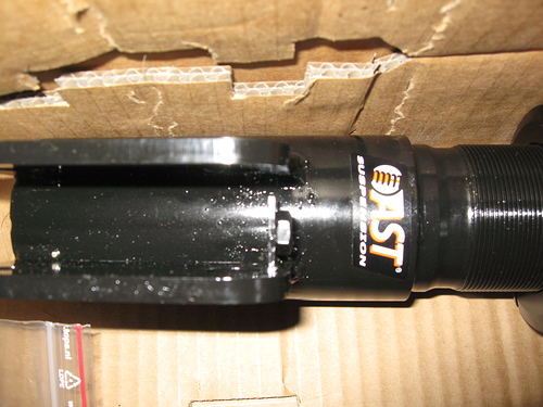

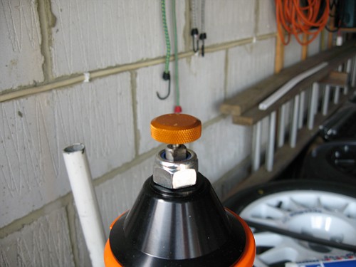

Also took a few pics of the other goodies that are part of the build..

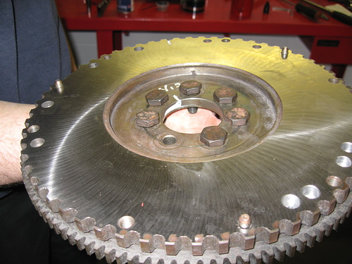

Helix uprated clutch
ATP bodies

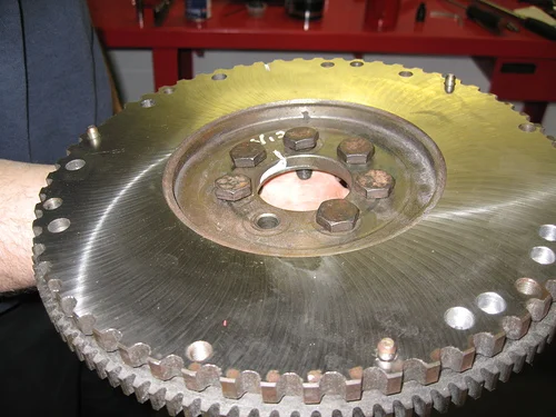

Lightened and balanced fly wheel

have you had the oil channels tidied up, as a performance f4r block has problems with oil flow, just bore them out to head gasket, and tidy up sharp casting edges, we had problems with big ends going in the rally car, this cured the problem, what pistons? are those wossener?? what power you going for?? anything more than 220 and you will find snapped drive shafts and fubared gearbox, sadav dog box reccomended, hissingsid has one for sale :cool:, and one last thing if you have high lift cams be carefull with valves, they snap!!! :mad:
