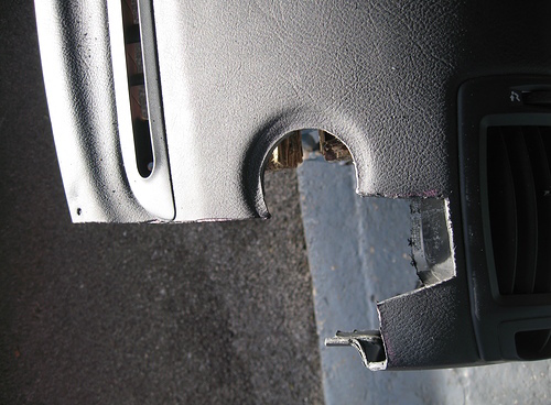

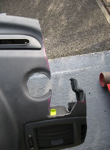

This weekend i wanted to get the final bits of the interior ready.

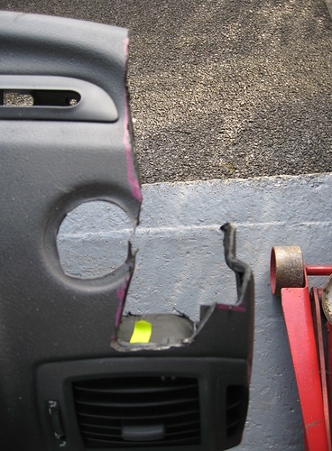

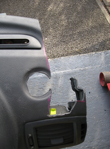

So it was a case of tidying up the dash where it was cut...
Before:
After:
And the other side tidy too:
So then i masked up the bits i didnt want flocking and boxed it all up ready to go.

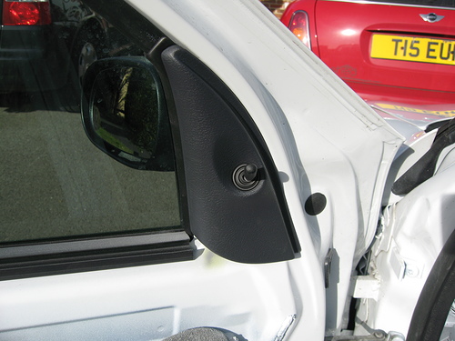

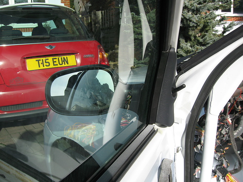

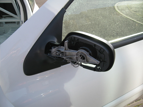

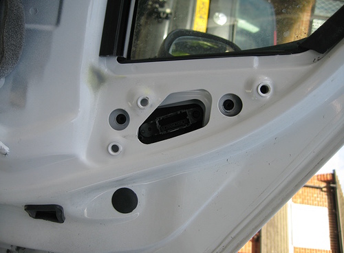

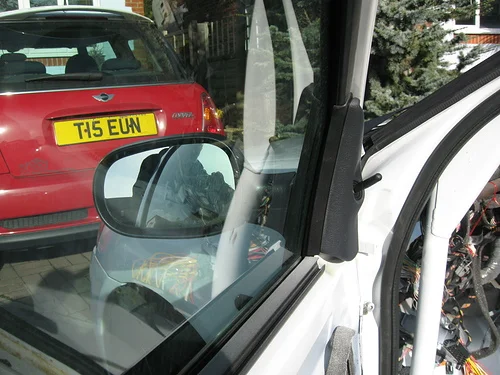

Thought i would fit my new mirrors too, seeing as its a 2 min job...
Off with the old electric units:
Then on with the new manual units:

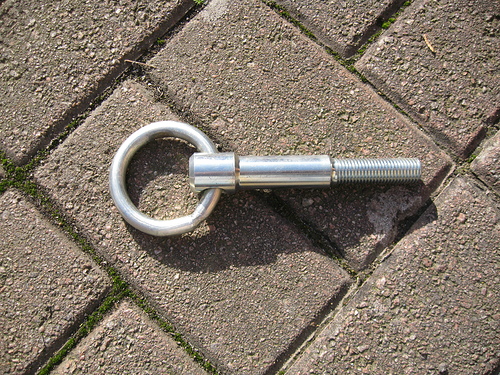

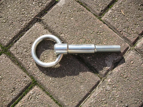

Also i received my genuine Cup Racer towing eye, courtesey of D4ve.

The electric motor mirrors can't weigh much more surely?

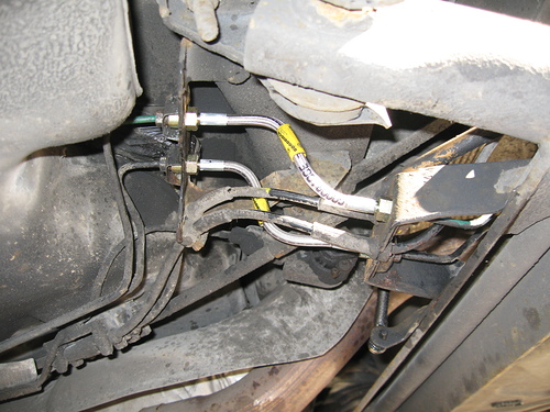

changed all my brakes lines for some Goodrich braided items. So that replaces the rear standard ones, and replaces the Compbrake ones that are way too long.

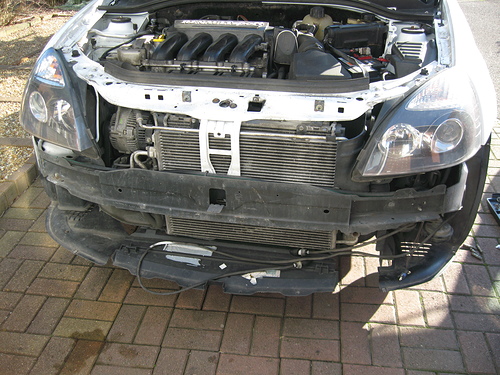

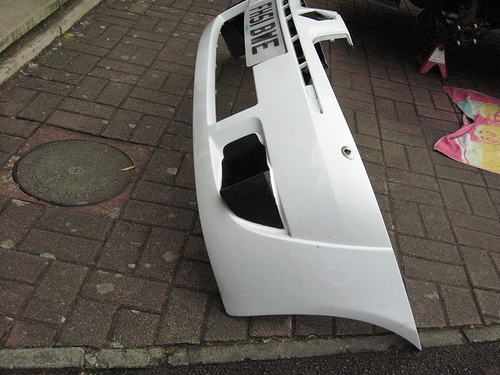

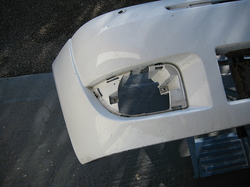

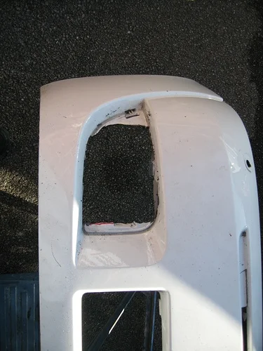

front bumper off...

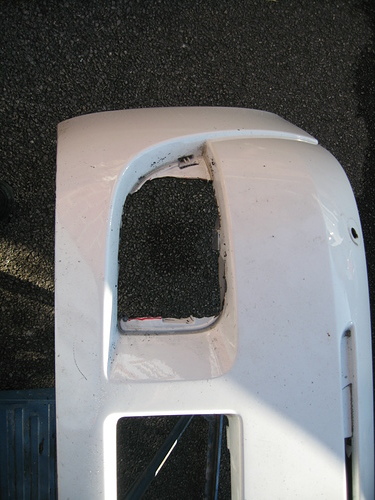

removed fog lamp covers etc, and started cutting to make way for the cup racer brake ducts. It was pretty hard to tell how much to cut away, so it was a case of cut a little, check fitment, cut a little more, check and repeat 50 times.
un cut...

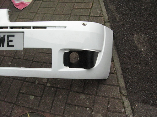

cut....
The fitment of these particular cup ducts is quite possibly the worst i have ever seen. They are not equal to each other, badly made and barely fit in the space they are meant to. I presume these are not original RenaultSport items, but copies of. This meant that there were huge gaps at either end, and it was almost impossible to make them look decent. Not ideal for £150 quid!!!
So the only way to get over this was to user sealer around them. And whilst not the ultimate in looks, i dont think they came out too bad. And luckily with thtis build function comes over form.

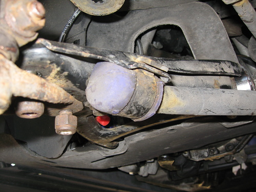

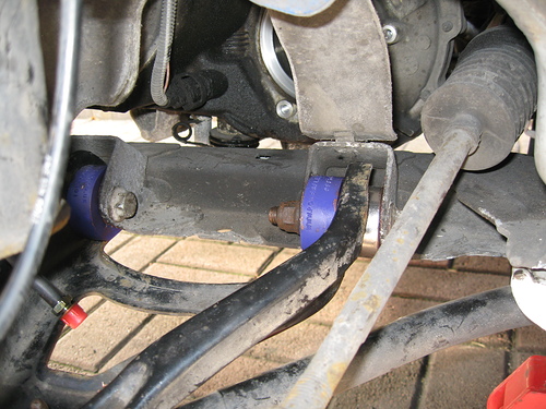

Powerflex bushes went on with no hassle....

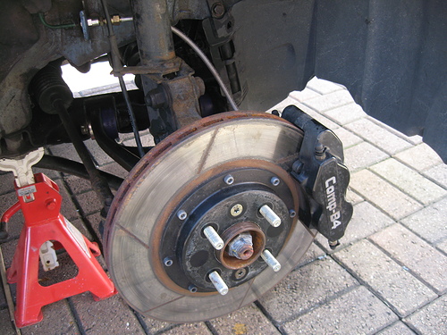

And finally Goodridge braided hoses went on, which replaced compbrake front ones, as they come waaaaaay too long
and replaced the standard rears
