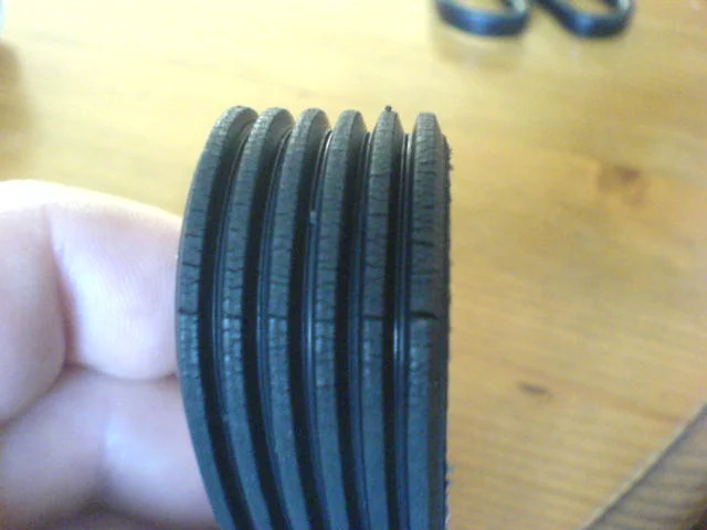

I had both belts changed yesterday by Renault_wiz, (Ed).
And this is what we found on my Aux belt.
If you're having your cambelt done, my humble advice
is, get your Aux done too! I didn't at the last cam belt change
and I am soooo glad i have now had it done.
I felt sick when I saw this!!!!!
