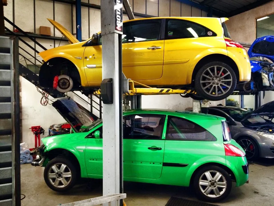

Here's my R26 looking sorry for itself. There hasn't been much progress yet as the oil pump is on back order.
RS Tuning have stripped down the engine now they have the parts required for the rebuild. Hold up was due to the oil pump being on back order so understandably they couldn't have my car stripped down taking up a ramp.
Paul has been in regular contact but his calls haven't been good news as the new engine is basically toast. It's hard to tell what caused the issue but from what Paul has said it points to it being poorly built.
Paul said he's never seen cams so badly scored and head is so bad he doubts it could be rescued. I believe the cams in new engine are the cams from the old engine (I asked for them to be swapped when the cam cover was resealed) so that's a new set of R26 or aftermarket cams needed! Hopefully the old head is in better shape.... The plan is to port the head and reuse the Supertec valves.
The crank from the new engine isn't going to be reused so the old crank is being sent off to be polished and balanced with the SMF and clutch.
The Wossner pistons are fine but need a new set of rings. That doesn't make much difference though as we were always going to bore the block out to 83mm to ensure it's round. I'm not sure if we're using the old block or new block but Paul is going to pick the block he thinks is in best condition. The Wossners will replaced replaced with CP pistons and the PEC rods will be reused.
The gearbox needs another £600 spent on it! I asked Paul to send it off, as it was popping out of 6th gear every 50 to 100 or so miles when driving at a constant speed, expecting it to be a simple/cheap fix. The transmission place say the damage is so small you wouldn't notice unless told to look for it but it needs a new selector hub and 6th gear to sort the problem.
Is this another Agency Transmission c**k up or bad luck?? I'm not sure. All I know is the issue wasn't present before Agency rebuilt the gearbox.
I could just live with the niggle as they say it doesn't really require fixing but last thing I want is to buzz the engine if it popped out of gear on track or at the Ring.
I don't regret forging the new engine as the old engine was tired and burning oil. I do though regret the expense of having to do it all over again and in hindsight I should have used RS Tuning or SJM to start off with.
I'll update when I get more news but hopefully it won't be too long before I can drive it again.
