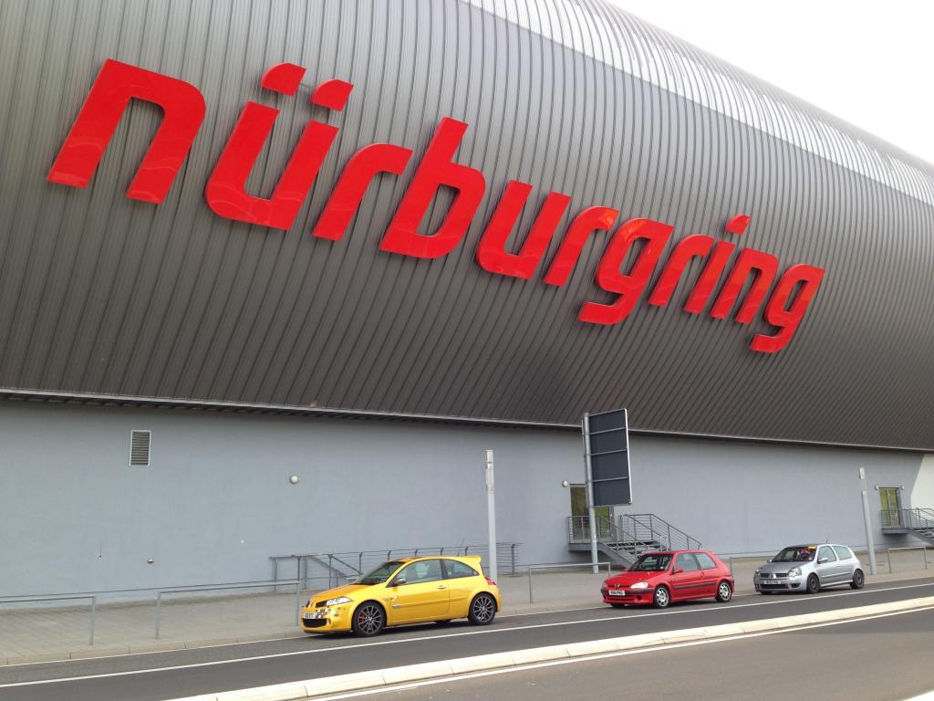

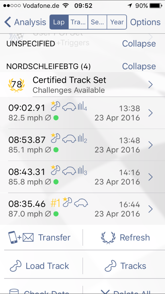

Taken the R26 to the Nurburgring this weekend :grinning:

Glad you're enjoying it Tim and the 'Ring trip looked like a good one (even if the weather wasn't perhaps ideal).

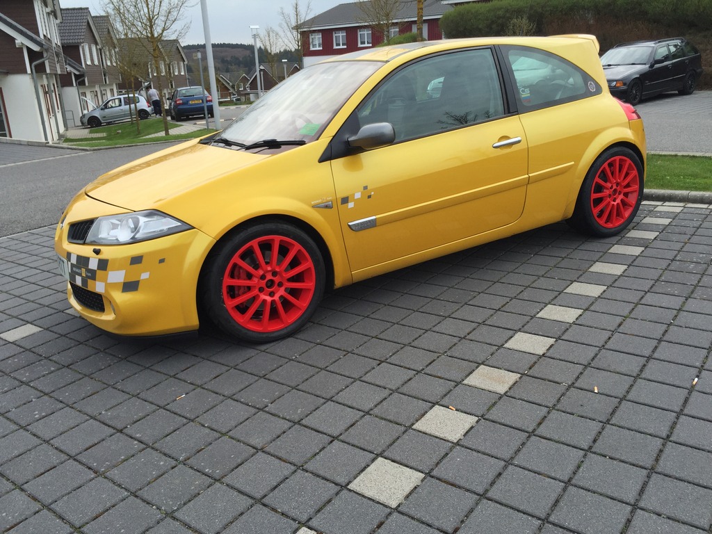

Looks great tim
And good to hear all is well with the engine
