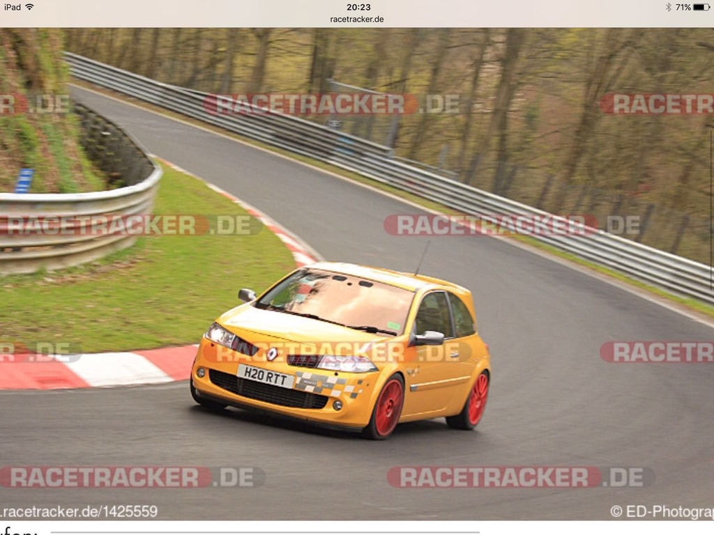

Couple of photos from this weekend. I'll post a full write and lap videos in next few days.
Summary is that it was a great trip despite snow meaning we didn't get as many dry laps as we had hoped. The red wheels are wrapped in R888R tyres which were great in wet and dry.
It was slightly annoying that conditions meant you were never 100% confident in what you would find round the next corner or over the next crest. Lap times show that with being able to cut 30 seconds off my time in four laps!
I'm nowhere near the potential of the car at moment. Think it's going to take a few trackdays to get used to pushing it hard again.
Passenger lap with @Fletcher showed that there's a lot more speed to be carried in corners up to Hohe Acht. I'm pretty much flat out from Wipperman/Brunnchen to the Gantry though.

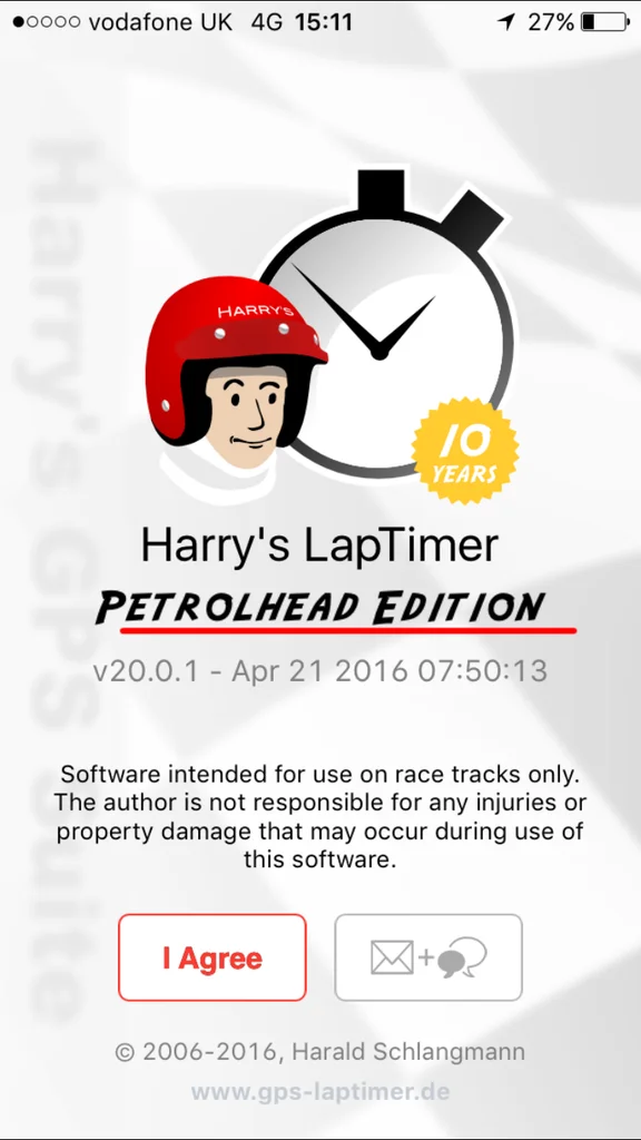

I hope the weather picks up as I'm heading out in two weeks. What's that app for data logging? (Apologies if you've said)

Thanks Rob.

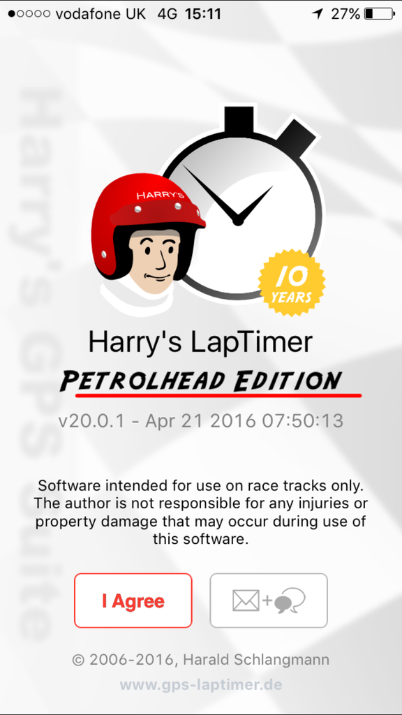

App is Harry's Laptimer Petrolhead Edition. It's very easy to use, select the track e.g. NordschleifeBTG then it automatically starts and stops timer via GPS.
Fletcher was using it and it looked good so I bought it on Saturday morning.

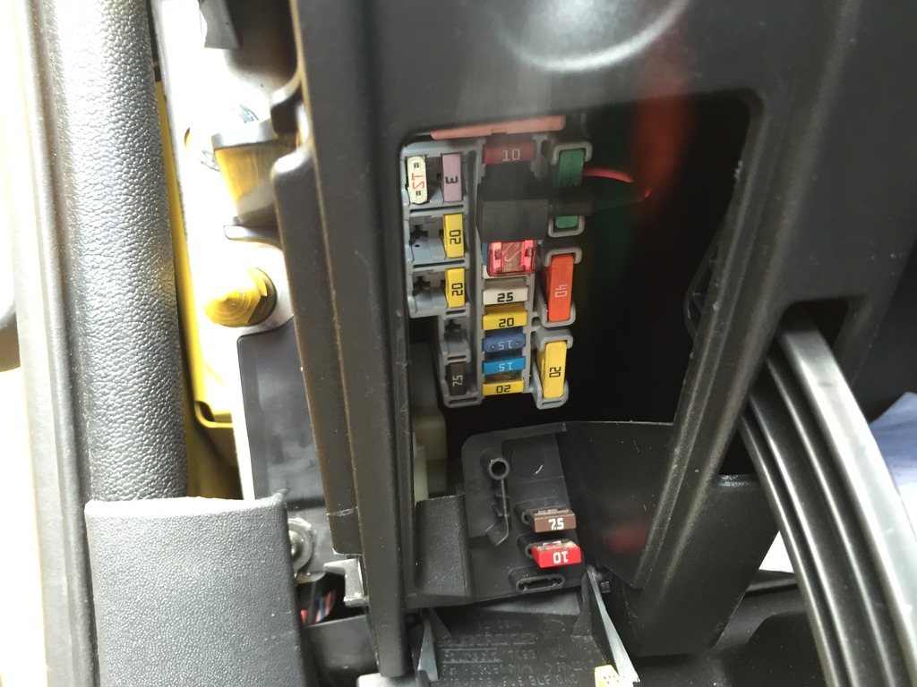

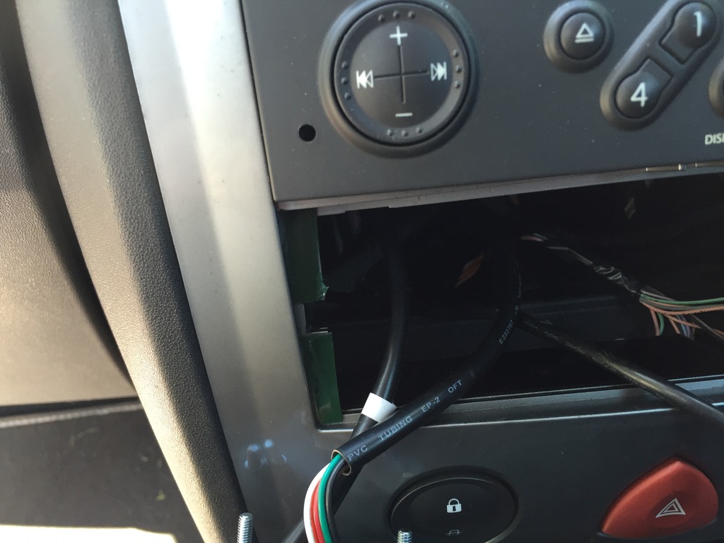

I finally managed to get my AEM AFR gauge working last weekend.

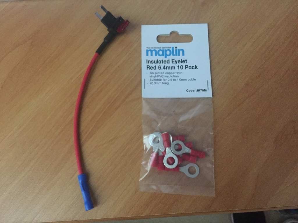

To power it I used a piggyback fuse holder and the 15amp Radio fuse as the source for my 12v switched power so it turns on and off with my ignition.

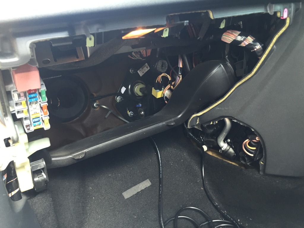

To give better access for feeding the wires where they needed to go I removed the glovebox.
Piggyback fuse holder in place.

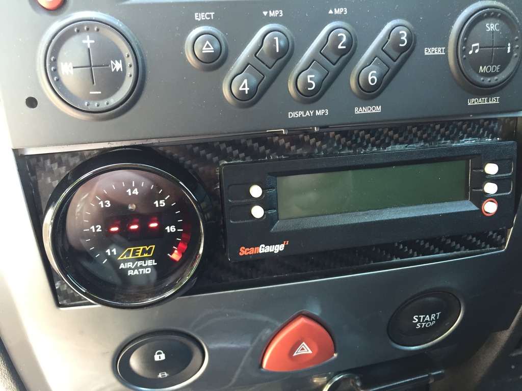

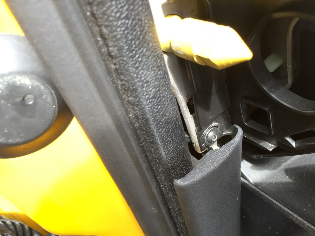

To earth the circuit I used an eyelet connector fitted under the screw below.
To keep the carbon fibre panel in place I wanted something not too permanent so I've used double sided tape.
And the gauge working with ignition on :grinning:

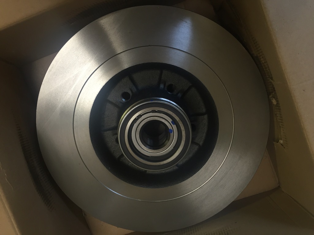

Thanks to @Matt e for the advice and for the rear brakes discs which are next on the to do list.
I fancy changing the rear DS2500 pads to something different so welcome any suggestions!
