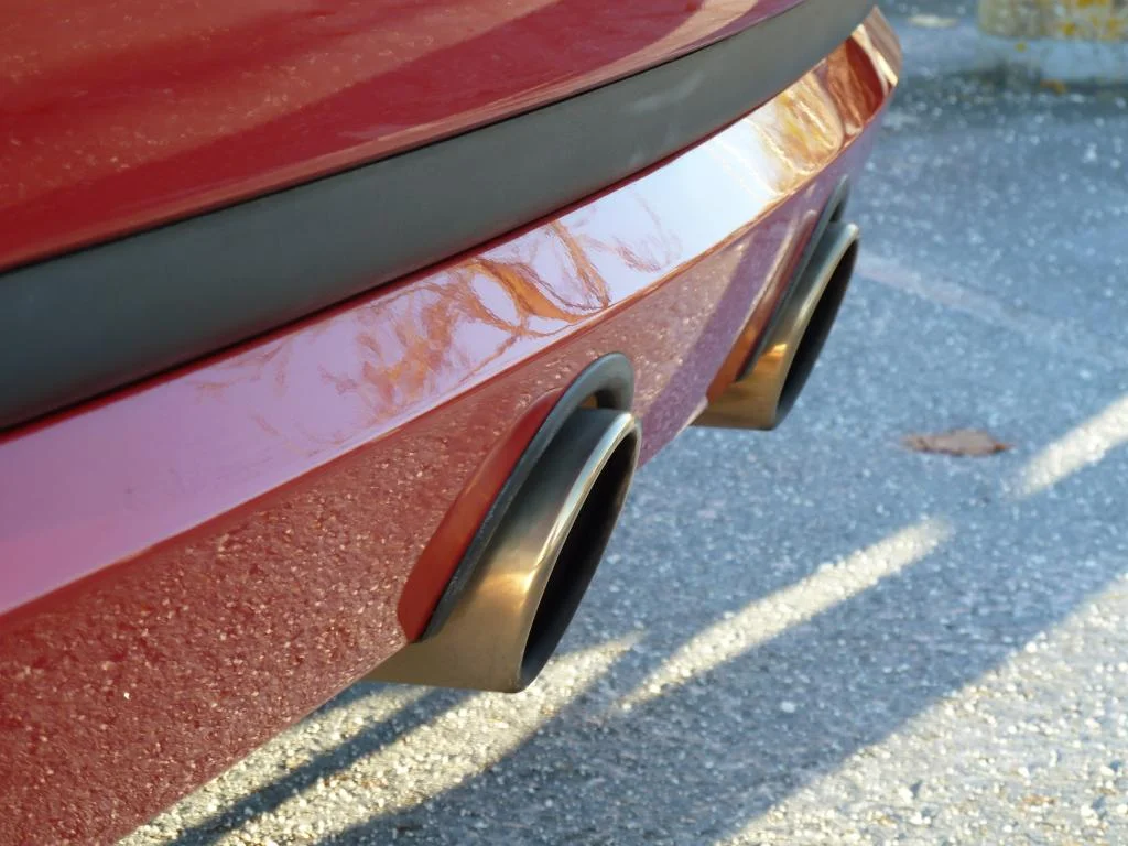

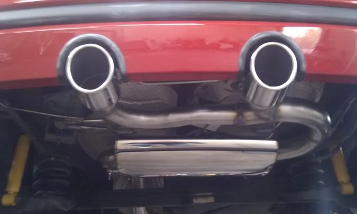

Exhaust - It was blowing slightly and having seen the way 2.5 inch slash-cut pipes fit the rear bumper so much better I couldn't bear to look at the standard exhaust any longer. I wanted something that was top quality and looked good but didn't sound chavvy so I took a trip to ProSpeed in Cardiff who fitted a cat-back system with a 'mid-sport' sound. It was superb and exactly what I was hoping for.

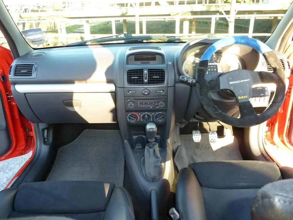

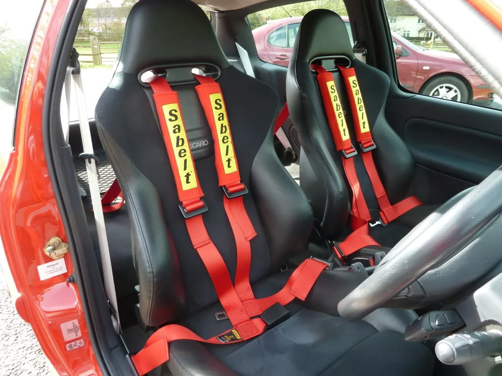

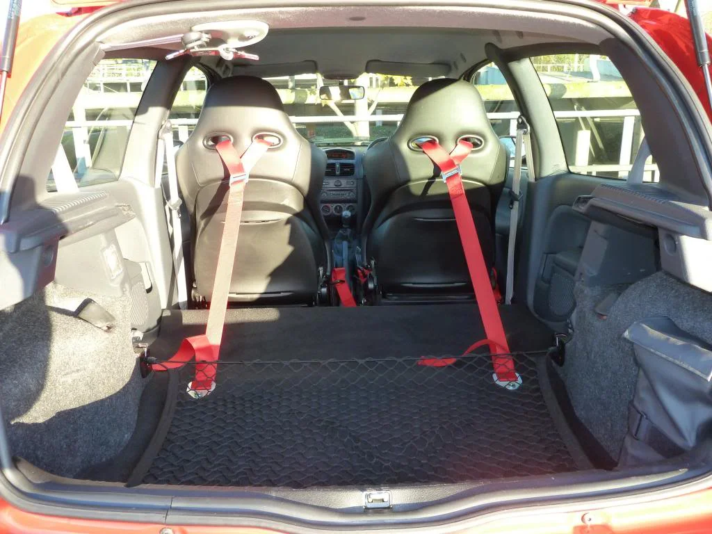

Interior - Stripped the rear seats and fitted some boot carpet (sourced from eBay), along with Sabelt harnesses and a Sabelt steering wheel. I never imagined changing the wheel would make that big a difference to the driving experience but the small, suede-covered rim was one of the best upgrades I've made, enhancing feedback and giving so much more confidence - highly recommended!

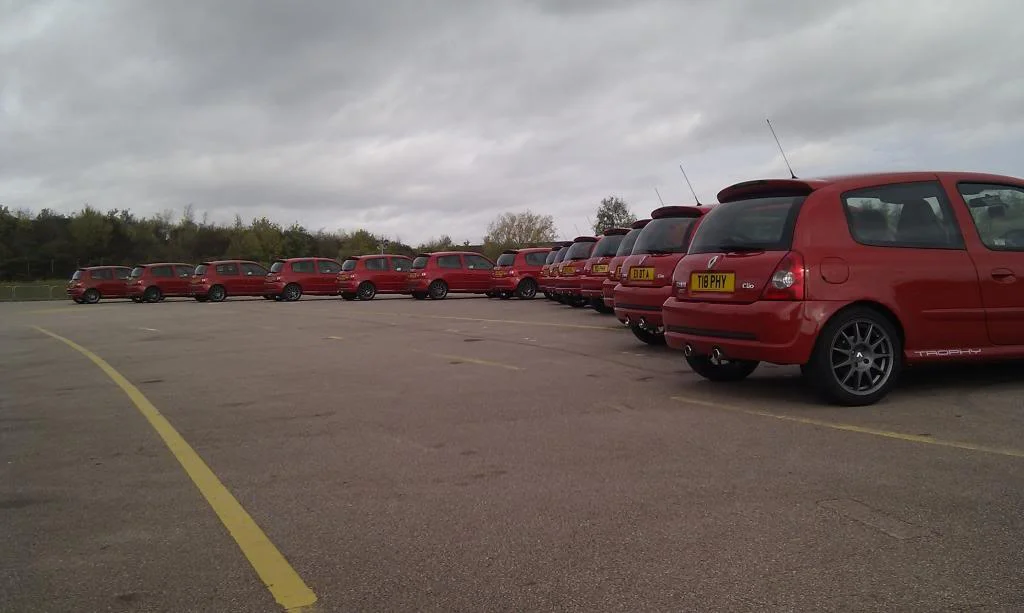

At a ClioTrophy meet at Gaydon some time ago:

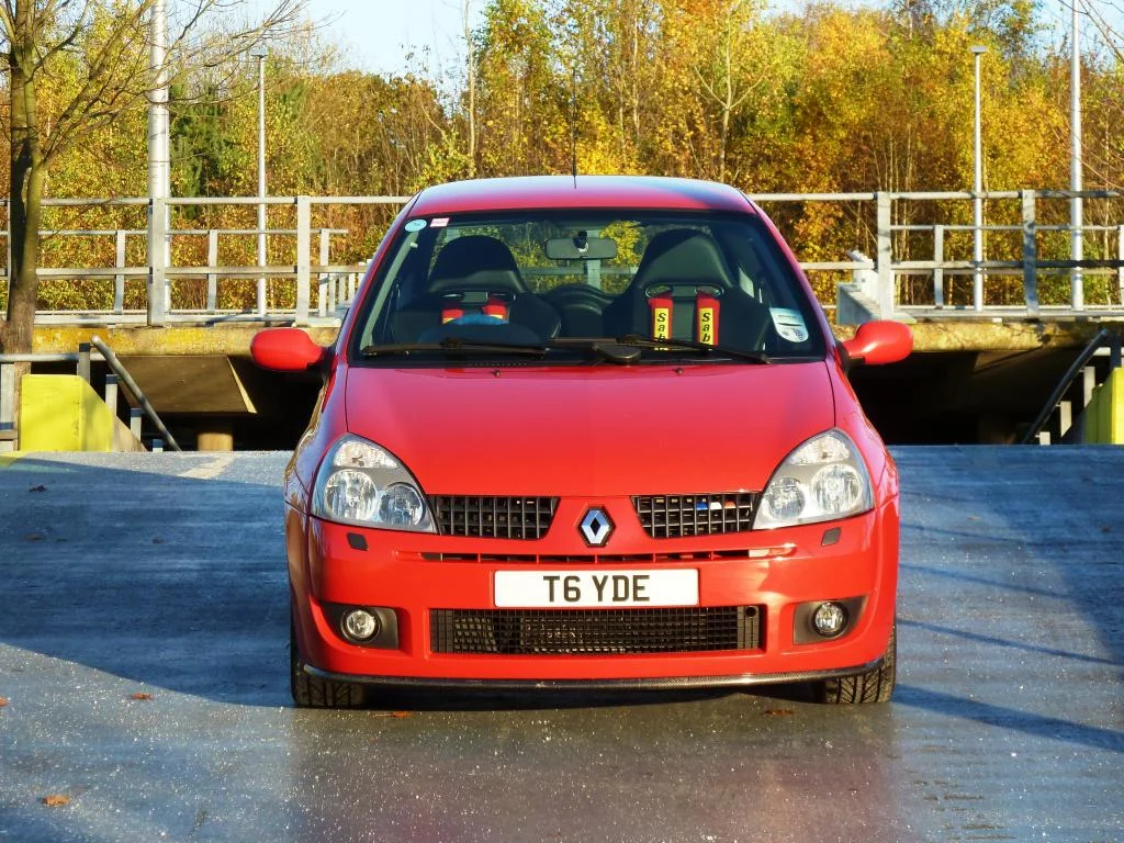

More recent pics:

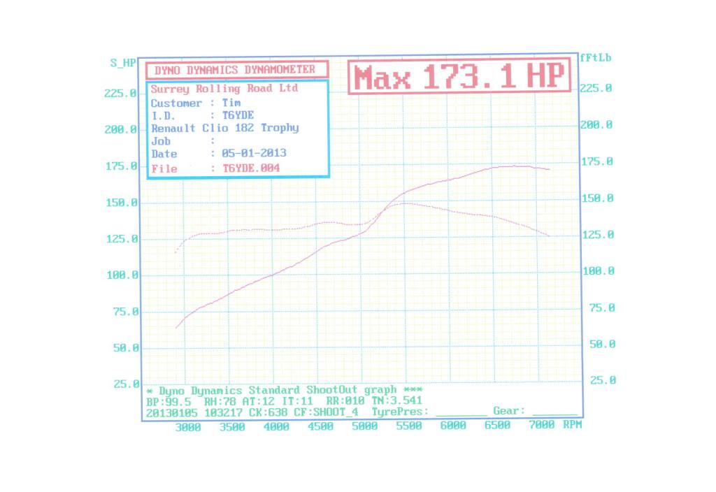

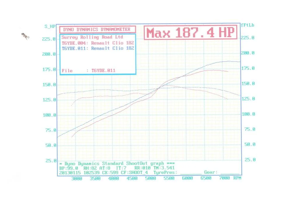

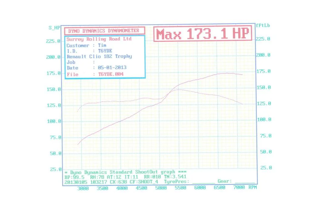

I took the car down to Surrey Rolling Road for its very first run on the dyno, with the only upgrades being the cat-back ProSpeed exhaust and ITG panel filter. Results below:

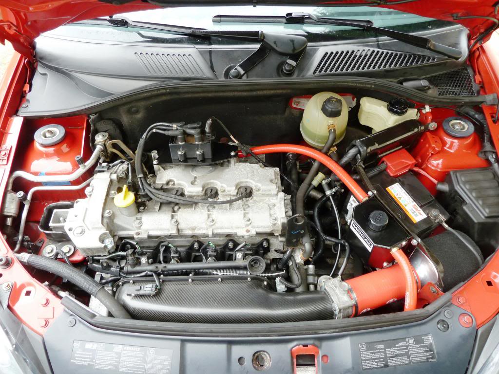

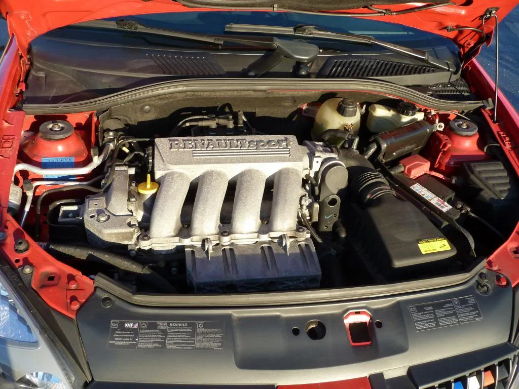

From there it went straight to Mike for an oil & brake fluid change, and for him to fit the RS2, a de-cat pipe & a Mocal oil catch tank, then map the whole package.
The wait was almost unbearable - it was like being a kid at Christmas again, but it wasn't long before Mike said it was all done and was ready for collection. I think it's a really smart looking bit of kit.

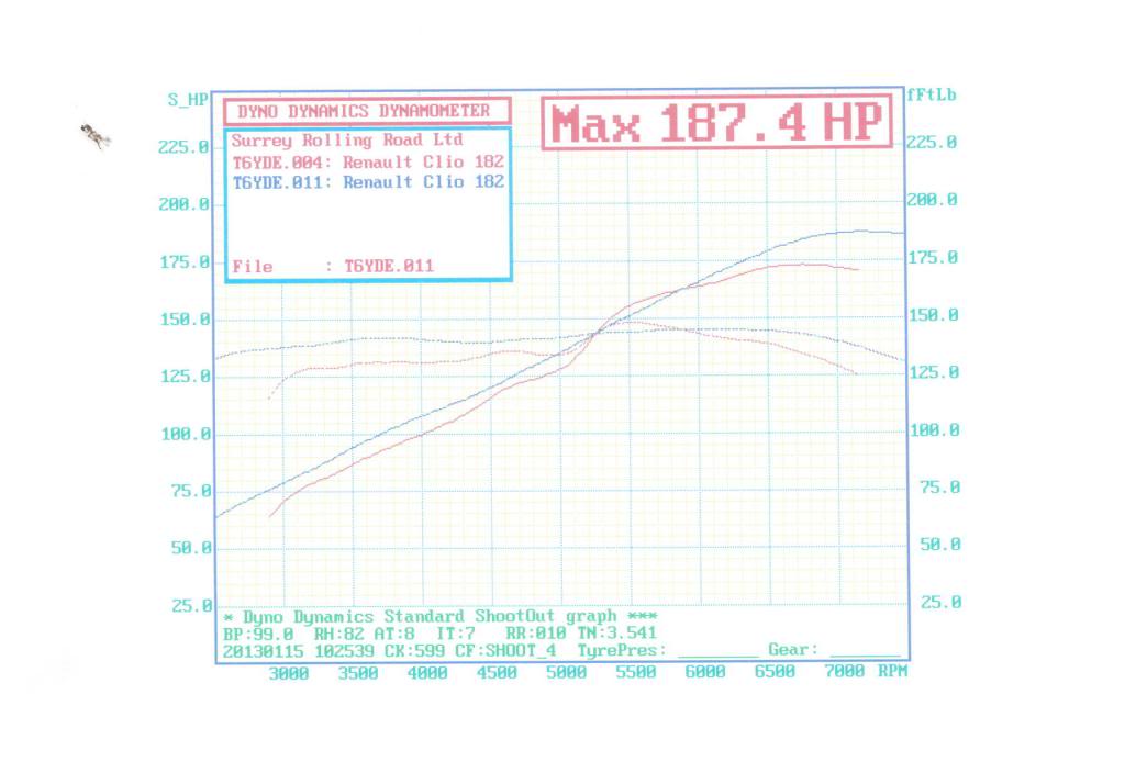

Many people will be most interested in the results:
The numbers speak for themselves but what they don't convey is how they've transformed the way the car drives, and how it pulls from low revs, and pulls, and pulls, and just keeps on pulling. It's so smooth, consistent & linear, I love it!
I much prefer how it delivers its power now compared to having that spike at 5,250rpm before, and to quote a fellow RS2 owner, "you can just waft alone on the low-end torque", and that suits me just fine!
The journey home was way too short for my liking. Exiting every corner I just wanted to get on the power and hear that noise...THAT NOISE!!!!! It's just utterly addictive.
Huge thanks to Mike for selling his RS2 and for fitting it to #455 and mapping it so well, I really am very impressed with how it goes. I have a feeling I'll be blitzing my 4,000 mile limit for this year's insurance. Oh well, it'll be well worth it!

Nice result there Tim, I can see why you are happy with that :)
Prepare for the fact though that some idiot is going now going to say that you have lost torque because you have indeed lost that completely pointless little torque hump, its just something we RS2 owners have to put up with from people who can only see a peak figure and cant look at the fact that yes you lost 5lbft for a few hundred rpm or whatever but you gained double that everywhere else!
A set of ARP's would be a good investment just to allow you rev it a little further even if you dont change the cams as well, as although power is just slightly starting to tail off at 7500rpm, its still got enough poke up there that a few hundred rpm more might occasionally be useful coming out of the bends to avoid the limiter.
They are a bit of a pain to fit due to having to take the sump off, but good insurance.

Lol at the red hose, you trophy boys love these little details dont you!
