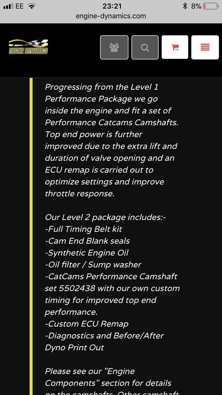

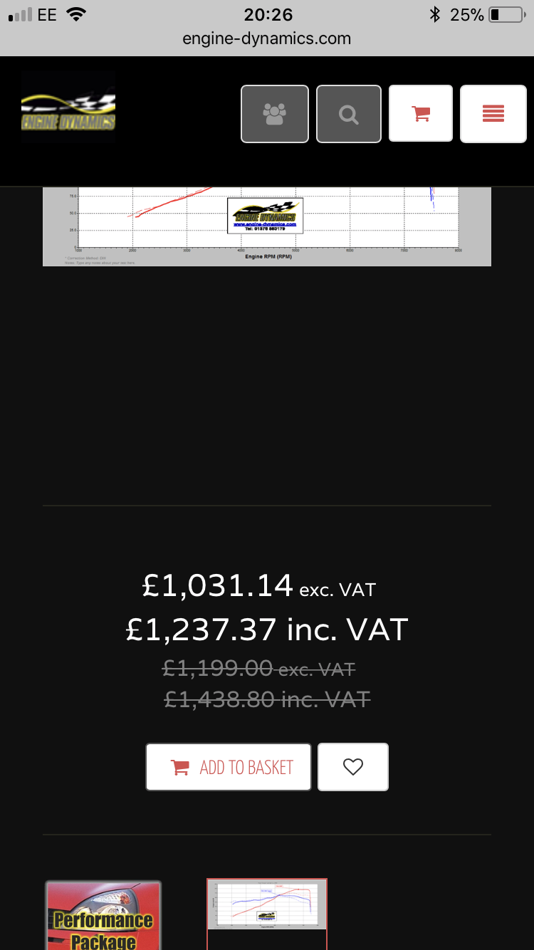

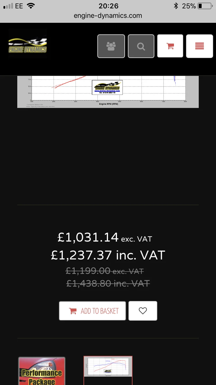

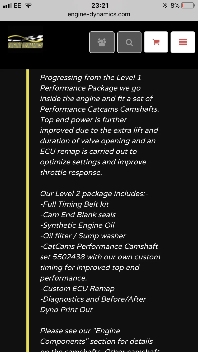

Decided Iam getting my belts done is it worth paying the extra 500 odd squid to get the cat cams from ED.

If staying NA then a nice set of second hand 438s would be a good choice
Id definitely go for 438 catcams in your position, they yield great results for n/a tuning. 15-20 bhp with a nice map to suit and nice driveability.

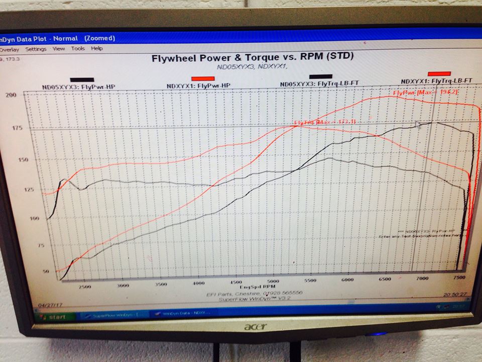

197 cams, top secret cam timing and mapped at efi
black was the car on standard map and cams

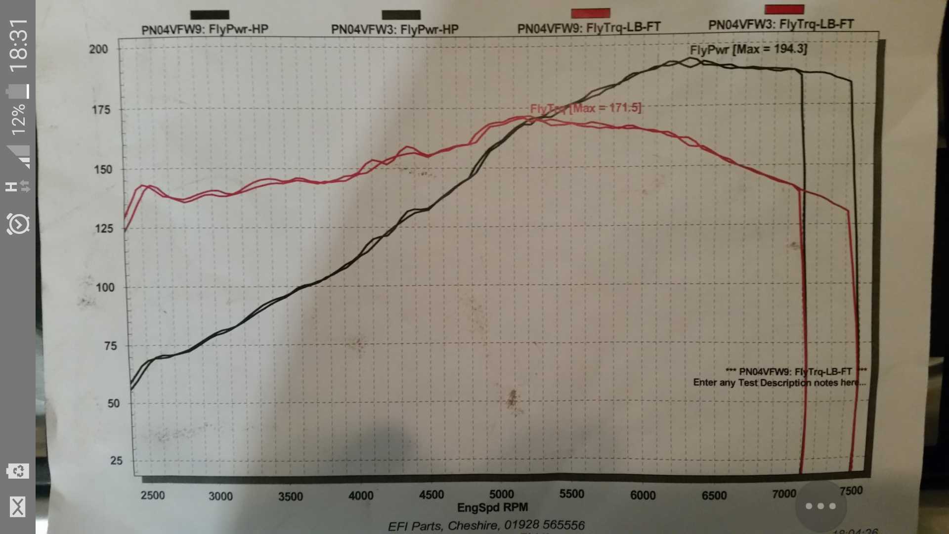

Why bother with catcams at £500+ when you can get similar results with 197 cams for £300 cheaper. For a similar price of the ED package on my 182 I had my belts done, Inc aircon delete, head work due to a few bent valves, oil service, EPAS conversion and a few other bits all mapped at EFI and this gave the below results on the same rollers as the above with just fatty induction and scorpion exhaust and decat. It's all in the timing, so my advice forget ED and go see @bloke.
Why bother with catcams at £500+ when you can get similar results with 197 cams for £300 cheaper. For a similar price of the ED package on my 182 I had my belts done, Inc aircon delete, head work due to a few bent valves, oil service, EPAS conversion and a few other bits all mapped at EFI and this gave the below results on the same rollers as the above with just fatty induction and scorpion exhaust and decat. It's all in the timing, so my advice forget ED and go see @bloke.View attachment 1354044

That's interesting that when 197 cams were discovered back when Micheal Woodford tested them he gained about 8 bhp peak from them , and then many people followed in his footsteps they also yielded similar results of around 10 bhp gain from 197 cams, and they were known as a slight increase in power because they weren't that much more aggressive than the standard cams in 1*2s, but nowadays they yield much better results than Schrick, 421s and 438s even though if you look at the profiling of the camshafts they are way more aggressive than 197 cams.
What I'm trying to say is, get your car on a dyno Dynamics roller, I guarantee it's not making in the 170s of torque, 197 cams do not yield the same results as 438s or 421s.

No offence to anyone but I would personally go with a known package and company with properly ‘uprated’ cams rather than a cheaper alternative with random timing, especially as it’s a fairly expensive purchase (for a Clio).

Also I don't need a dyno graph to tell me my car has changed as the seat of my pants can tell me more than any piece of paper can and the change in performance after the above work was night and day over the OE set up, not to mention the results it produced on track and with that I'm satisfied with the results the 197 cams have produced.

End of the day if doesn’t actually matter if you want to spend more or less for essentially the same thing, I very much doubt there will be much between an engine with the super special timing and 197 cams vs catcams, I would just rather get it done ‘properly’ and pay abit more, but as always each to their own really.
