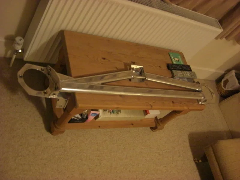

Carbing front strut brace, only weighs just over 1 kilo.

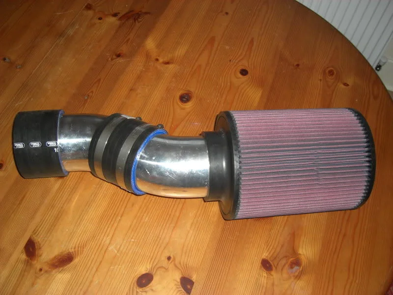

4 inch inlet + K&N

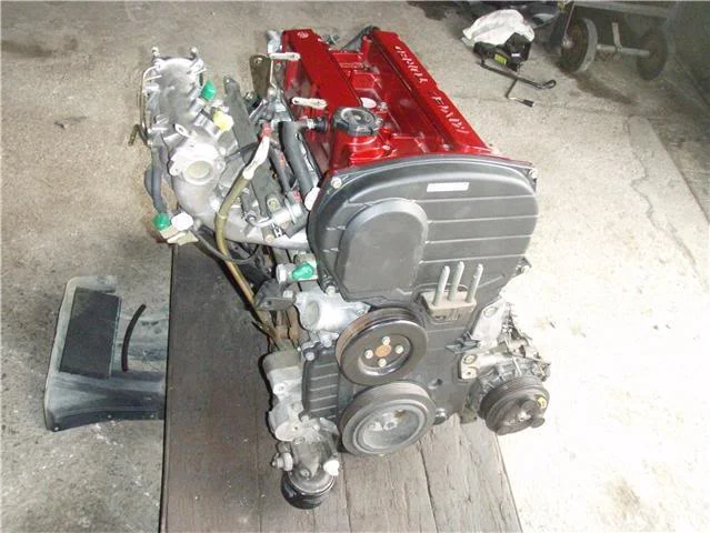

2.3 Stoker engine.

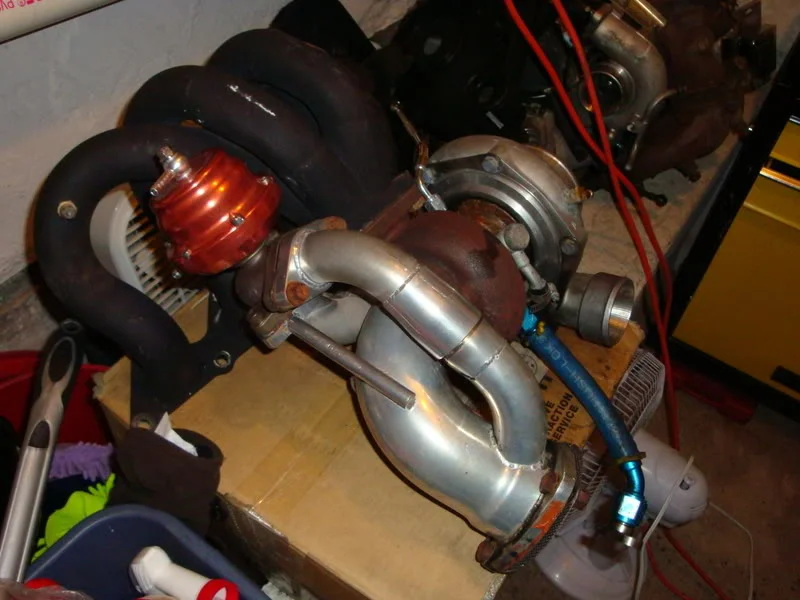

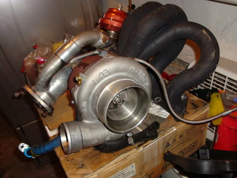

AMS GT35R turbo kit with black cermaic coating. Not the best looking mani but serves a very important roll by reducing temps under the hood.
I wonder if the induction kit is large enough? :D
Ant1
Brembo! Brembo! Brembo!
forget the air filter, just stick some mesh on the front of inlet!
Can't do that, would suck in to much warm air and it's not worth the risk of blowing a 4k turbo if something goes inside. Than the debris will move down the ic pipes through to the inlet manifold and into the engine! :dapprove: :D

make some ducting to stop the heat issue and run some fine mesh... pleanty people do it, when i go big single i will run without filter...

Must be other reasons than fella as there is not one big power Evo running between 500-1000bhp with that setup in the UK :dapprove:

really??? was sure i saw a few evo's just running the pinky inlet trumpet on the turbo... though norris did on the swb for a while? i know alot of the skylines and rx7's do cos the filters just wont flow enough and strangle it as do supras...

that's all showy b****cks mate, very not sensible to run it like that

i dunno, i know of a couple rx7's running 500 bhp up and run without filters simply cos they wont flow enough... dragon run a couple cars as road cars without and their drag cars all run without like their 200mph car...
there are a fair few supras in the uk doing it also...

Turbo is massive! The ceramic coating on the manifold makes a huge difference... good for the whole engine bay!

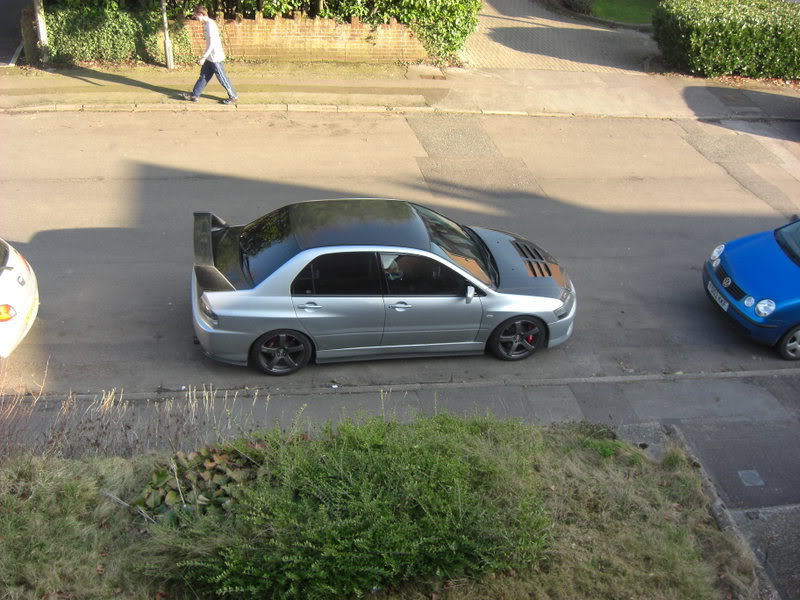

Grrr here is a pic of the new wheels and i really don't like them! Oh well back to the drawing board.
Strell
  Clubman JCW
Could you get further from the curb;)
Only joking, that is one awesome car, just wish i had the monies:(
