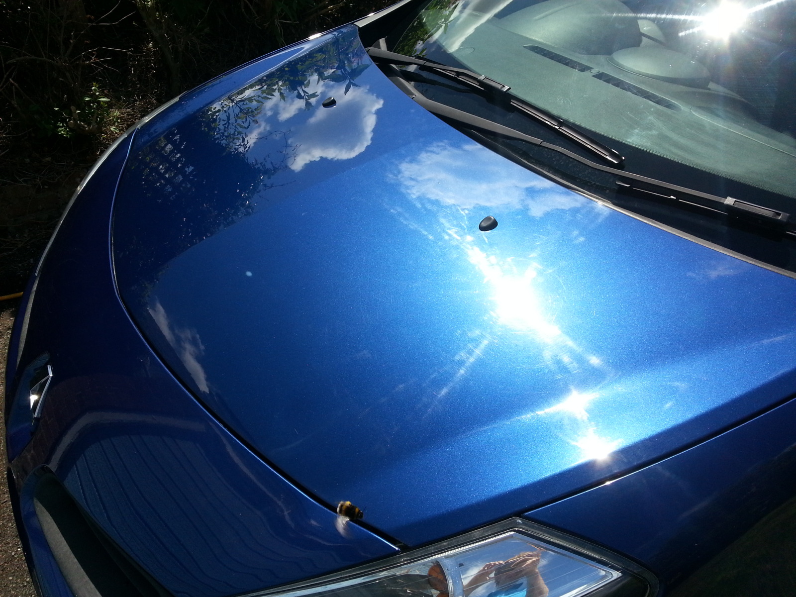

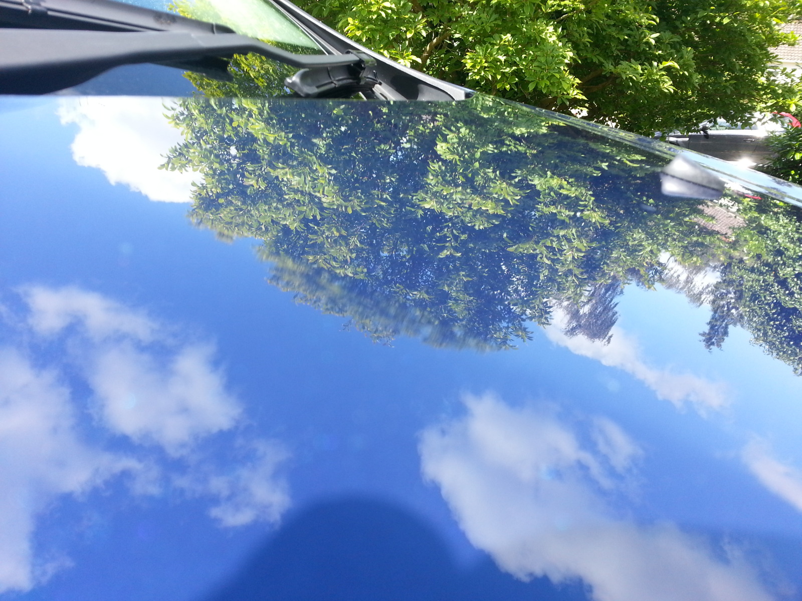

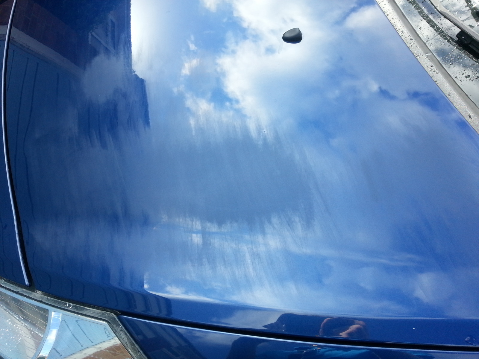

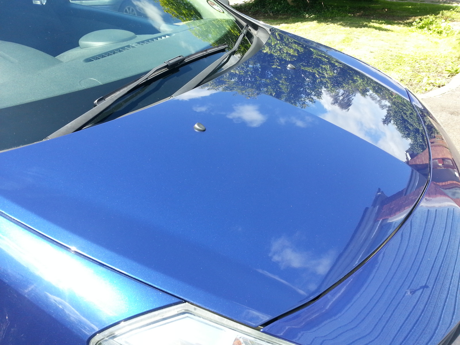

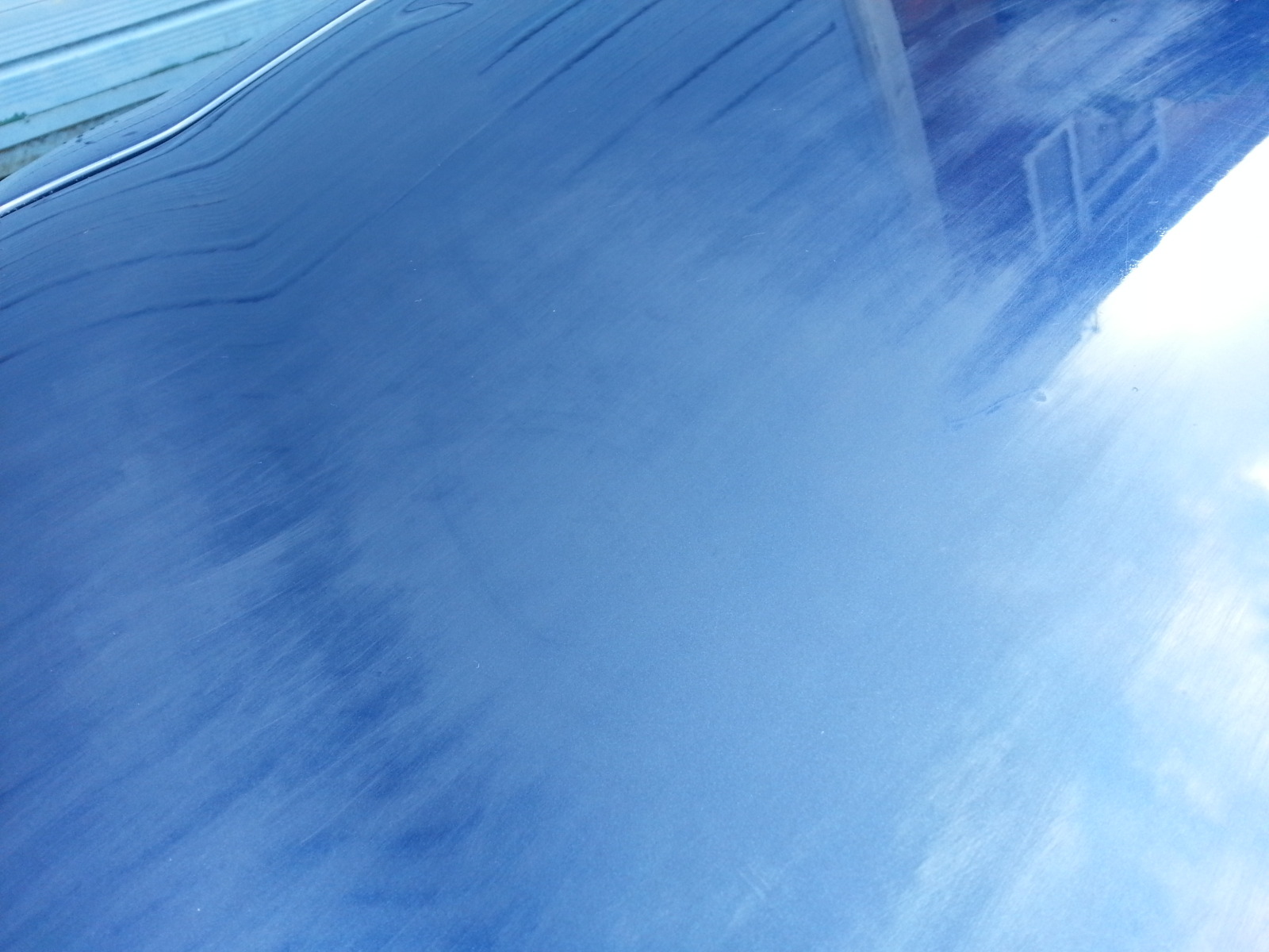

So, the pictures for you all aucky Knuckles gally Coby. (there's still some paint left ;)) :) Before:
  1.6 Astra Sporthatch
Top work! The wet sanding didn't look anywhere near as bad as I expected.
I got up early (way too early!) this morning and went through the grits until I got to 2500 trying to smooth it all out as best I could, and then when it was properly light I took that photo! It looked far worse before I started sanding like you suggested so thanks for that :)
Please tell me someone didn't charge you "about £40-£60" for the above after results?
£25, I will admit there's still swirls and its not the 100% perfect finish like I expected a machine polish to be, I think he was far from a detailer but some of the paintwork he did there looked very good. I was just happy to get the bonnet back to its former shine, but I do wish it was all swirl free.
That's fine then. Not great, but better than spending a lot of money on an average finish.

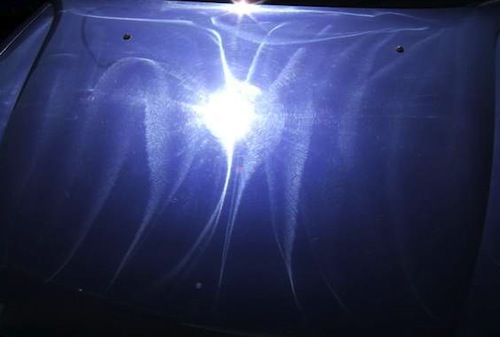

Complete layman explanation, you need to work the polish from low up to high rpm to cut out the original defect, but by then you'll have inflicted your own defects in the paint. You then need to work the polish down to low rpm to remove these defects and get a swirl free finish.
Sadly it's not a case of turning it on and passing it over the paint. That's how hologramming occurs (not working/breaking down the polish sufficiently).
