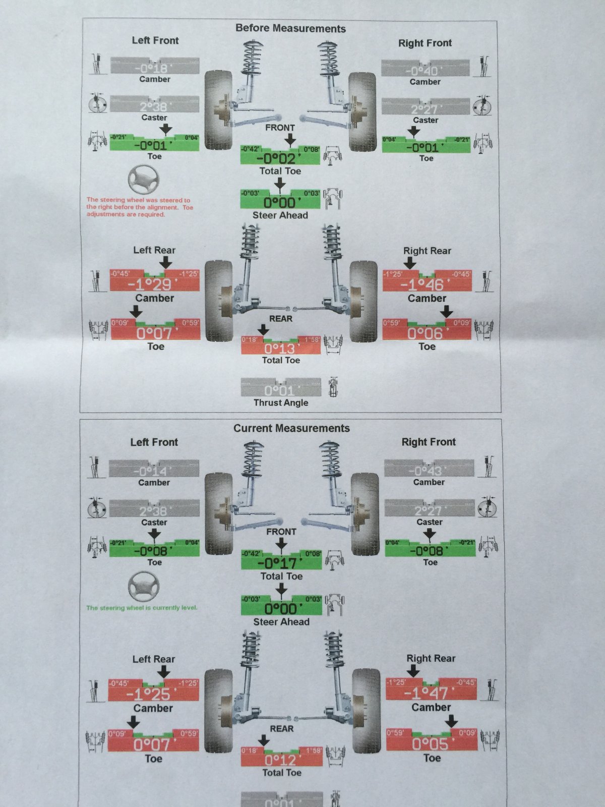

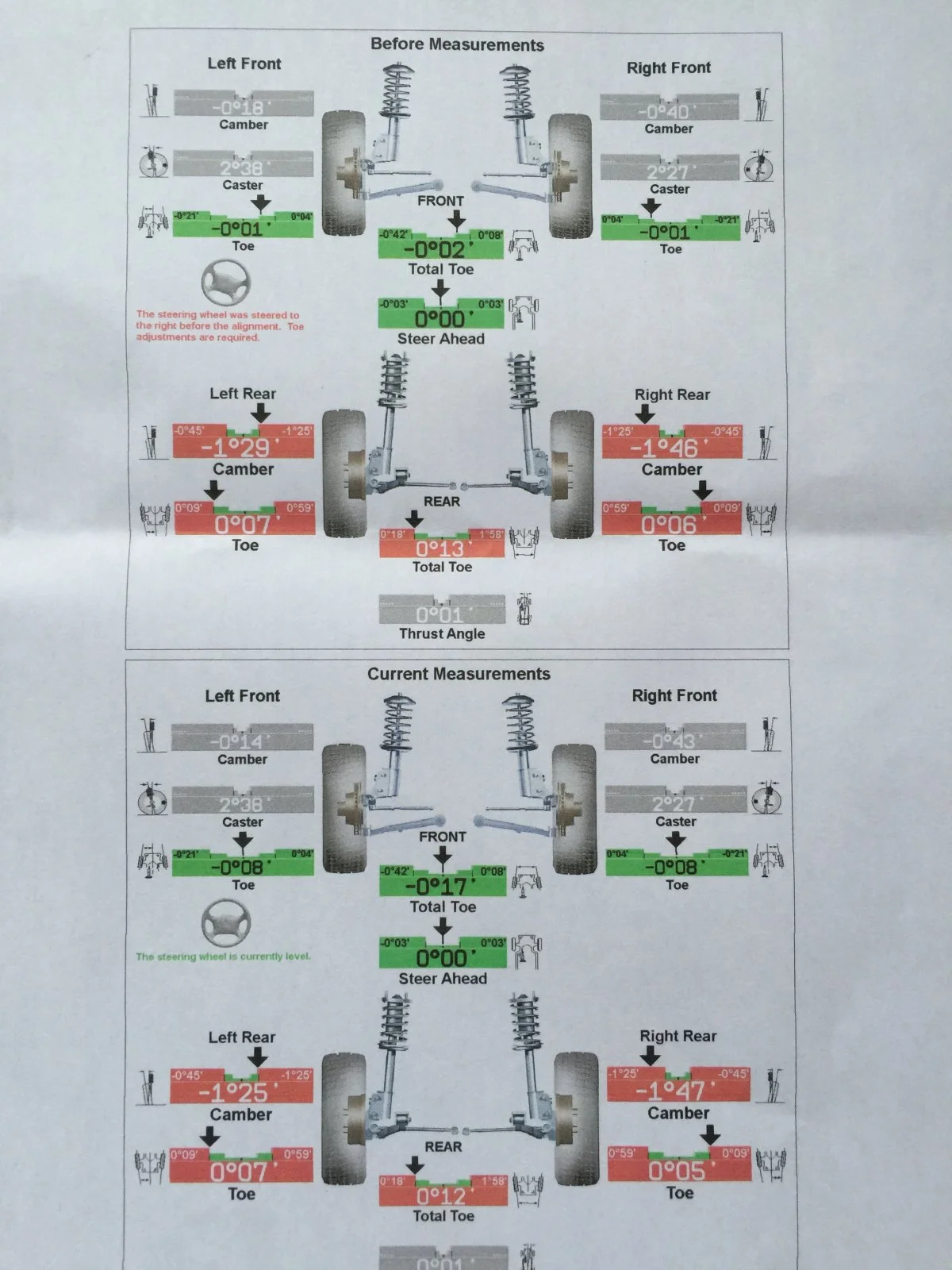

Here's my set-up
  E92 M3, BG 182
Heres my settings before and after the last KwikFit visit
  E92 M3, BG 182
The car drove straight with the original settings of minus 1 minute toe out - sounds like it might just be roundabouts like flebay said and nothing to worry about (i.e. should have left well alone)

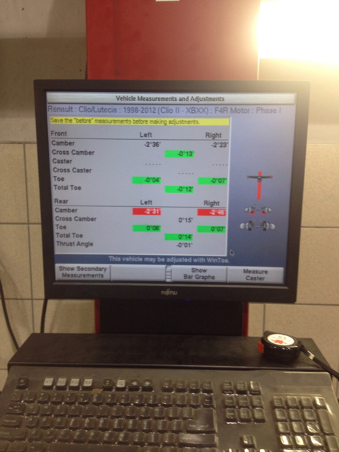

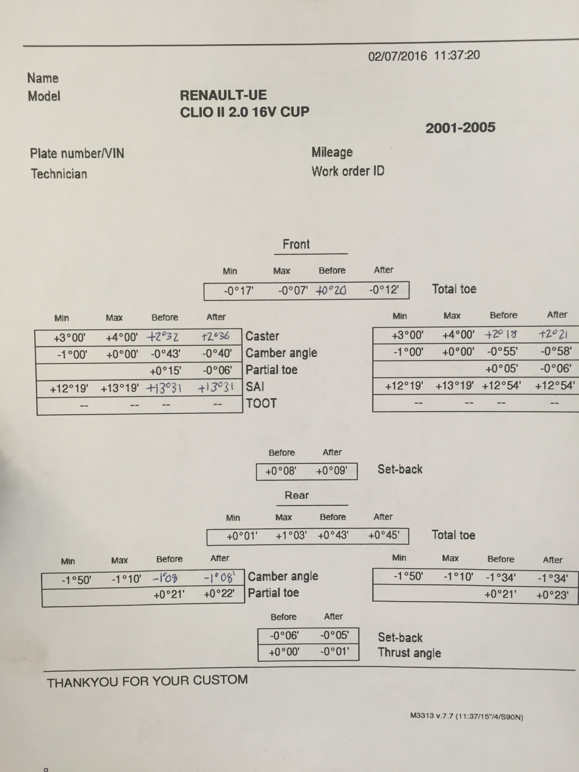

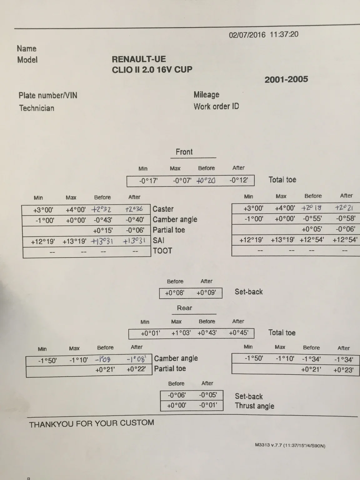

  BG FF 182
This is what I set mine to the other day at work, The reason the toe is so far out to begin with is i undone the track rods on a different ramp,While doing the oil change to check they were not seized.
