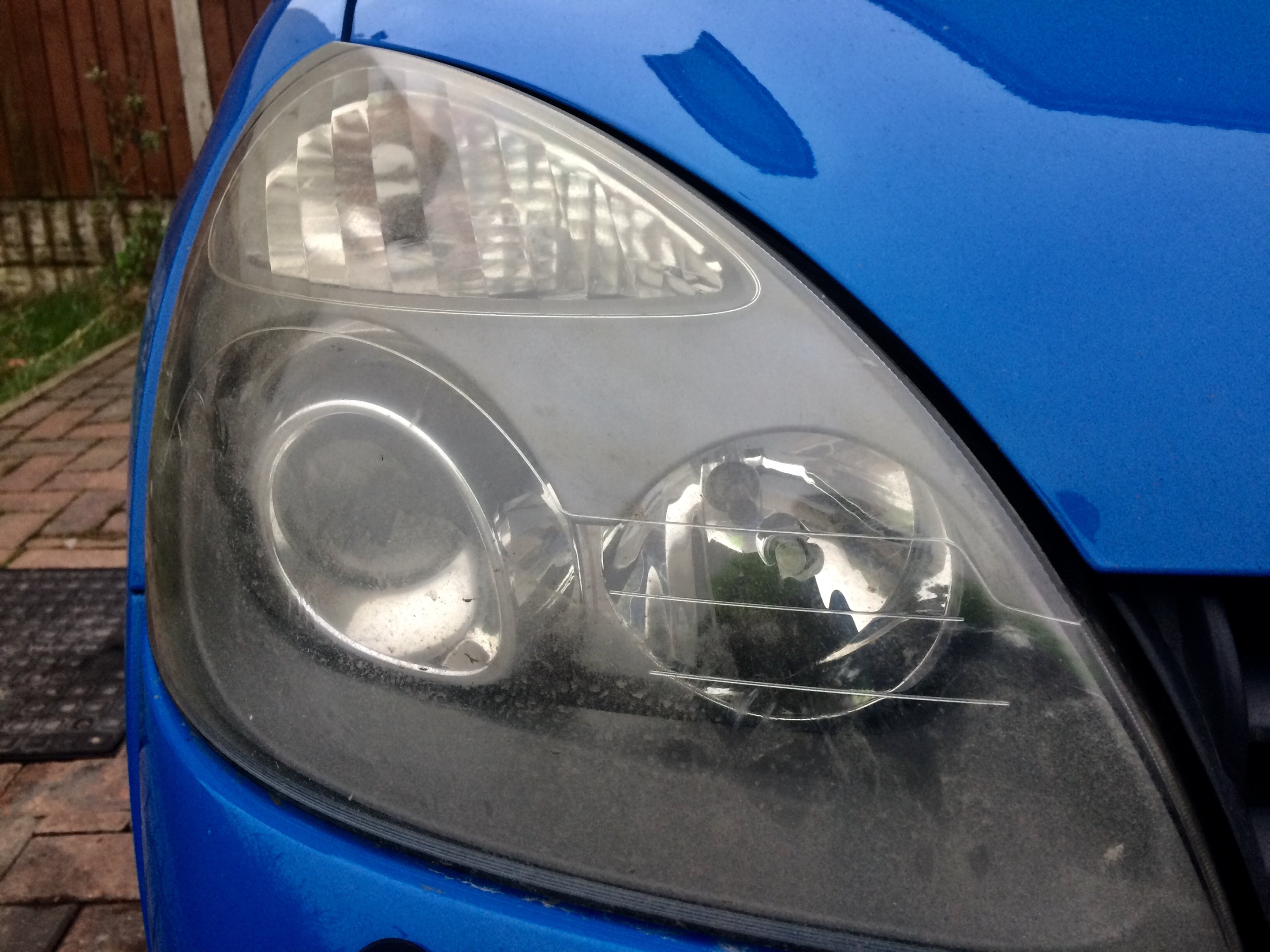

Cheap little mod, silvertech indicator bulbs front and back

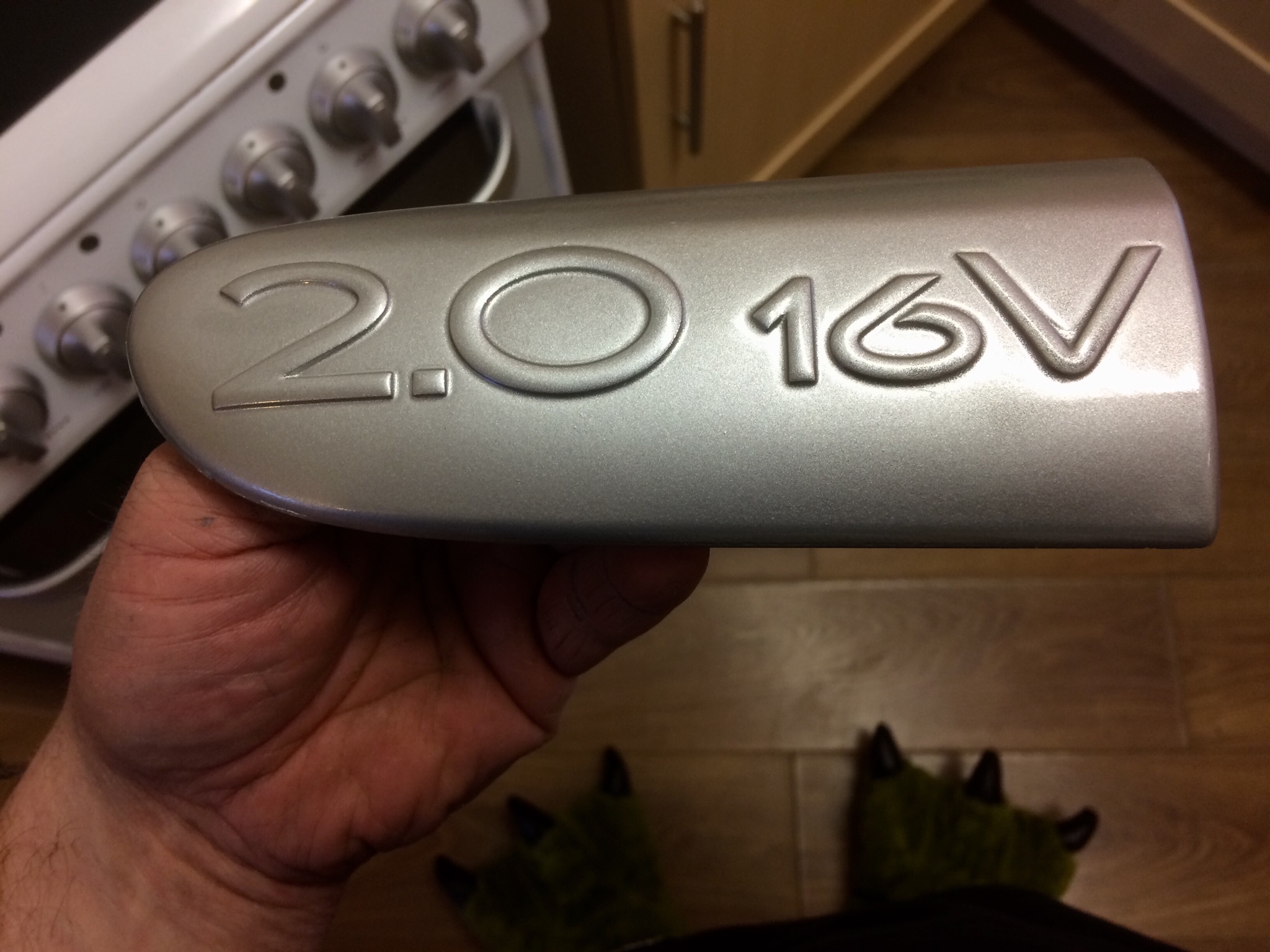

Ive also resprayed my wheel diamonds and bullets as i wasnt happy with the finish, i ideally want all new but im insure if renault sell them?

The bullets look great, did you spray them with a rattle can? Any tips to get the best finish? One of the things I want to do on mine :up:

Those bullets have come up lovely! Nicely done :cool:

Hi mate yes i rattle canned them, smoothed with 2500 wet and dry, a fine coat of primer, a couple of coats of mercedes brilliant silver and a coat of laqcuer.
After each coat i dry them with a hair dryer until tacky, this gives me the best results.

Sounds good, will give it a try and see what happens :up:

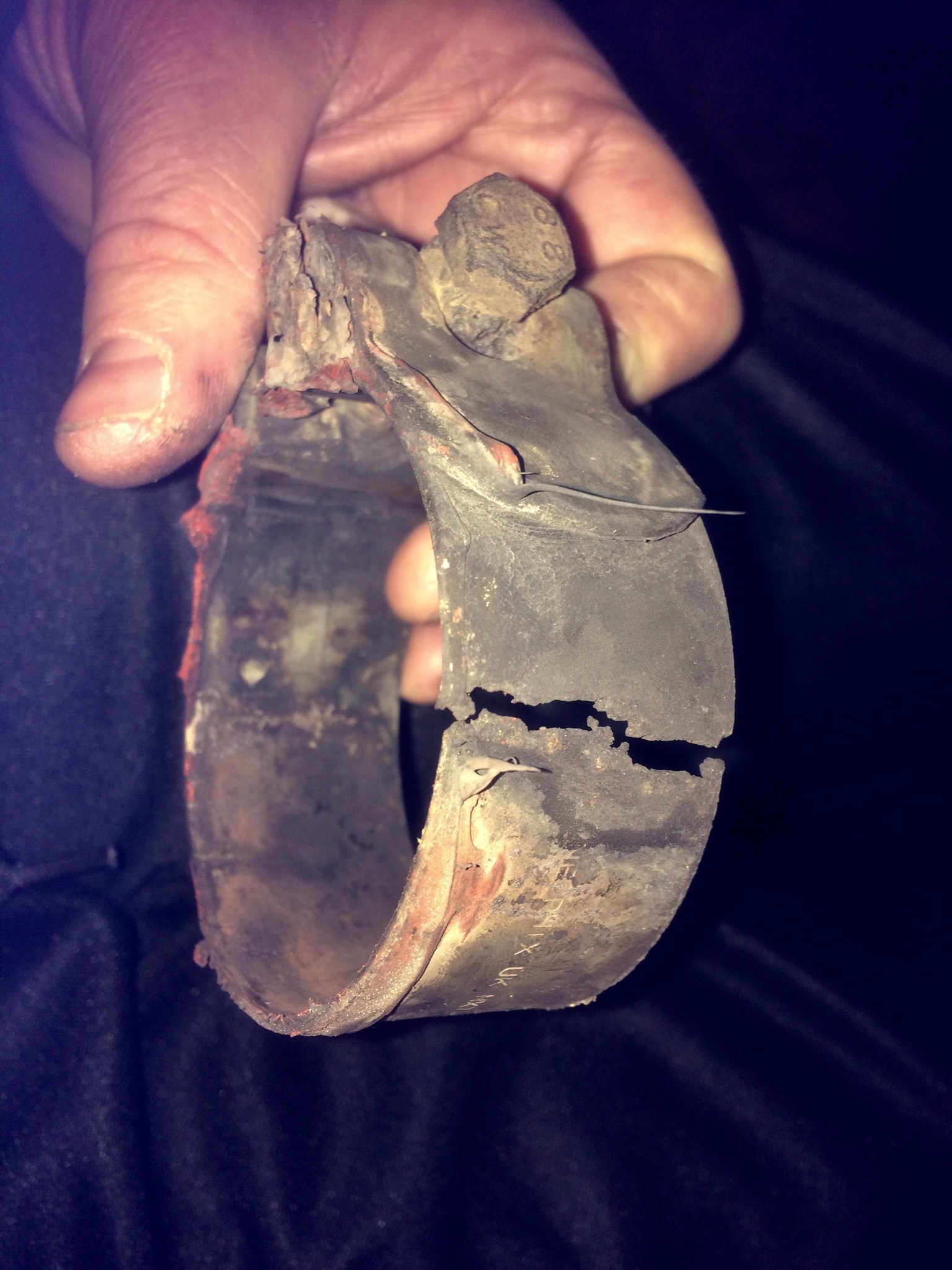

I also got the bloke to check a bit of a blow from the exhaust, he noticed that a clamp was snapped, but he said it was the wrong clamp fitted, and i need one with three grooves in it to fit and seal correctly.
I have a miltek catback, does anyone know where i can get one of these clamps?

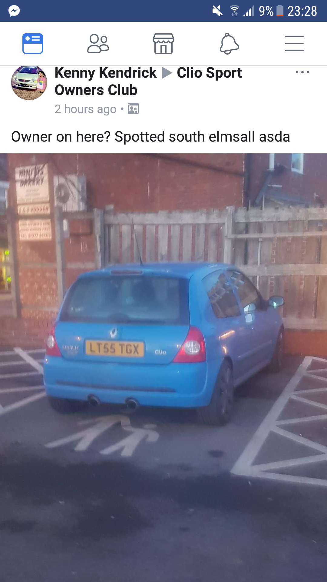

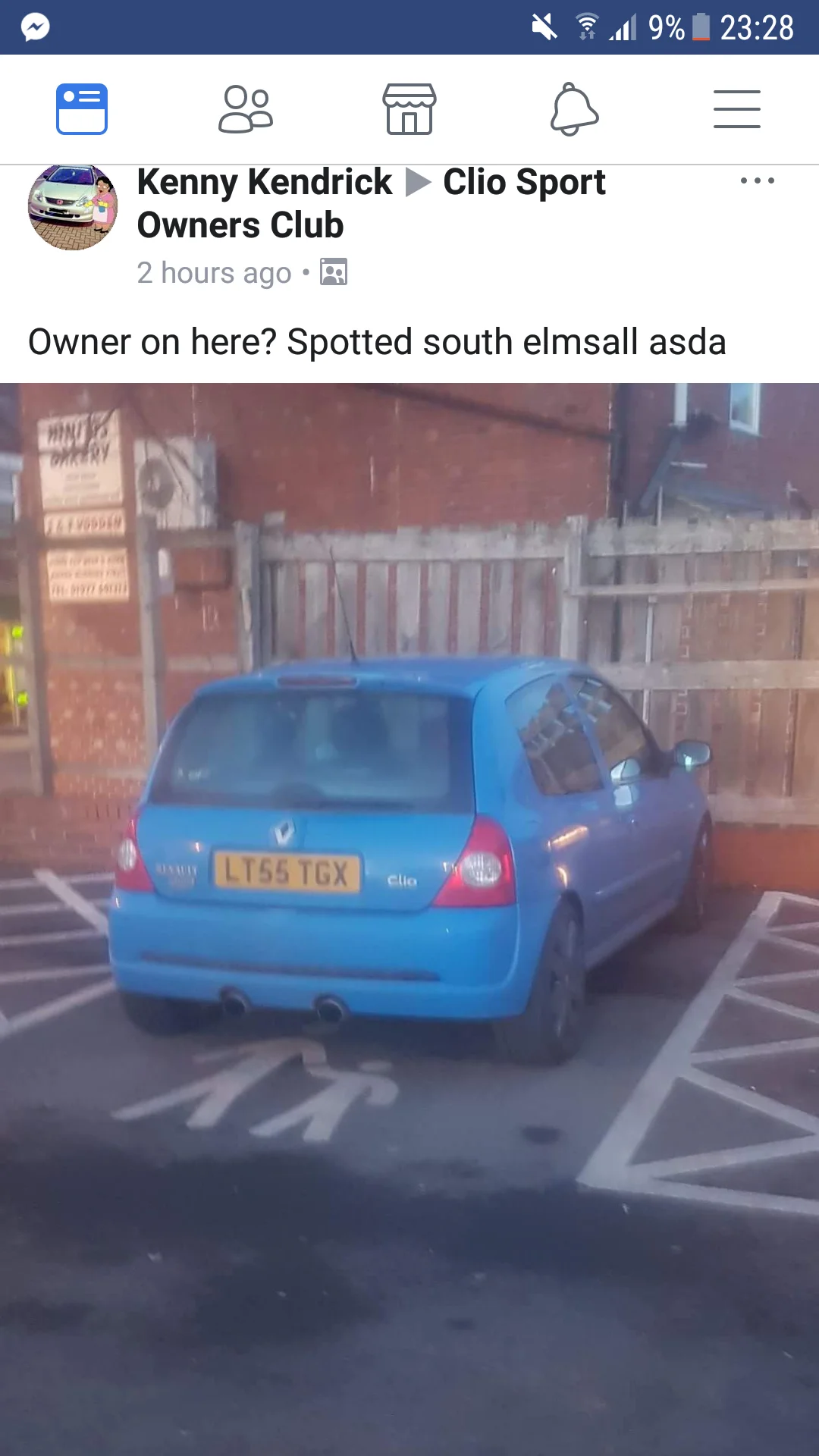

Because im in a child space, have you not looked in the’ youpark like a c**t’ thread? Inspector gadget? 😂
Eh? It was on Facebook and someone just said they spotted you and whether you were on CSOC. At no point did anyone say absolutely anything about your parking.
Lol'd at that first clamp pic hahahaha.

I know mate i was only joking haha, i just put it out there before the, ‘omg, you parked in a child space’, witch hunters started 😂
