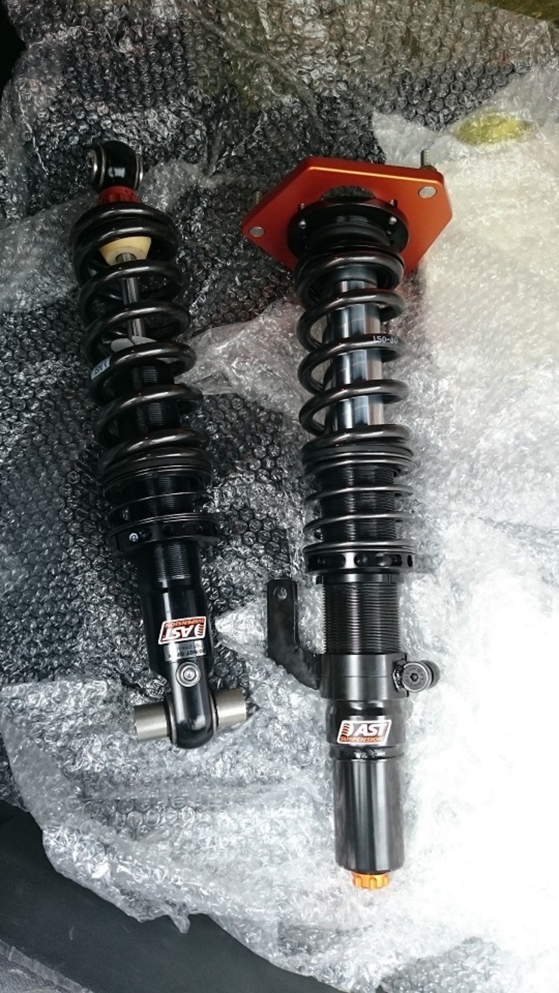

Decent suspension was required so I got a set of AST Sporline 2 with the standard AST 450lb springs front and rear along with the camber adjustable top mounts. They're fitted with the double digressive pistons which appear to be working well at the moment.

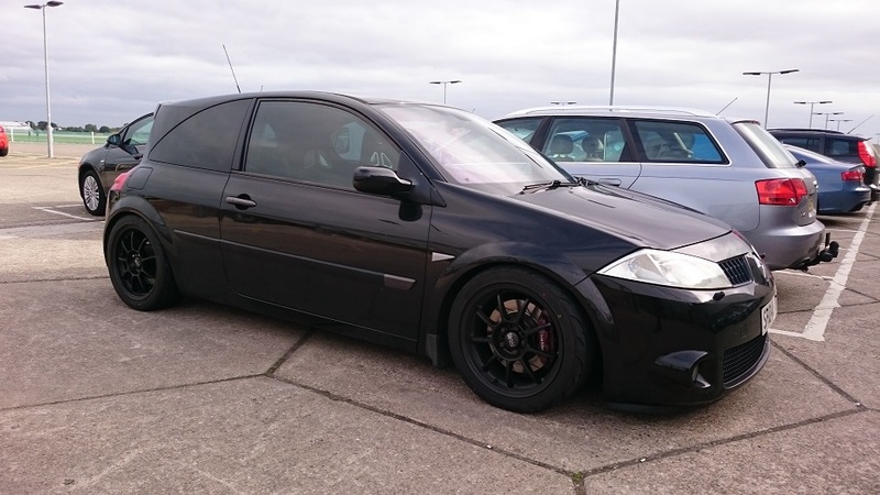

So here is the only awful photo I've taken so far and it really needs a wash and polish. However its taxed, insured and MOTd and ready to go this summer, not driven it properly yet but when I have use it it's f***ing rapid!

That looks epic already.
Knowing how capable your ph1 one was, this is going to be a right flying machine. Brilliant!
Look forward to it going past me at Oulton.

Cheers dude! Its amazing how a different set of wheels and some lows transformed it.
I'd like to do a bit more weight saving to it such as polycarb windows, carbon bonnet and lithium battery but that's a lot of outlay on about 40kg of weight saving. Instead I'm looking at going halves with a friend on a dedicated track car.
Haha! I don't think so, your power to weight is probably superior to mine.

It looks proper mean, good choice on the wheels mate. :up:
Mines only 283 ftlbs :cry: (need more power)
Cant wait to see it Tom. :smiley:

It rides better on the road than the Clio. The ASTs feel perfect for fast road use, I'm hoping they feel just as good on the track, BC racing are a cheaper option but I wanted a proper rear coilover setup.

You know the car well then? Yeah the ASTs have transformed the car, the wheels help too, definitely make it more spritely.
