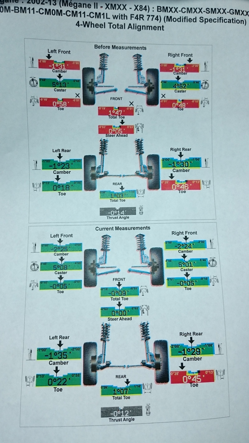

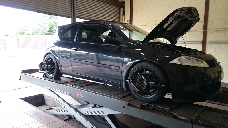

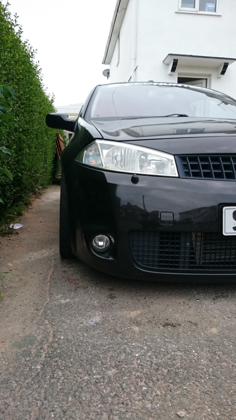

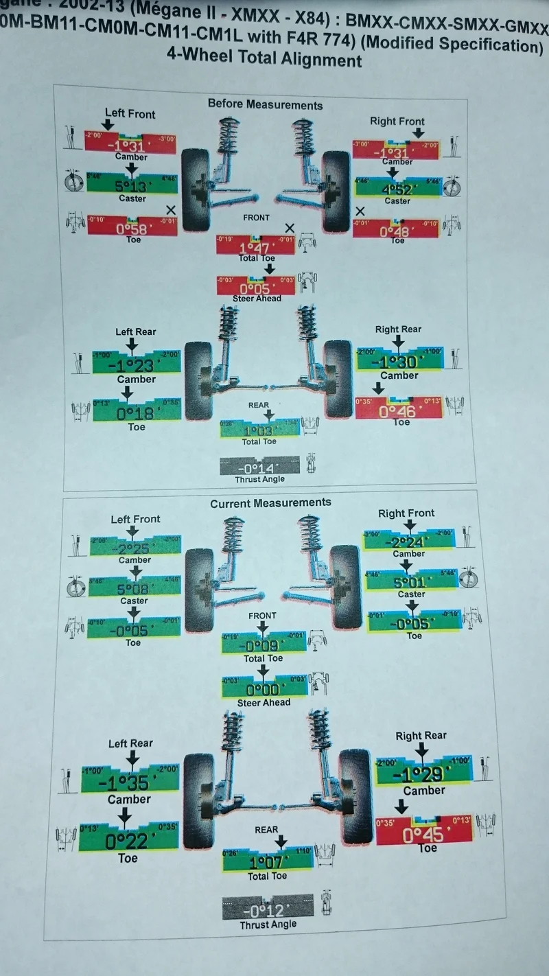

Full front end refresh with upgrades including Track Focus steering rack bush, 22mm cup racer ARB, Powerflex camber and caster adjustable bushes set to max. Then I had the camber set to approx. 2.5 deg. neg. on the top mounts and the toe set to 10 mins out.

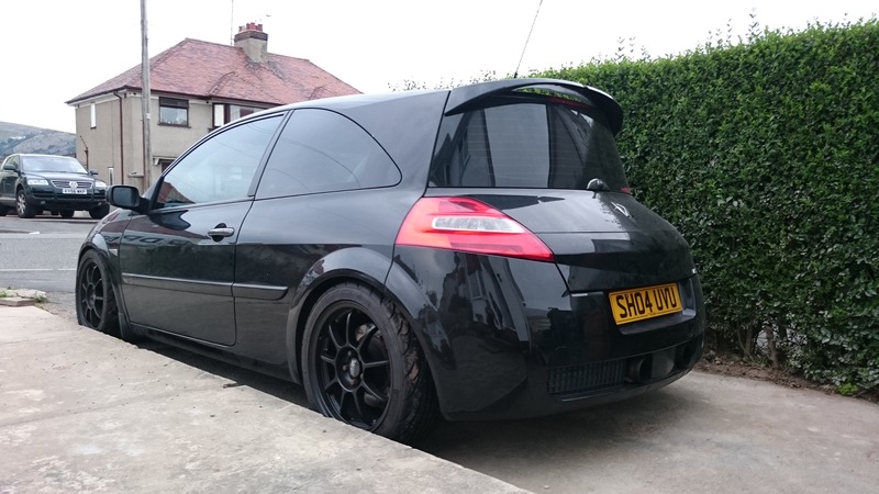

Camber angle on the wheels

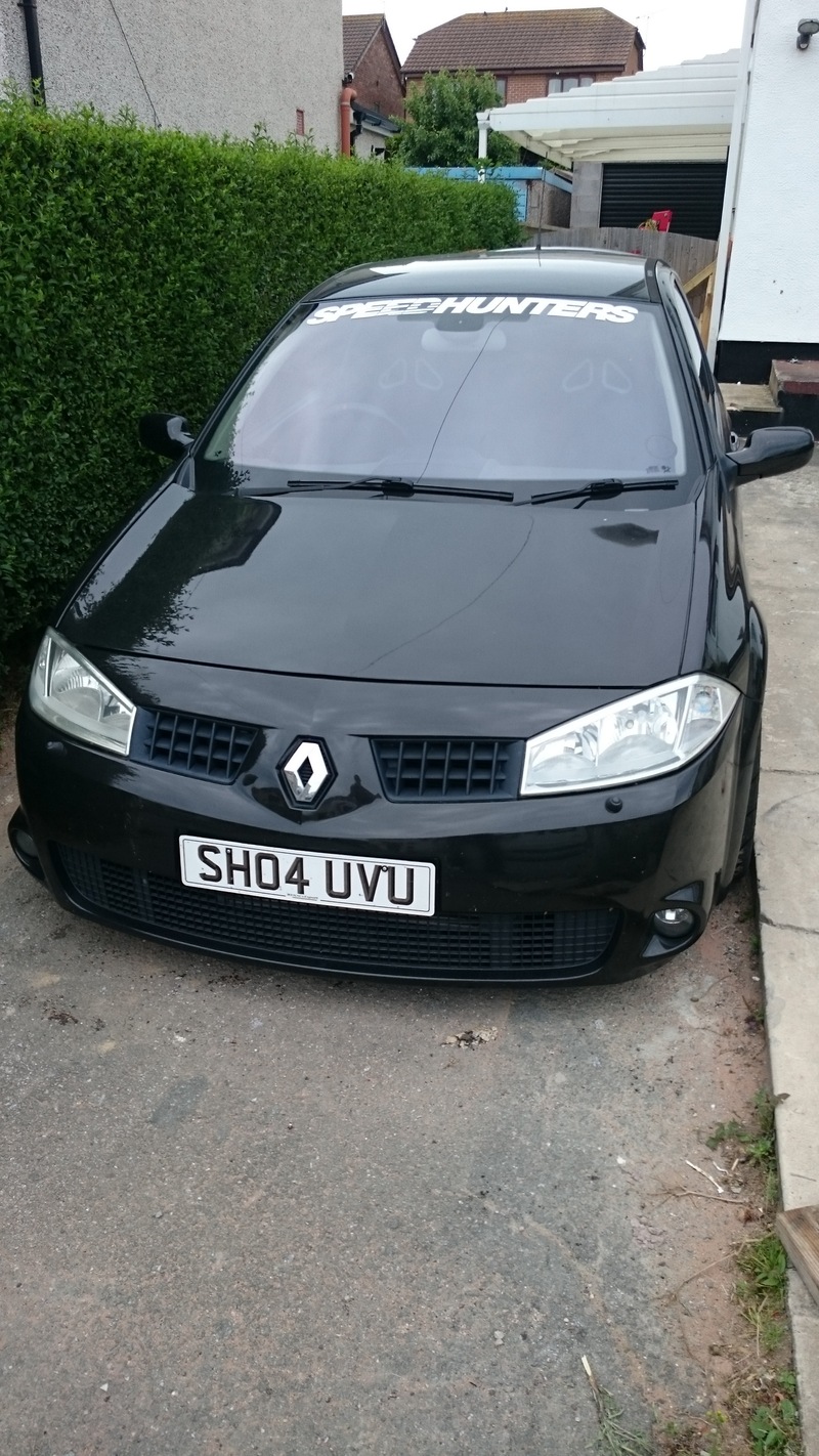

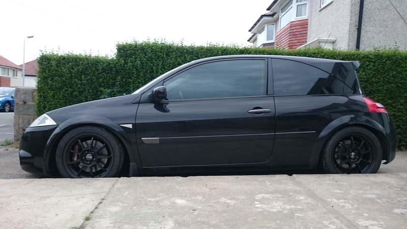

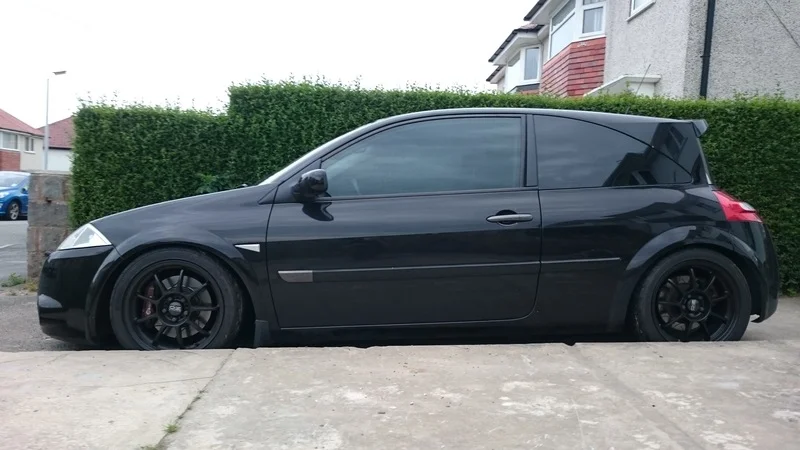

I fitted the speedhunters strip and removed the front splitter as it was too low. Took some photos of how it sits before I gave it a quick wash before Oulton.

Those wheels really suit the car.

Tom where did you get the tracking done and how much was it. The settings look bang on the money so would be interested to know mate
Thanks.

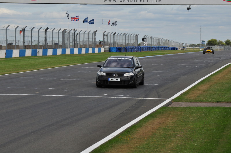

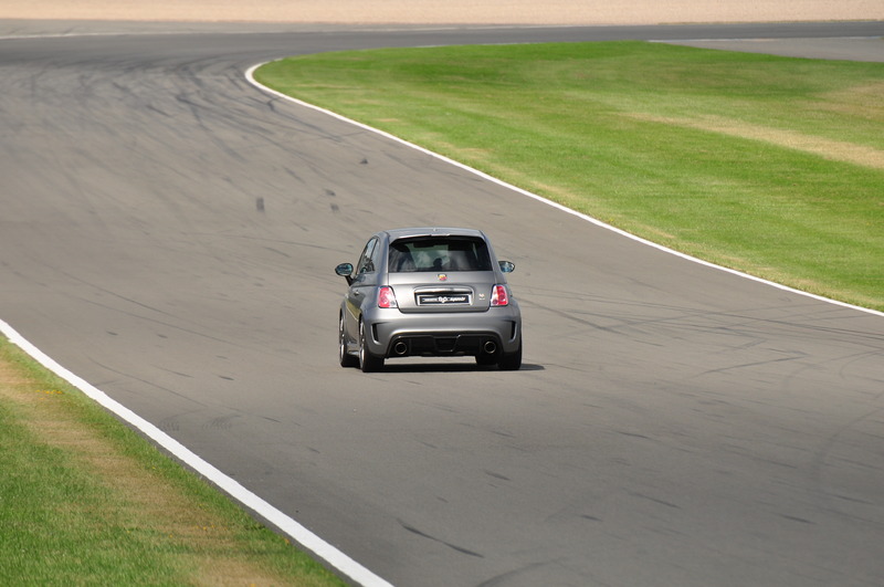

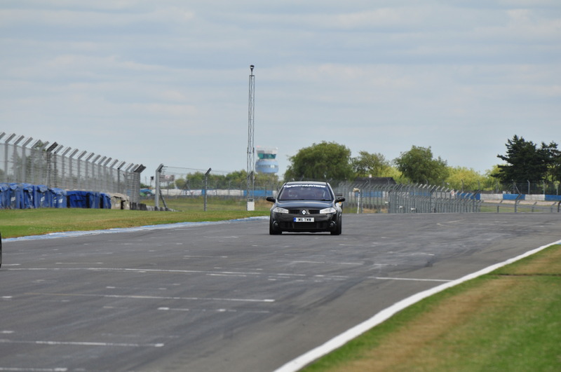

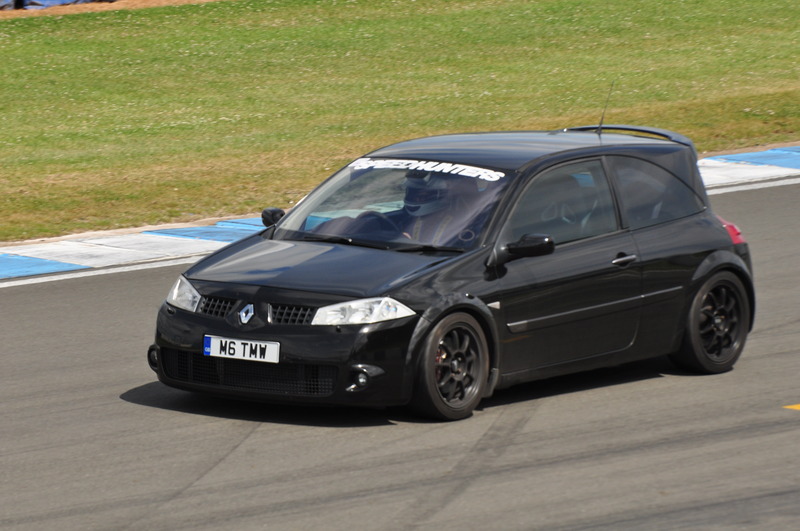

Went quite well at Donny, no mechanical issues. NS2R performed reasonably well, grip levels were reasonable and on a par with RSR. Wear was nice and even. Performance dropped off after a few laps but the drop off wasn't too sharp. I wouldn't mind a bit more power! 😂

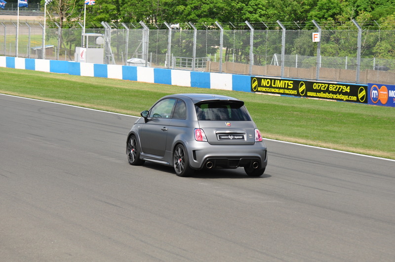

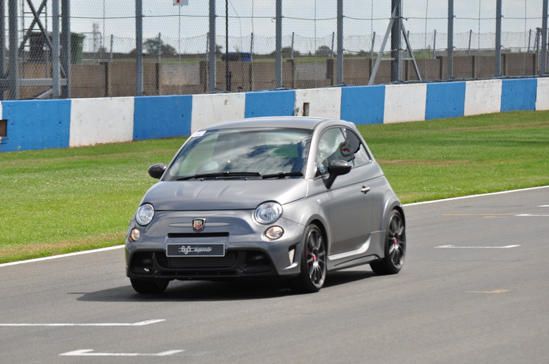

I also drove the 695 Biposto they had there, lovely car and felt great but the £52K pricetag for the top spec model is a bit steep for a Fiat 500...
A few pics my mate took, I'm hoping to get some from Xtremesportsphotography soon.

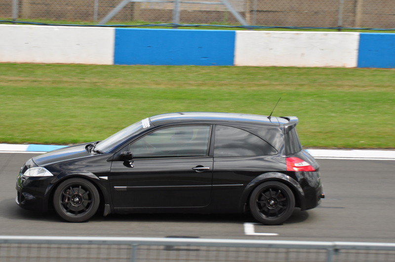

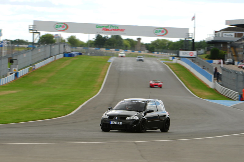

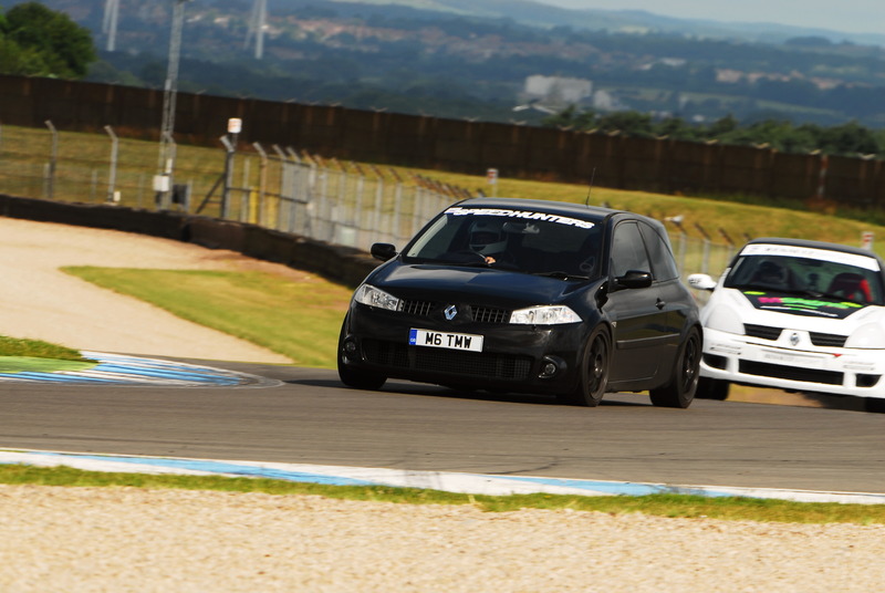

Got some professional photos done, nice to see it corners nice and flat, the suspension mods are obviously working. Wouldn't mind getting the R26 rear axle though with the extra rear ARB I haven't got now and I believe the R26 runs bigger bearings in the rear discs too which I suspect will last longer. I think mine are starting to grumble.
Grandpa Joe
Looks to corner very well that, Tom.

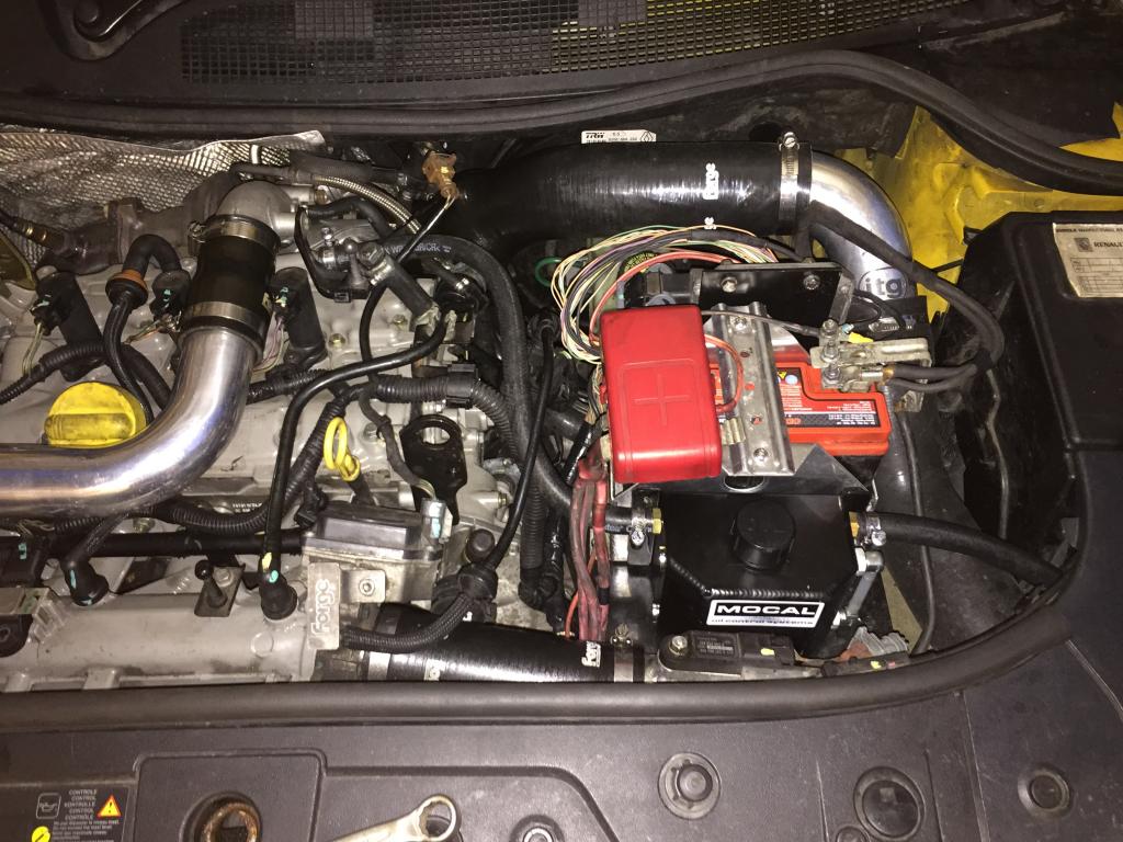

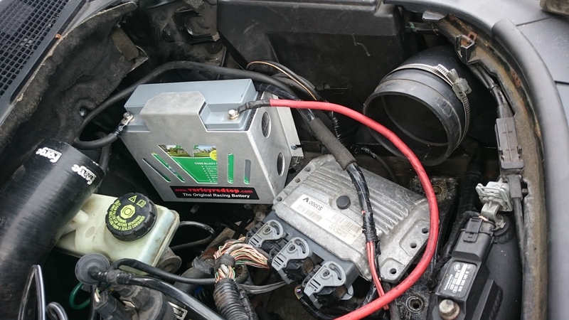

Battery is under the airbox bend. I need to fix the battery bracket properly still.
It's just a cheap Varley/Odyssey equivalent for now like I ran on my Clio.

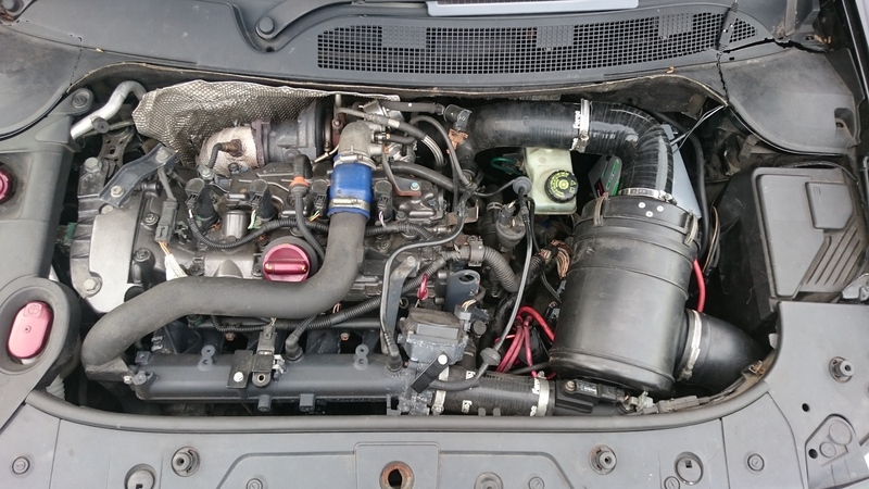

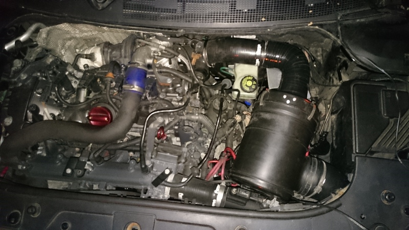

Been driving it a fair bit since changing the Itg filter for the V6 airbox and it feels much smoother to drive from idle all the way to the redline.
I always felt like it ran a bit too rich and since changing the filter it doesn't seem to, possibly why it's now smoother and the exhaust doesn't pop as often.
Hoping to get it on some rollers soon.

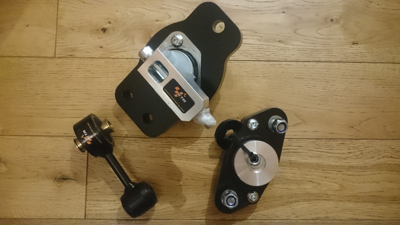

With the next trackday at Oulton Park being 4 weeks away and the engine mounts feeling a bit loose I bought these
They worked out about the same price as new mounts with powerflex inserts and I liked the vibratechnics mounts on the Clio so thought I'd give them a go.
