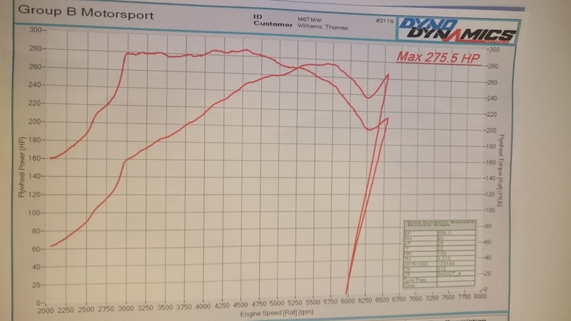

Got this to replace the paper filter that is currently fitted and I'm booked it for a power run on Friday at Group B Motorsport. Hopefully it'll make what it's supposed to be running!
Grandpa Joe
And maybe not just me either.
It picks up a bit quicker and drops off sooner than a hybrid should. And this is at 17psi
A hybrid makes more power and torque than that at 12psi

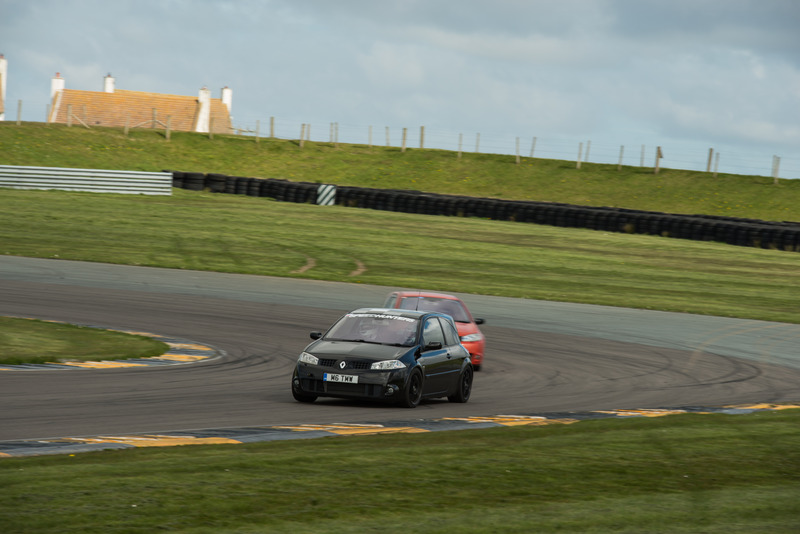

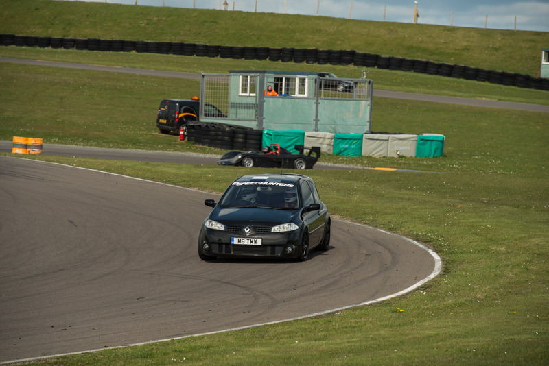

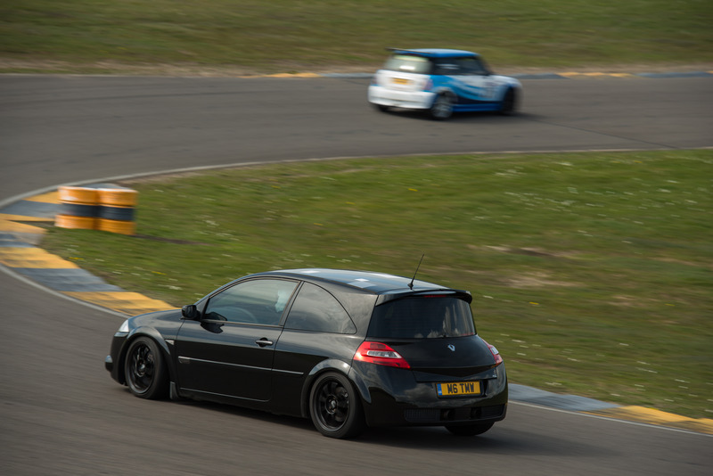

Did a track day earlier in the month. Killed the standard discs with the DS3000 so for next year I'll get some DS1.11 and 330mm discs.
Other things to do are get a R26 RARB setup and adapt it to fit the 225 beam, sort out the missing power.
Also consider getting some extra wheels are road wheels with some contisports as I wasn't happy with the NS2R in the wet. I wasn't confident in the car at all. Then I can replace the NS2R when their worn out with some DZ03G in the summer :)
Here are the pics anyway.

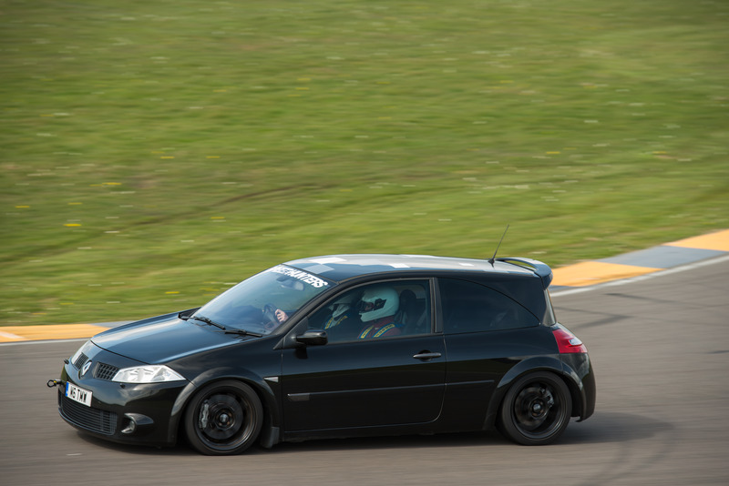

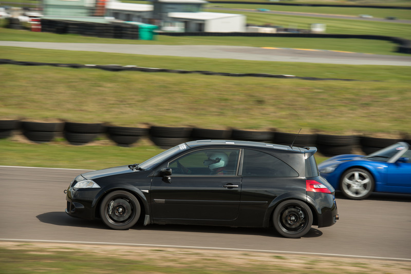

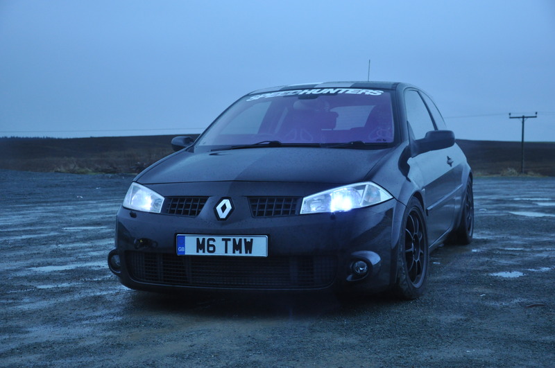

Not much to report other than the NS2R on a cold wet day are a bit scary when pushing on.
I changed my cheap battery for a Varley 25 and it starts well now.
Went for a run around the triangle and surrounding area as it's local.
And a shot of being cold and wet...

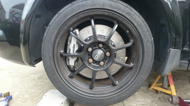

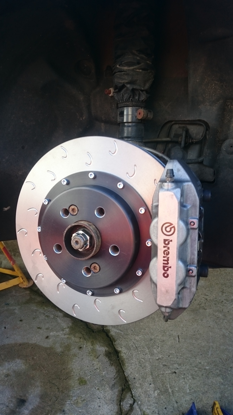

Fitted some DS1.11 pads with 330mm bells and rotors.
Behind my 17" Alleggeritas
And fitted new discs with bearings and pads on the rear. Also painted the callipers to match the fronts.
Brakes are strong!
Looking forward to the track day next weekend.
