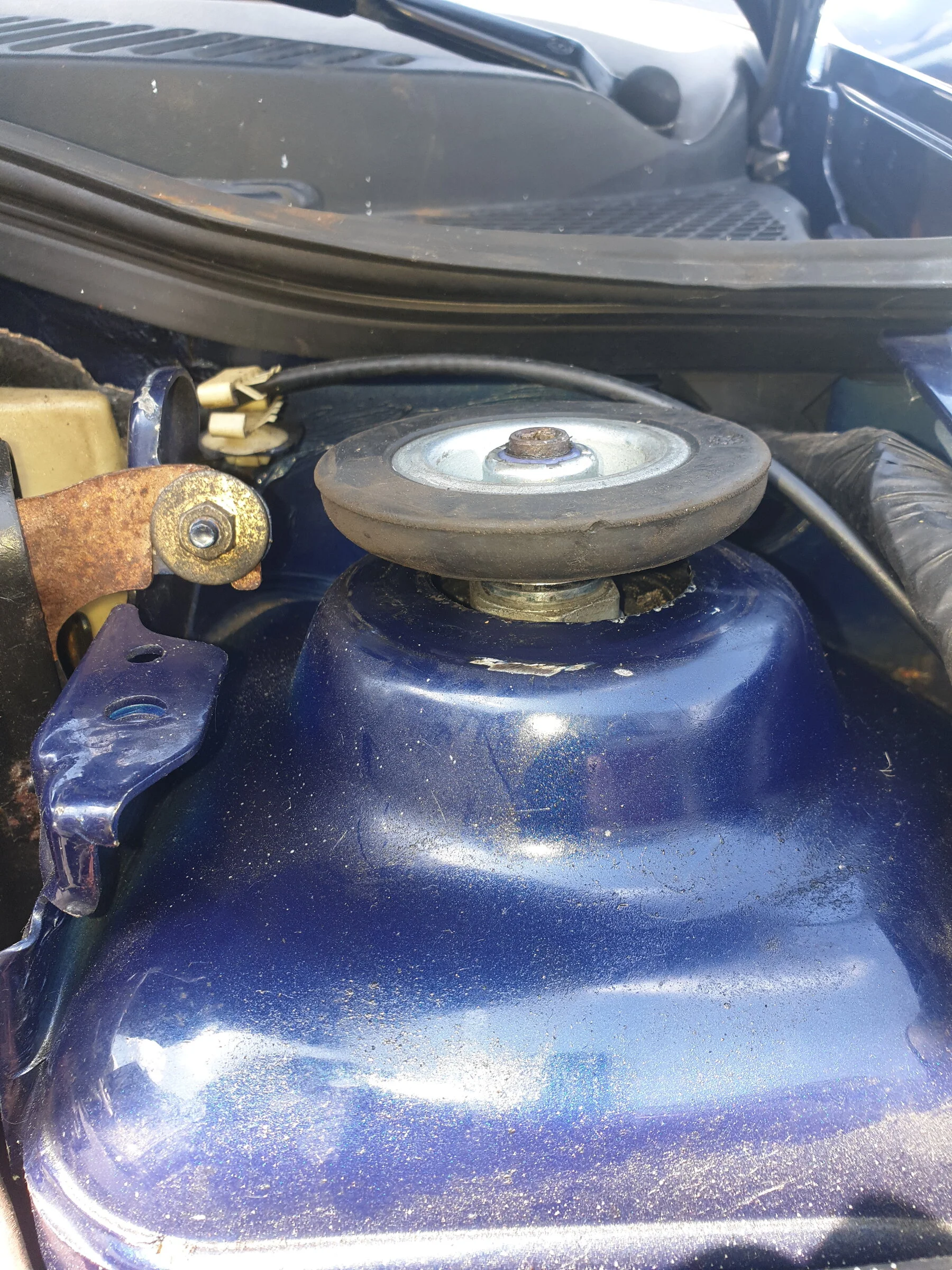

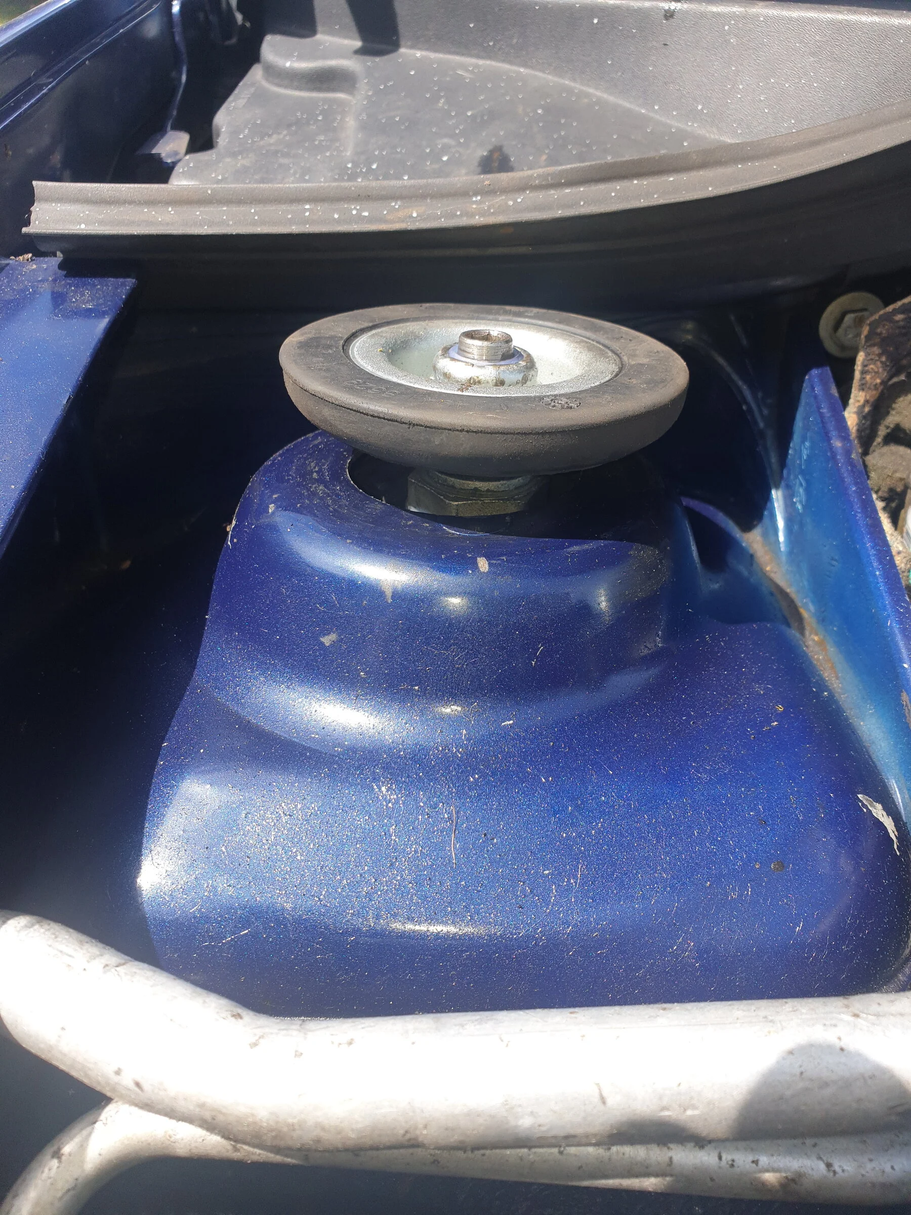

Fitted a new Febi topmount kit with the newer version combined nut/spacer, and now the top hats are sitting really a lot higher than I'd have thought was right.
Everything has been fitted in the correct order and the bearings are the right way round. Its standard cup shocks with Eibach springs.
Both sides are the same, theres no knocking and steering seems perfectly fine......it just doesnt look right 🤔
You don’t need the new spacer with the febi mounts. It’s only for the Renault ones as they changed them.

I had no spacer at all! I seems the previous owner used the top hat to secure it all so had it like this:
Spring
Spring top
Bearing
Top mount rubber
No spacer No securing nut
Top hat holding it all together.

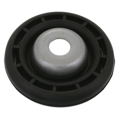

The Febri kit comes with the bearing, rubber doughnut and top hat, so I had to buy the nut/spacer from RPD as a separate item as it's not part of the kit
So there wasn’t a nut holding the spring cup on?
I’m afraid you’ll need a standard nut instead of one with the spacer built in to lose the huge gap, or buy Renault top mounts.

Ah, bugger. I couldnt find the original version of the nut through Renault which is why I ended up with the modified version 🤦‍♂️
