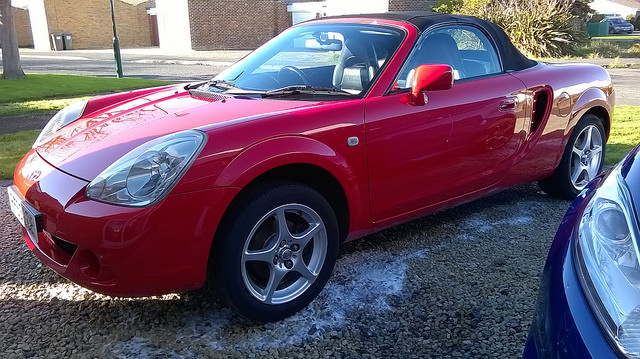

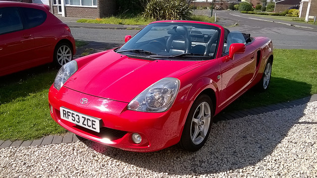

On Saturday I picked up the Saxo VTS replacement .
It’s a MK3 MR2 facelift that had the 6 speed gear box and does not suffer the engine problems like the first ones pre 2003 .
The car is in great condition with no to very little rust under the car and divers very well indeed .
I was looking at an MX5 but the problems with rust have just put me off and I like the MR2 better ( I did run a MR2 REV 3 Turbo )

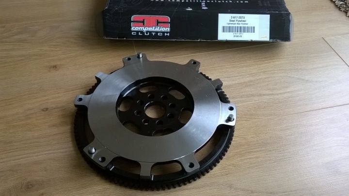

CC LIGHTWEIGHT FLY WHEEL 4.5 KG

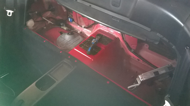

Fist things done have been to strip the car of some weight so removed has been the below
Wind deflector
Front storage trunk
Front mats
Sound carpet
Pop up aerial

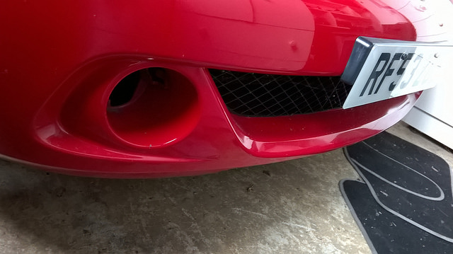

Fog lights
Mud guards
Storage bins and doors
Sound Tar stuff
Spear wheel
Tool kit
Jack
Exhaust Heat shield
Other plastic / metal bits and bobs
With this little lit removed I make it 35 Kg taken out of the car so with the stock weight at 975 Kg the car is now at around 940 Kg .
And a few photos of the work done .

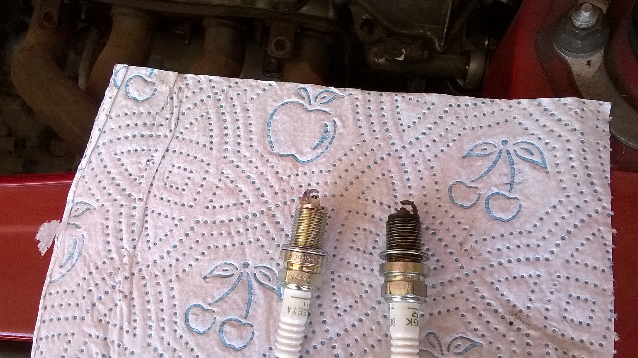

The only thing done other was a change of the old spark plugs .
WP_20170923_14_59_19_Pro[1] by Alan Kaveney, on Flickr

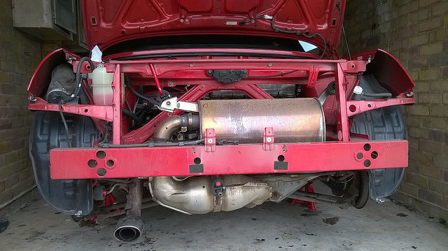

To gain access to the exhaust and other bits I removed the rear bumper to free up some room .
WP_20170930_12_59_40_Pro[1] by Alan Kaveney, on Flickr

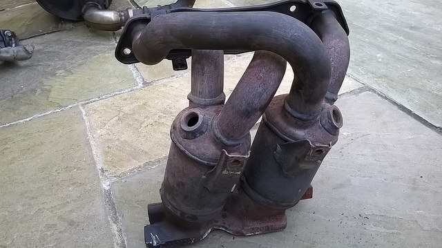

Then removed the manifold , cat and exhaust system .
WP_20170930_16_34_13_Pro[1] by Alan Kaveney, on Flickr

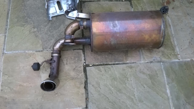

Old exhaust and manifold .
WP_20170930_16_35_34_Pro[1] by Alan Kaveney, on Flickr
WP_20170930_16_35_57_Pro[1] by Alan Kaveney, on Flickr

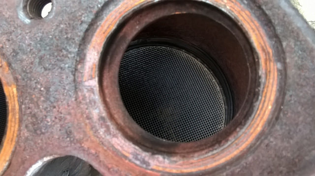

The problem with the pre cat manifold is that the cat structure can break down and be sucked back in to the engine causing damage so it was good to see they are all in tact .
WP_20170930_16_36_31_Pro[1] by Alan Kaveney, on Flickr

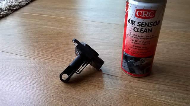

And to finish off I removed the MAP sensor and gave it a clean .
WP_20171001_16_13_21_Pro[1] by Alan Kaveney, on Flickr

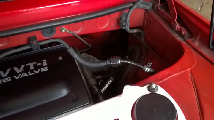

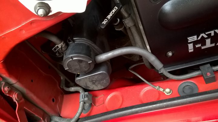

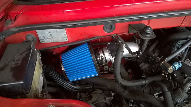

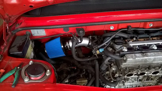

I installed my PPE induction intake that I got from the USA that sits behind the battery where the side air scoop is .
WP_20171007_12_55_53_Pro[1] by Alan Kaveney, on Flickr
WP_20171007_12_56_04_Pro[1] by Alan Kaveney, on Flickr

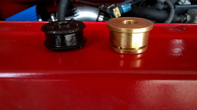

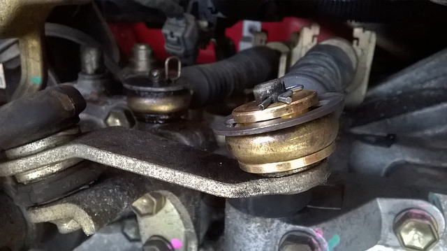

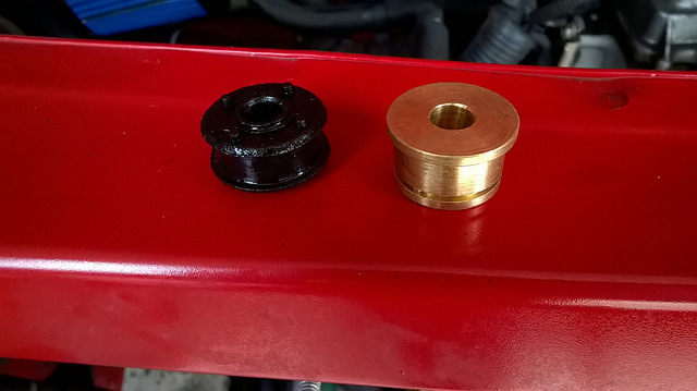

Then I change the shifter bush to solid brass units .
WP_20171007_13_08_45_Pro[1] by Alan Kaveney, on Flickr
Old OEM rubber and new brass unit
WP_20171007_13_09_56_Pro[1] by Alan Kaveney, on Flickr
WP_20171007_13_10_08_Pro[1] by Alan Kaveney, on Flickr
Installed
WP_20171007_13_17_47_Pro[1] by Alan Kaveney, on Flickr

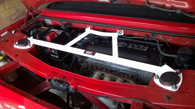

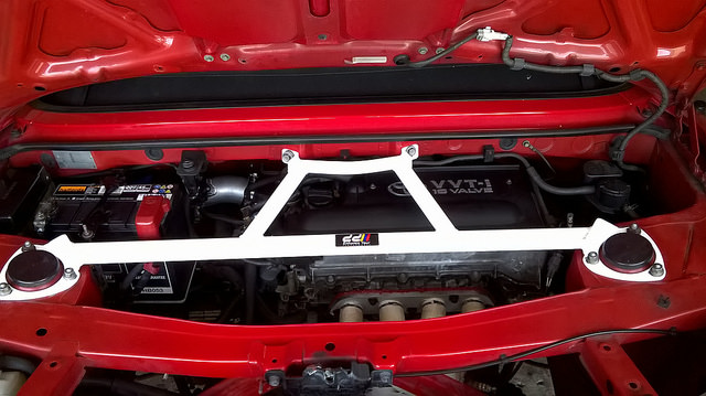

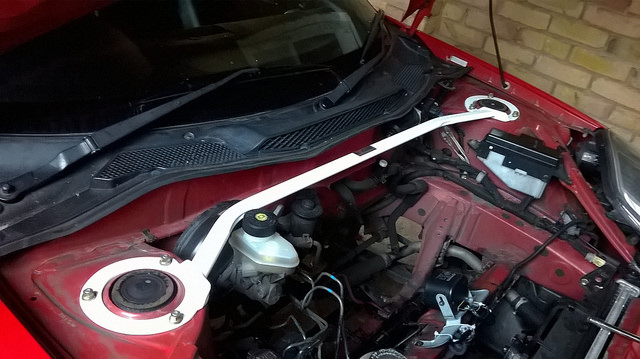

Then I fitted a front Ultra Racing strut brace
WP_20171007_14_34_18_Pro[1] by Alan Kaveney, on Flickr
WP_20171007_14_34_26_Pro[1] by Alan Kaveney, on Flickr

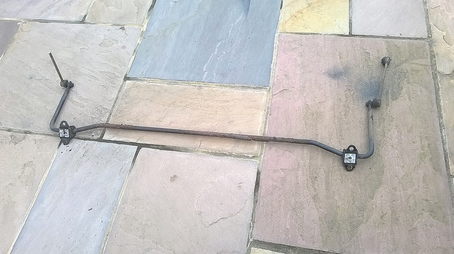

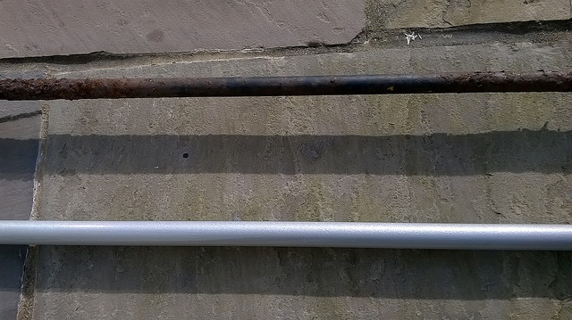

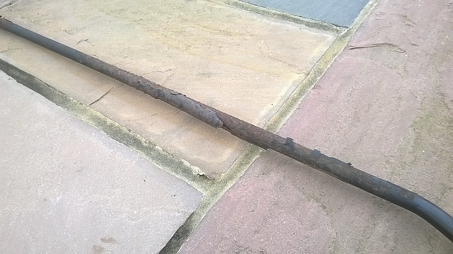

Then to finish off I remover the old rear ARB and drop links .
WP_20171007_15_12_46_Pro[1] by Alan Kaveney, on Flickr
WP_20171007_15_12_52_Pro[1] by Alan Kaveney, on Flickr

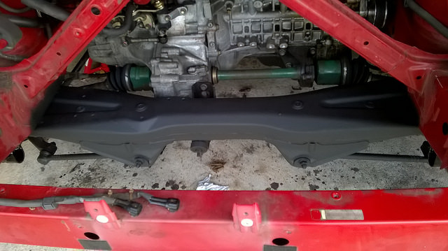

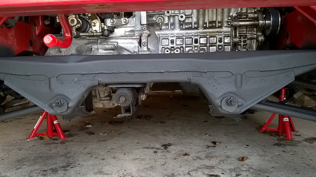

I got some more things done on the MR2 at the weekend .
I rubbed down and sprayed up the rear sub frame in black stone chip .
WP_20171015_16_32_33_Pro[1] by Alan Kaveney, on Flickr
WP_20171015_16_32_39_Pro[1] by Alan Kaveney, on Flickr

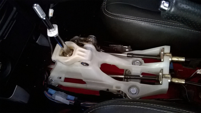

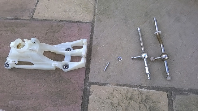

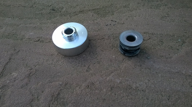

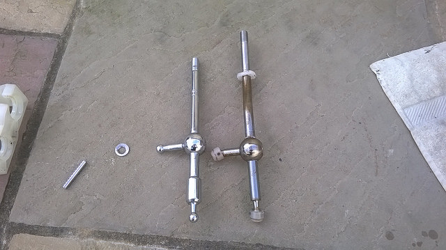

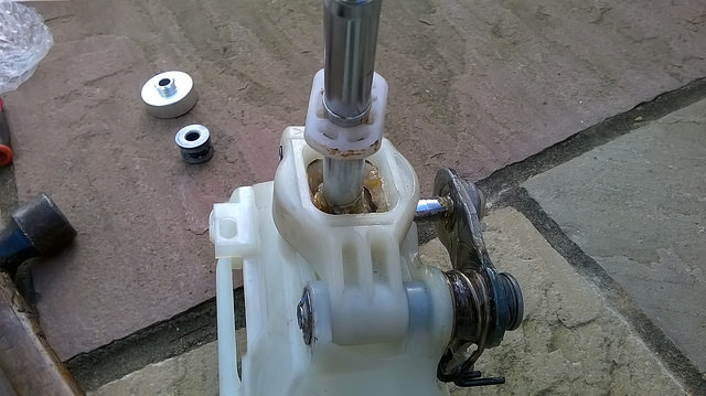

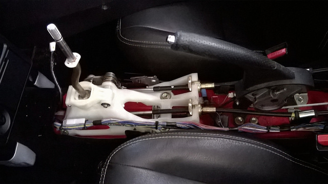

The it was on to install the short shifter with solid shifter bush .
Removed the cover and disconnected the shifter .
WP_20171014_14_12_14_Pro[1] by Alan Kaveney, on Flickr
Old and new shifter
WP_20171014_15_01_53_Pro[1] by Alan Kaveney, on Flickr
WP_20171014_15_02_05_Pro[1] by Alan Kaveney, on Flickr
Old warn rubber bush and new solid bush
WP_20171014_15_33_21_Pro[1] by Alan Kaveney, on Flickr
Installed and re greased
WP_20171014_15_33_32_Pro[1] by Alan Kaveney, on Flickr
Installed and working very well with a nice solid short shift action
WP_20171014_16_39_29_Pro[1] by Alan Kaveney, on Flickr

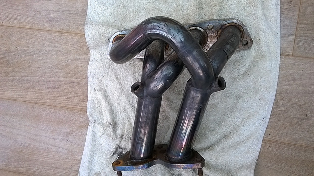

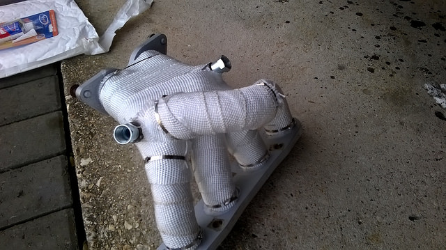

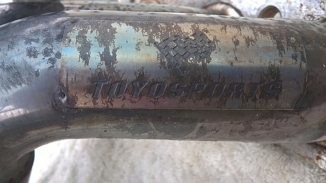

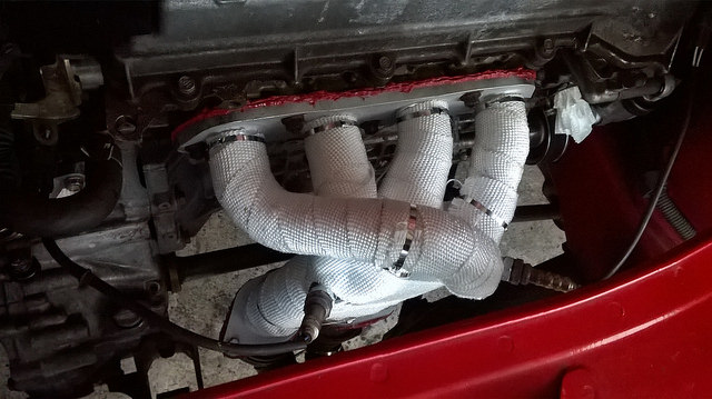

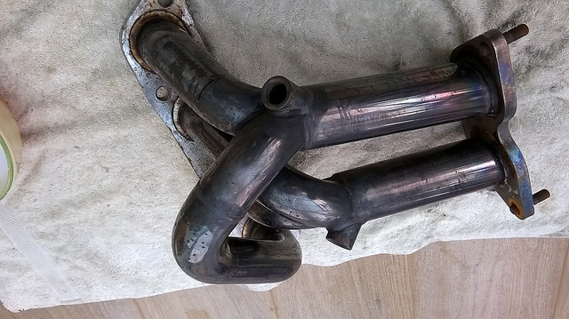

I won a Toyosports manifold on bay so gave it a bit of a clean and will heat wrap it before installing .
WP_20171014_10_55_52_Pro[1] by Alan Kaveney, on Flickr
WP_20171014_10_55_46_Pro[1] by Alan Kaveney, on Flickr
WP_20171014_10_55_32_Pro[1] by Alan Kaveney, on Flickr

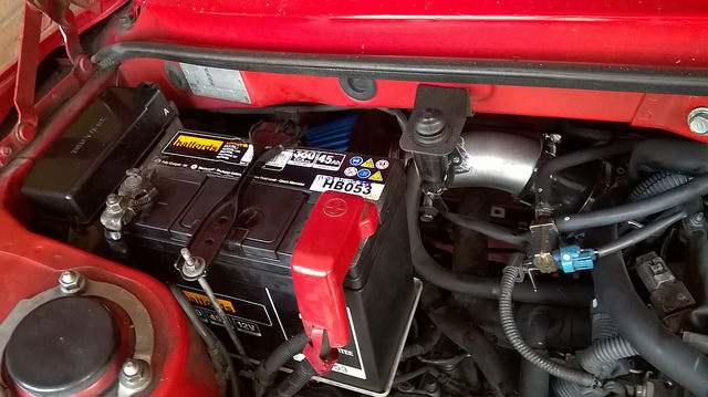

And to finish up I installed the battery back in the car that sits just in front of the PPE induction .
WP_20171015_16_46_31_Pro[1] by Alan Kaveney, on Flickr

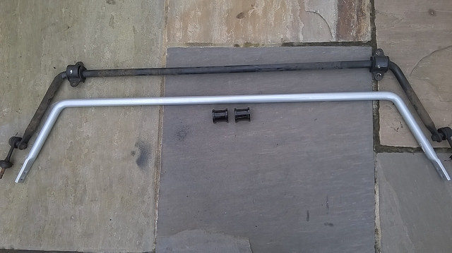

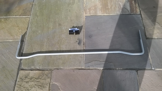

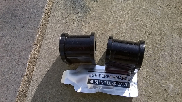

Rear Whiteline ARB installed with new bush .
WP_20171028_12_53_49_Pro[1] by Alan Kaveney, on Flickr
WP_20171028_12_54_05_Pro[1] by Alan Kaveney, on Flickr
Thicker new vs old .
WP_20171028_13_05_50_Pro[1] by Alan Kaveney, on Flickr

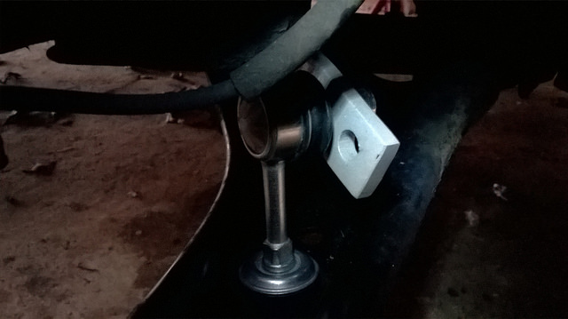

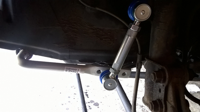

HD drop links .
WP_20171028_13_25_05_Pro[1] by Alan Kaveney, on Flickr
And installed .
WP_20171028_13_30_30_Pro[1] by Alan Kaveney, on Flickr

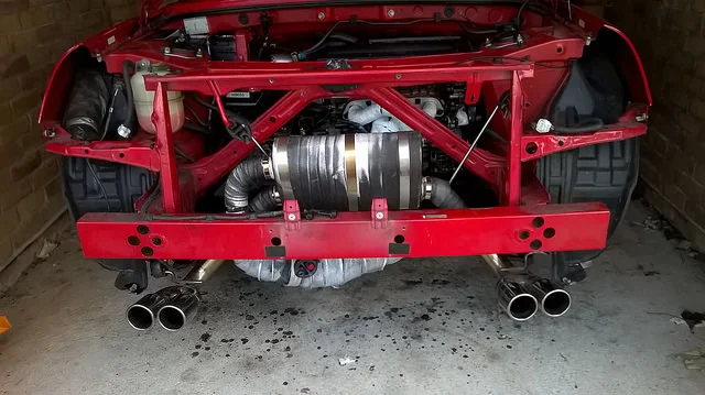

Manifold all heat wrapped and O2 spacers installed
WP_20171028_12_23_20_Pro[1] by Alan Kaveney, on Flickr
WP_20171028_17_30_04_Pro[1] by Alan Kaveney, on Flickr

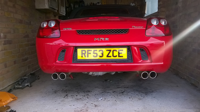

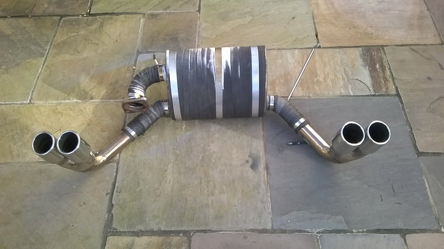

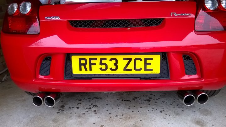

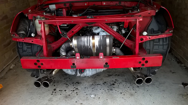

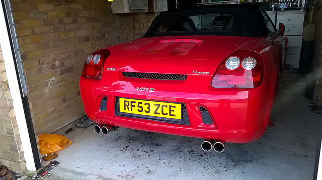

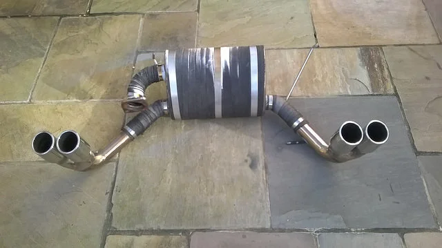

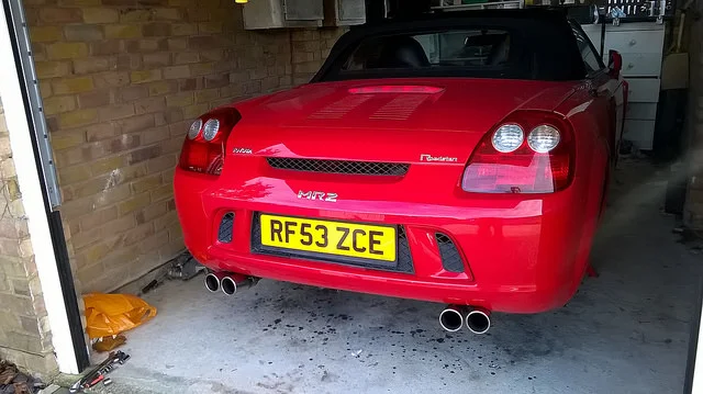

Cobra exhaust ready to be installed .
WP_20171028_15_16_54_Pro[1] by Alan Kaveney, on Flickr
And installed .
WP_20171028_17_29_49_Pro[1] by Alan Kaveney, on Flickr

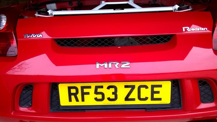

At the weekend I finished off all the bits I was planning to do before the end of the year for its stage 1 before I put the car back on the road and do my first track day in it .
Rear bumper back on
WP_20171104_13_49_34_Pro[1] by Alan Kaveney, on Flickr
WP_20171104_13_49_28_Pro[1] by Alan Kaveney, on Flickr

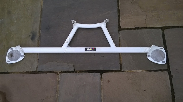

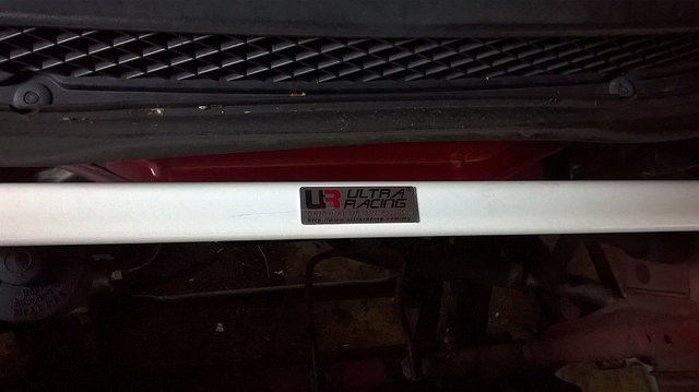

Rear strut brace installed
WP_20171104_12_43_43_Pro[1] by Alan Kaveney, on Flickr
WP_20171104_13_28_58_Pro[1] by Alan Kaveney, on Flickr
WP_20171104_13_29_08_Pro[1] by Alan Kaveney, on Flickr

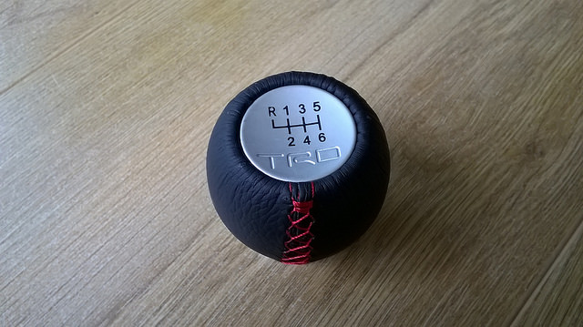

New TRD gear knob
WP_20171104_14_13_33_Pro[1] by Alan Kaveney, on Flickr

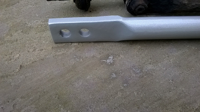

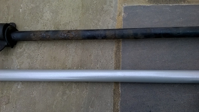

Front thicker whiteline ARB old vs new
WP_20171104_14_54_22_Pro[1] by Alan Kaveney, on Flickr
WP_20171104_14_54_27_Pro[1] by Alan Kaveney, on Flickr
WP_20171104_14_54_32_Pro[1] by Alan Kaveney, on Flickr

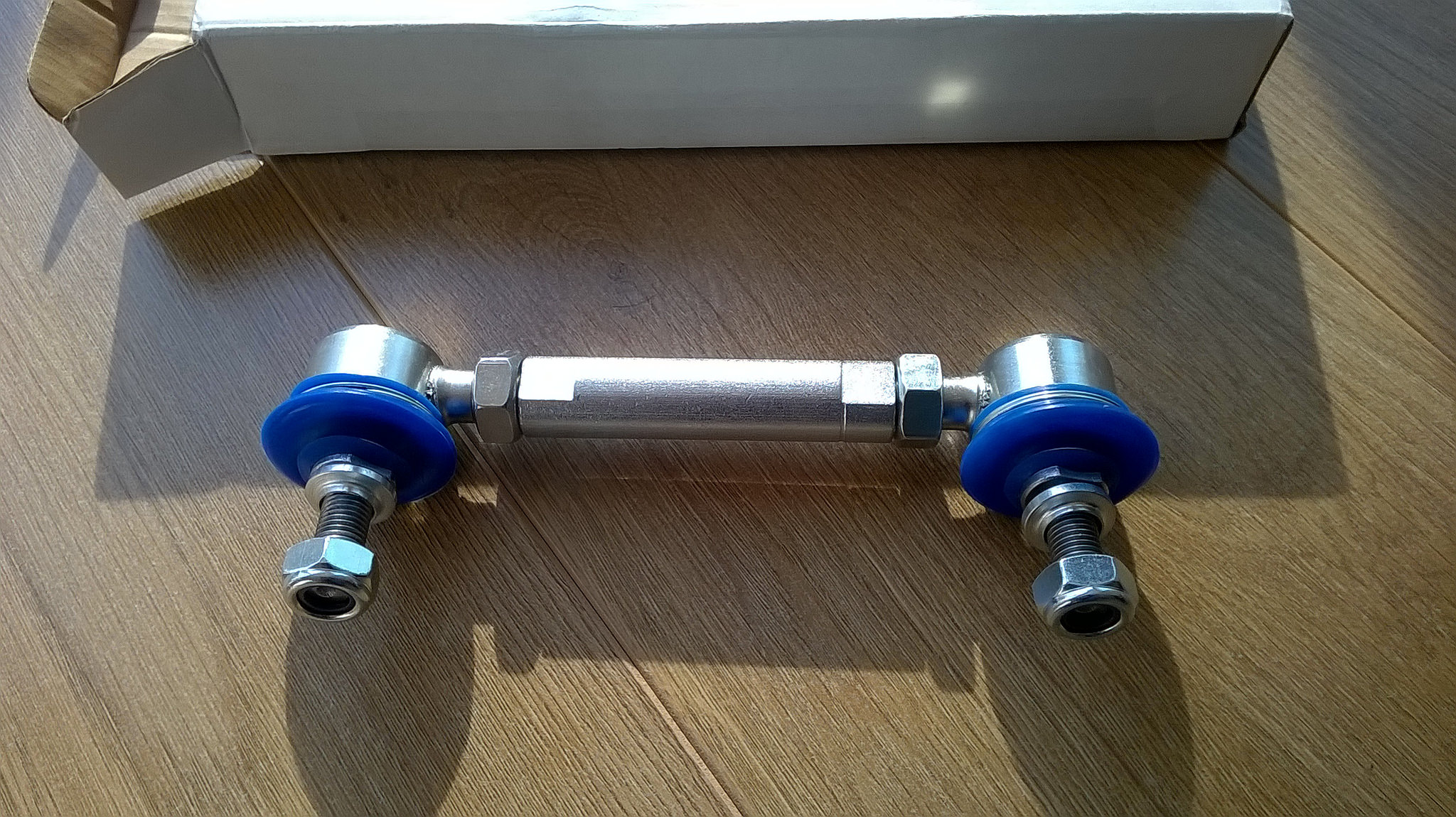

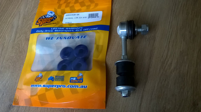

New front drop links with Super pro upgraded bush
WP_20171104_15_20_41_Pro[1] by Alan Kaveney, on Flickr
And installed
WP_20171104_15_33_18_Pro[1] by Alan Kaveney, on Flickr

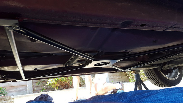

Matt performance under chassis brace

Then a quick wash and clean up .
WP_20171112_12_54_26_Pro[1] by Alan Kaveney, on Flickr
And one with my road car .
WP_20171112_12_55_06_Pro[1] by Alan Kaveney, on Flickr
Gave the car a drive up the road to check everything and there is good and bad news .
Good the car driver and feels really good and tight and I know will be great fun on track even with only a few upgrades on the car .
Bad the clutch is now slipping and will need changing before I can drive the car again but this does give me a good excuse to fit a light weight flywheel .

Brake pads , fluid lines discs
Coilovers

Ok I have read that the engine swap is not to hard but then problem come after that .
I have already removed the below weight so the car should be around the 900 Kg mark .
SPEAR WHEEL 12KG

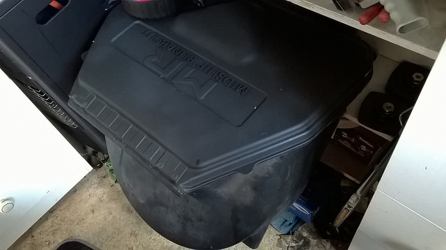

SPAR WHEEL BIN AND LID 5KG
TOOL KIT 3KG
REAR STORAGE BINS 6KG
FLOOR MATS 2KG
WIND DEFLECTOR 1KG
EXHAUST HEAT SHIELD 1KG
EXHAUST SPLASH BOTTOM SHIELD 1KG
FOG LIGHTS 1KG
OLD EXHAUST MANIFOLD WITH PRE CATS 3KG
MANIFOLD HEAT SHIELD 1KG
OLD STOCK CAT AND DOWN PIPE 4KG
OLD EXHAUST SYSTEM 4KG
REAR STORAGE SOUND COVER 2KG
AREIL 2KG
SOUND TAR 3KG
ECU PLATE 1KG
STUFFING FOOT WELL 1KG
MANIFOLD BRACKET 3KG
STRUT BRACE PLATES F / R 1KG
REAR BUMPER BARS 1KG
DRIVER AND PASSENGER AIR BAG 7KG
LIGHTWEIGHT FLYWHEEL 5KG
SPORTS CAT 4KG
TOTAL WEIGHT REMOVED 74KG

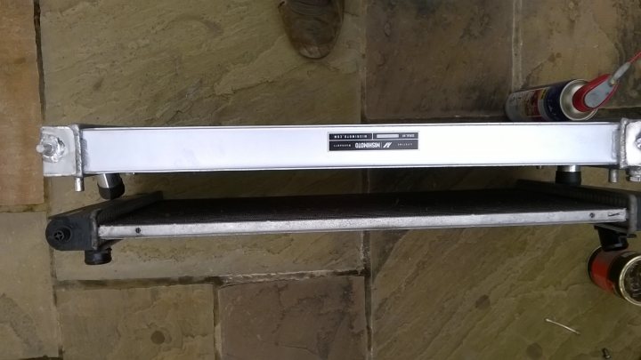

So after 5 months of the car sitting in the garage under a cover I at the weekend started to crack on again and fit a few bits .

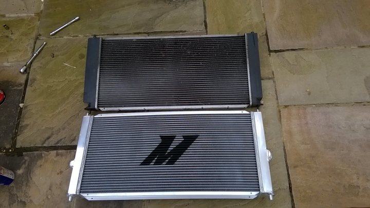

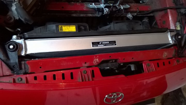

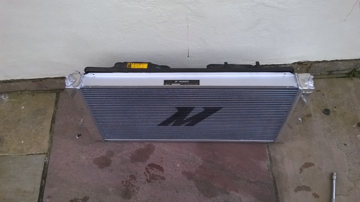

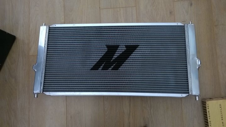

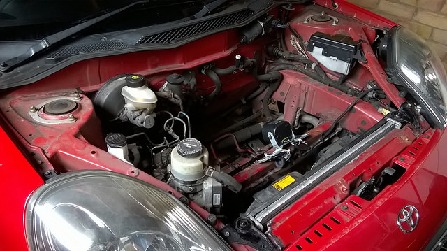

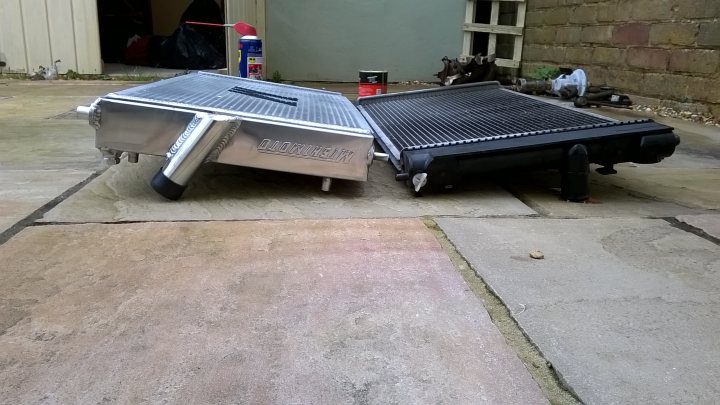

First up was a Mishimoto aluminium radiator that I have had sitting in the shed for months ready to fit .
Old stock rad vs the new Mishimoto unit that is 3 times bigger and will keep the car cool on track not that the stock rad is that bad .
Stock fan attached to the new rad
And installed . I did have to cut the slam panel so the new bigger unit would fit in .
Then some new coolant and bleeding of the system .

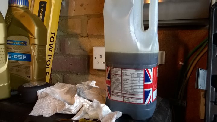

First was to change out the old power electric steering fluid that was looking a bit old and dirty .
Old fluid .
New Ravenol fluid .

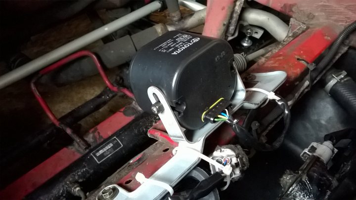

Then on to some more weight saving so out came the alarm siren .
Then the charcoal filter came out replaced with some fuel pipe .
Then to just tidy up the rear a bit as I don’t like the big MR2 badge so this got removed .

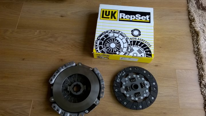

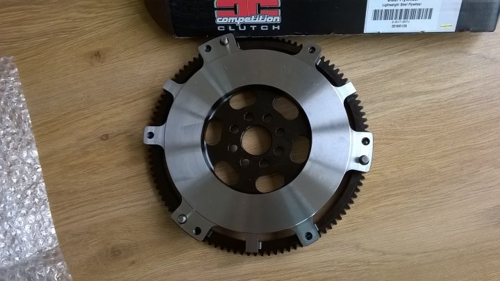

The clutch started slipping at the end of last year so a new LUK unit will be installed .
As I’m doing the clutch a competition clutch light weight flywheel will be installed and is 4.5 Kg ( stock flywheel is 7.5 Kg )

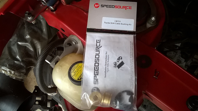

And then some new MT-90 gearbox oil .
Next up will be getting the car back on the road so MOT tax and insurance before Brands Hatch .

Flywheel will be the best mod you do :up:
I do read this a lot and with sticking with the 1ZZ engine this year it will help make the best of what its got .
I have never had a light weight flywheel so im I correct in saying that it will make the revs go up and down quicker ( like 3 gear feeling like second with regards to how quick it revs with a light weight flywheel )
Have you had one on a car before ?
