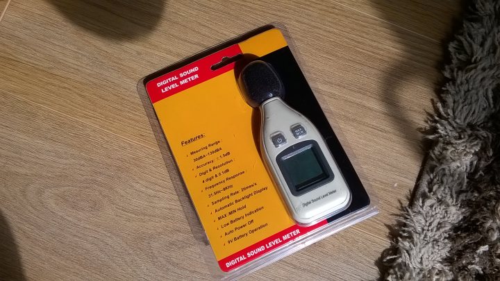

I will be doing a track day at Brands Hatch in May but im unsure on the Noise the car is making .
The car has a Cobra quad exhaust system , 100 cell sports cat , toyo sports de cat manifold so does anyone know what noise level I will be at as the car does not sound that loud .
Brands hatch have a limit of 105Dba .
Also I only have an open face helmet so do I need a full face helmet as I have been reading you do .
Regards
I got a few more bits done at the week end .

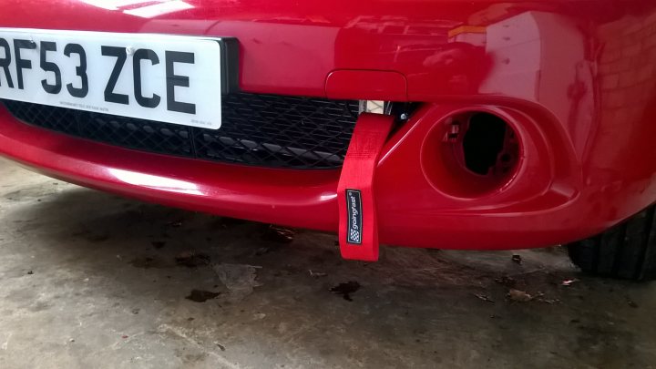

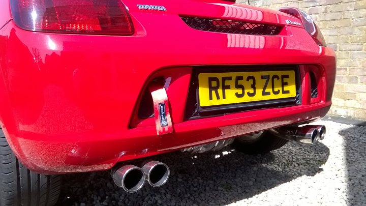

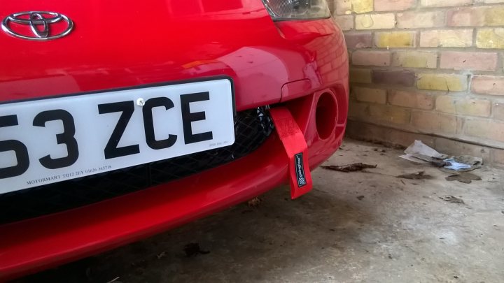

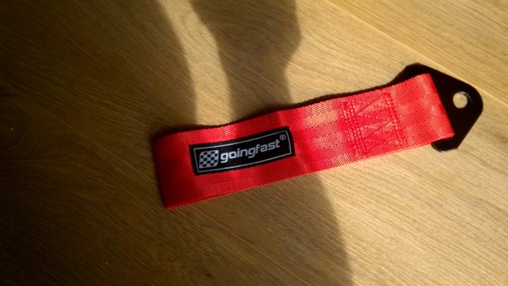

I fitted a towing strap to the front of the car .
Then I checked the noise level and it is at 79 dB

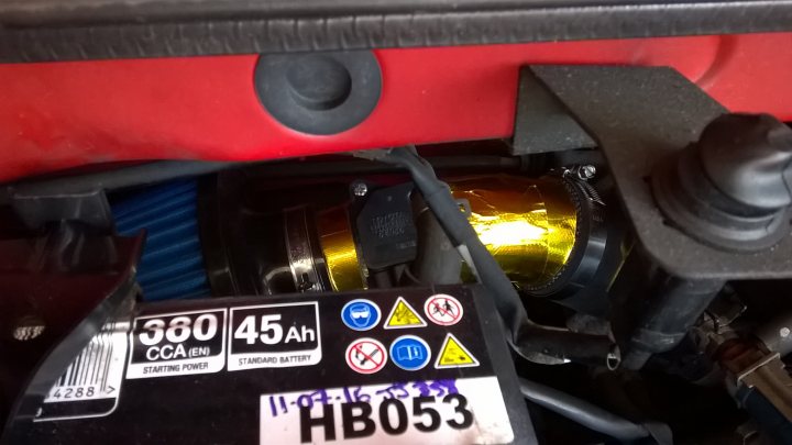

Then as I had some gold heat reflective tape left I used this on the induction pipe .

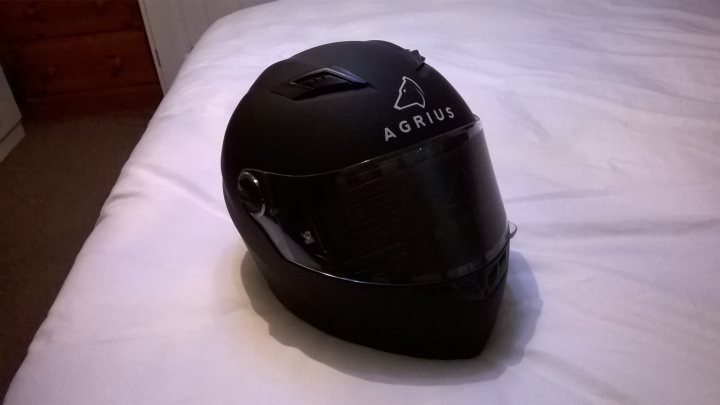

And to finish off as the car is a soft top you need a full face helmet so my OMP open face helmet will be no good so I purchased a Agrius one .

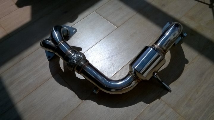

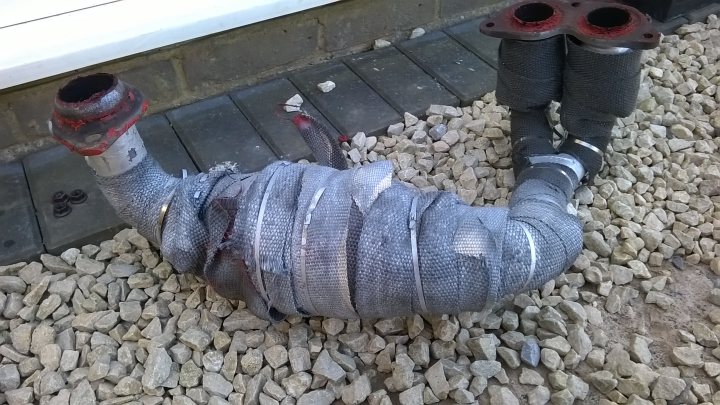

First up was to install a 100 cell sports cat
Old cat
The old cat I will put back in next year for the MOT as I don’t think the 100 cell unit will pass .

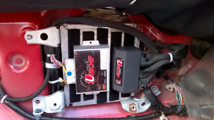

I then installed a Destak unichip that plugs in to the ECU as a piggy back unit .

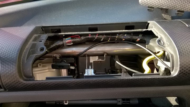

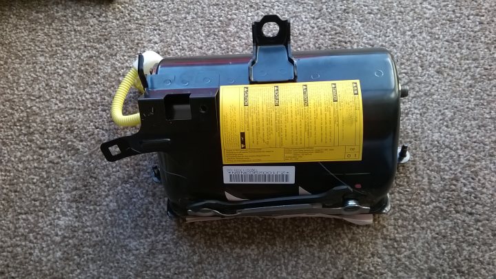

Then removed the passenger air bag but retained the top cover so all looks stock and no big hole in the dash .

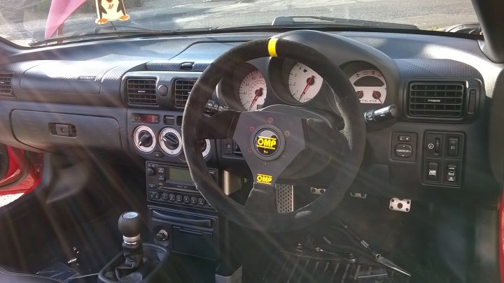

Then changed out the steering wheel for a OMP 300mm unit .
Next was to install the rear towing strap .

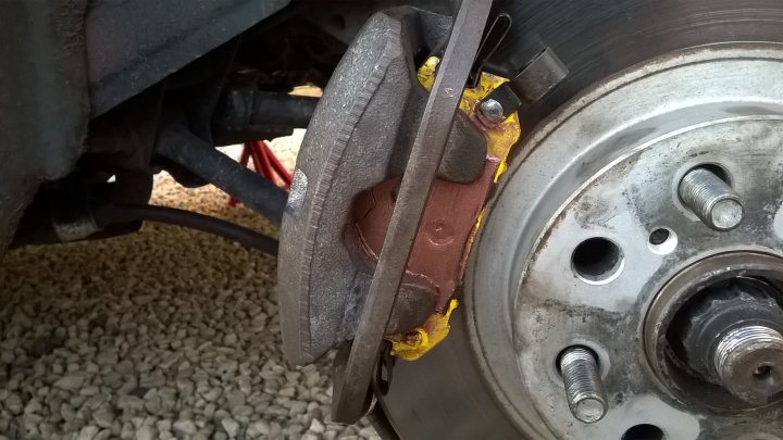

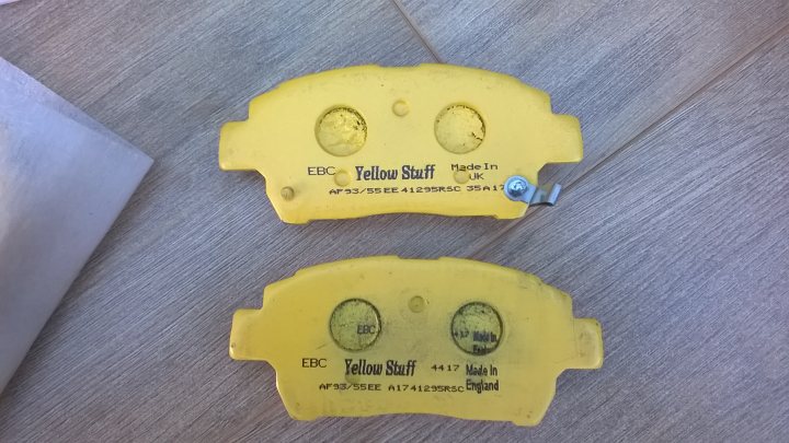

Then on the changing the rear brakes for some EBC yellow stuff pads and re greasing the sliders pins .

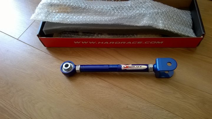

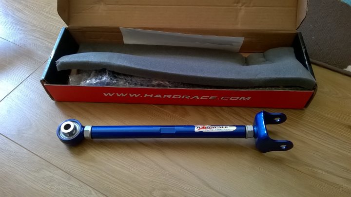

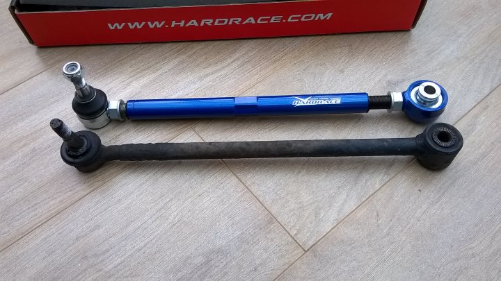

I have Ordered replacement Hard race rear control arms that will be in tomorrow and some braded brake lines and RBF660 fluid that should be in on Monday but it will be a mad dash to get every thing finished off in time .
Nothing like some last minute problems to get you excited 

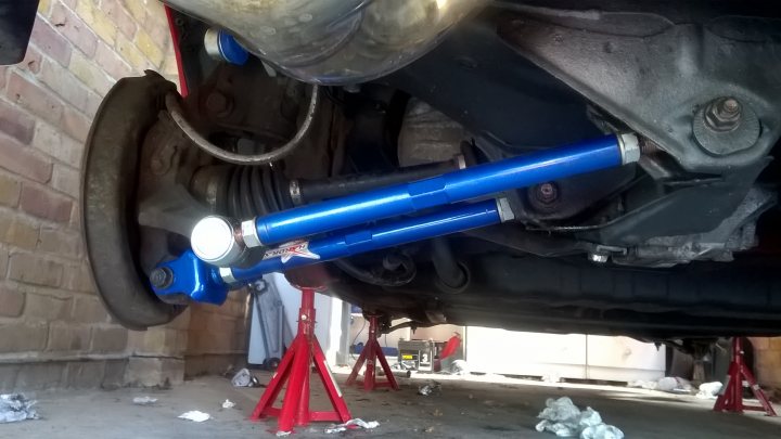

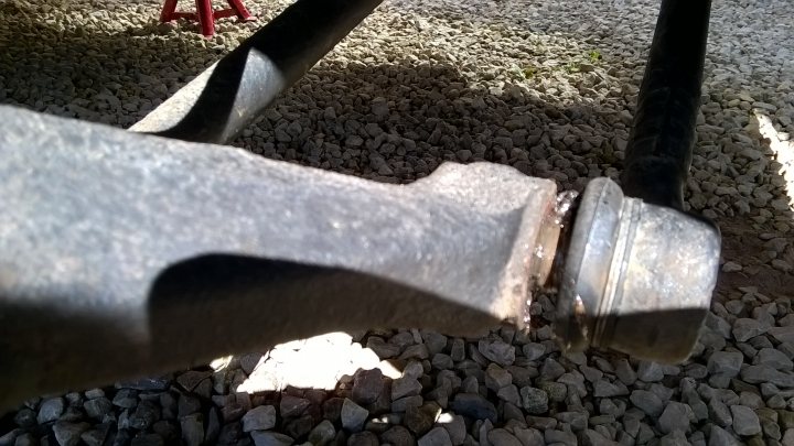

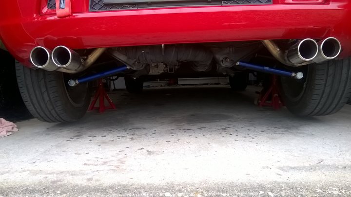

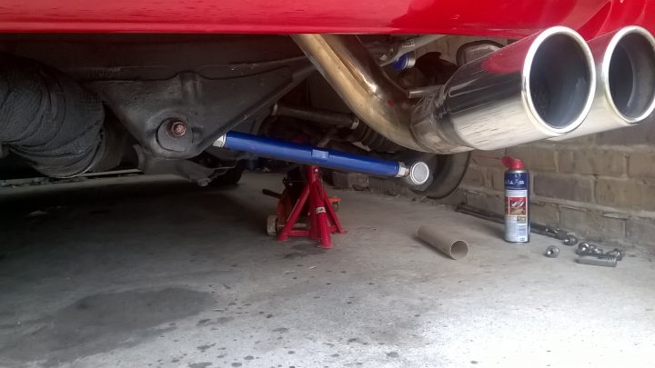

So with only three dyas until Brands Hatch track day the new rear control arms arrived just in time .
New Hardrace adjustable rear control arms
Old and new
And installed
Car now drives spot on again but could do with a tracking set up .
I fixed the Idle air control valve with a good clean out and now the idle is spot on again .

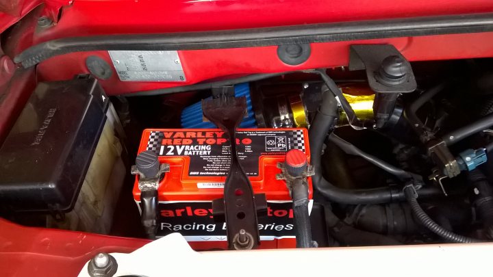

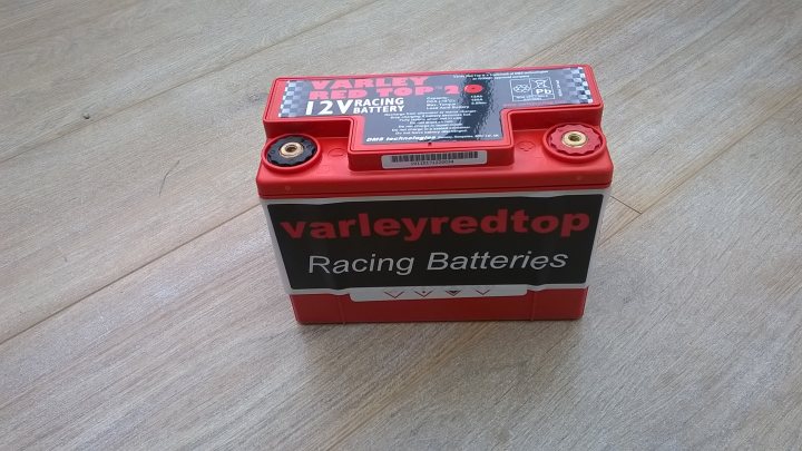

I also install a Varley Red top race battery ( 5 Kg vs the OEM 13.3 Kg unit )
I also installed the front EBC Yellowstuff pads and re greased the front slider pins .

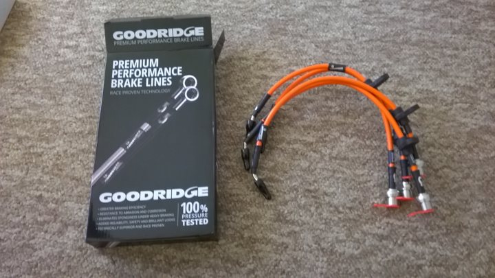

I have coming today some Goodridge braided brake lines to go along with the Motul RBF 660 to finish off the car so far .
So it looks like I will make Brands Hatch after all but it would have been better if everything had gone more straight forward but where would be the fun in that .

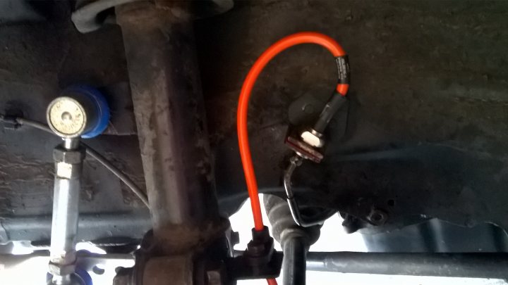

My Goodridge braded brake lines arrived and I was going to fit them last night and do a brake fluid change and flush for the Motul RBF 660 .

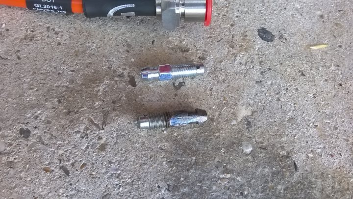

Three bleed nipples came off / open fine but the last one was rounded off and the first line I tried to remove for the brake pipes was not going anywhere so I thought it best to pack up and call it a day as a snapped pipe / nipple would mean not making Brands Hatch tomorrow so I will have another go with some heat and other tricks at the week end after the track day .
I did manage to bleed the three other corners of the car with the Motul RBF 660 so at least there is some good fluid in there .

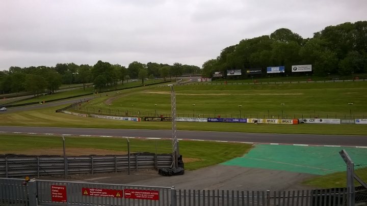

So did the first track day of the year at Brands Hatch for an evening session in the MR2 and below is the report of how the session went with some good and bad points .
It is about an hour from work and the Mrs met me at work and we had a quick stop to get some food and a coffee .
We then got to Brands Hatch and signed on and did a noise test ( 94DB )
Looking at the other cars there I would class us in the slower category at this stage as there were some very nice cars there .
After the safety briefing we had two sighting laps and what a great track this is with some great turns and undulation going up and down .

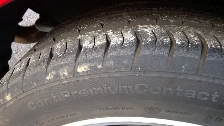

As said before the car is only 50 % finished and is running stock eco tyres and 15 year old stock suspension .
After one lap it was clear that the tyres were totally out of there depth and loosing grip very quickly so I had to be very gentle on the throttle as slip was very easy to get in to with too much throttle .

So to sum up it was a great track session and the car felt great up to a point but was hampered by the stock suspension & tyres so it will be good to go back with the car finished off to see how it gets on them as I think it will be much better and a lot quicker .
Last pic of the destroyed road tyres 

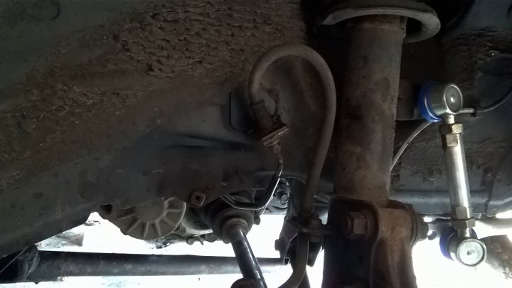

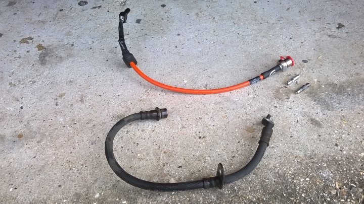

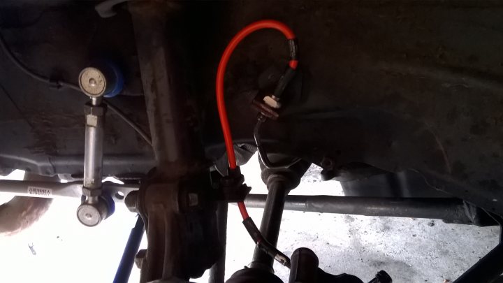

At the weekend I had another go at installing the Goodridge brake lines as last time there were not coming off at all .
New Goodridge braded brake lines .
Old and new
One of the bleed nipples was rounded and stuck on but with some p oil and some heat and a bit of filing it came out without snapping .

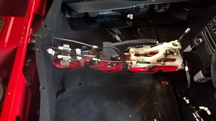

I also adjusted the handbrake cable as it was 10 clicks to clamp on and now at 5 clicks .

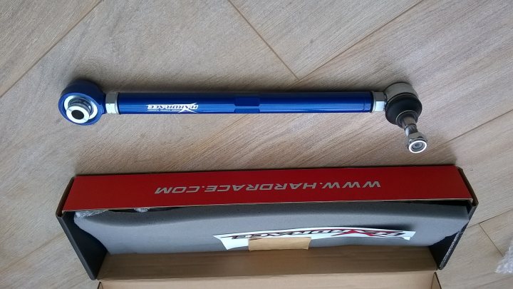

At the weekend I got some time to fit some of the new parts to the car .

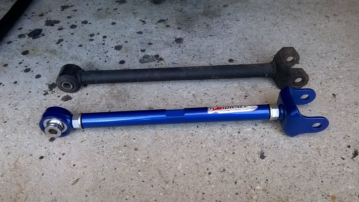

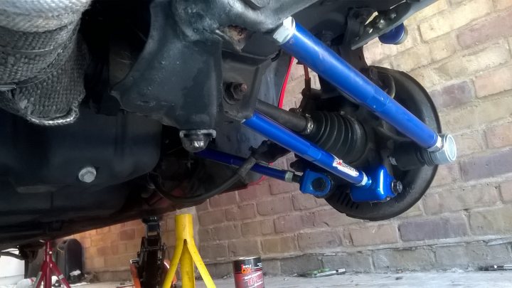

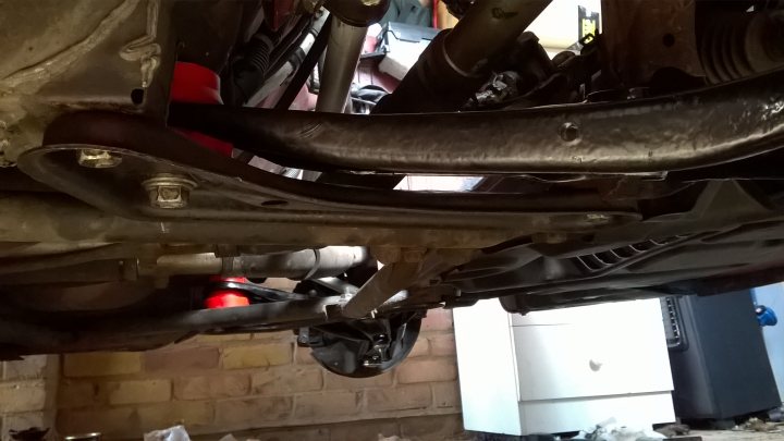

First up was the rear trailing arm and rear lower arm .
I replaced them with some Hardrace uprated units
New vs old
And installed

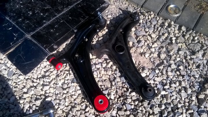

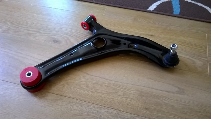

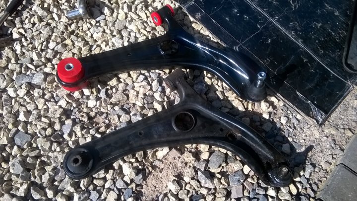

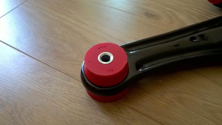

Next was to replace the front wishbones with new uprated units .
New pollybush units
New vs old
Installed

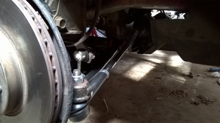

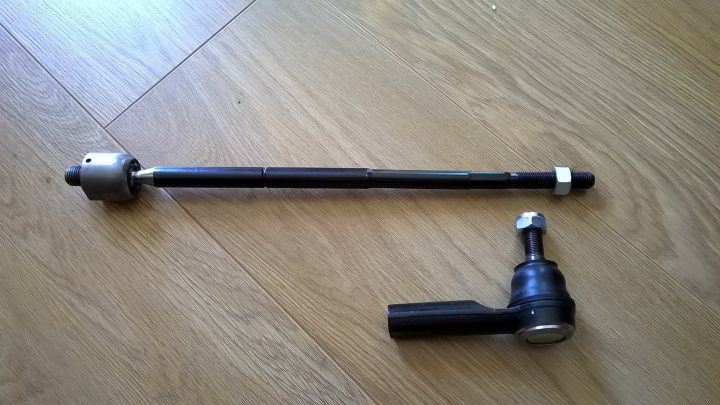

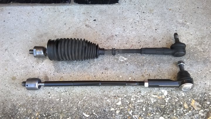

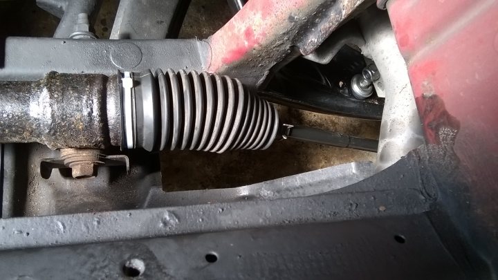

Then it was on to the front inner and outer tie rods and track rods .
New unit .
New vs old
And installed

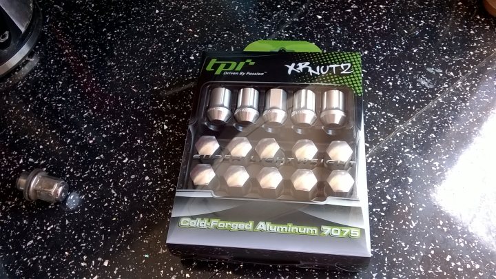

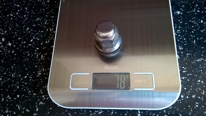

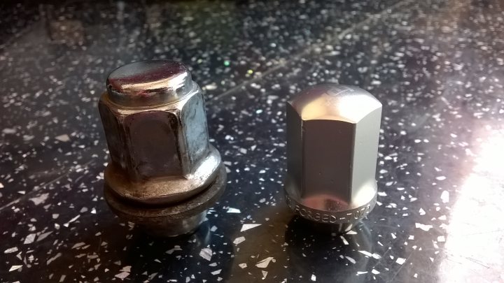

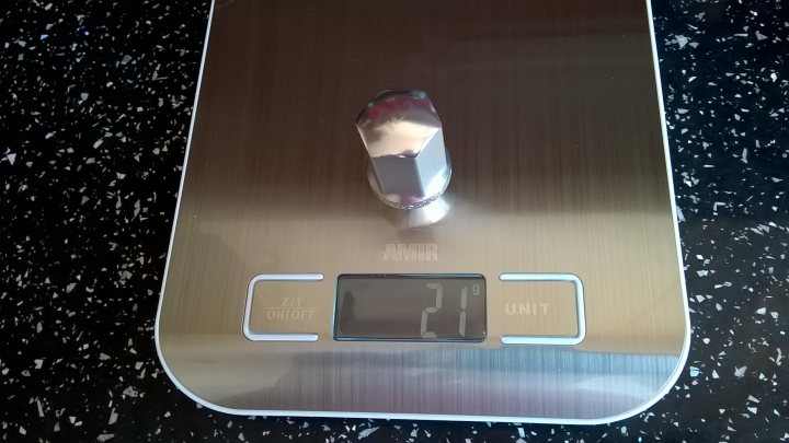

I also got some TPI lightweight wheel nuts ready for the new wheels and looked to see how light they were vs the OEM units .
OEM vs TPI
OEM nut
TPI nut
So that is just under 1 Kg saving of un sprung weight
And now the post man had just delivered some more shiny stuff
Nice - just got one of these myself. What boss did you go for if you dont mind me asking? Heard a lot of them mess with the self cancelling @mr bognor
I got the Momo unit and it fits fine but there is no mounting for the horn or any self cancelling for the indicators so think you may be restricted in your options .
Is your one std at the moment ?
Ah. Expensive as well for it to not be plug and play. Does it come with the airbag resistor? I thought the self cancelling thing was the yellow plug which goes through into the boss.
Its standard apart from a stainless catback. Just bought some Tein springs and long term planning to 2ZZ. Love to drive it though.
My one did not come with that yellow plug ?
Its not too much of a problem as I will put the OEM steering wheel back on for MOT time next year .
