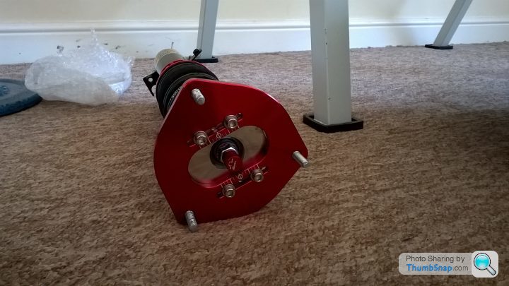

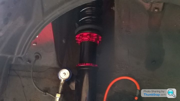

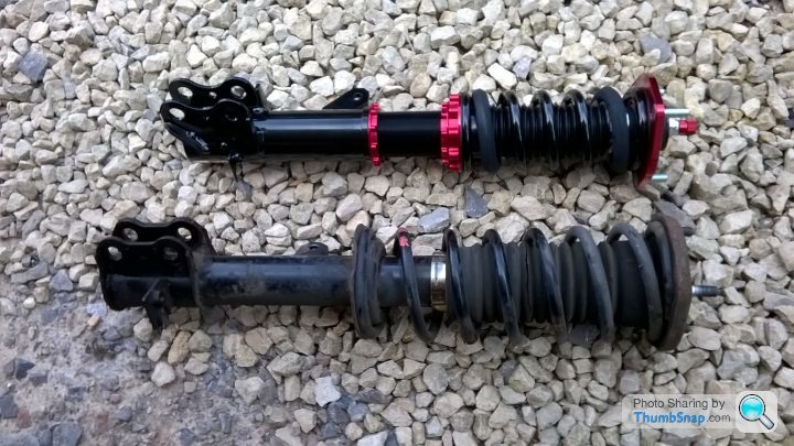

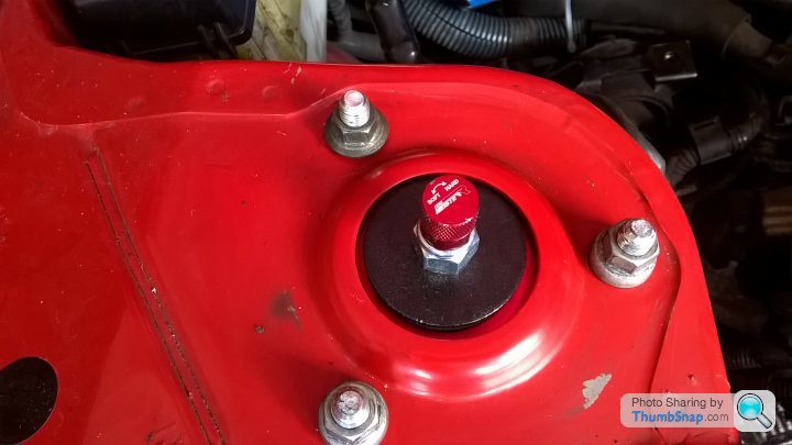

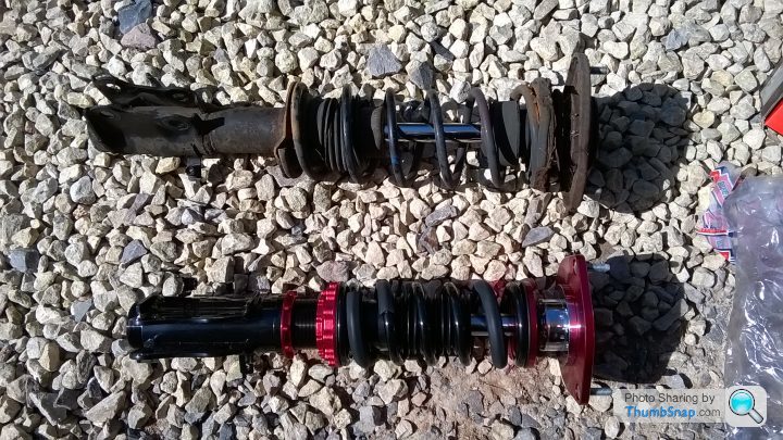

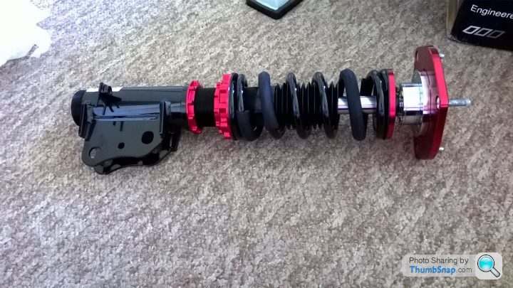

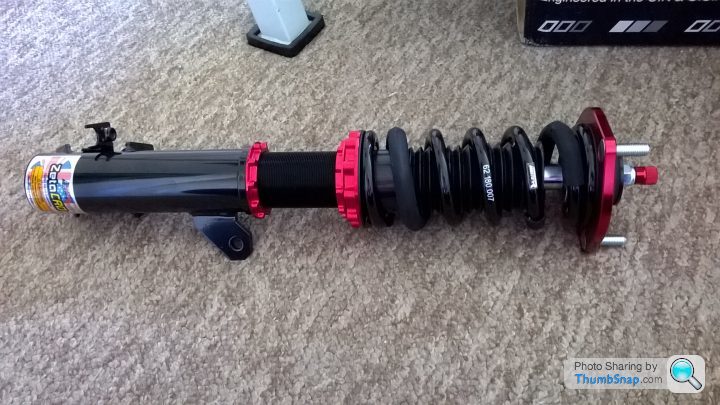

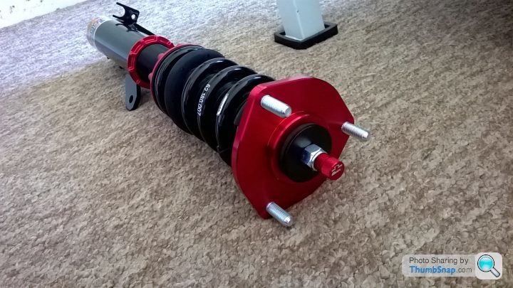

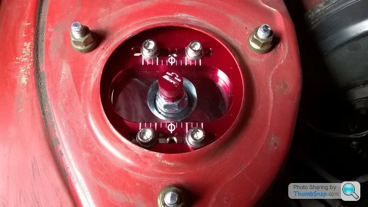

So another weekend and more new parts put on the car this time in the form of some new and shiny Meister R Zeta CRD + coilovers .

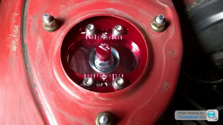

The front units have adjustments for height and damping as well as camber adjustment and pillow ball bearings .

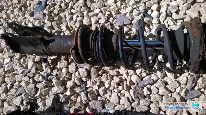

Removal of the old units was nice and simple and gave me chance to have a look at the strut pillars and like the complete car there is no rust and they are in great condition .
The old unit are 15 years old and are looking a little tired and have some rust on the springs and mounts .
Old unit
Old Vs new
Front installed
Rear installed

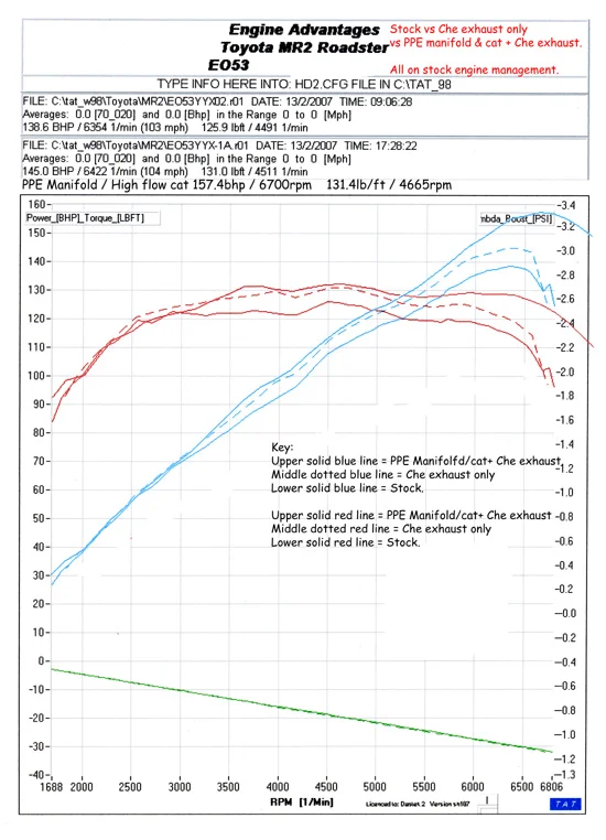

I have been doing some thinking about the 2ZZ plan and have two options I think as if I go for the 2ZZ I will only want to have this done by a tried and tested garage that has done a few conversions and the only one is Rogue Motorsport .
I have got a quote for a full 2ZZ conversion along with the gearbox swap and it come in at £ 4,675

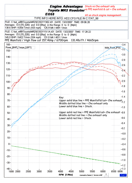

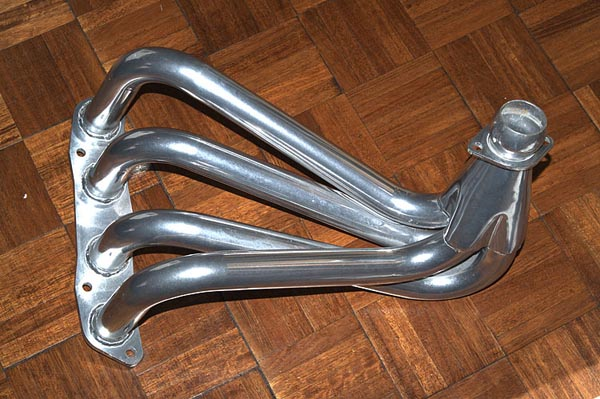

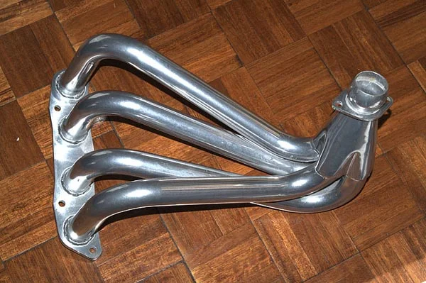

Option two would be to keep with the 1ZZ and look at the PPE 4-1 manifold + sports cat that should see around 160 BHP from the 1ZZ lump and this is £ 850 delivered from the USA .
I think option tow will be better as I have already spent way over what I was planning on the car and a MR2 roadster with 160BHP and 900 Kg kerb weight should still be respectable .

Dyno chart from another MR2 owner with the PPE 4-1 exhaust manifold so some good gains and a lot cheaper than the 2ZZ conversion .

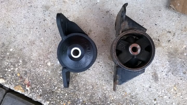

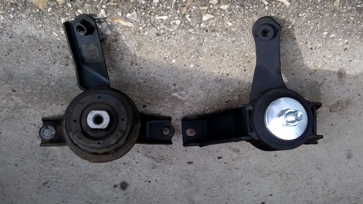

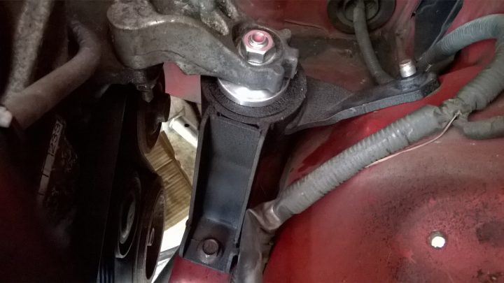

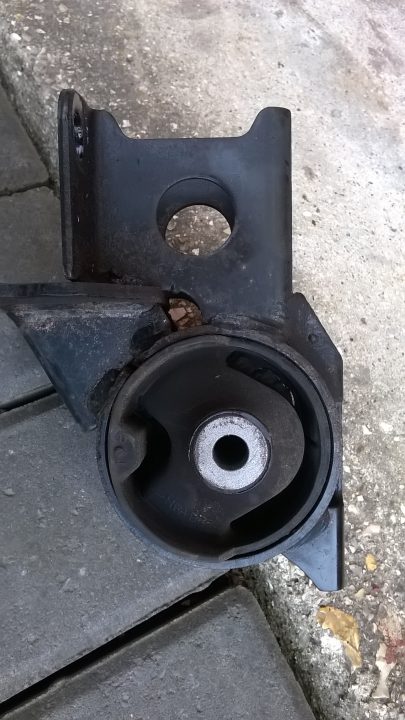

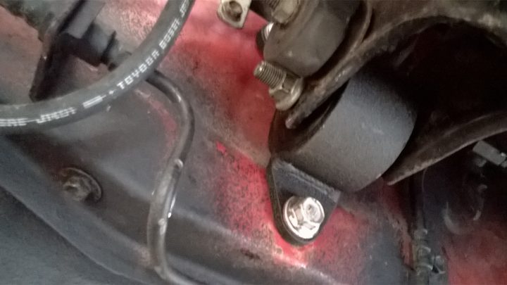

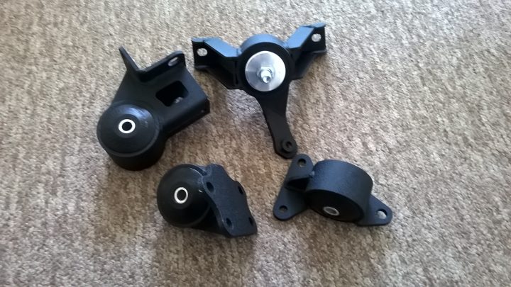

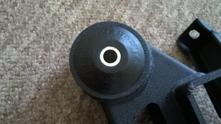

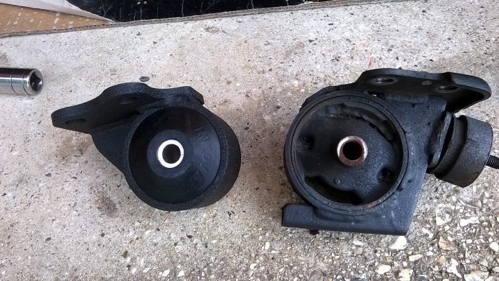

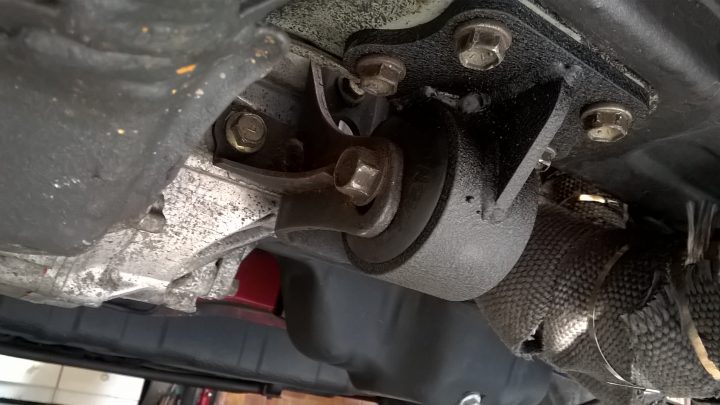

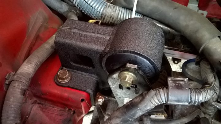

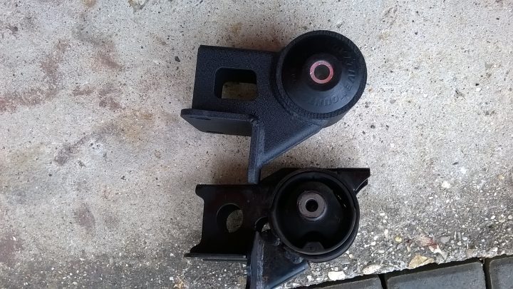

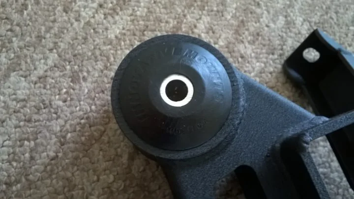

Late last week I received my Innovative Uprated Engine Mount Kit from the USA and looked in to installing this at the weekend .
The kit is for all three engine mounts and one gear box mount and is in Track spec 75A .
Old mount in ok condition but does feel soft and had a bit of movement .
New vs old mounts and installed

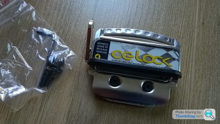

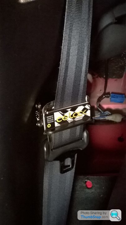

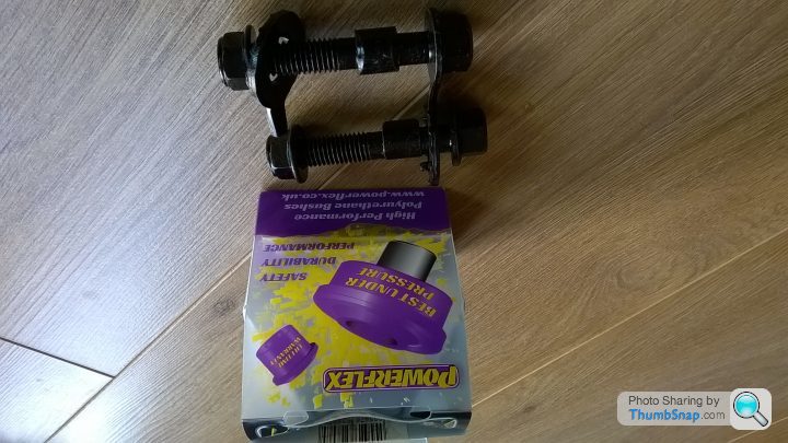

Another small update
I managed to get some new CG locks ( finding them now is not easy ) that I have been after as any half cage and racing seats will not be this year and on the stock leather seats you can slide around a bit .
X 2 new units
And installed

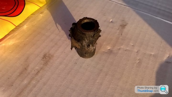

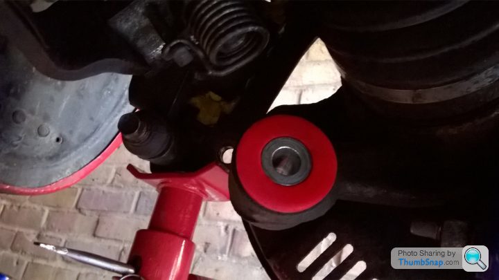

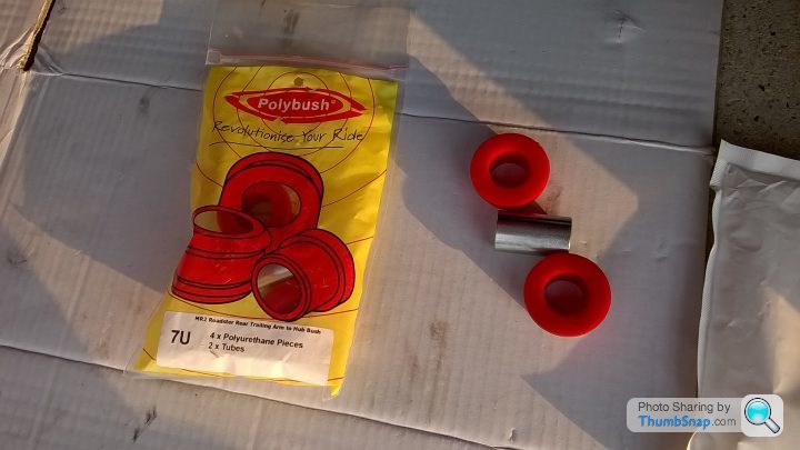

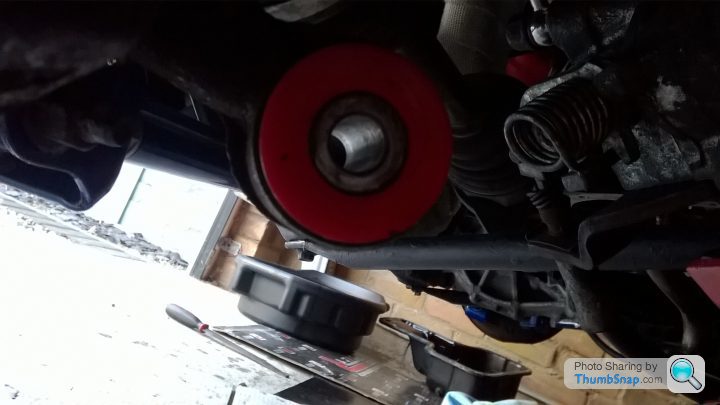

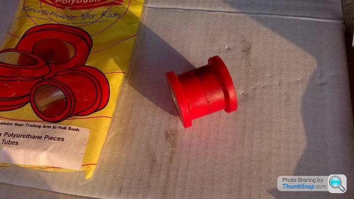

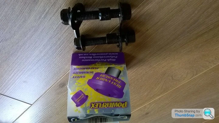

Another small job I got done at the weekend .
The rear arms I have changed to some Hardrace units and they have a pillow ball end but the other fixing goes on to the stock hub bush so I have got some pollybush units to replace this unit .
New pollybush unit
Old rubber unit
And installed

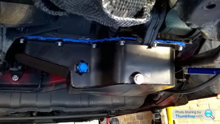

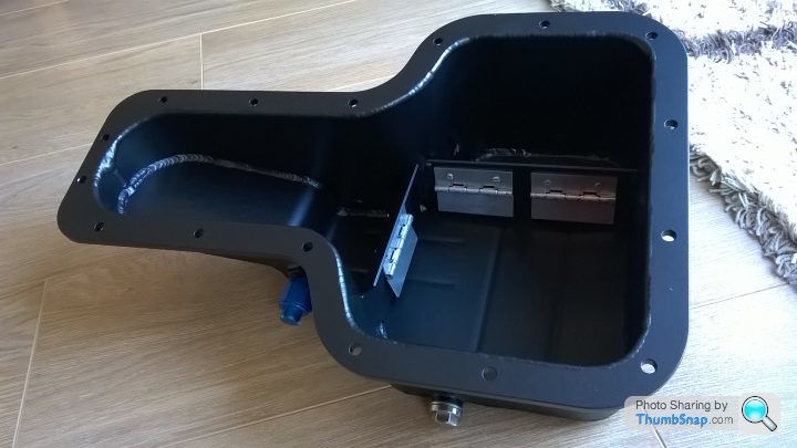

Fit the Lotus Elise EP baffled sump
Bleed all the brakes
Set up the coilovers ride height
Fit Nankang NS-2R tyres
Get tracking done

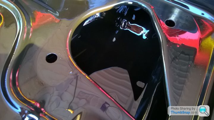

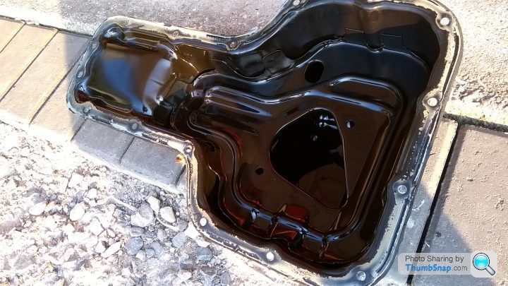

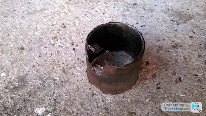

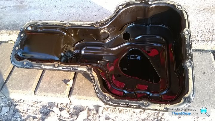

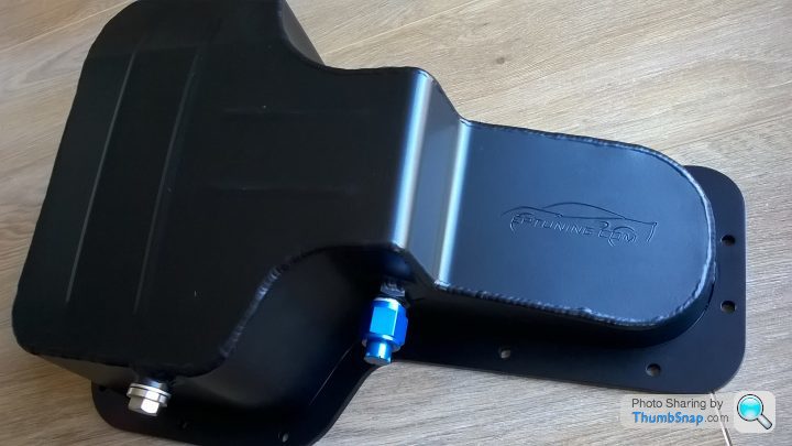

I have got round to removing the stock Toyota sump and it does have a windage plate it is not really a fully baffled sump
Old stock sump

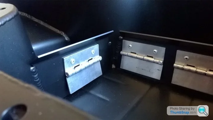

New Elise EP baffled sump with trap doors .

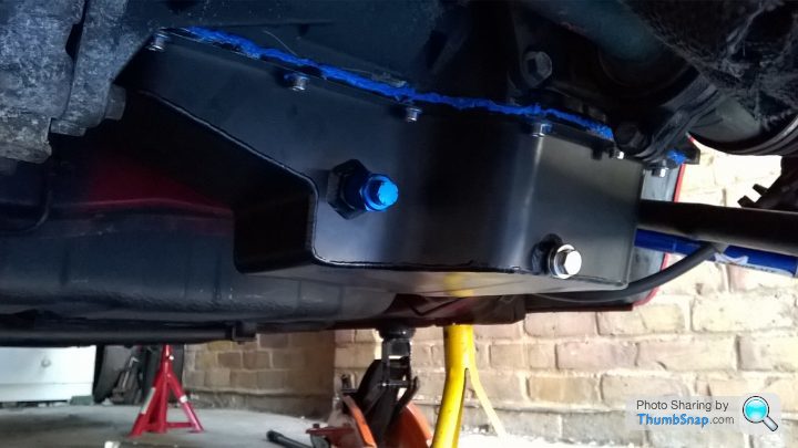

This should keep everything in check on track and no oil surge issues and the EP sump has an extra 1 liter of oil capacity so will help to keep engine temps down as well .

Love the door hinges.
You'll have a great time at Brands. I had fun in my stock car and yours look like it's got some good mods toward making it that bit more fun for a whole day.
That is £ 400 worth of door hinges I will have you know :)
Does work well tho I was testing this with seeing how the oil flows and it really does keep it in the spot you need .

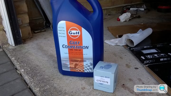

One of that last jobs before Castle Combe was to fit the baffled sump and a new oil filter with new 10-W40 racing oil .
Just need to check for leeks and then get the new tyres on tracking done then we are good to go for next Monday .

One thing to note is that the engine mounts have made the car a proper track car now and the whole car shakes and is so loud inside but this just adds to the special feel of a track car .

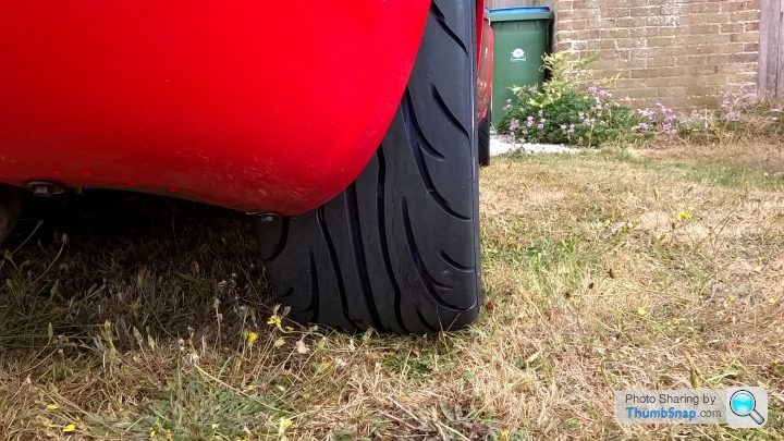

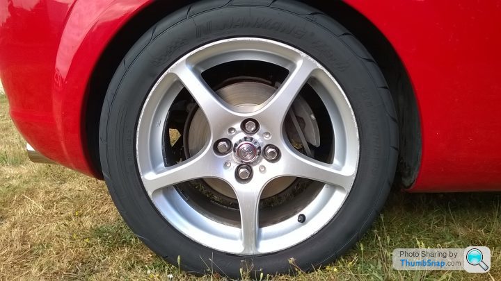

The car is in today for some wider rubber in the form of Nankang NS2R 195/50/15 and 225/45/16 and to have the tracking done then we should be all set for Castle Combe on Monday .
And i thought i ploughed money into track cars, lol.
Should be a good little roadster once all set up, albeit not the quickest on track but you'll still be having as much fun as the other cars out there.
I'd defo look into the 2ZZ conversion once you've hit the limit of its performance as is.
Had a good chat to the guy who bought my Celica for a 1zz-2zz conversion and he said its not a hard job at all and even the 2zz ecu is a straight bolt on job.

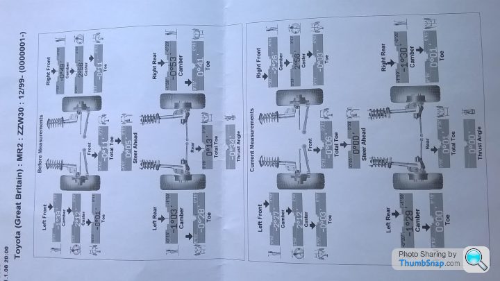

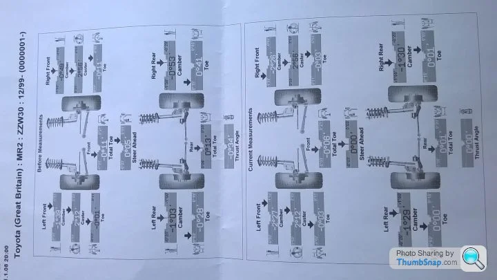

Last update was to have the Nankang NS2R tyres put on that are bigger at 195/50/18 front and 225/45/16 Rear ( stock is 185/50/15 215/45/16 )
Then a front wheel alignment only as I could not get booked in for a 4 wheel one in time .
Then a quick shake down to check everything was ok before Monday at Castle Combe .
I checked everything again Saturday morning and there was a puddle of brake fluid on the front drivers side .
This was just a lose pipe that was a quick fix and a re bleed and all was fine again .

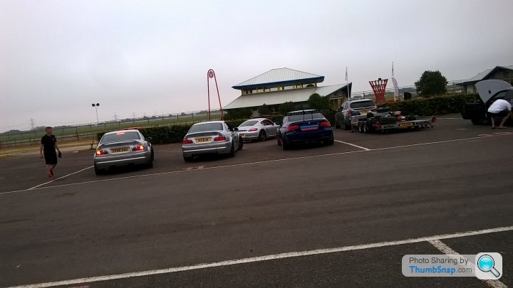

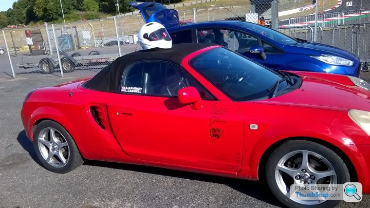

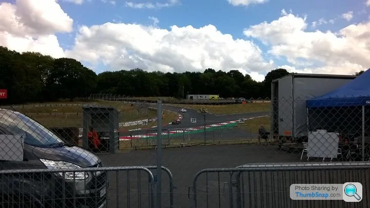

So yesterday we went to Castle Combe for the first time and the below is how we got on .
It is about 2 and a half hours from where we live so we set off at 4.20 AM in the morning and got there for 7.00 AM
Did all the signing on and safety briefing and noise test .
A few pics
Then it was out for some sighting laps then off out for my first session .
The car has had lots of suspension upgrades from our last track day at Brands Hatch 7 weeks ago and felt amazing and much quicker than before with loads more grip and traction than before .
The vids are not the best for sound or picture as we had a few problems im afraid .

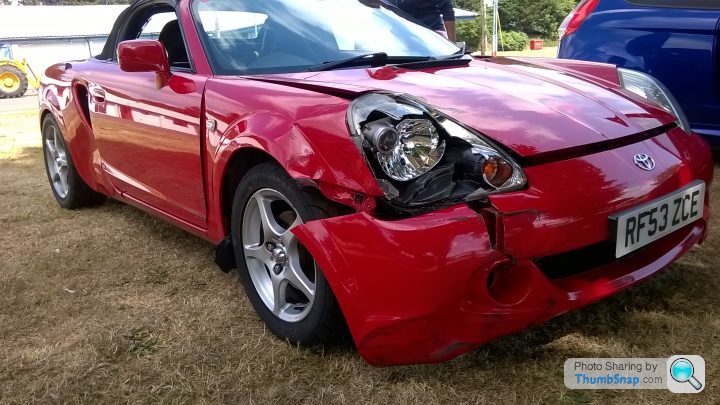

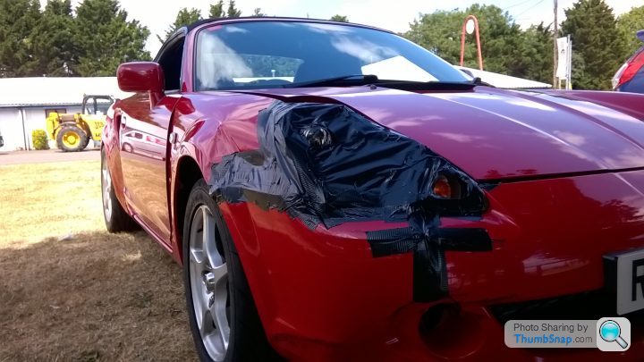

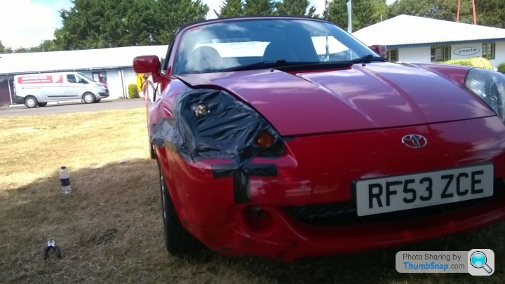

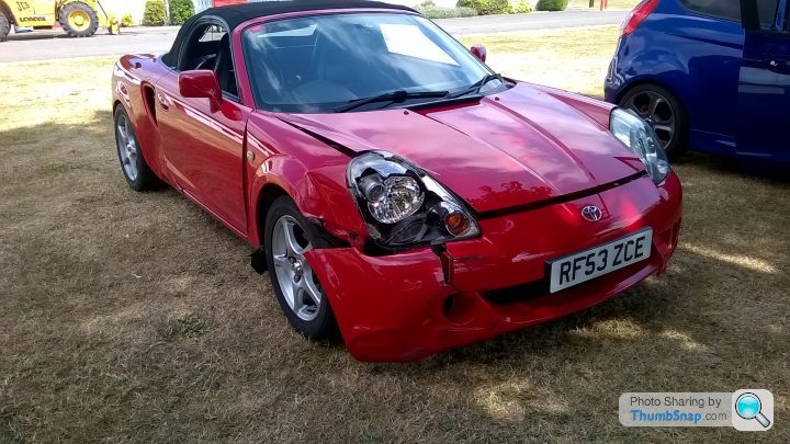

Then it was time for my second session and things did not go according to plan LOL
I was really enjoying myself and pushing harder and harder each lap and then had some fun keeping an Prelude and Boxster behind me before a racing instant happened or me running out of talent and driving past my limits .
I hold my hands up it was Just down to pushing too hard , turning in too early and driving past my limits so no oil on the track or something broke on the car just driver error .
My session 2 ( 3.40 for the good bit )
https://youtu.be/9ECayQu9HUw

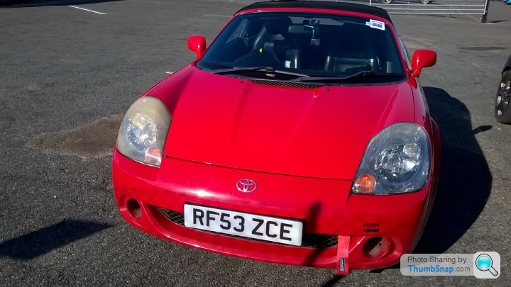

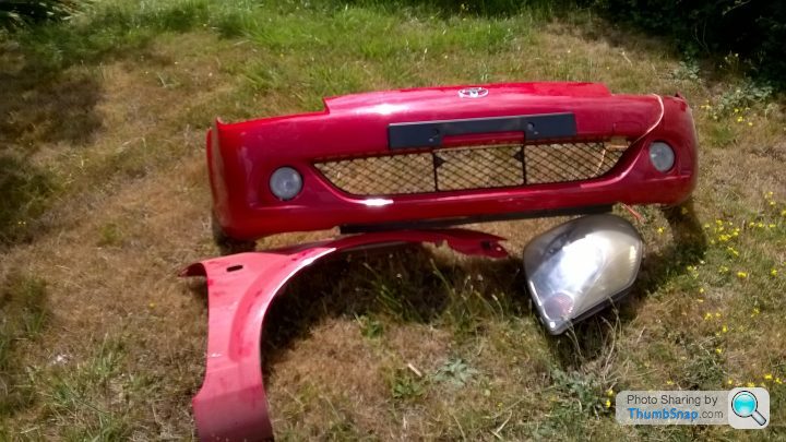

With a bit of luck the damage was just cosmetic ( front bumper , light , door , wing and rear panel ) as the radiator , PAS pump and steering / suspension was all un touched and fine so after a really nice guy ( sorry forgot your name ) gave me some duck tape the car was allowed back on track again .

Then I wanted to get back on track and it’s the first time I have had a crash so lost a bit of confidence and was lapping slowly and was not feeling confident driving the car .
I started to push a little bit more but called it a day and went back in .

So all in all it was a great day and great fun and I learnt a lot and now just need to get some replacement bumpers , wing and headlight fast as we are booked in to Brands Hatch next Tuesday then off the Nurburgring on the Monday after 06/08//18 .
Yeah I know if it was left or right I would have just been on the grass but you live and learn .
Just need to get it patched up fro next Tuesday .
The only way to learn the limit of the car is to go past it. Just unlucky with the tyre stack being there.
Good to see the damage was only cosmetic and you were able to drive home. Easily done, I was pushing my Clio a couple of months ago at a Goodwood, unfortunately I hit something more solid...
Hopefully you get the car sorted for next trip, great little project.
Yeah its just cosmetic but im back at Brands Hatch on Tuesday so running out of time .

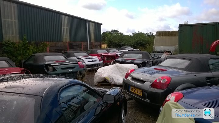

Rutland was the company and had lots of MR2s and loads of replacement parts .
All back home with the replacement bumper , front wing and headlight .
I also got some new rear camber bolts from Powerflex with 1.75 adjustment .
The car is booked in to Eurospec in Guildford tomorrow at 9.00 AM to have a full Geo set up and to make sure everything is set up correctly then it is off to Brands Hatch in the afternoon for the afternoon track session . ( hoping not to have any more moments as we have only driver the car twice on track and have both had spins )
I just need to get all the replacement units bolted on and we are all ready to go for tomorrow .
Dean is sound, I went a few weeks ago to get a bumper and bonnet.
What geo are you going for? I need to sort mine when I decide on springs or coilovers!
So yesterday we set off at 6.45 AM up to Guildford to have a full GEO settings done at Eurospec before we went to the Brands Hatch evening session at 5.00 PM .
After talking to Ben at Eurospec we asked for a better rear set up that would be more forgiving and after talking with him the rear end should be more planted but he did say with this set up if you do lose the back end it will be harder to catch .
The night before I did set the rear anti roll bar to full soft as well .
Before and after measurements .
Not ever having a car set up correctly in not too sure on the numbers but am happy that is has been set correctly ( if anyone wants to explain this more this would be helpful for me )

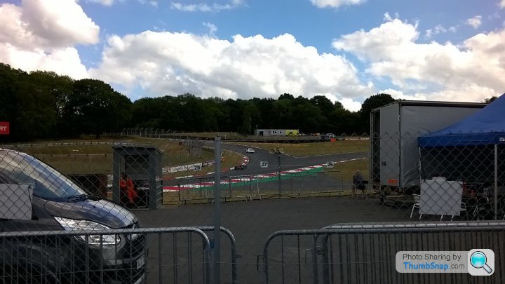

We got to Brands Hatch and did the sign on and then parked up .

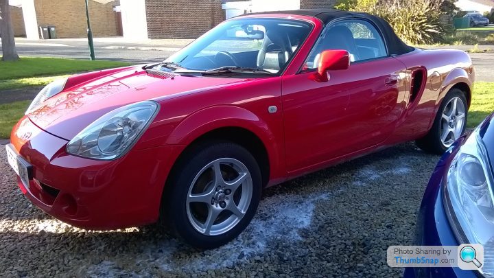

New wing , bumper and light fitted .
Then noise test and that is where problem one started .
Doing the noise test it became clear that the hand brake was not holding the car enough so we will have to look to get this sorted but not the end of the world and we just parked the car in gear .
We did some sighting laps then I went out for the first session and after one lap the car had hesitation and missing under load so it was back in to the pits to take a look .
