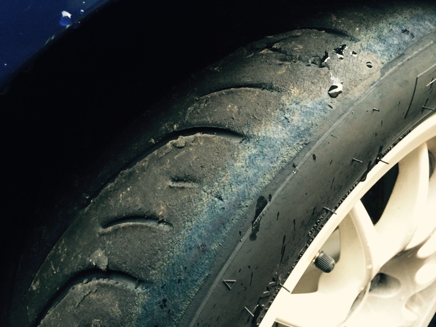

yes the sidewalls are a bit soft. I run them at 28.5psi cold and on track they hold up a lot better. I ran my 1st set at 30psi hot after some 'advice' and ruined them :(
Hmm, I'm only about -1.5 degrees as well...lol
Good to hear that the sidewall issues can be sorted with a bit of extra pressure though. They seem a decent tyre for being so cheap!

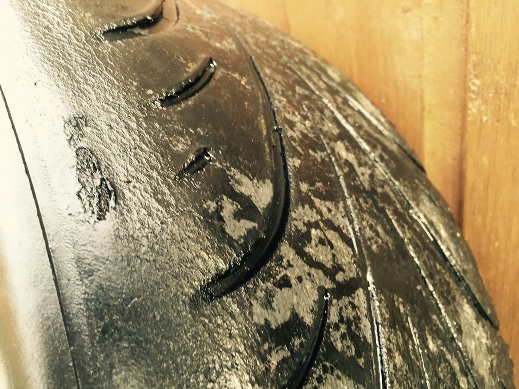

For the bin unfortunately, loads of tread across the tyre, shoulder is toast. Great tyres on track though but I don't hold back!
Not good! Was that due to low pressures or a lack of camber?
bit of both imo, but the track I go too has two long straights with tight right hand bends at the end, one a hairpin, known tyre and brake killer, other people on different tyres have similar problems so it may well be more track specific. NS-2Rs next time out so I'll find out. The 1st set @30psi hot actually put holes in the shoulder :( . The two rears are the original RS-Rs and have done 4 track days @ ~70 laps per day as well as an hour drive too/from the circuit and still look excellent, no uneven wear at all, in fact no obvious wear at all :) I still rate them for the money, I'm sure I'll have them again!
