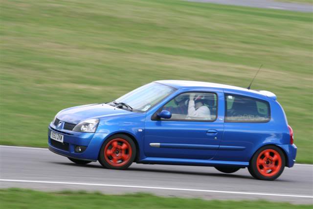

I've run a set in the past...running 205/50/15 rubber. This was on standard suspension with some modest strippage.
Cleared the calipers fine and no rubbing.

Thanks for the replies, top photo Mark..
