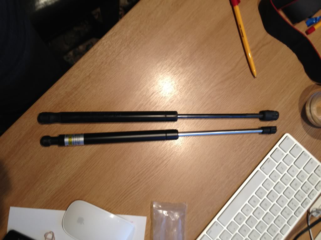

Just in case anyone is in need of a new pair, I know mine were failing.
From Renault they are around £500 a pair including VAT
But, the struts from the front (bonnet) of a BMW 1 Series (04 on) are the same size and fit. Replaced mine today and they are perfect, stronger than the old ones, hold the boot and actually lift it if its not completely open, and the spoiler still has the same clearance as before.
They are available on eBay here, I bought from here for £39 delivered and the service was excellent too :)
http://www.ebay.co.uk/itm/350479082...X:IT&_trksid=p3984.m1497.l2649#ht_2045wt_1413
And a picture, Trophy at the top, the eBay lesjofors BMW ones at the bottom

Im i right with the understanding that the trophy struts are shorter than standered?
I have a 182, and my spoiler is catching on the roof bad, and its getting worse. Will the trophy (or bmw 1 bonnet) struts help the spoiler clear the roof? How?
Can anyone tell me the lengh of the Trophy struts?

I guess it really depends on where your spoiler is catching the roof.
You could get the shorter struts, but IMO it sounds like something is fitted correctly. Have you got any photos of the issue?
You could try some from a BMW 1 Series, I think a few on here have used them in the past.

I had to get some shorter ones when I fitted a cup spoiler to my 172, it was just touching the roof edge in the middle of the spoiler no matter how many times I refitted it or adjusted the washer pipe under there. Bmw 1 series bonnet struts from struts direct.
I used sgs engineering for my trophy was annoying me having to bend over like an old man to get in the boot. I had mine custom made so they were longer than the v6 ones but slightly shorter than standered and still leaves enough space for the spoiler. Service was good and I think it was delivered the next day.

Jaguar X-type bonnet struts also work and give you slightly more lift than the 1 series/trophy/v6 struts but still give the spoiler clearence
