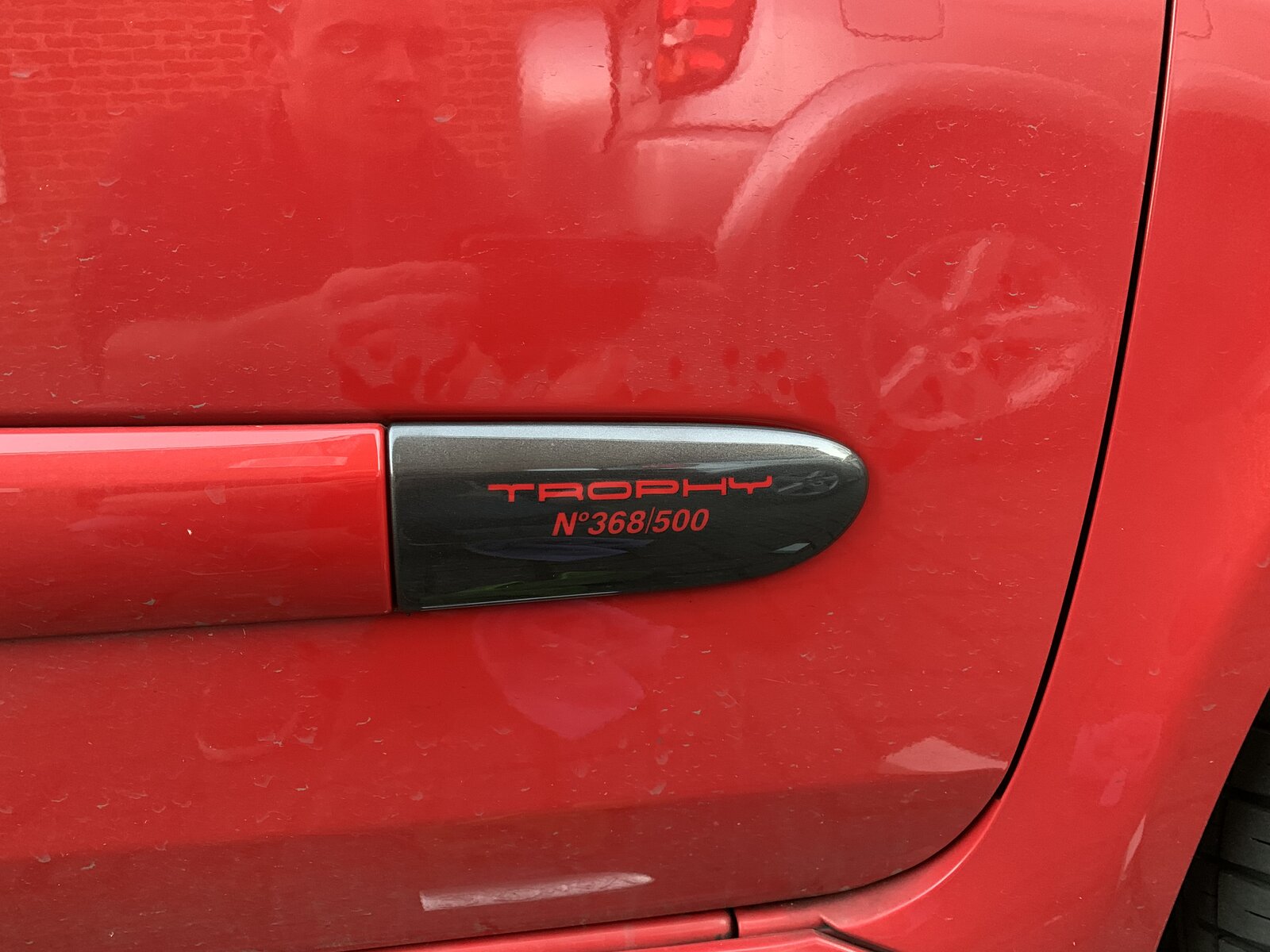

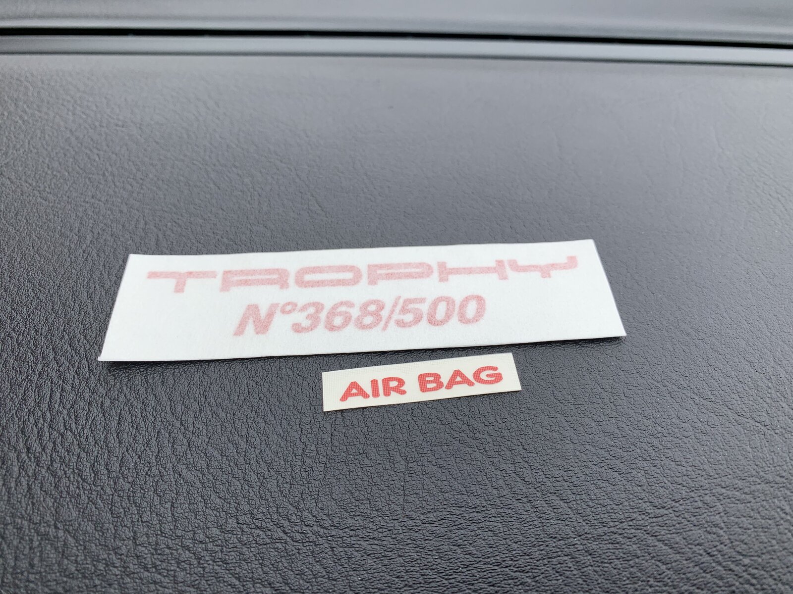

Anyway, picked up a 182 Trophy today. At last I have one (you may remember I built a Black Gold 182 up to full Trophy spec a number of years ago, it was documented on here).
This one is number 368.
It has been very, very well cared for, and is in extremely good condition. Mileage pretty low at circa 65k too. Also had a full engine rebuild very recently (within last 6 months) with no expense spared; all this documented over on the Trophy register. A quick search on the MOT history also shows there has never been a single advisory either!

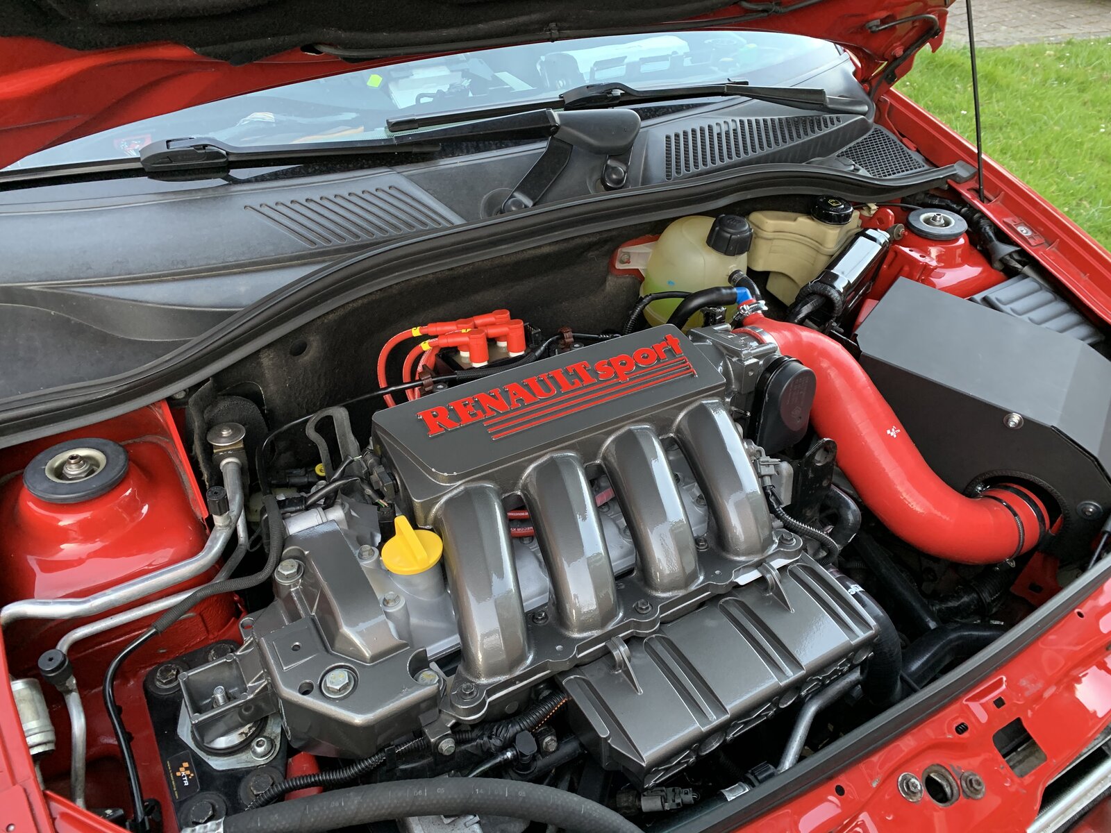

It is pretty much standard to my knowledge apart from a few things:
Scorpion Cat-back Exhaust
Fatty Induction Kit
K-Tec Engine Mounts
Forge Motorsport Silicone Coolant Hoses

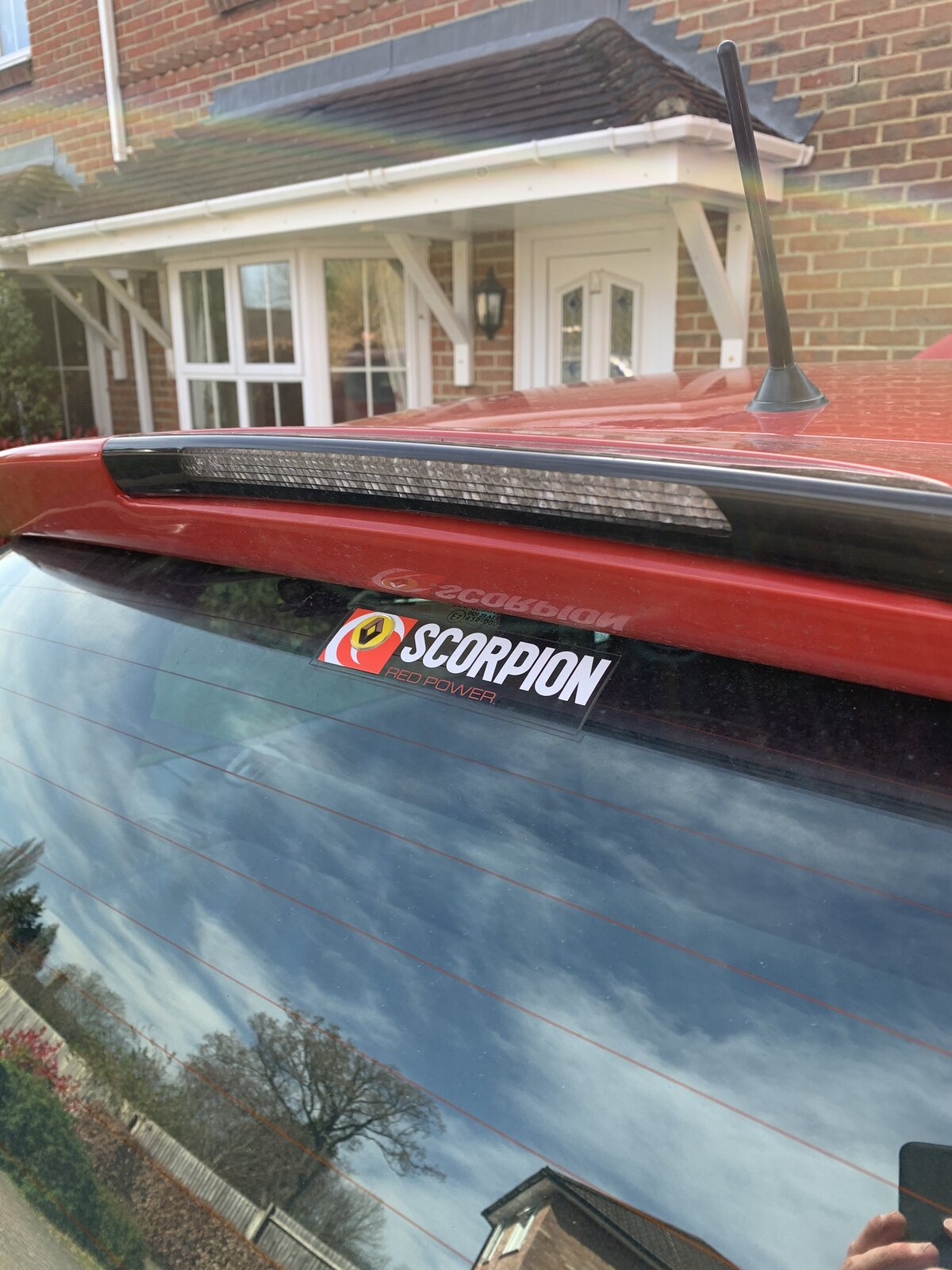

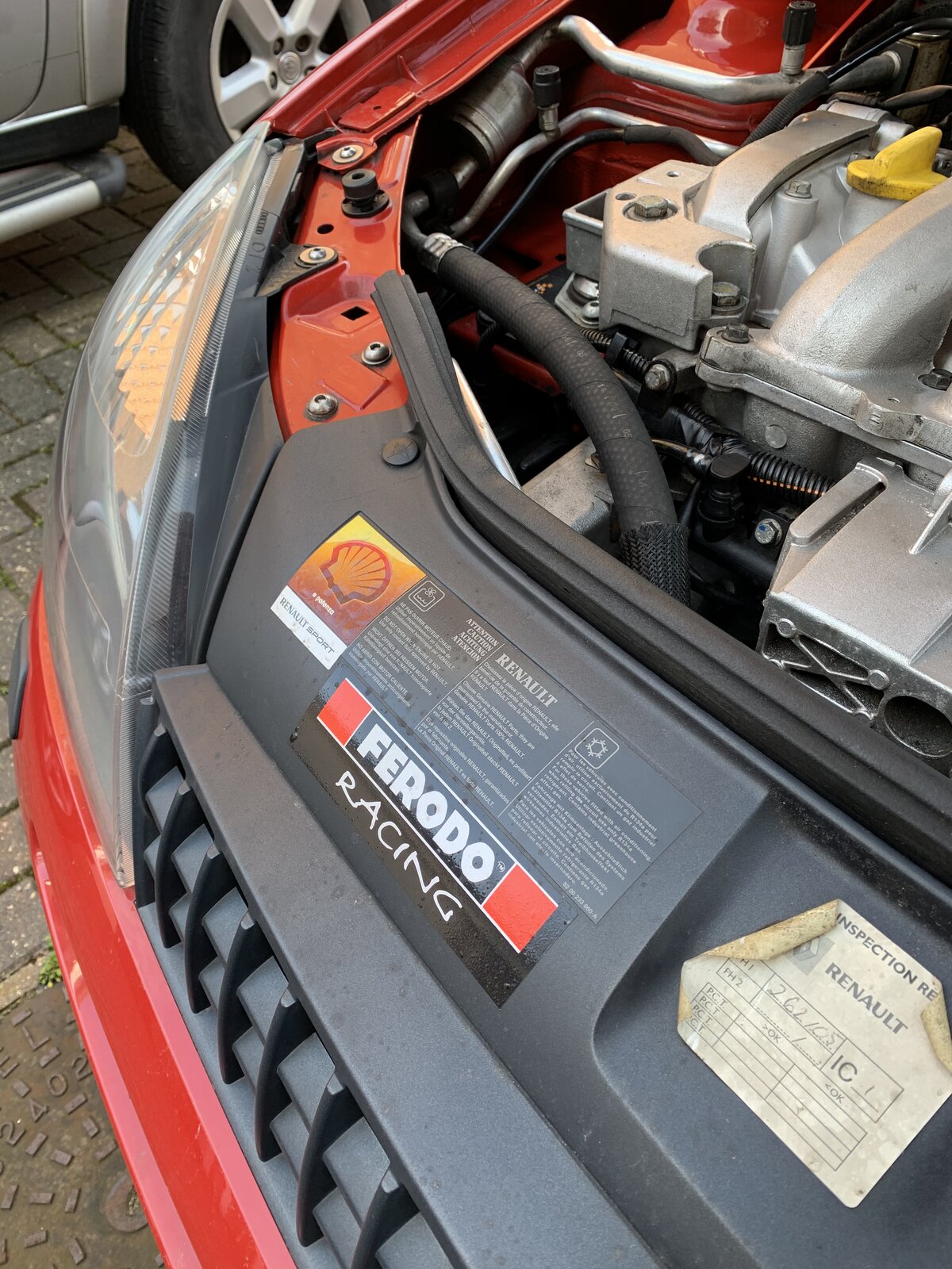

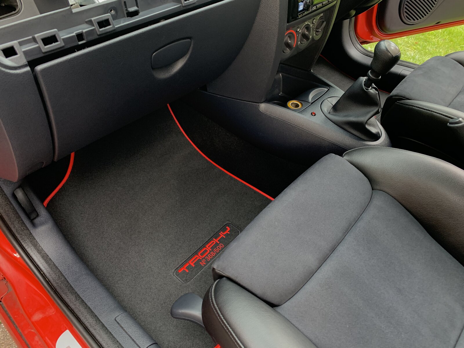

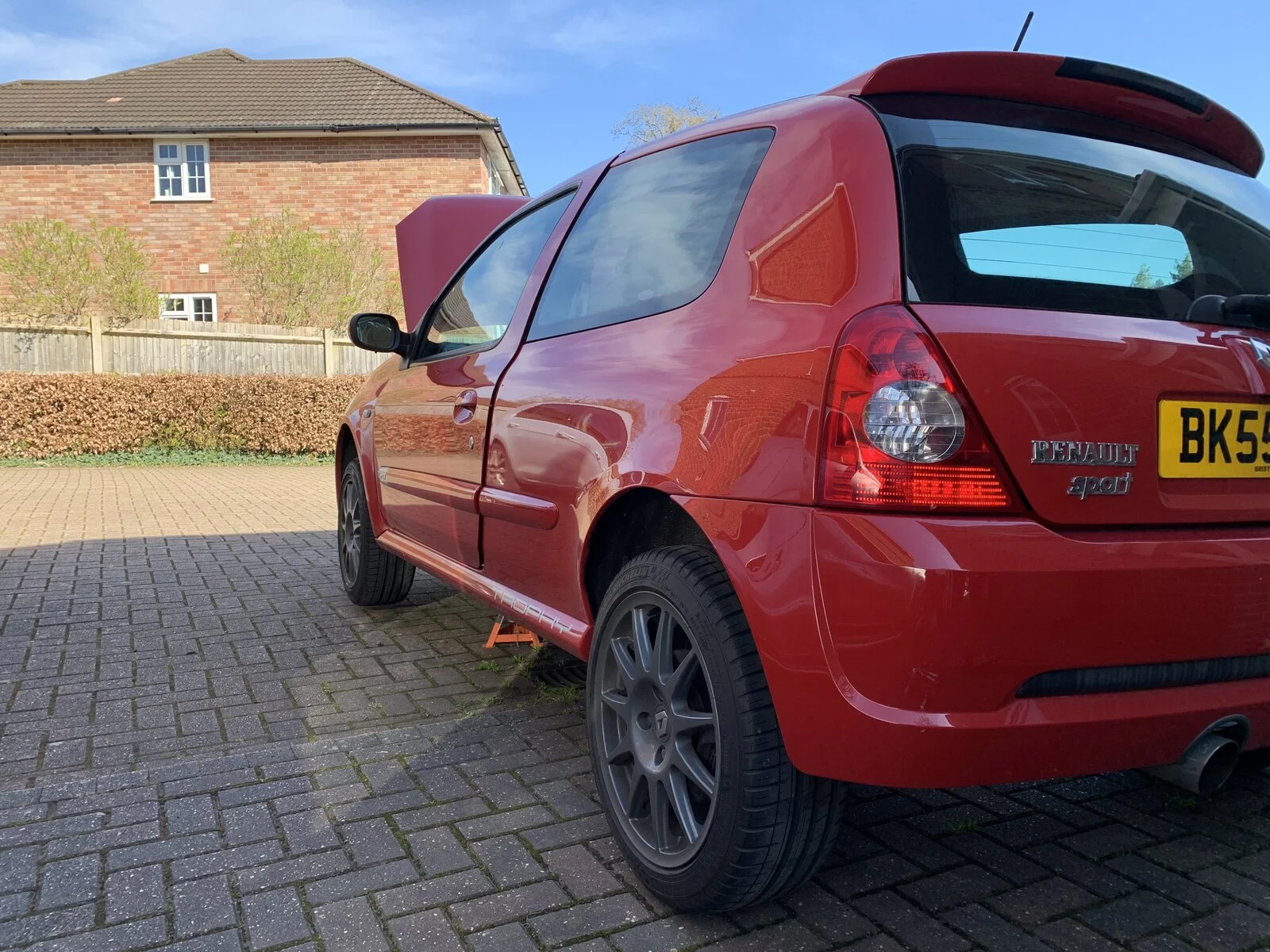

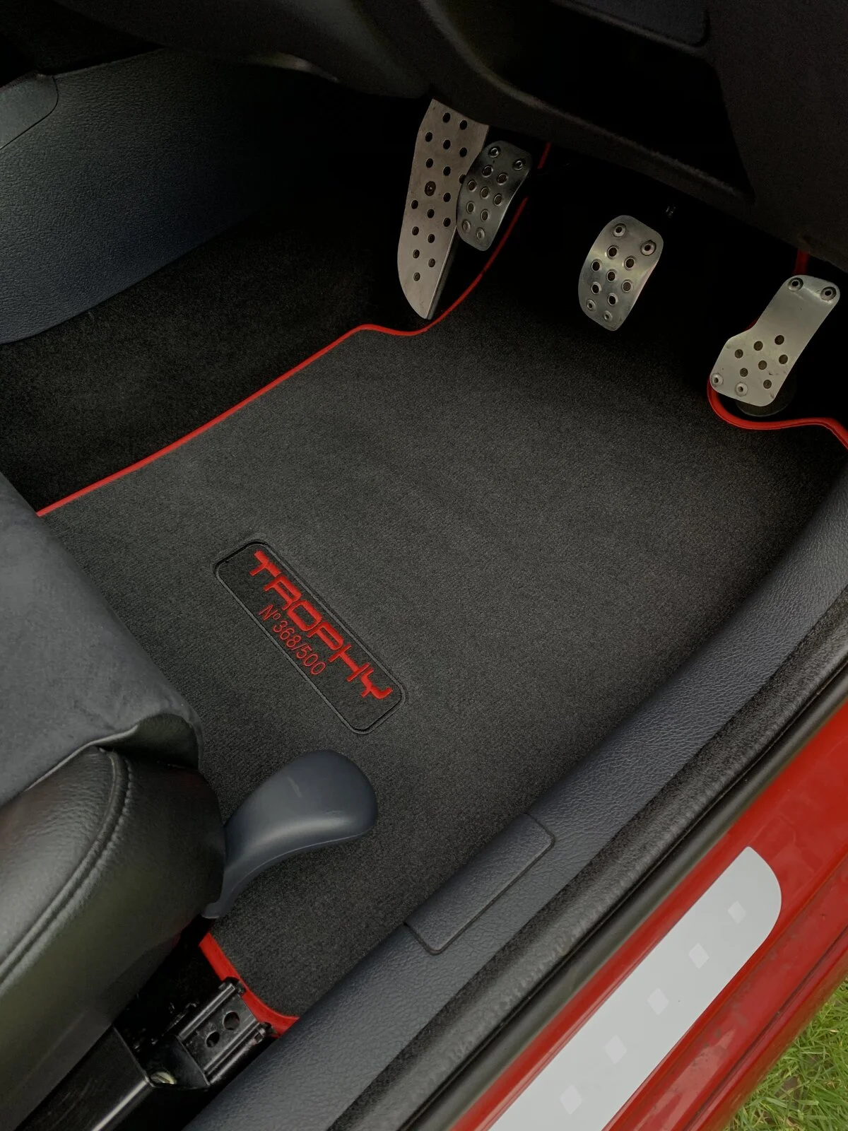

Below are a couple of pics I managed to take today just before I arrived home with it, when I stopped to fill up with some of Shell’s finest. Last pic just shows it came with a boot full of goodies too!
Will get some better daytime pictures later in the week.
Plans are to keep it pretty much original, but there are a few things I would like to do over the coming months which will keep to an OEM/OEM+ theme; basically in typical Ash fashion (you all know the level of my work by now as enough of my cars have been documented on here!).
First job to do straight away is to adjust how the exhaust is sitting - no need to mention it; my OCD literally can’t cope with looking at it!

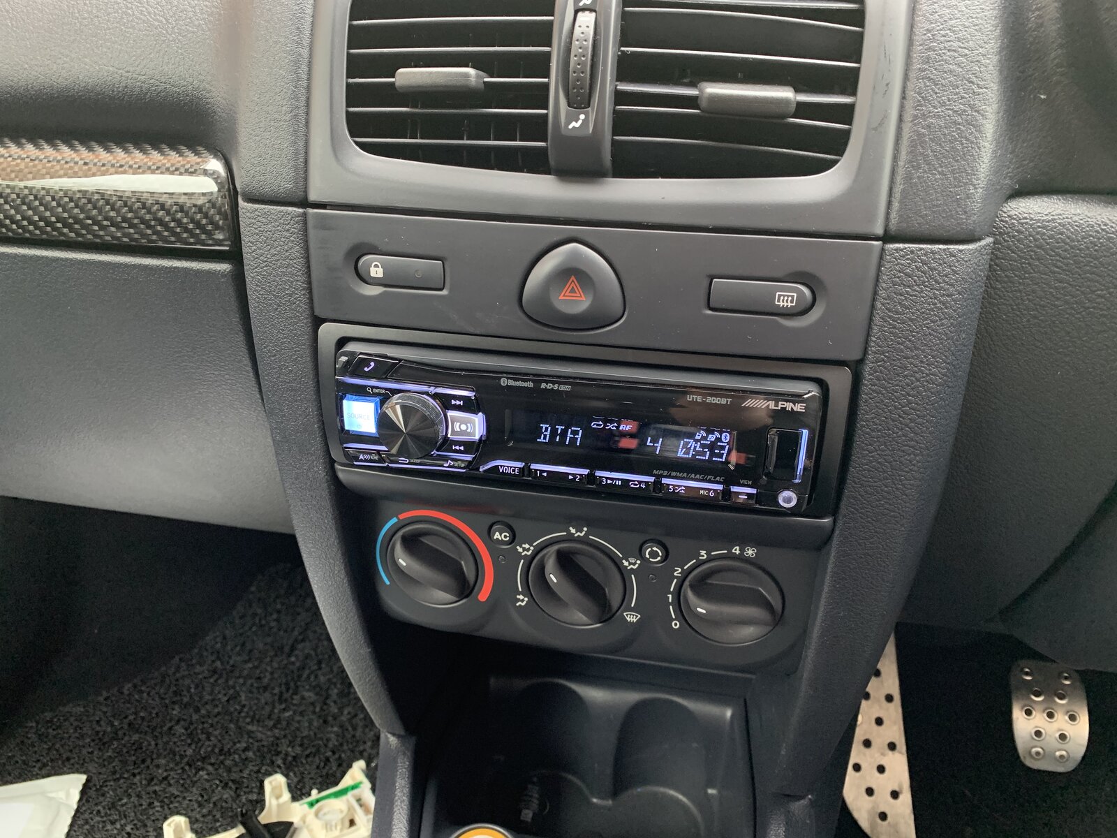

So, main thing I wanted to do over this weekend was fit a bluetooth headunit so I could play my own tunes!

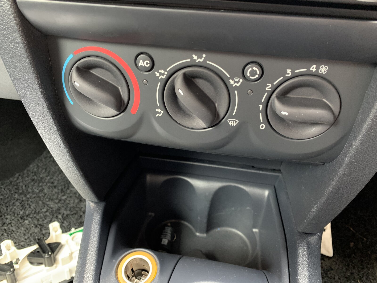

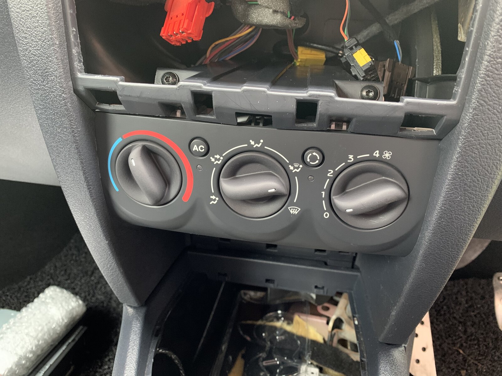

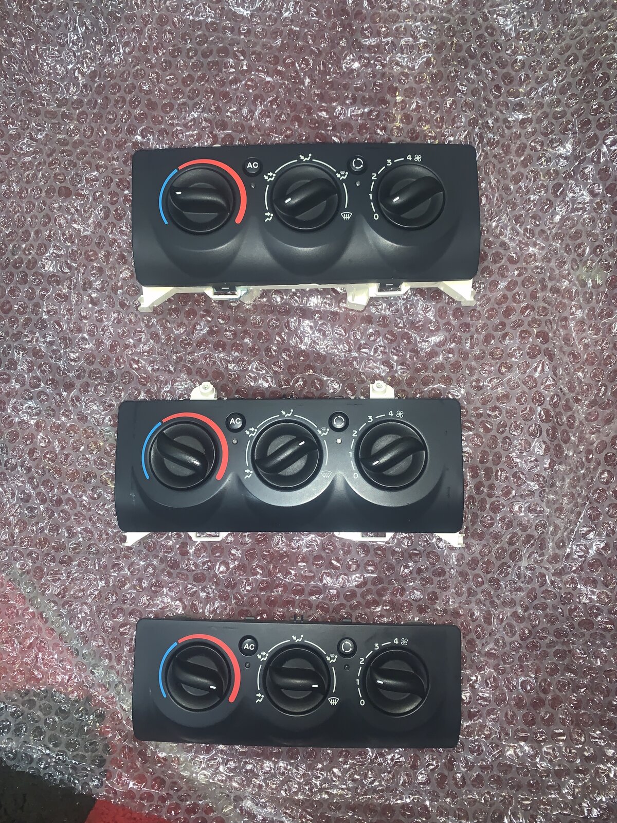

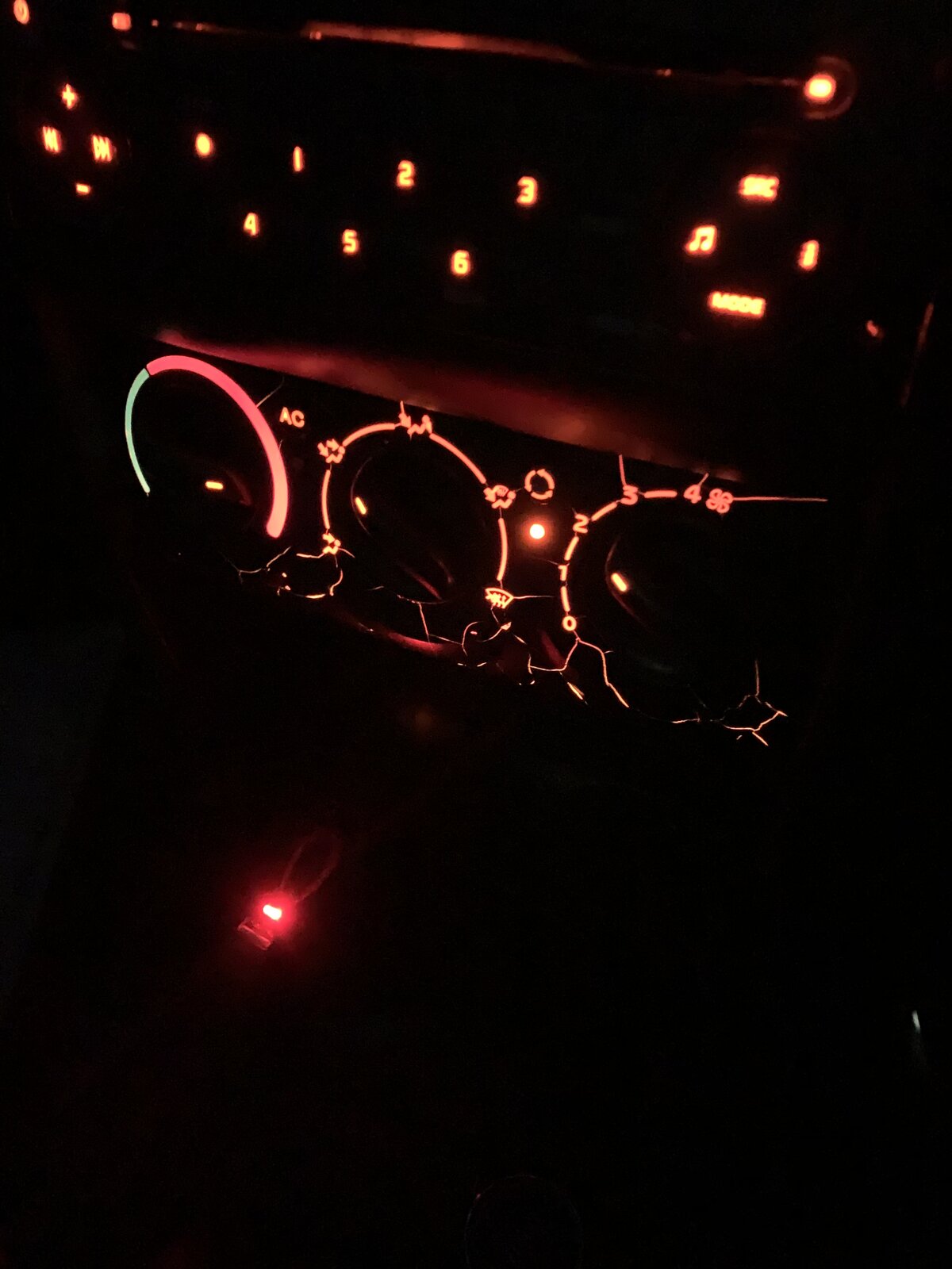

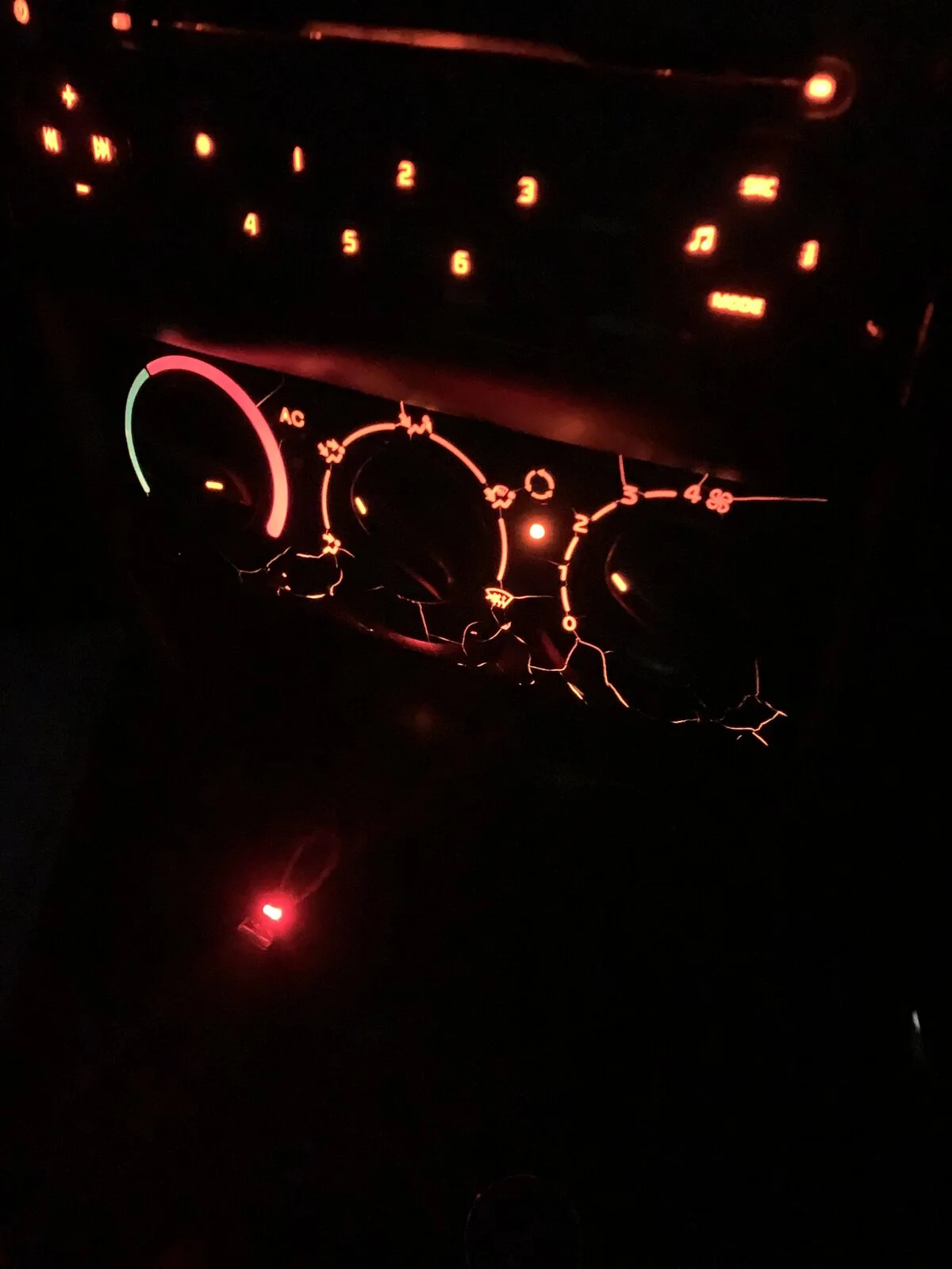

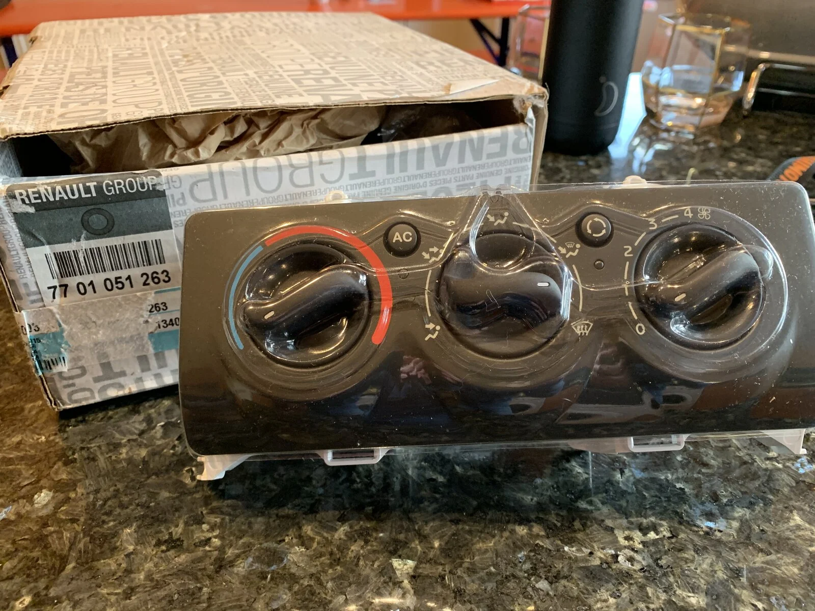

As most Trophy owners know, the heater control panel is prone to peeling. At first, I thought my car had escaped this, but after switching the headlights on to drive home one evening, this was revealed...
Something my OCD just could not cope with! Luckily enough, I just happened to stumble across a brand new one being sold. Not cheap, but buying a second hand would just be pot luck and most are going to be in similar condition, so I jumped on the new one. Thanks to @ashtons99 for selling me his boxed, new control panel!
Unboxing when it arrived...

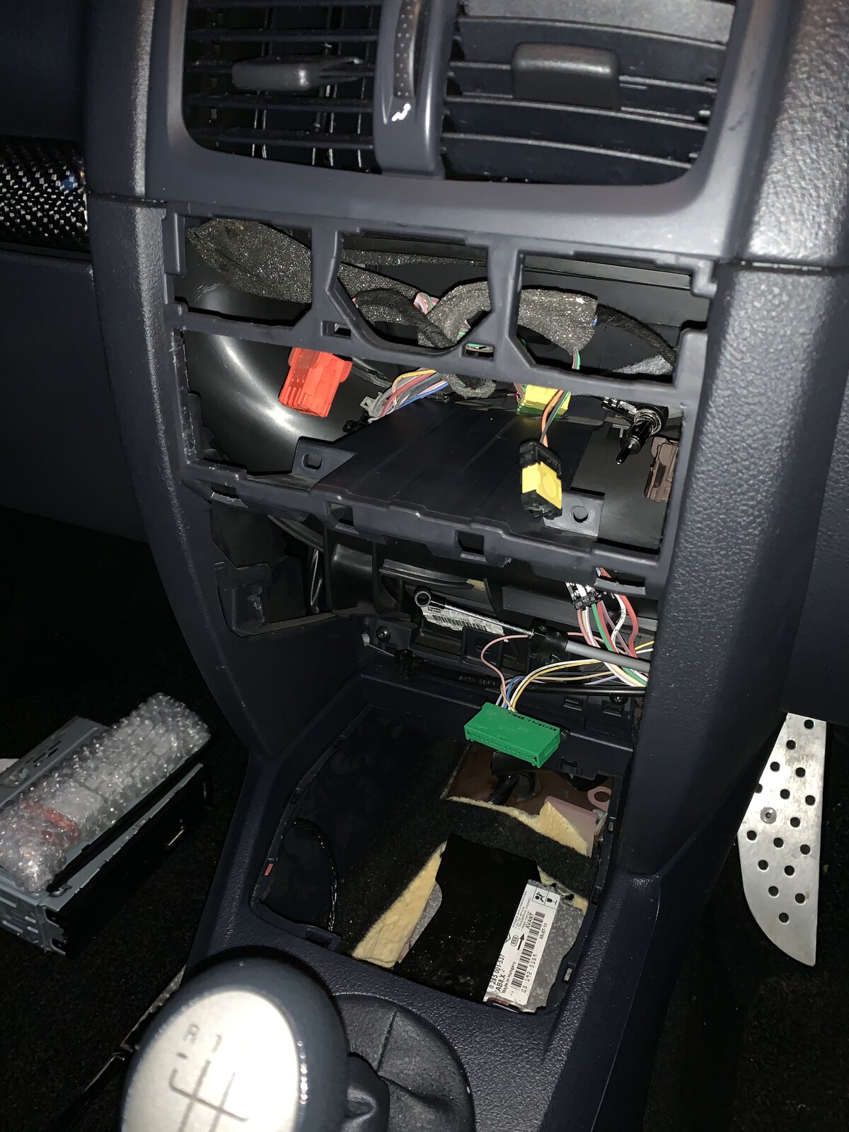

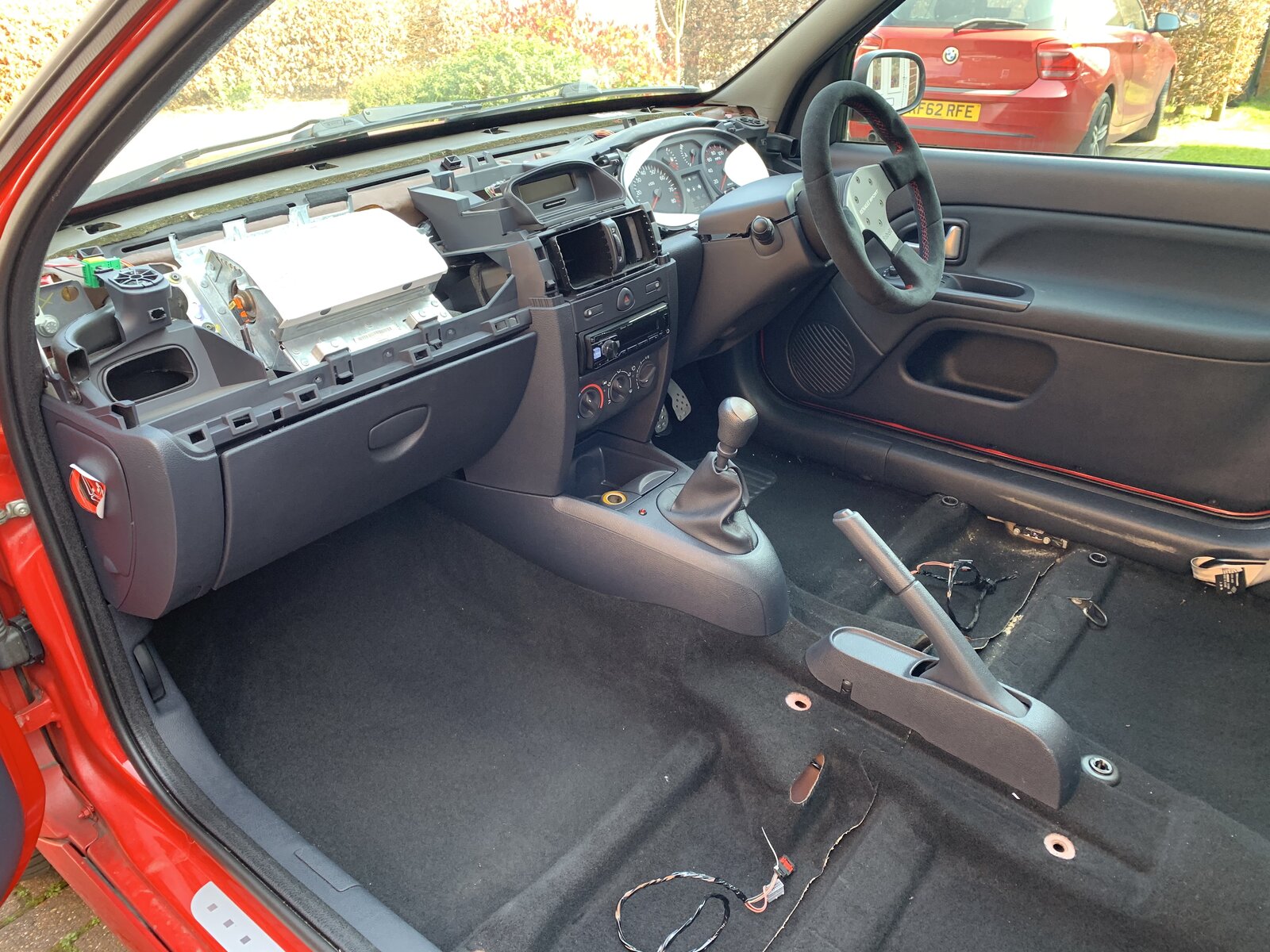

So back a few steps, I decided to start fitting the headunit yesterday. Was not planning on replacing the control panel until a later date, but then looking at the dash with the standard radio removed, I thought I may as well replace it at the same time.
I got the old one removed before it got dark yesterday, and left it there. What a ballache of a job, hardest part is disconnecting the heater cables at the back of the panel as you are going in blind. Left it like this...
Back at it today, and again hardest part was connecting the heater cables up, mainly because there is not much room to play with, and I didn’t want to scratch the new panel!
Lots of swearing and some scratched knuckles, then voila...
Then I continued to install the Alpine Bluetooth radio I bought, pretty straightforward job. Now looking much better!

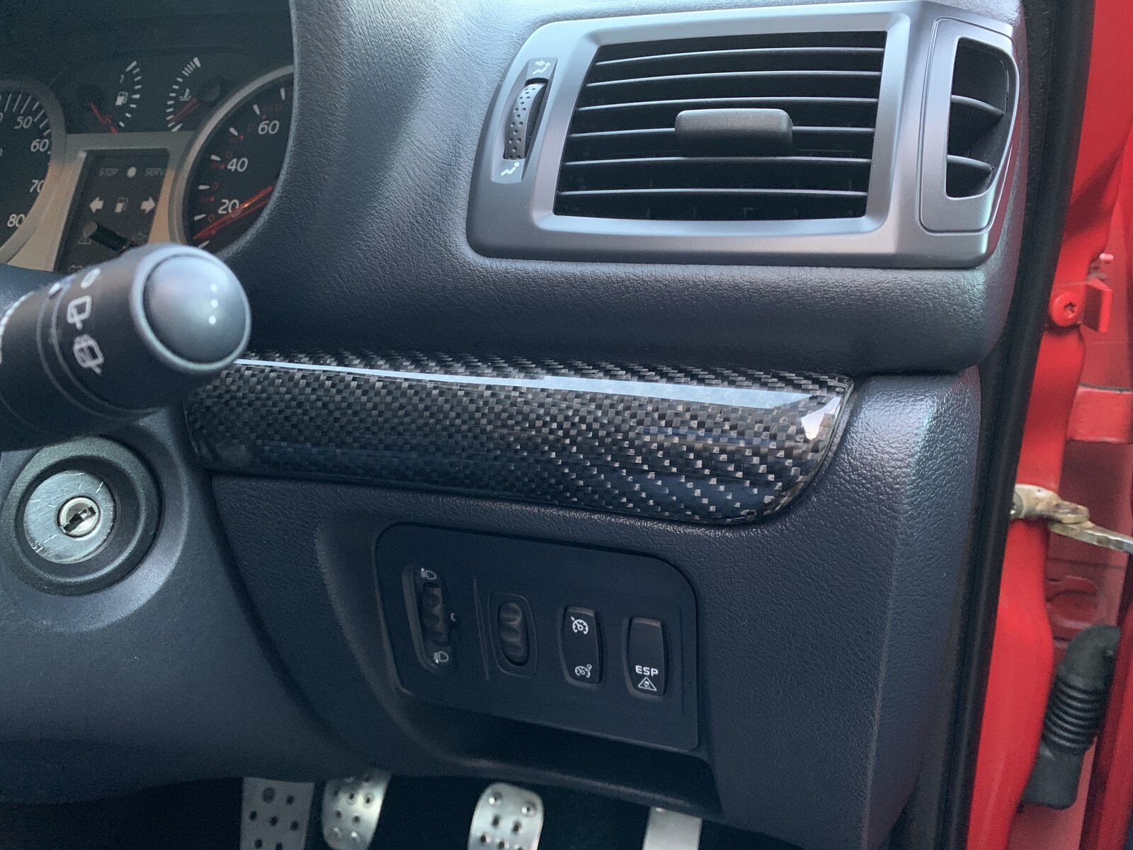

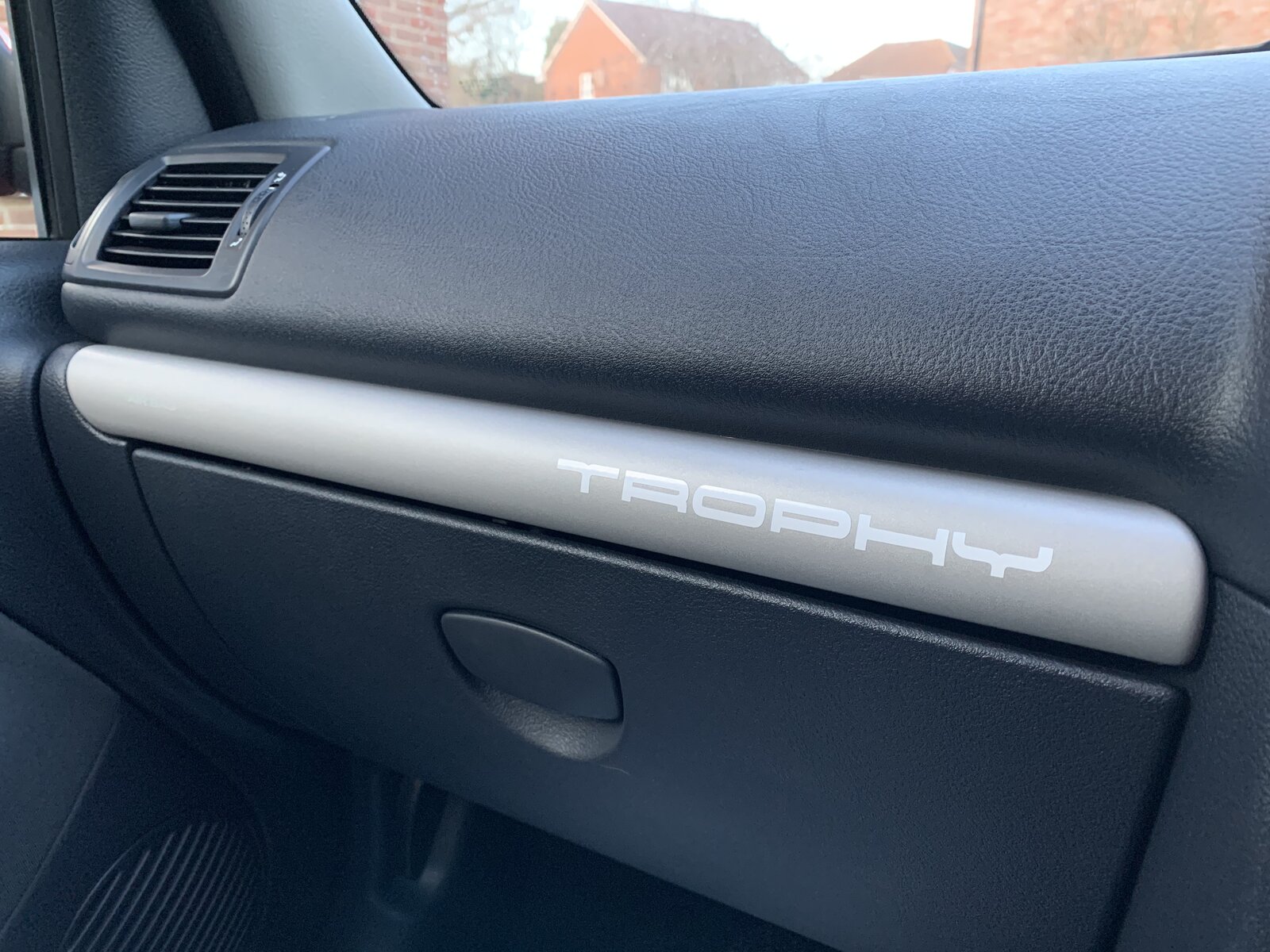

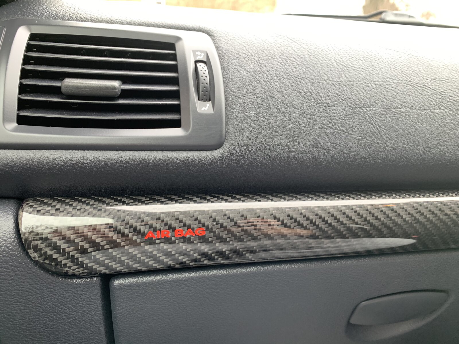

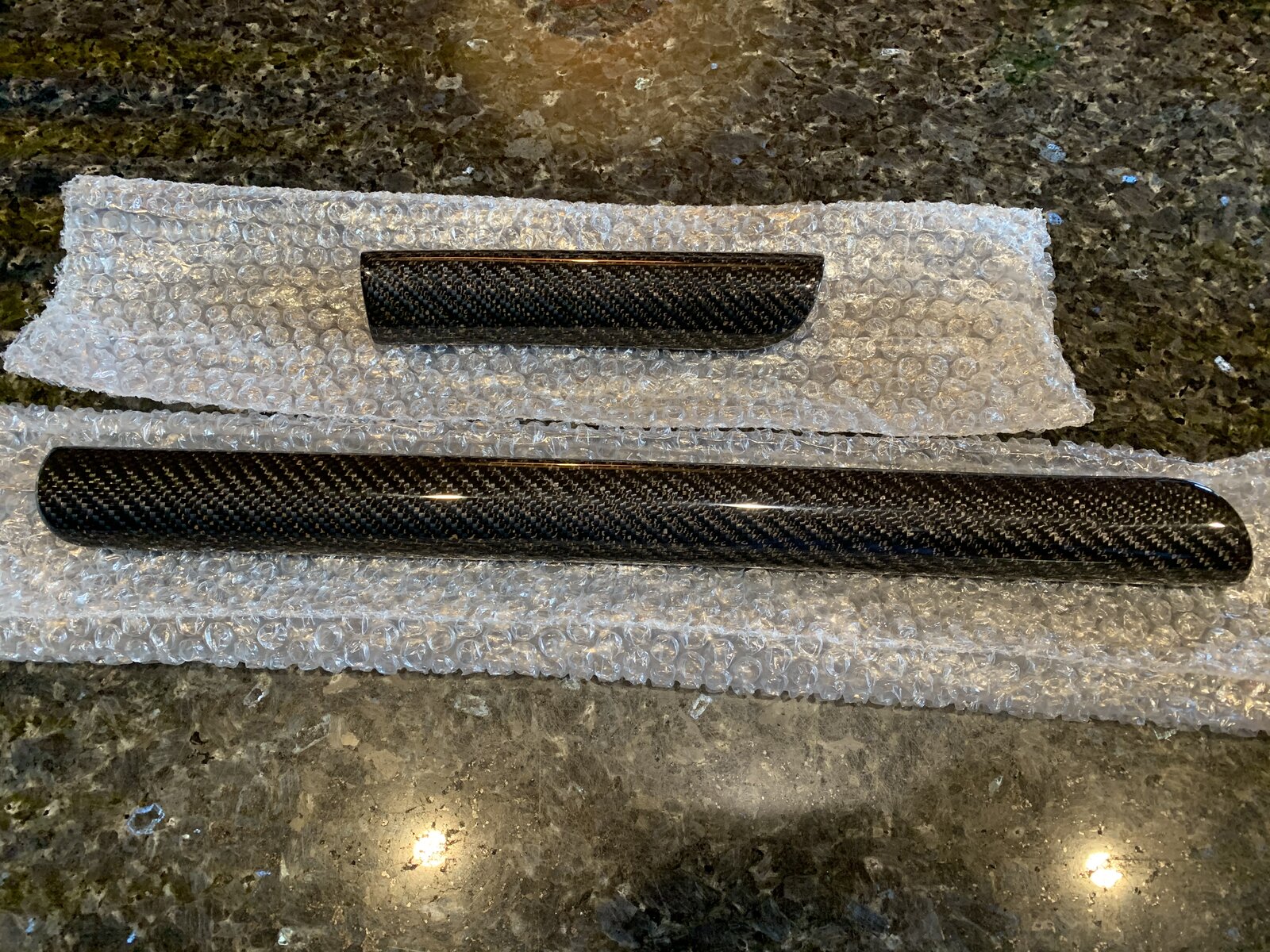

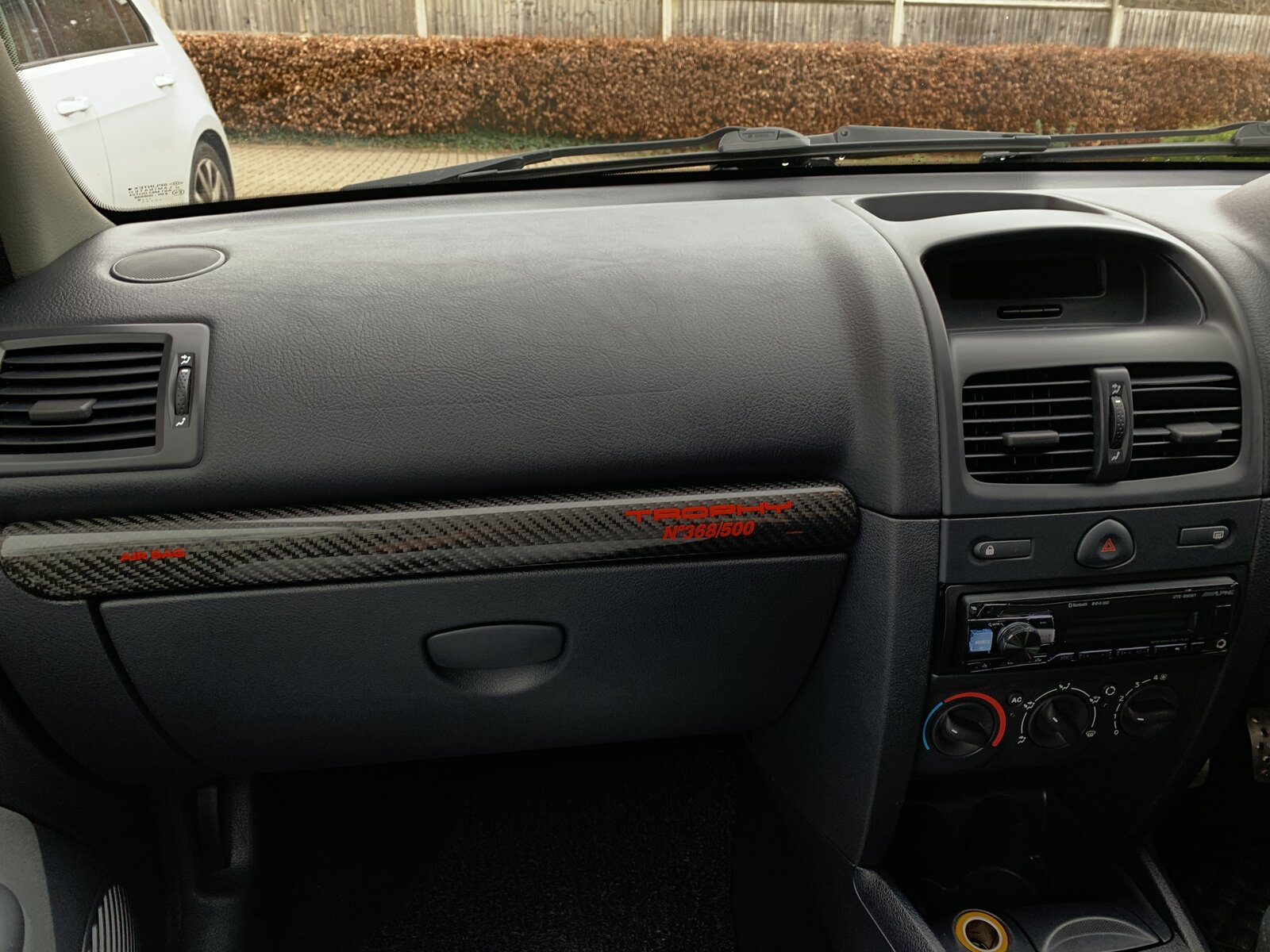

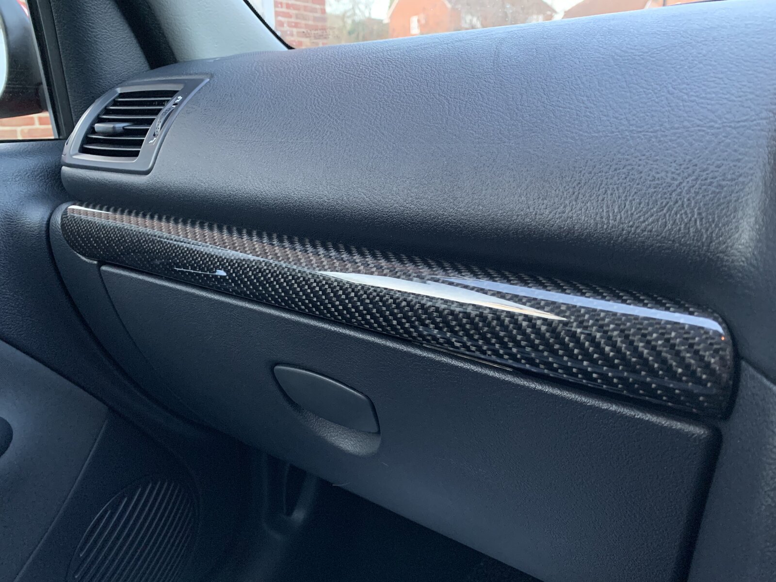

Whilst I was in the mood, I decided to fit some replacement dash strips I recently bought.
Not normally a carbon fan, but I went for these as they are real carbon as opposed to the fake stuff which I really don’t like. They weren’t cheap.
Obviously a very easy job to swap over.
Before pic (was not a fan of the big Trophy decal anyway)...
And after...
As I say, not normally a big carbon fan, but I am really happy with these. Look much better than the photos suggest. And it should tie in with another plan I have for the interior which will be revealed in due course.

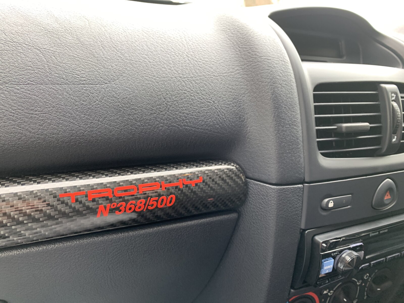

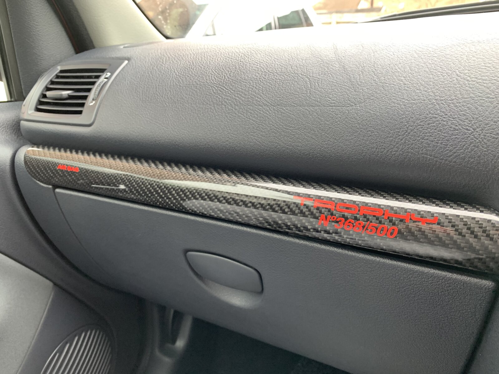

After I had purchased the dash strips, I thought it would be a nice touch to have a couple of decals made up, just so it isn’t quite as plain looking.
These are what I thought would work...
And once they were fitted. Again, very happy with the result, I really like it.

I’ve got a new heater panel for mine.
Getting it done by garage whilst it’s in for a few other bits.
Looks like a right ball ache [emoji23]
Mimes got a bulb out behind the heater panel. Is it a radio out job to change it?
Must be good to have a new heater control panel.
I have been saving them up as they are rare and £175 from renault :oops:

Now I have done it once, I think I could do it in about an hour to hour and a half. Not particularly hard, just a pain getting to the cables behind! Don’t be surprised if your garage hates you afterwards :LOL:
Yes, you can’t get your hands behind otherwise to disconnect the plugs and heater cables.

Glad it all went ok and I was able to help with the new panel.
As you say once you fitted one once it’s easier the second time.
The only other advice I would give to anyone fitting a “used” one is change the bulbs.
It’s easier than discovering one doesn’t work after you’ve fitted it....I speak from experience

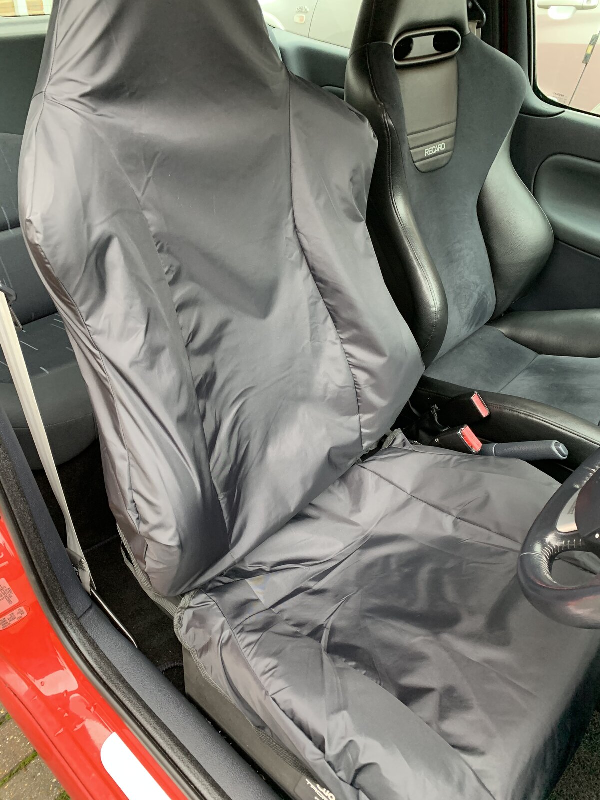

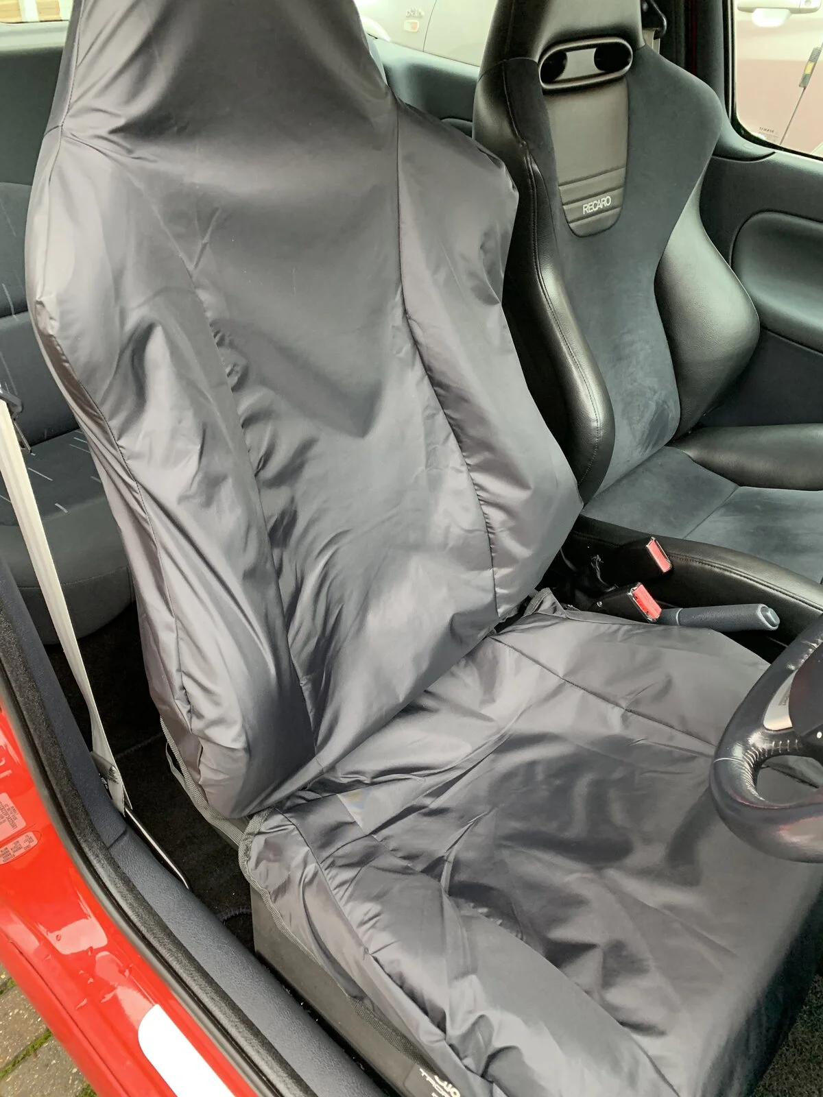

Bought a seat cover for the driver’s side. Normally only me in the car if I take it out, but am thinking of getting another for the passenger side.

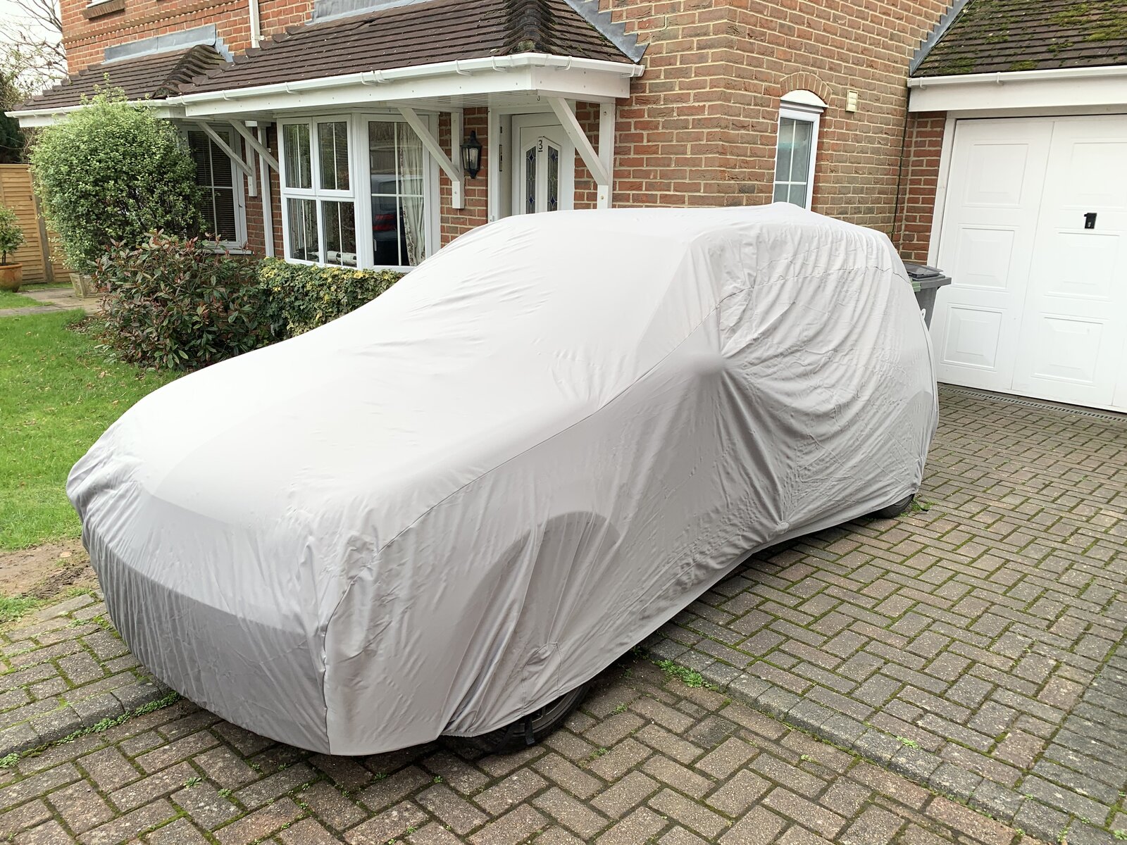

Also bought an outdoor cover from Classic Additions. Instead of getting one tailor made for the Clio, I opted for the “Small” universal one which is what they said was suitable for my car, and it was a bit cheaper.
Really nice quality cover, but I would probably pay the extra for a tailored one if I had the choice again, as there are just a couple of places where it is a bit tight, but on the whole I am pleased with it and protects the car in bad weather.

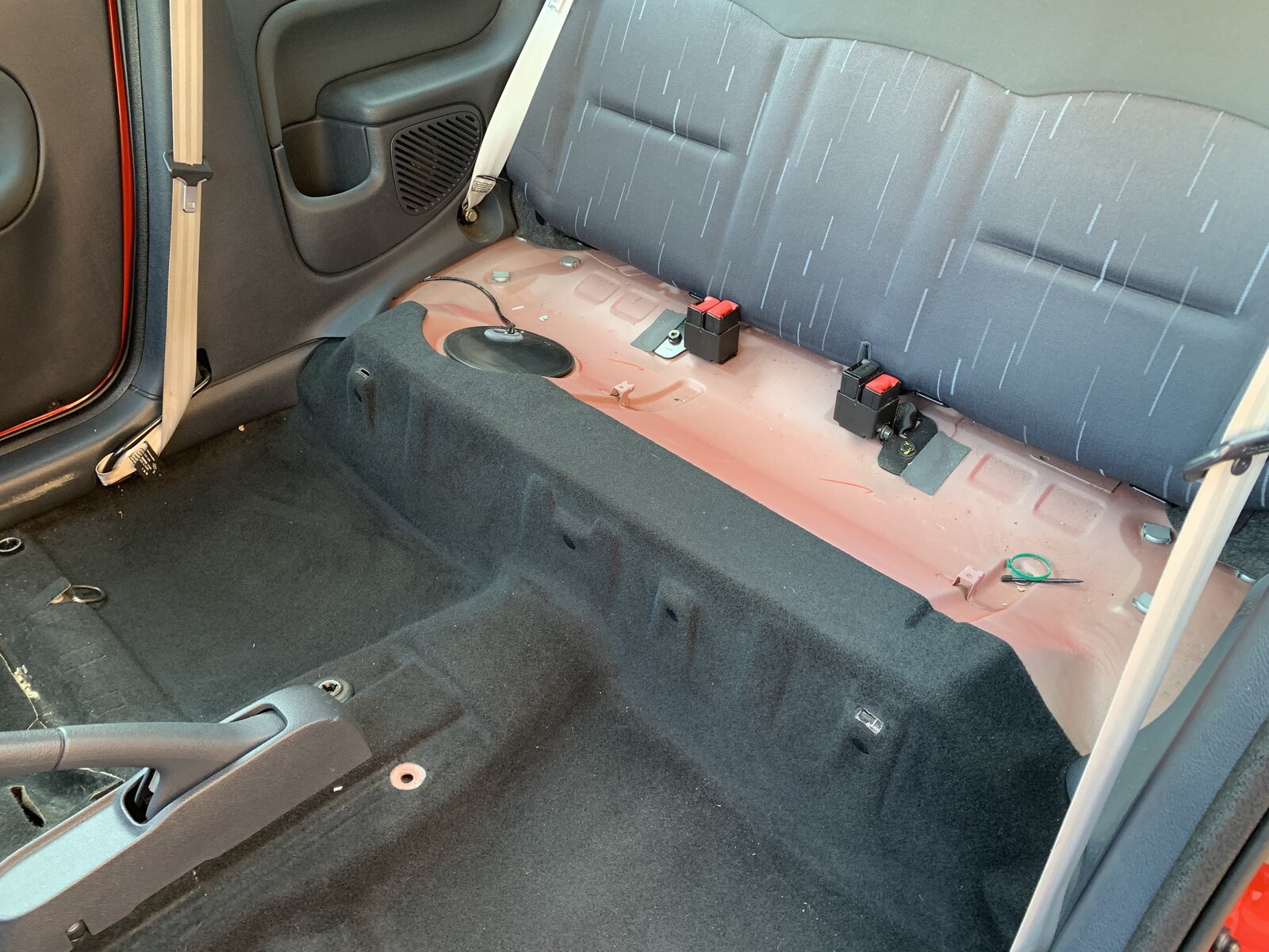

This weekend, I decided to get round to a job I have been wanting to do for ages, getting rid of all the stickers that were on the car when I bought it...
No after pictures, but all these have now been removed and it looks a lot better!

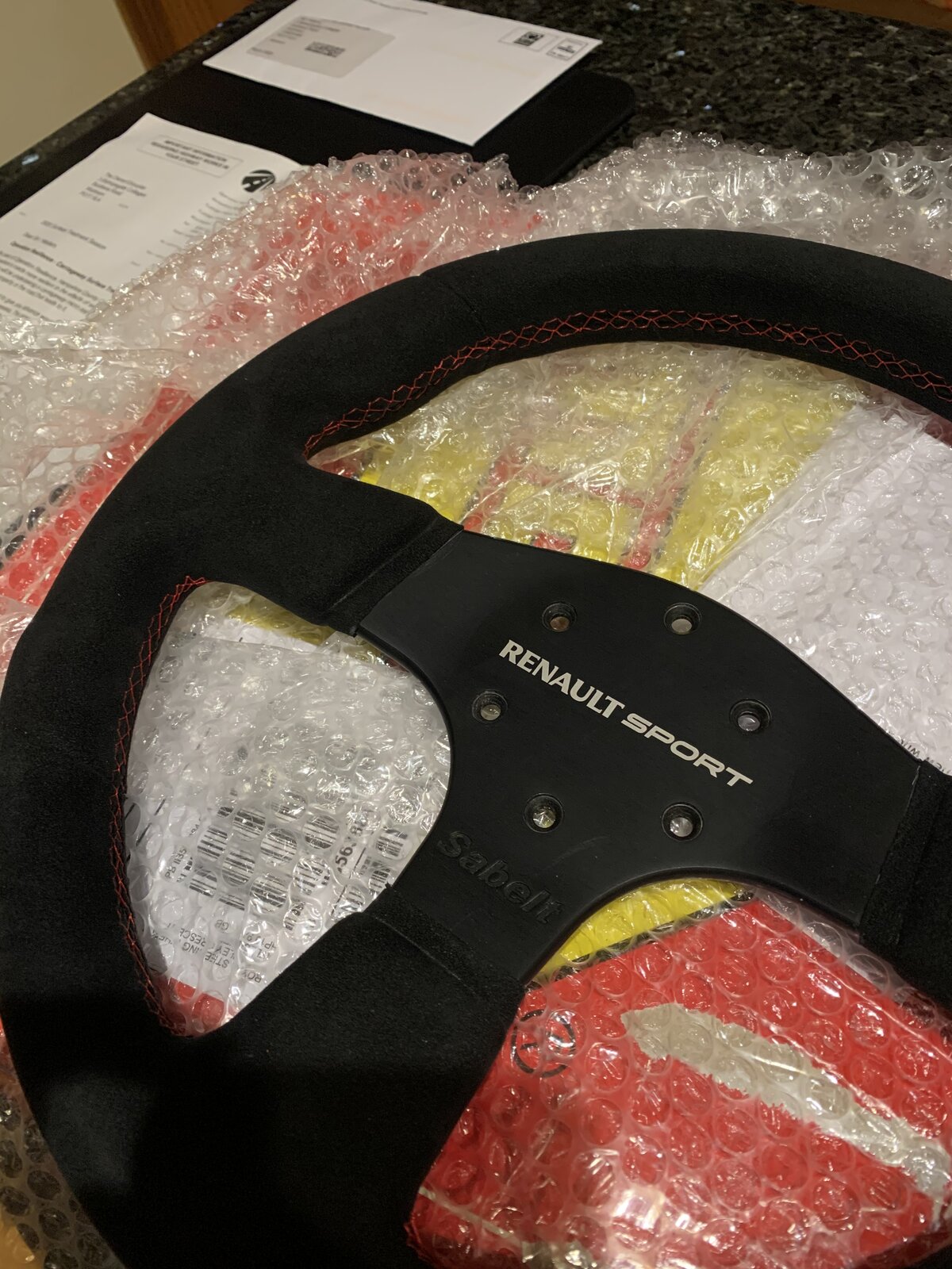

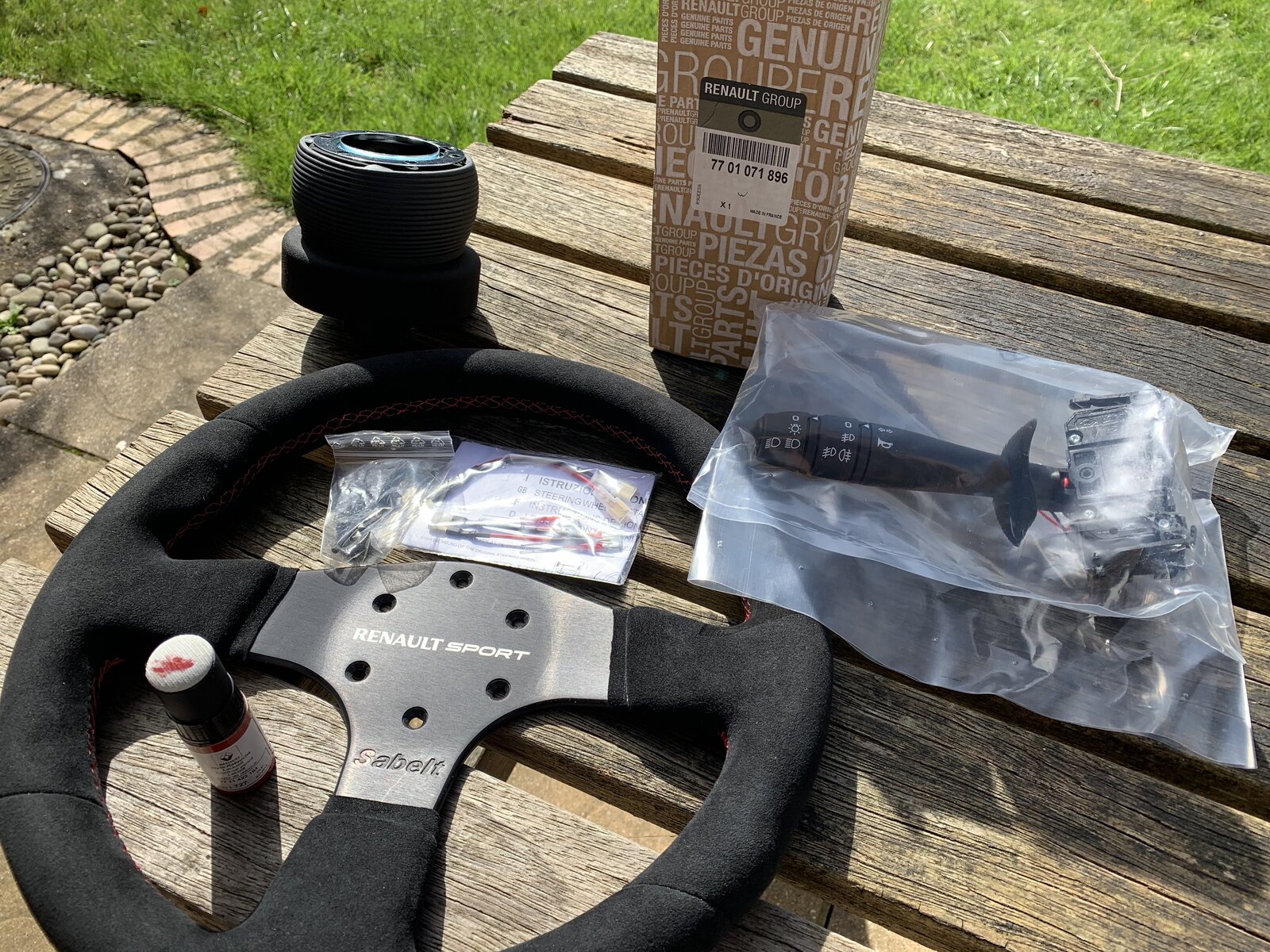

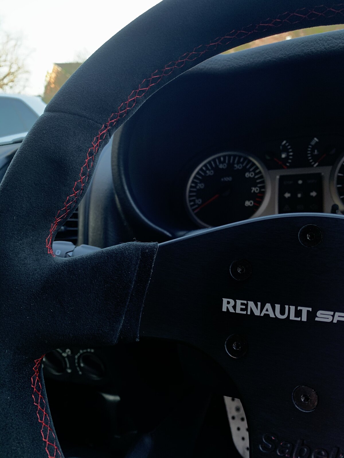

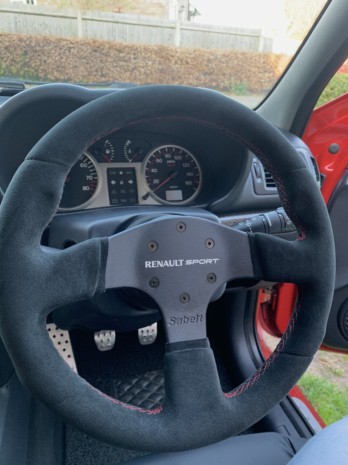

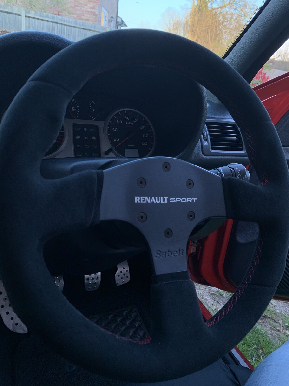

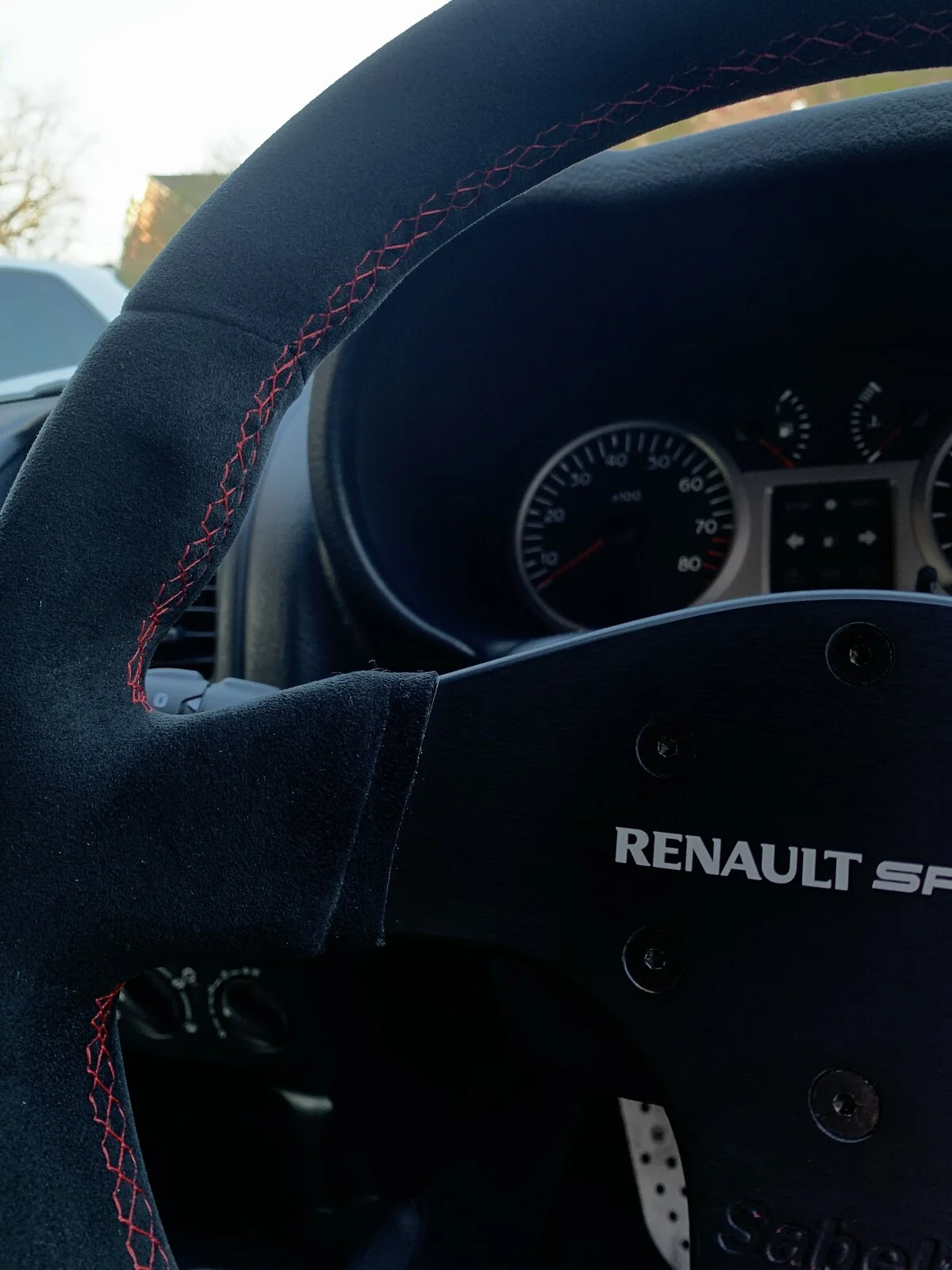

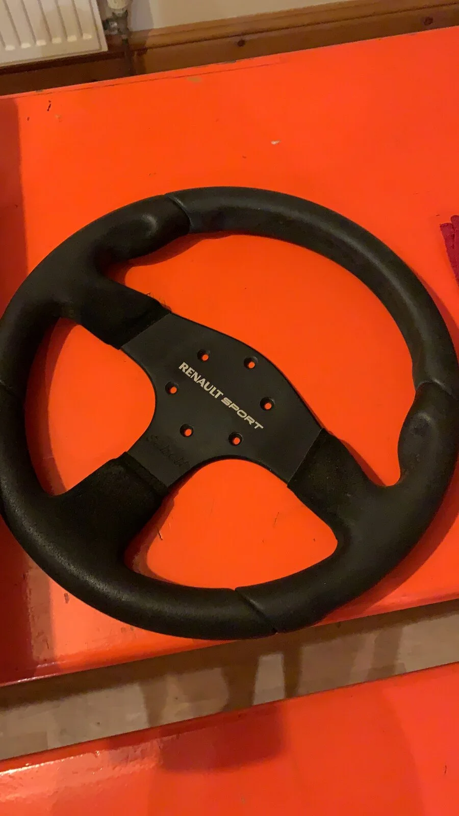

Few weeks back, I got hold of a Sabelt steering wheel...
...and then sent it off to Royal Steering Wheels to be retrimmed in alcantara with red stitching. Arrived a week or two ago...

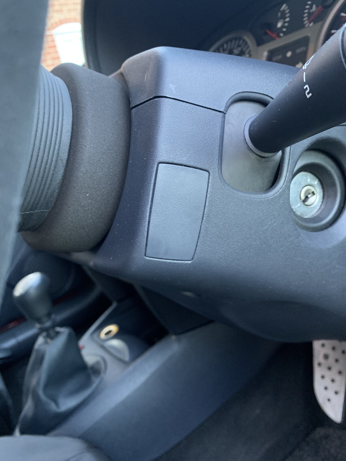

Also had my steering wheel boss arrived from K-Tec, and managed to source a brand new Ph1 indicator stalk with horn push on the end for a very reasonable price on eBay. So set about fitting all this yesterday...
And finished results..

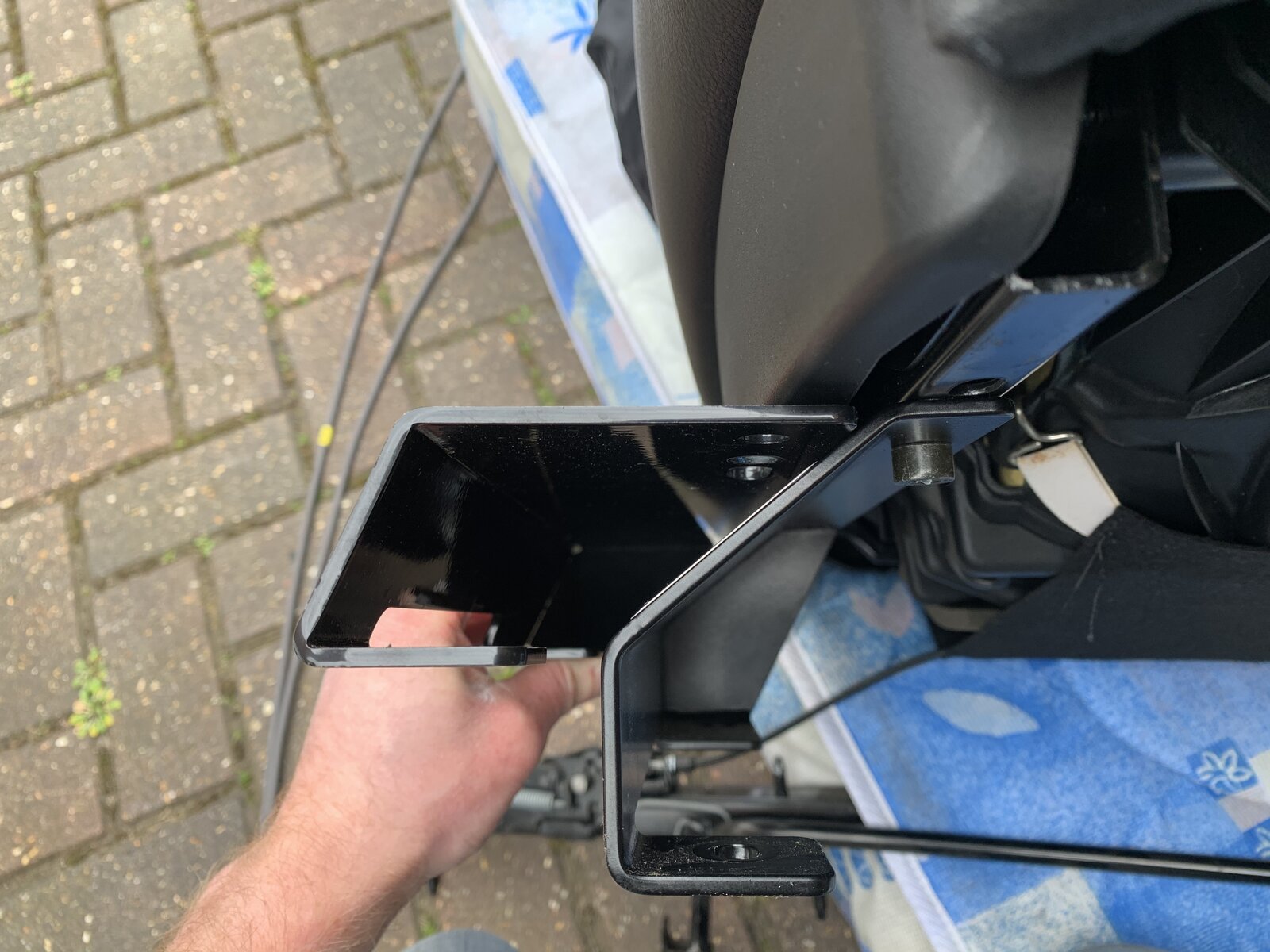

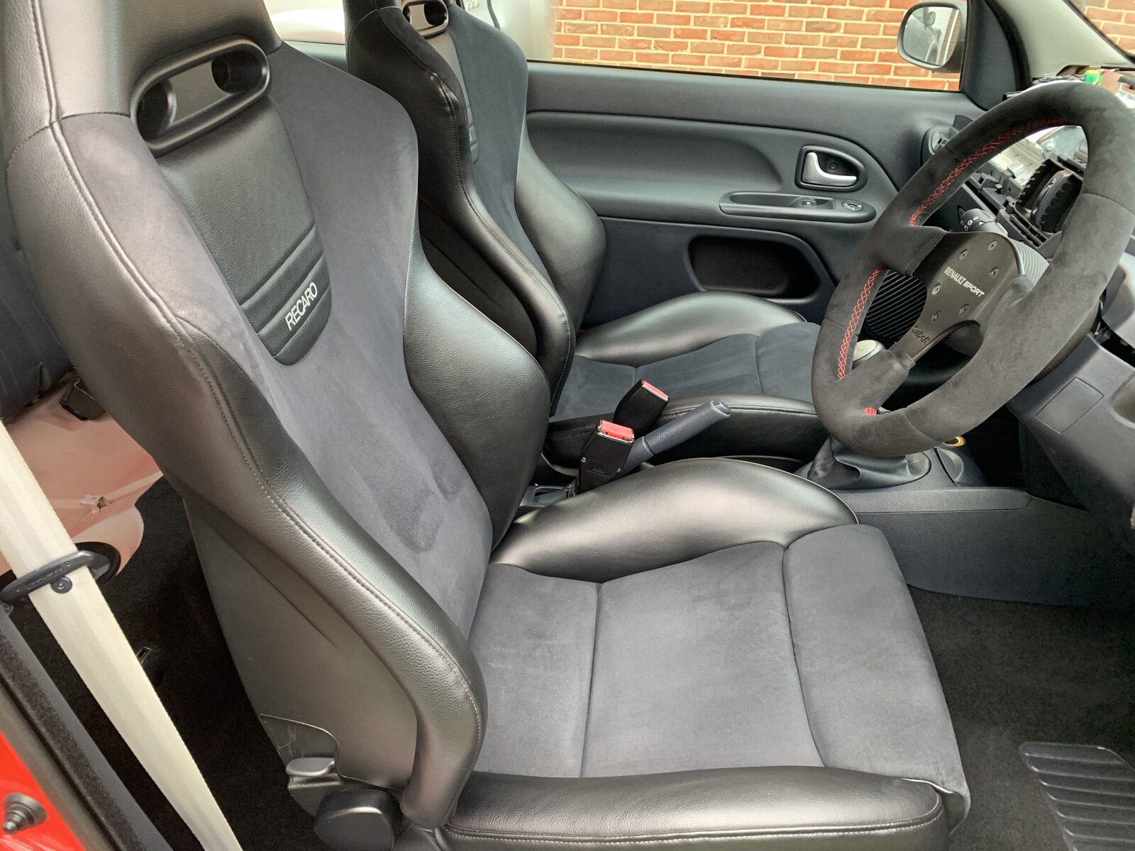

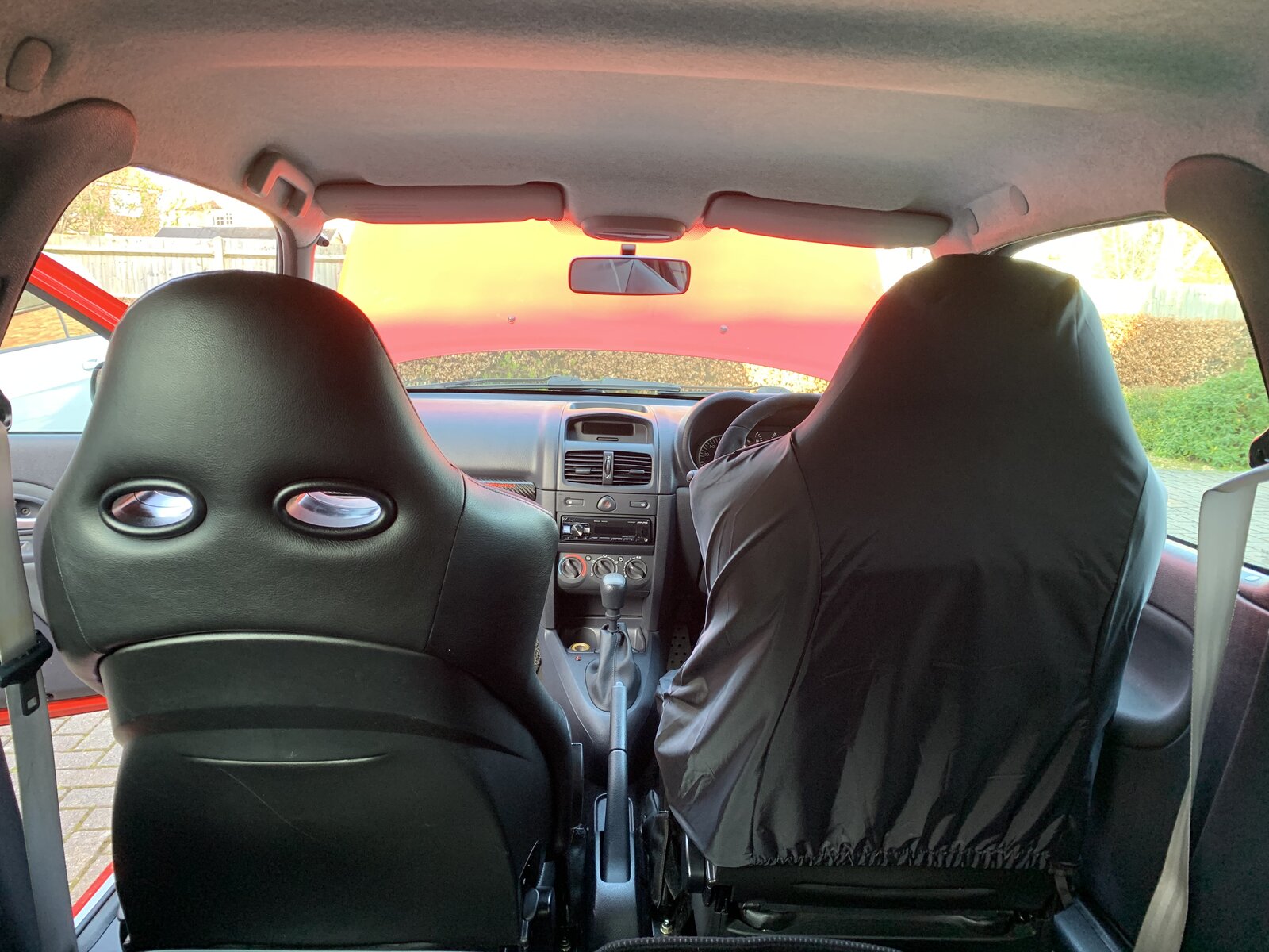

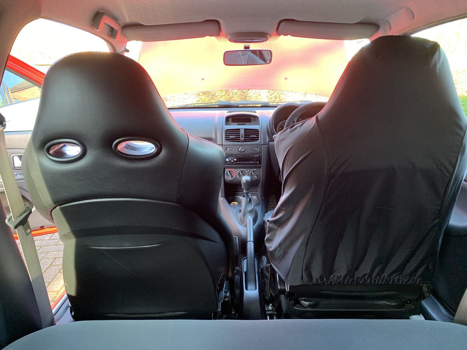

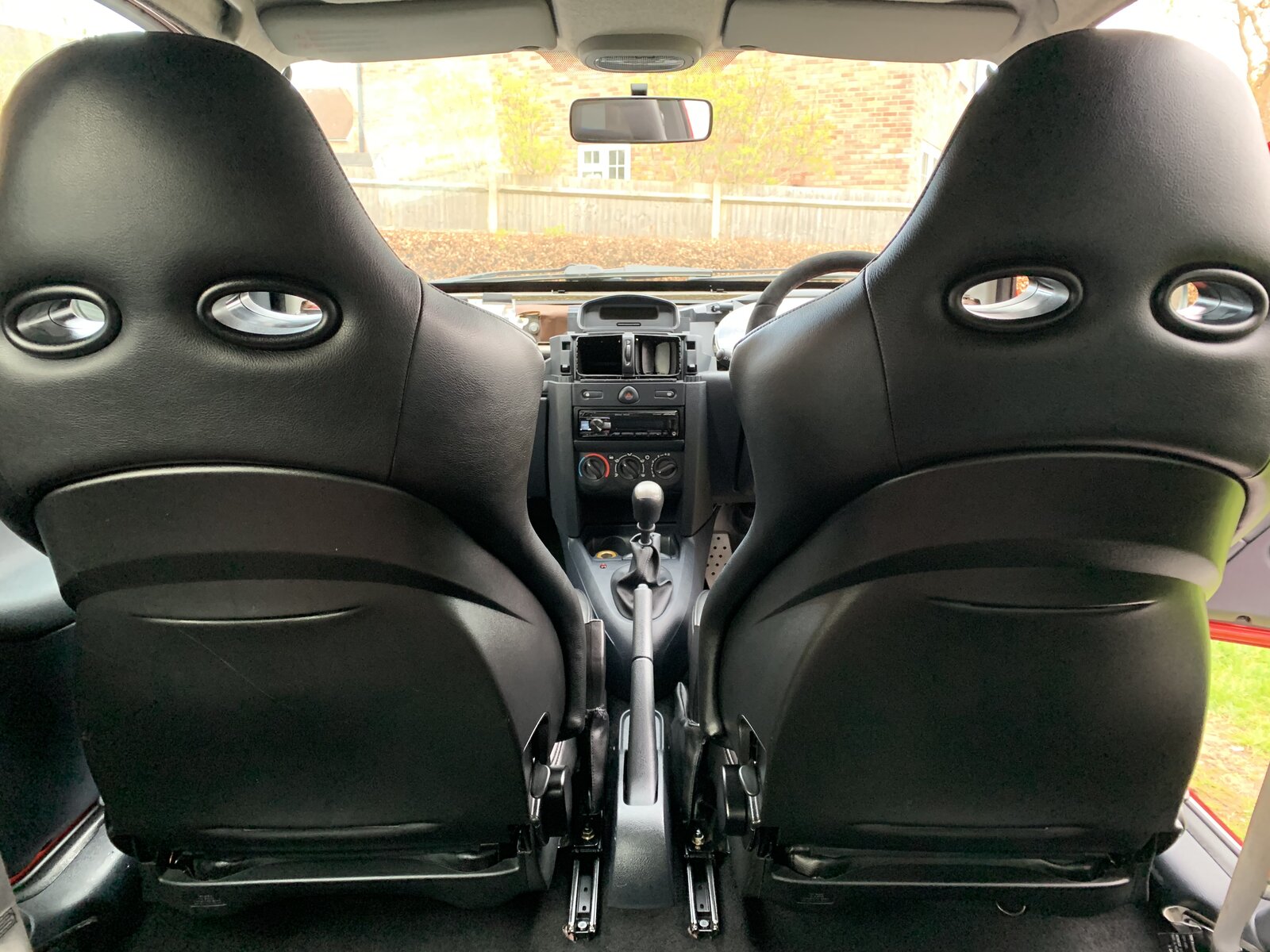

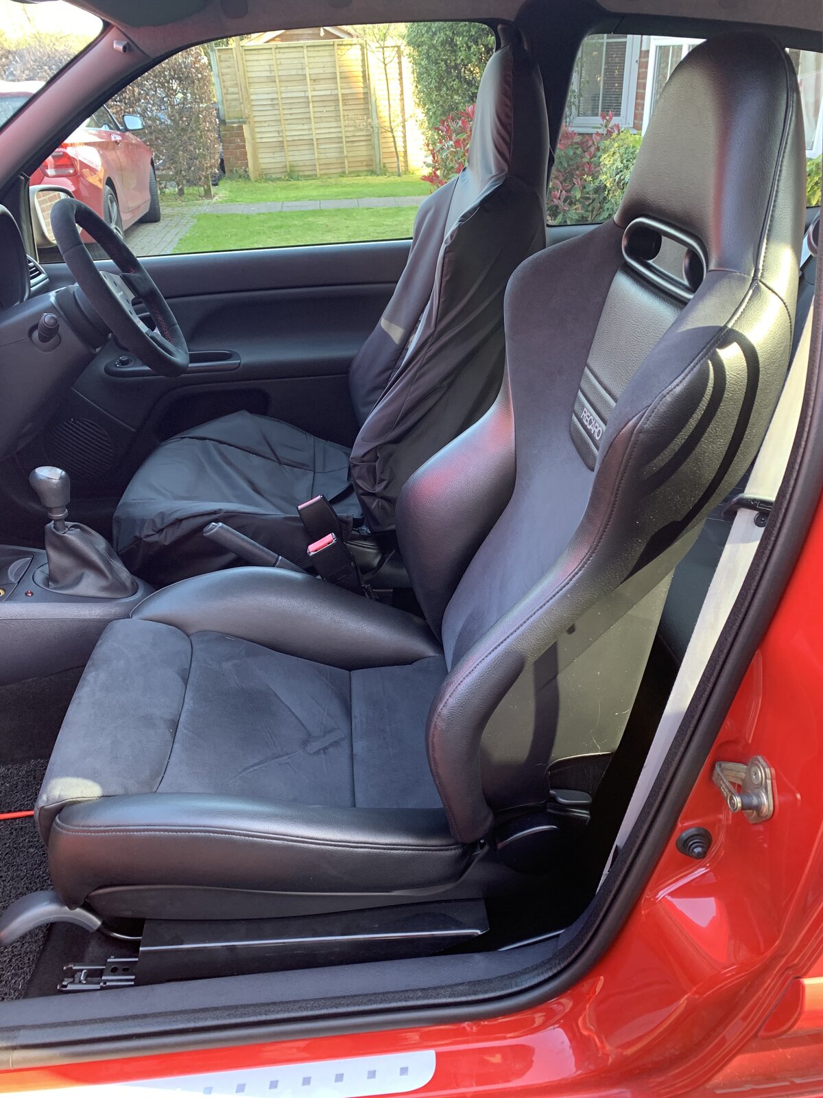

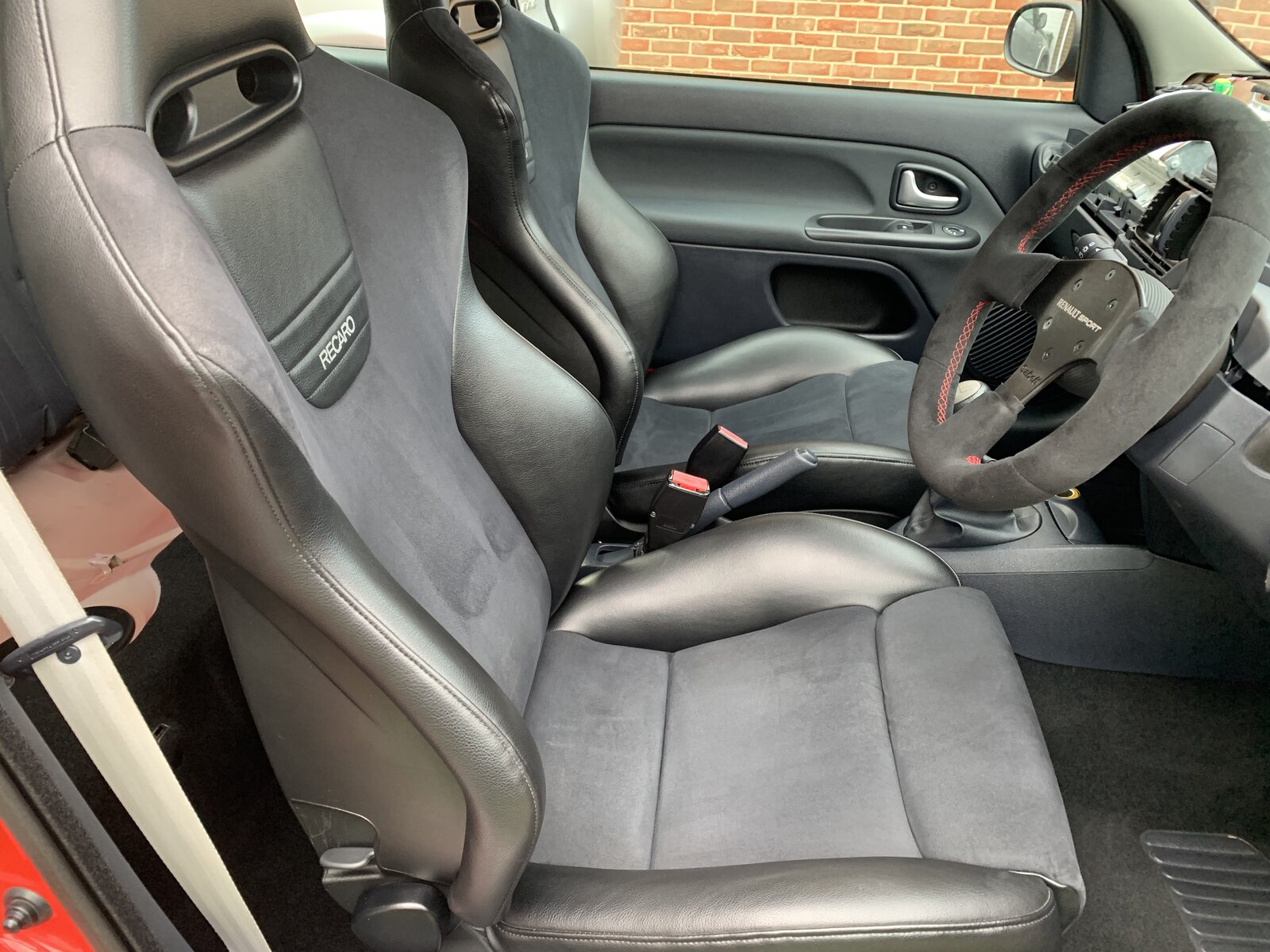

I bought some Jon Foz lowered Recaro adapters just before I actually purchased the Trophy!
No pictures of the adapters, but made a start on fitting them.
Got the car on axle stands so I could get to all the bolts underneath...

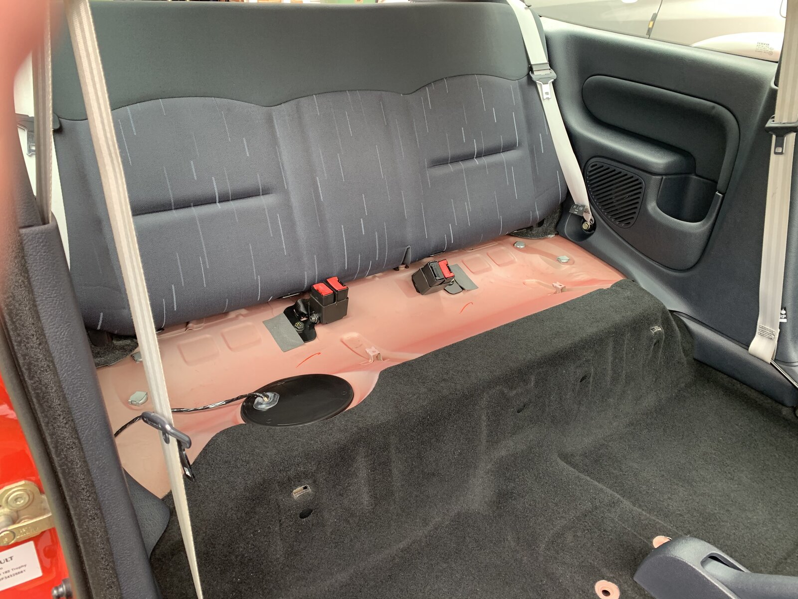

Before picture from the boot...
Got the passenger side out (seats are heavy!) and took the opportunity to hoover...
Swapped the adapters over and refitted the Recaro, voila...
You can see the difference from behind...
You can tell by looking at the line/groove at the bottom of the passenger seat, against where it is on the drivers side (just below where the seat cover ends).

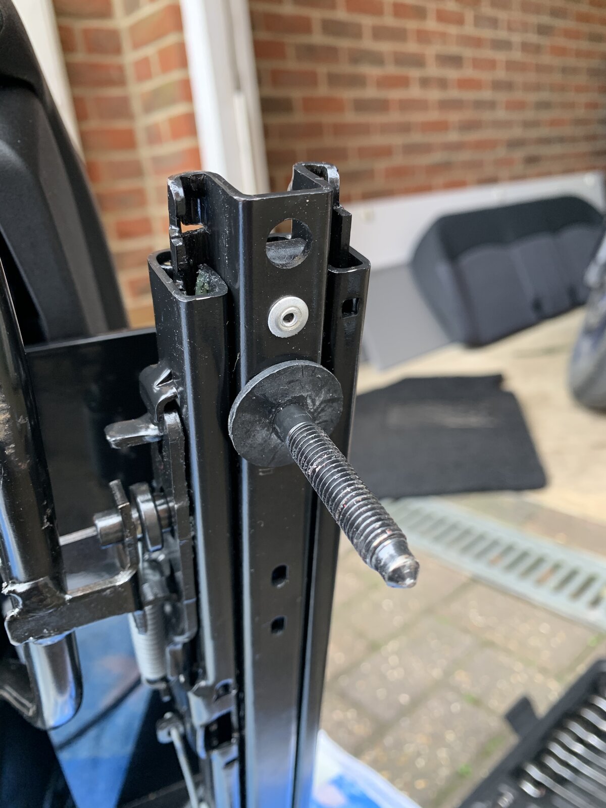

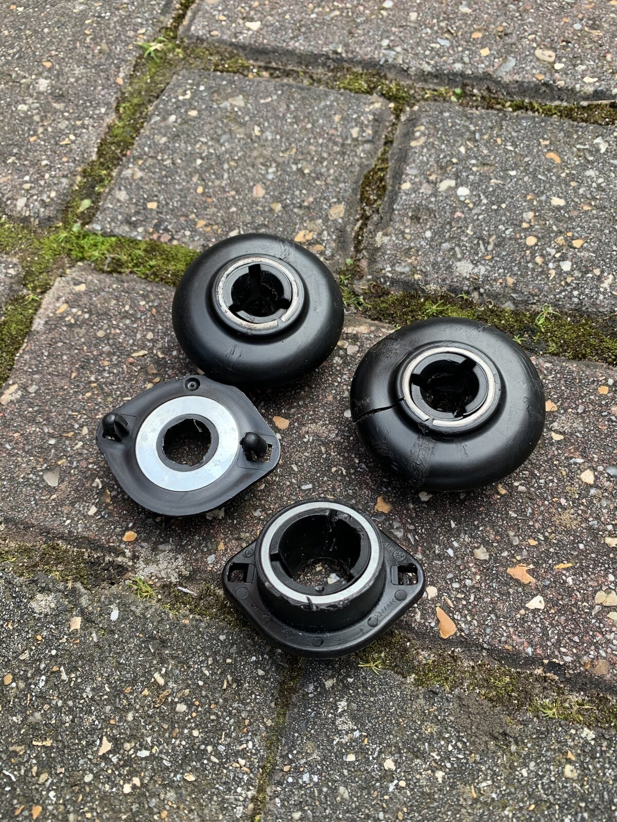

Came across a problem though. The seat would not lock into the sliders, so it was just going backward and forward on the rails. Ended up taking the seat out again; turns out I hadn’t properly modified the handle slider bar first time around. So I adjusted it and went to fit the seat again.
Second attempt of fitting the seat, and I just could not get the studs on the rails to line up with the grommets/rubber bungs on the interior. The furthest away one kept coming out of its slot every time I got the stud near. This was really starting to p**s me off! Especially as it is hard work constantly picking up the seats, bloody heavy for what they are.
In the end I decided to remove all 4 rubber grommet/spacers which has probably given me another 5-10mm over what the adapters give. Sure I have read before that others have simply just removed these to get the seats a tad lower.
If you don’t know what I mean by the grommets/spacers, it’s these things...
With them removed, I got the seat back in and nipped up from underneath the car. This time round, the slider mechanism was working as it should do, hooray!
Another picture to show how they fit, even lower now those grommets have been removed...
I’d had enough by the time the passenger seat was fitted properly. So I will do the drivers side during the week or next weekend. Definitely very happy with how they are going to sit though!
Massive thanks to @JON FOZ for your help today on the phone, giving tips and info during fitting on a Sunday afternoon!

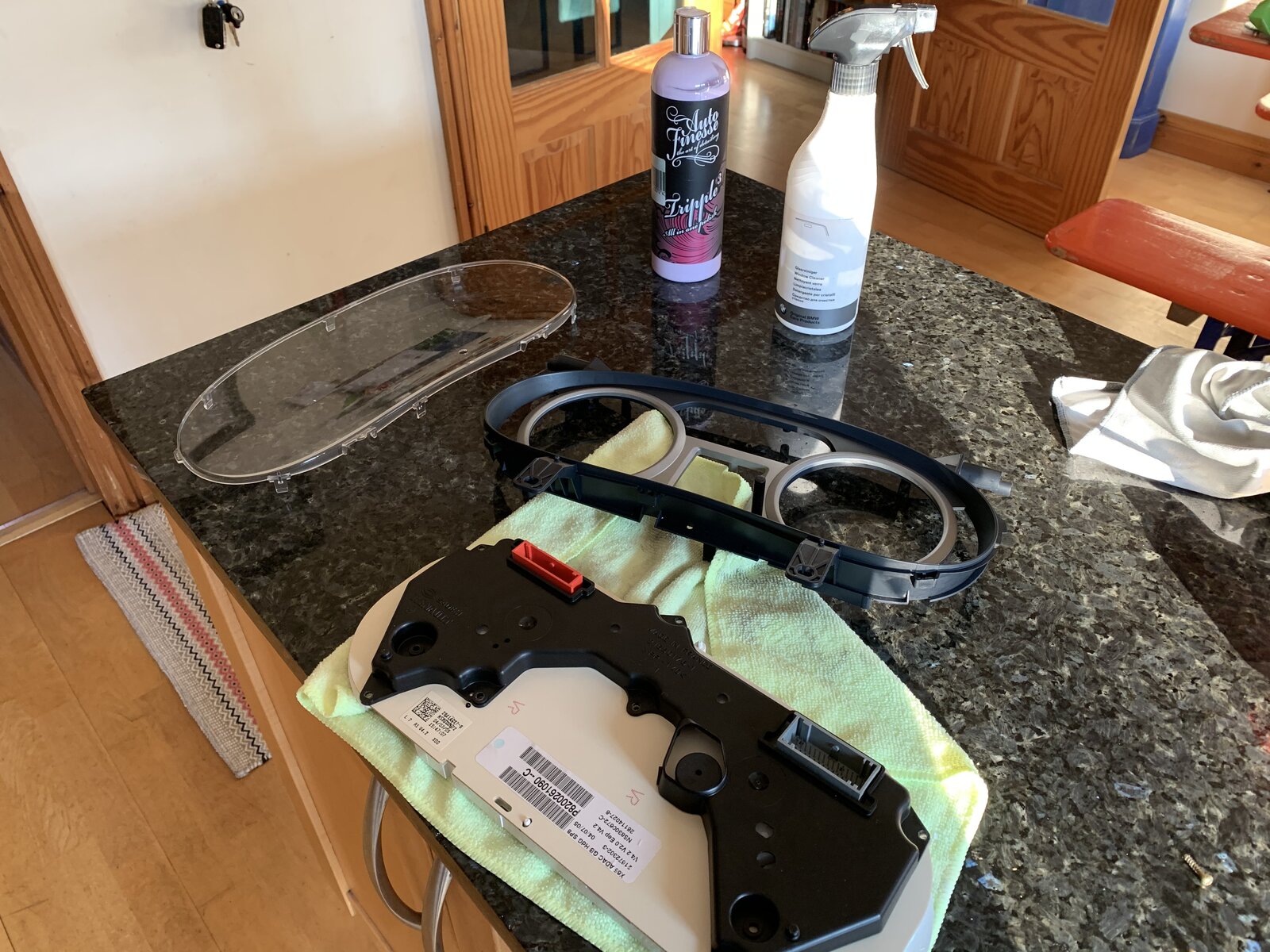

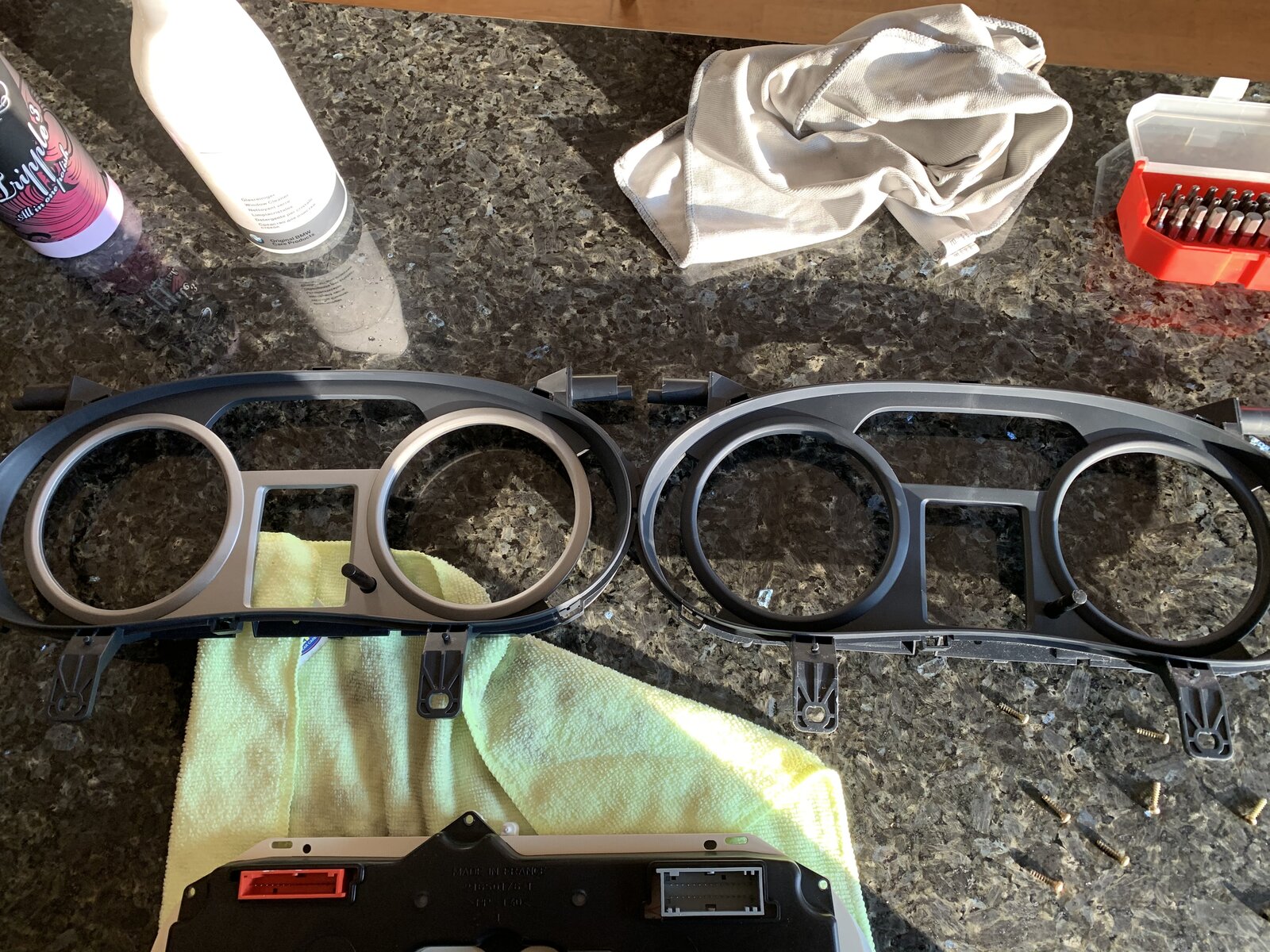

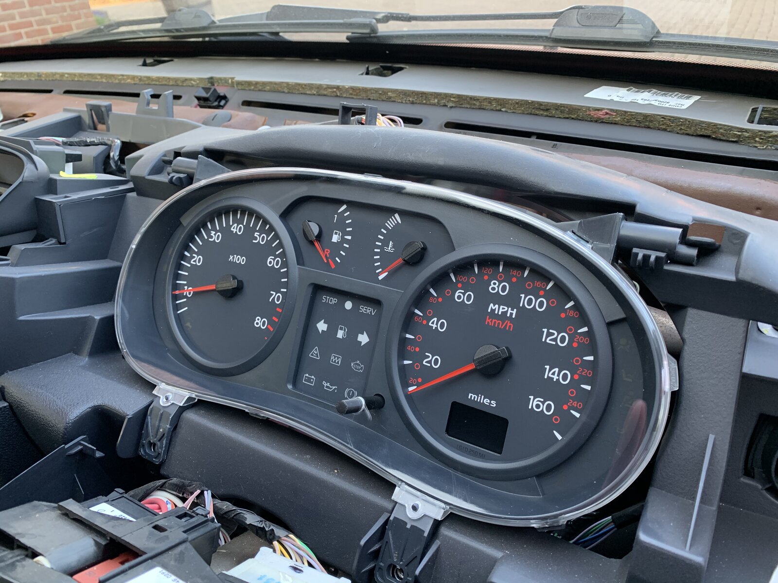

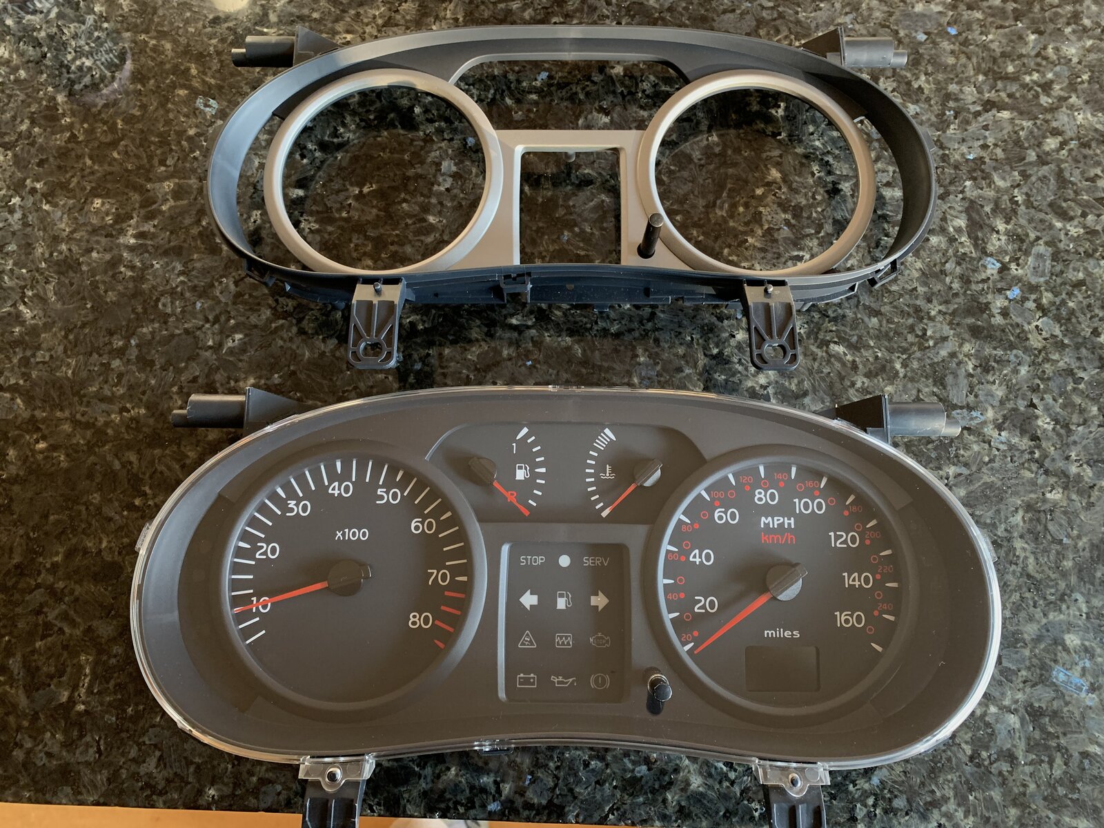

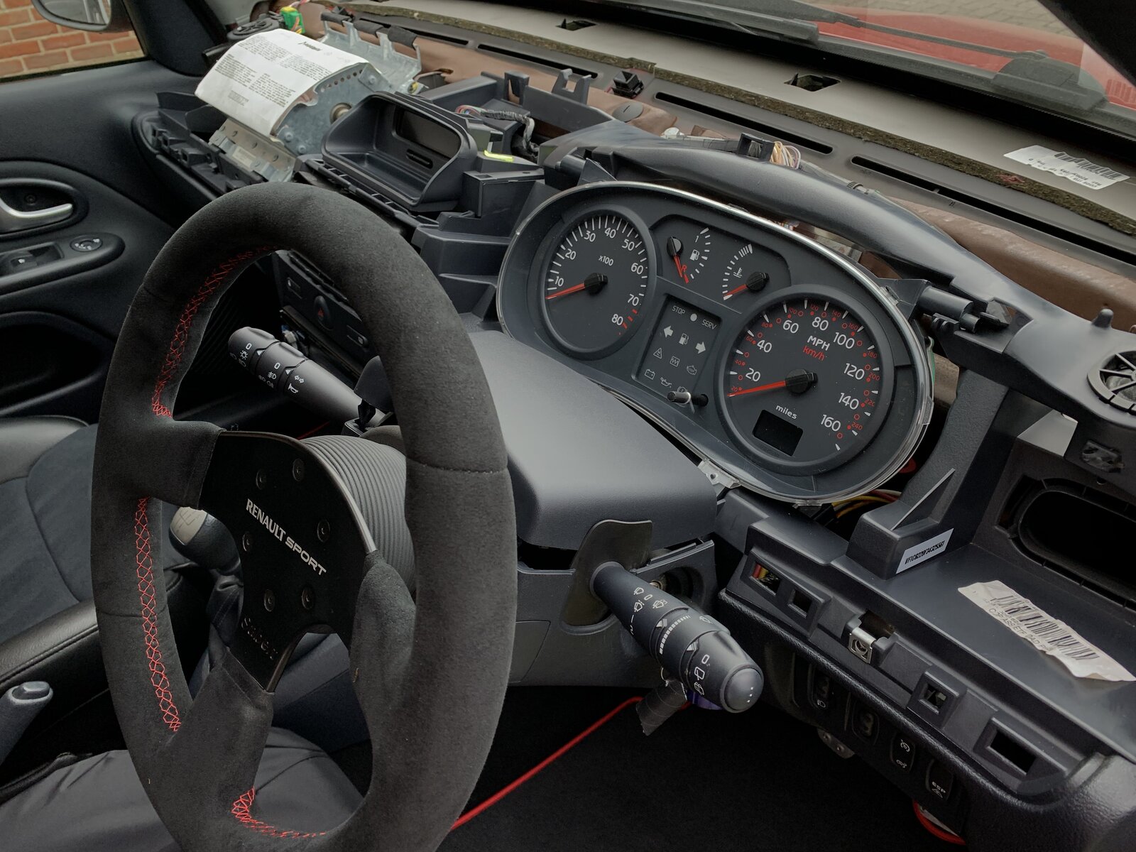

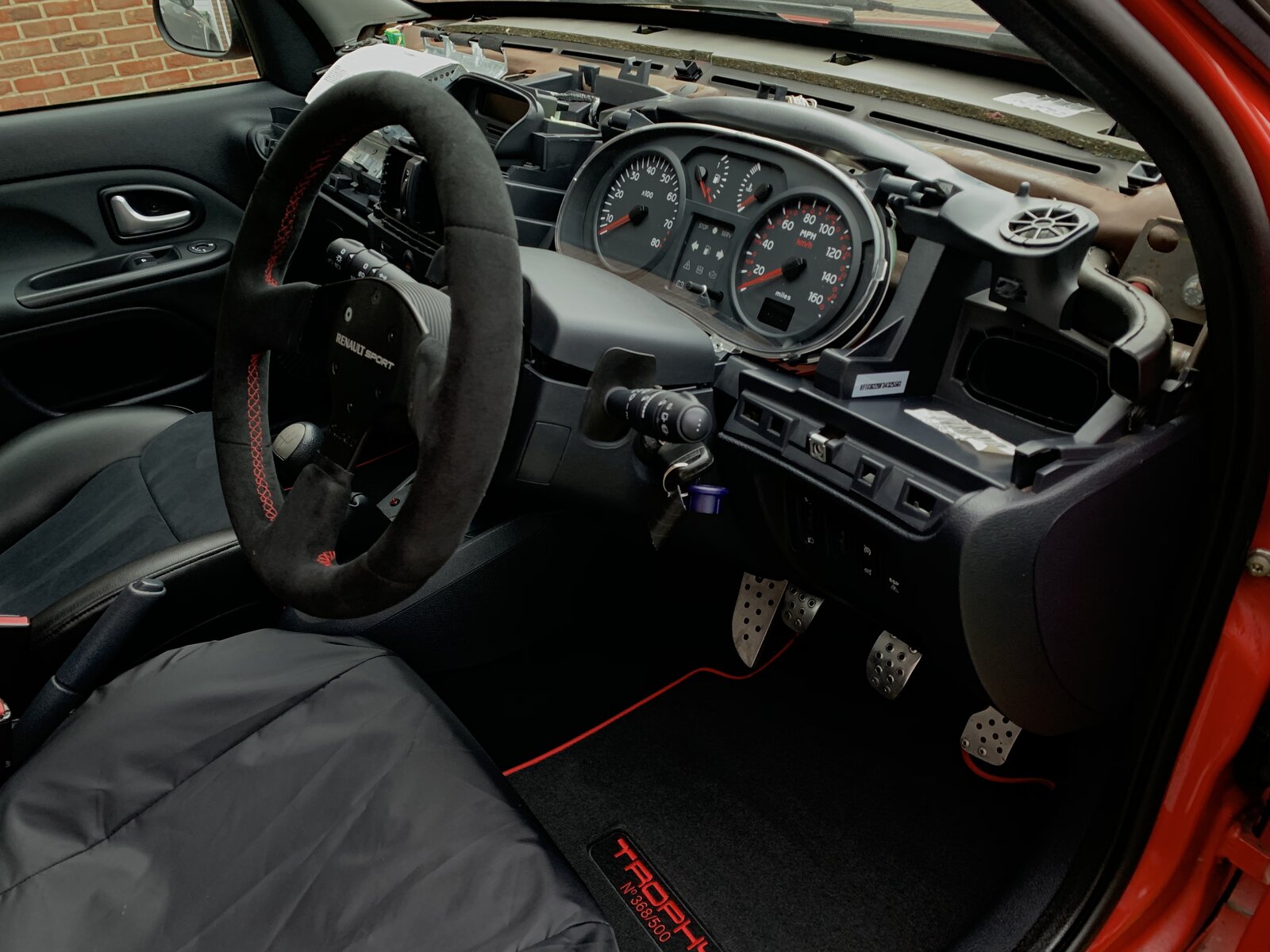

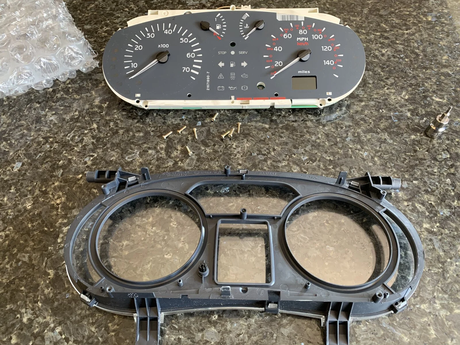

First up, changing the clock/dials surround. Never been a particularly big fan of the silver surround/bezel.

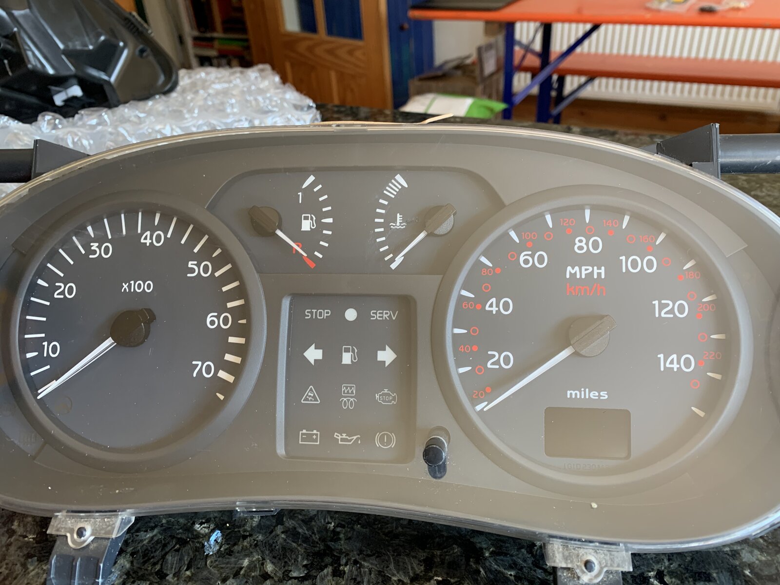

Found some dials from a Dci going cheap, which come with a matt black surround instead of silver.
Here they are…

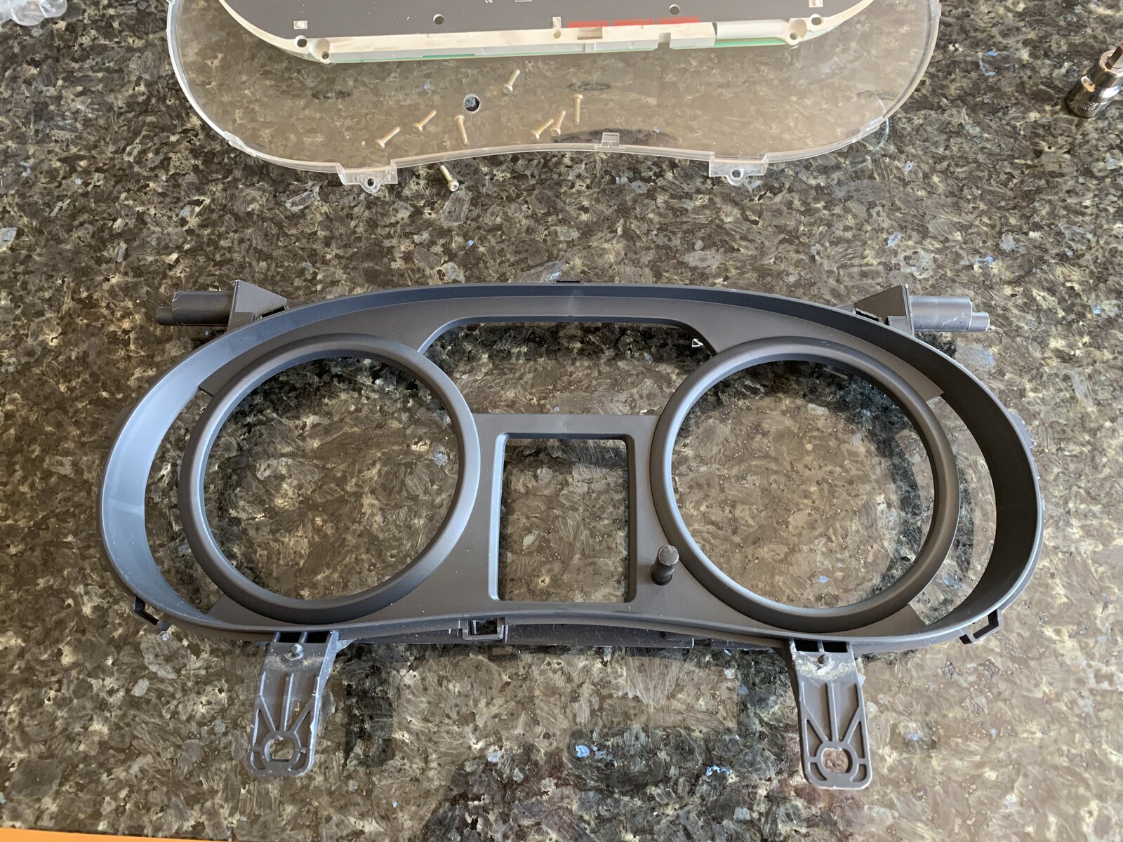

Set about stripping these down…

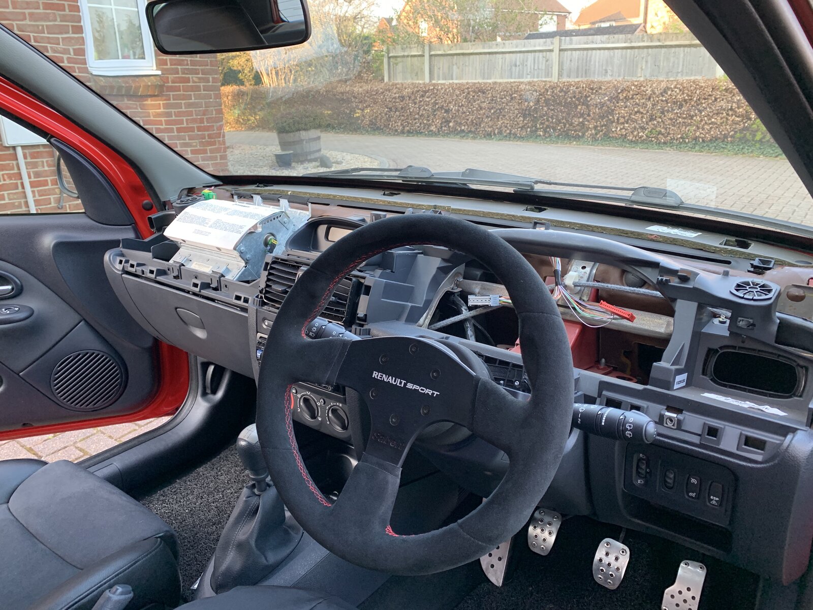

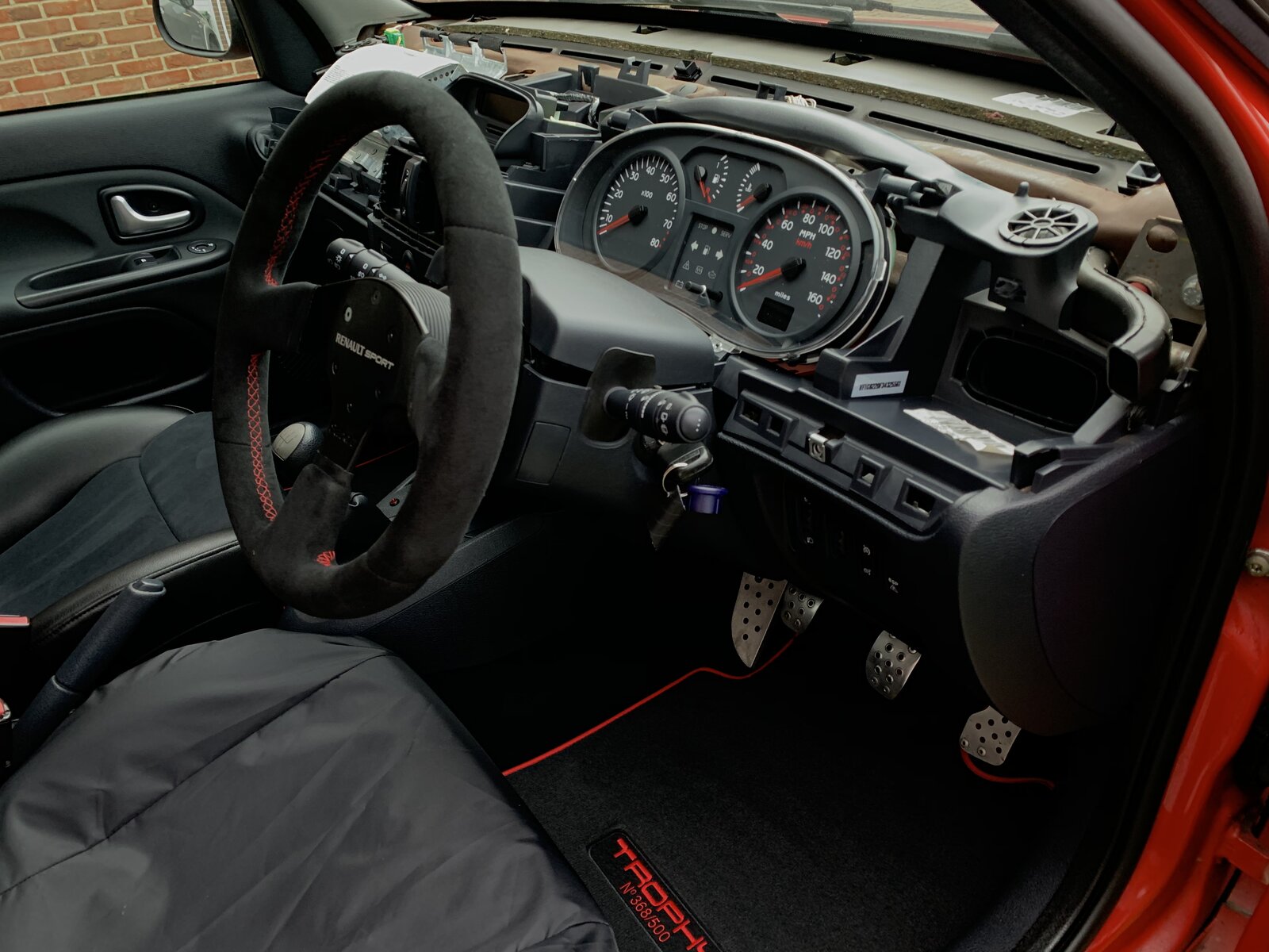

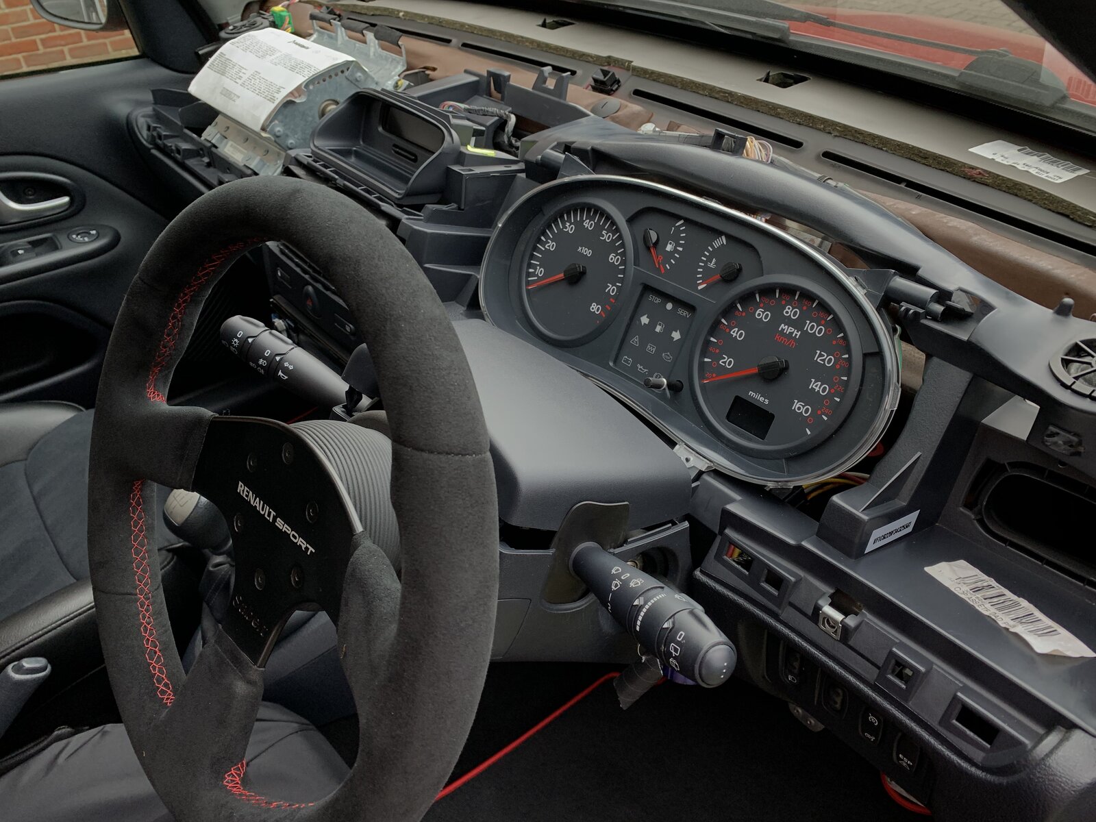

Then removed upper dash from the car so I could get the clocks in the car out…
And then set about swapping the surrounds over. Pretty easy job, and you end up with this…
How they look back in the car. For me, makes a big difference and looks much better. I also like the fact it is OEM finish and not painted.

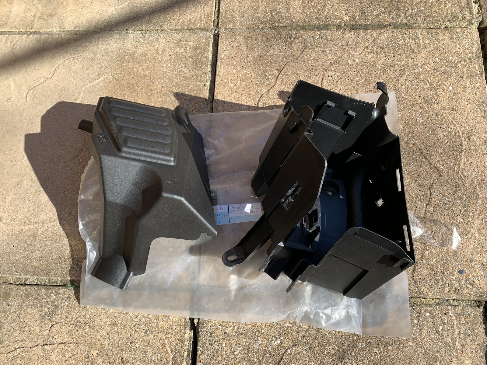

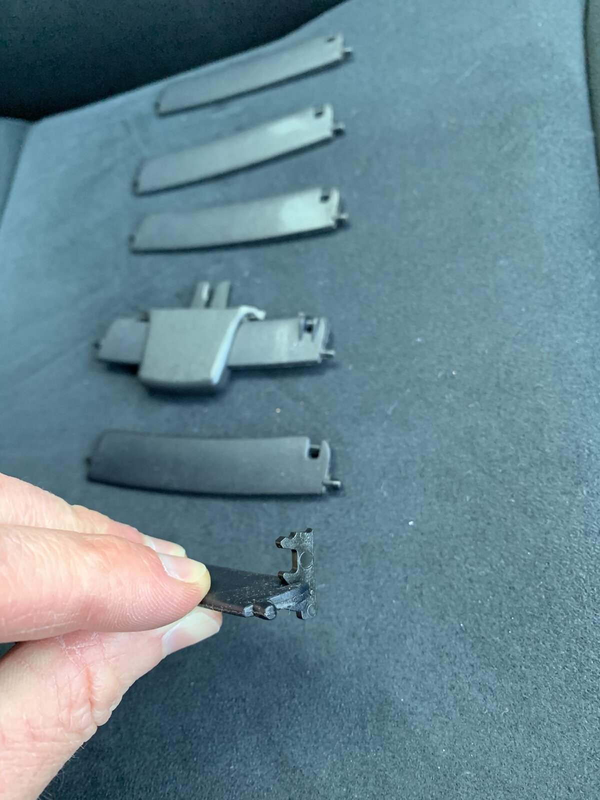

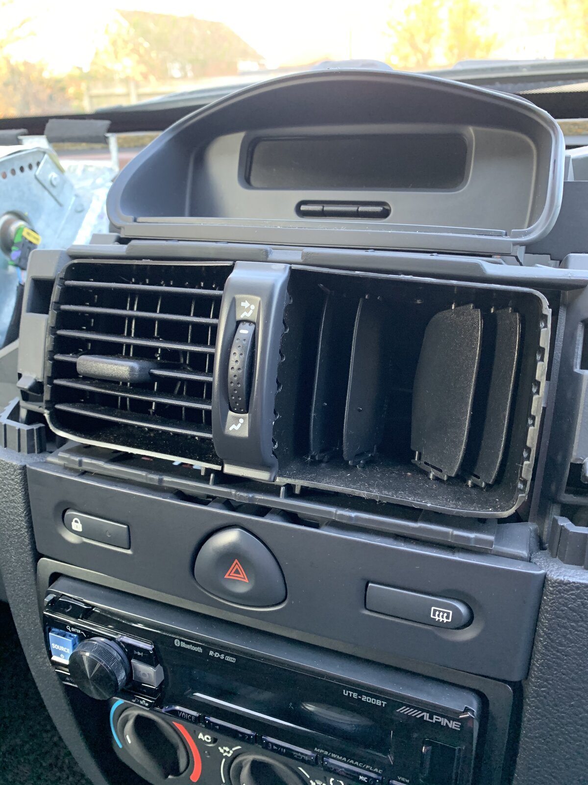

Whilst the upper dash was off, thought I would take a look at the centre heater vents, because the slats are all over the place and not connected up.
Turns out the little bars that the slats pop into have snapped. Definitely not able to get hold of new slider bars, so I was going to source a pair of single vents (ones furthest ends of the dash) and take them apart and use the parts from those. But a chap on the Facebook group reached out to me, and send if I send him the bars (one of them is still in tact), he will 3D print some for me – result!
Now just waiting to receive them back from him so I can sort the vents out. So the upper dash remains off for now until they arrive.

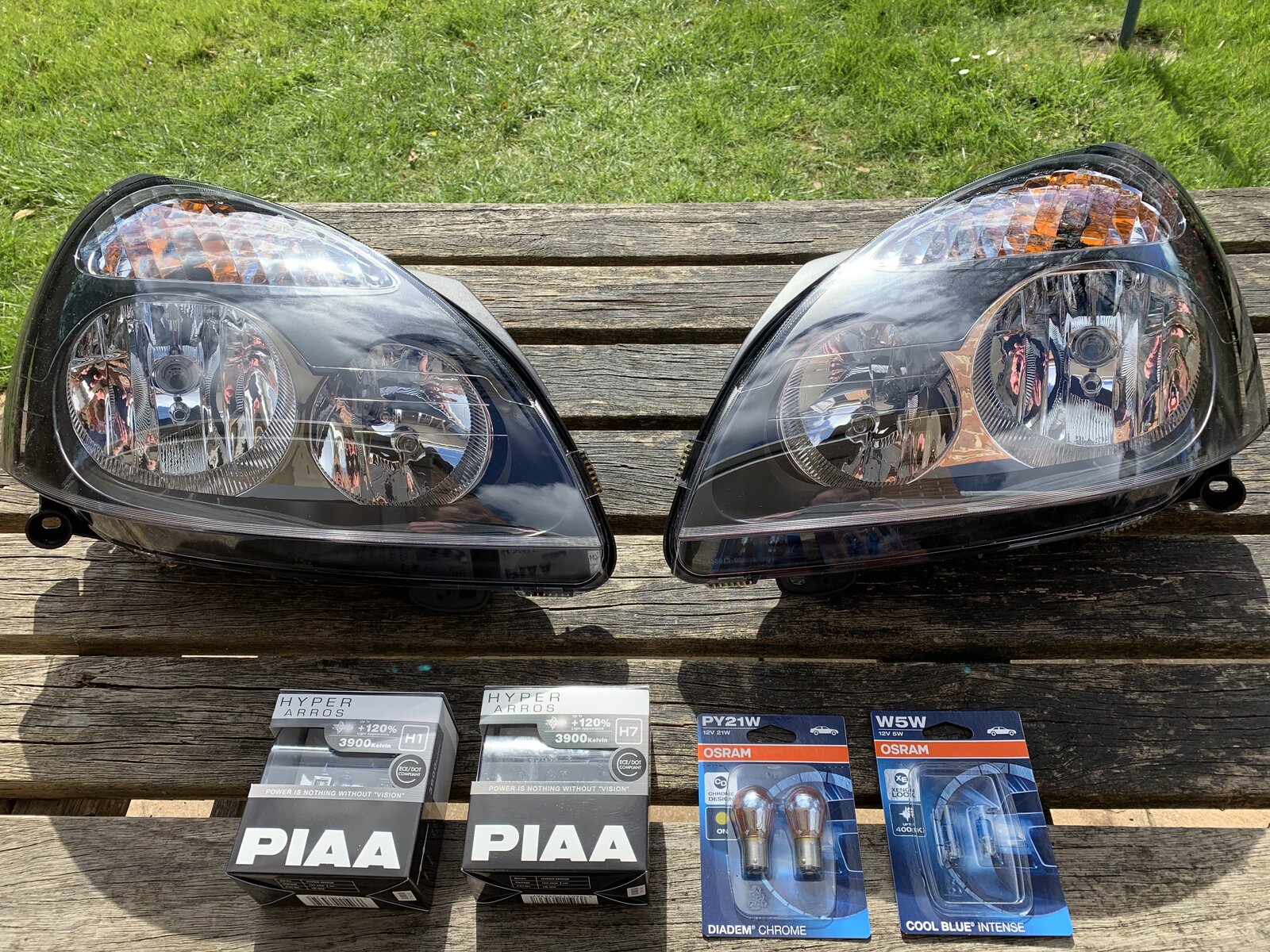

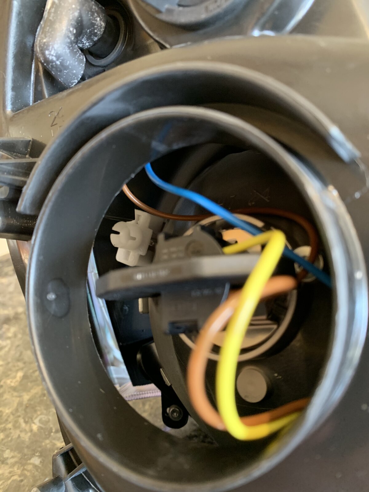

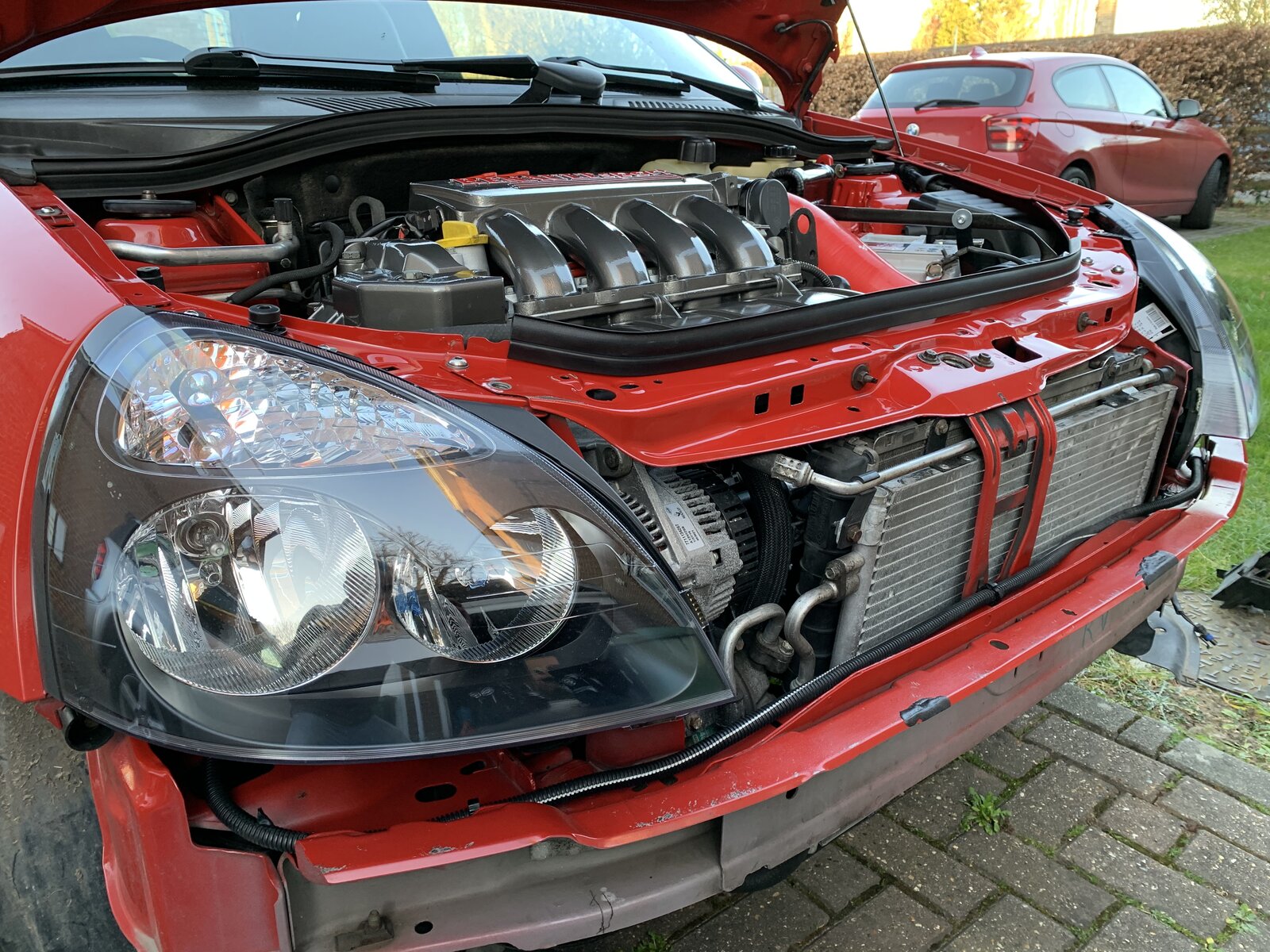

Next up, headlights!

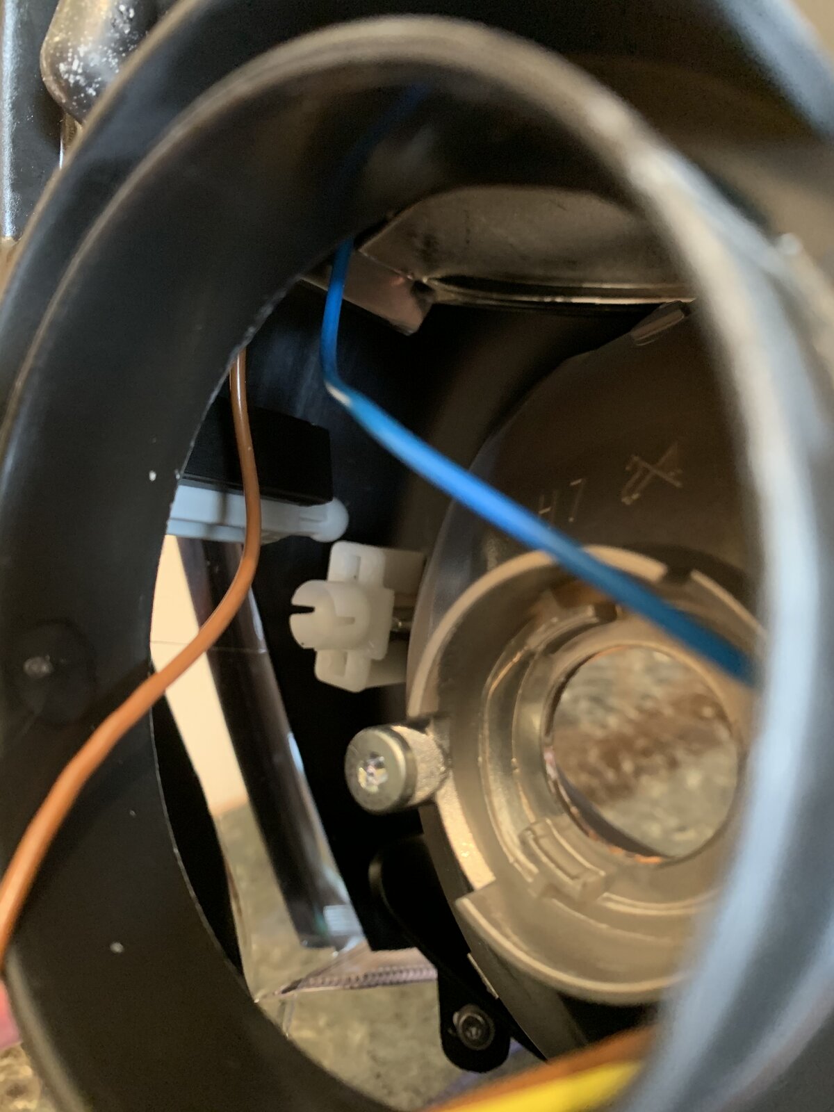

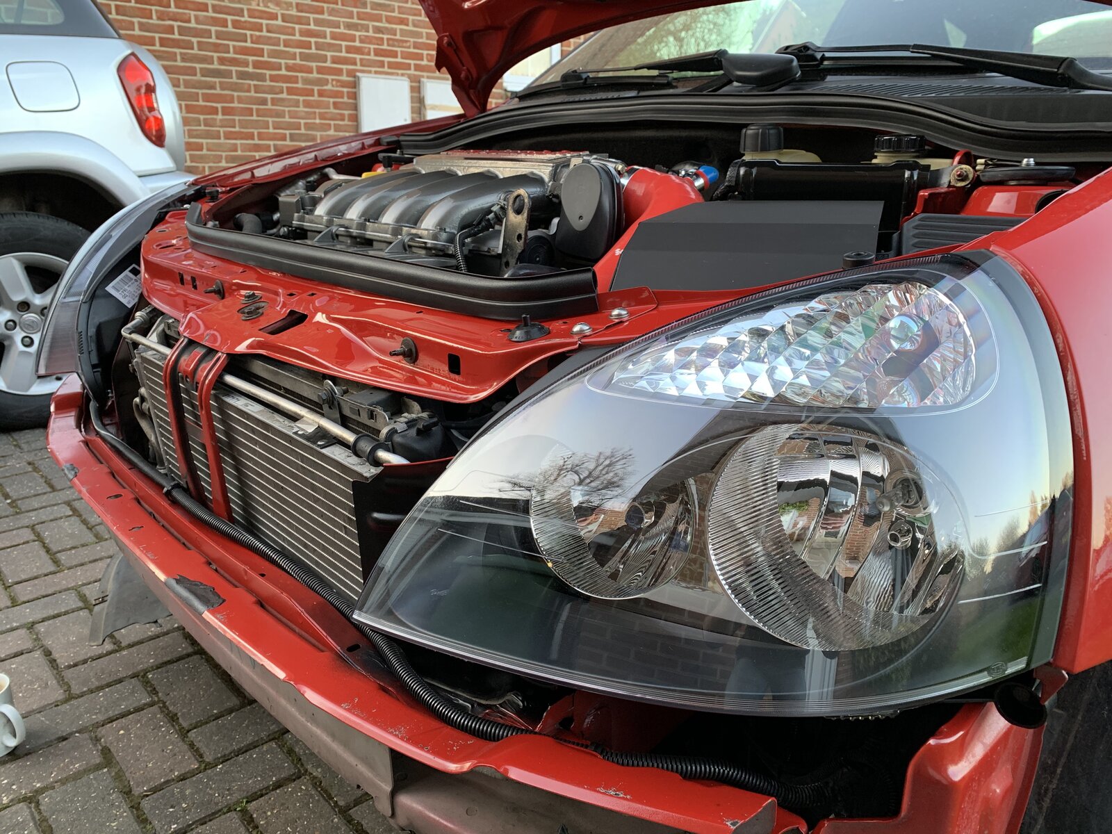

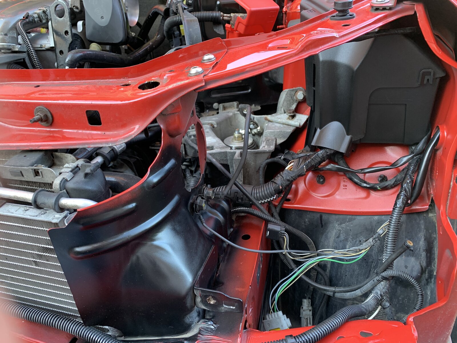

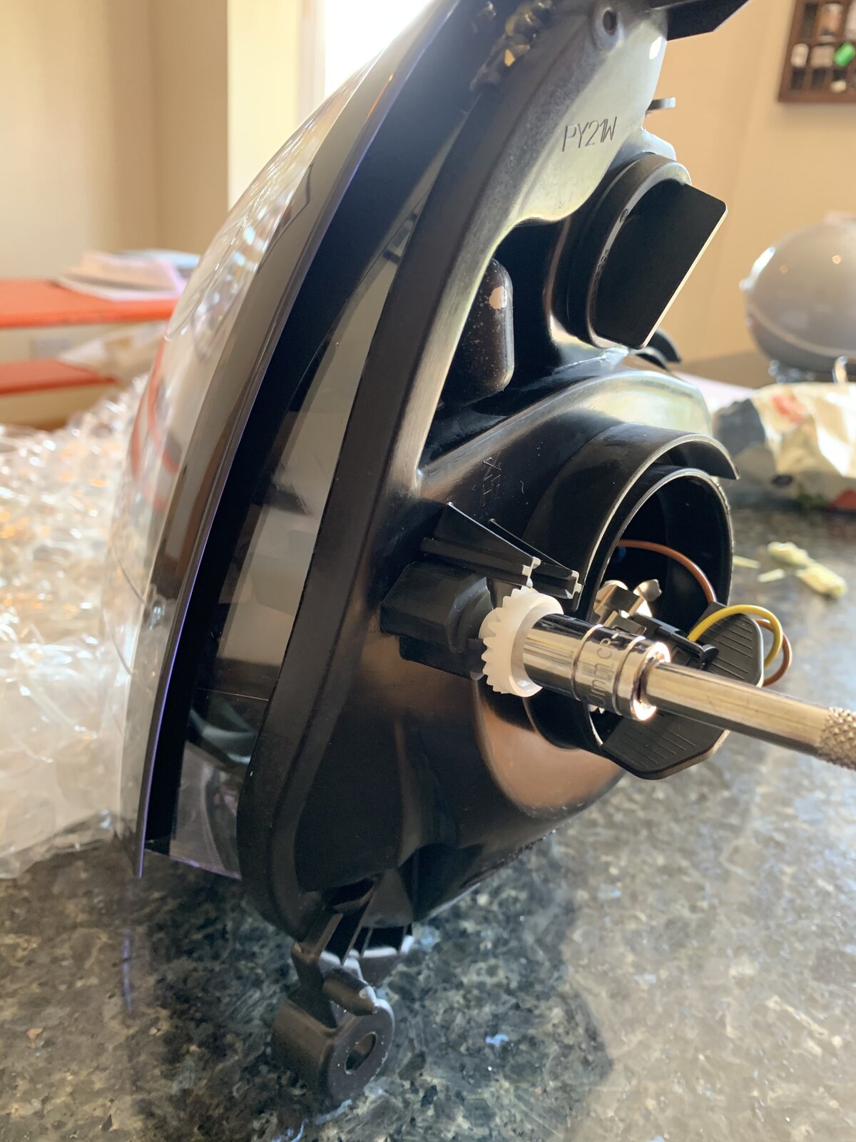

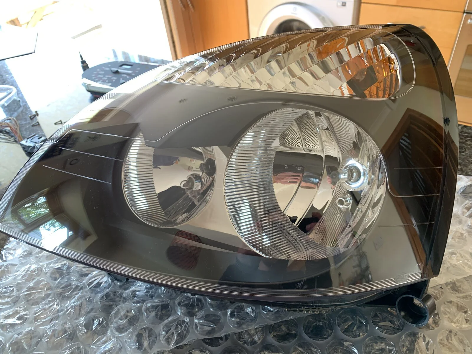

I recently bought a pair of brand new black insert Hella headlights (halogen not xenon) to replace the grey ones on the car. Mine are actually in great condition, just prefer the black ones.

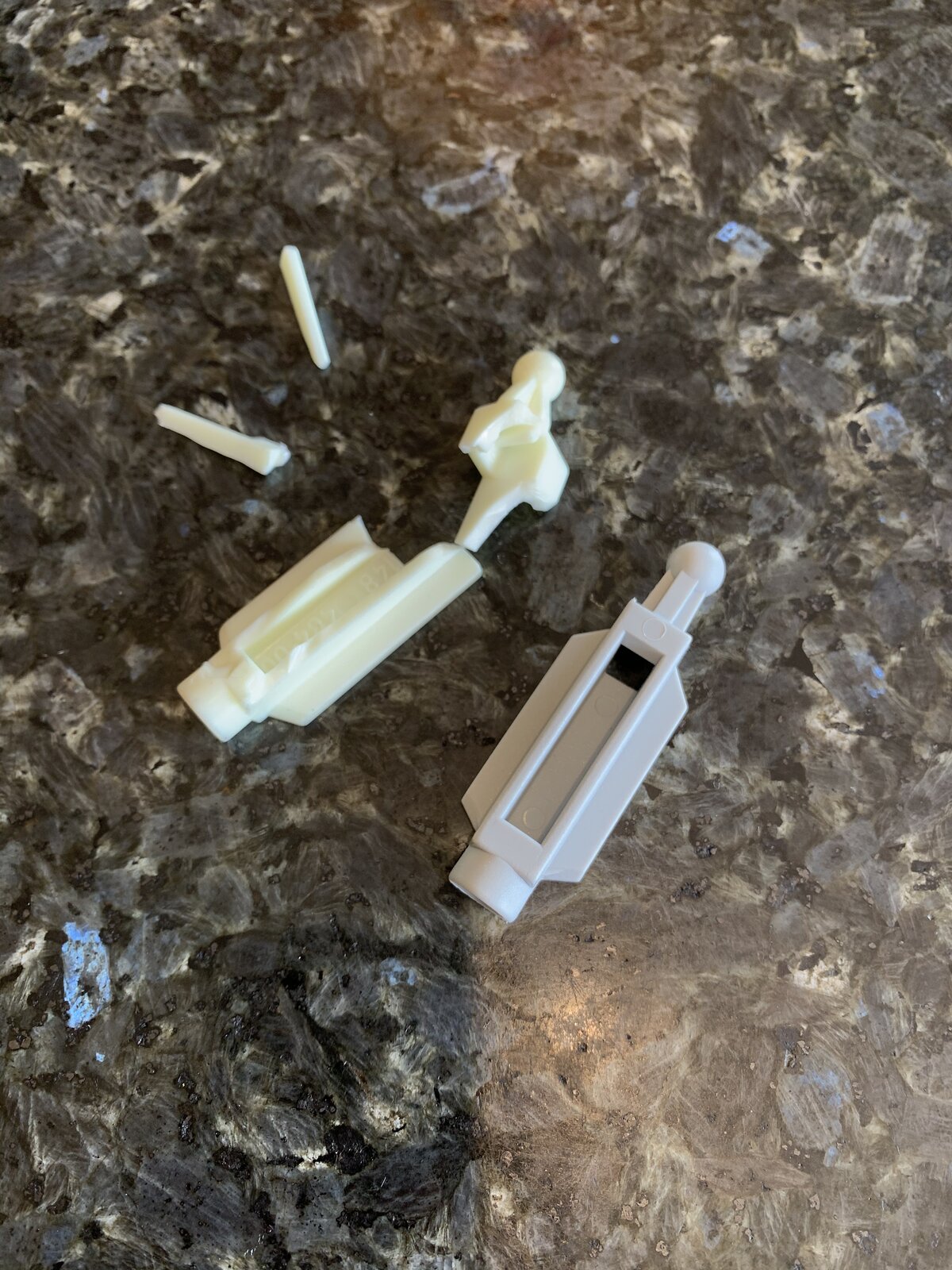

I bought both headlights separately – after a bit of an eBay search, stumbled upon the correct headlight for each side, not advertised in the best way, but I managed to confirm part numbers so I went for it.

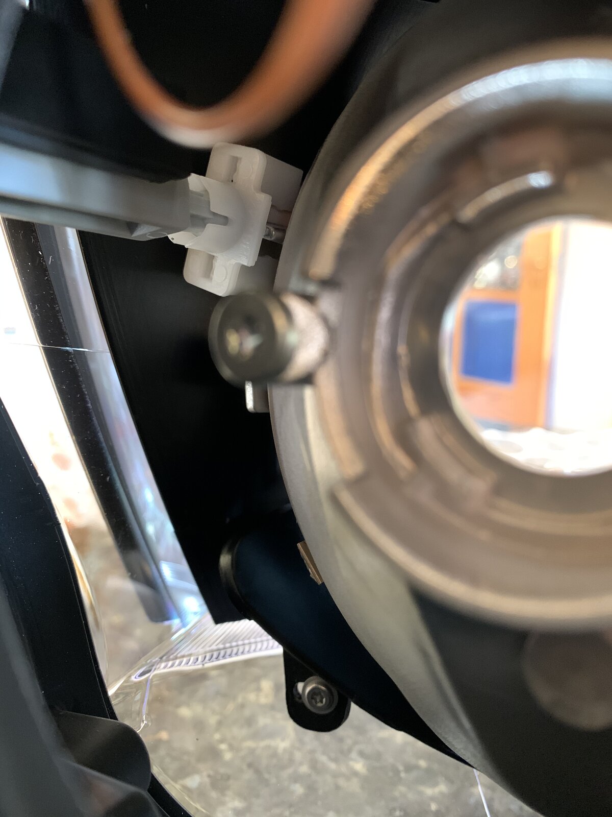

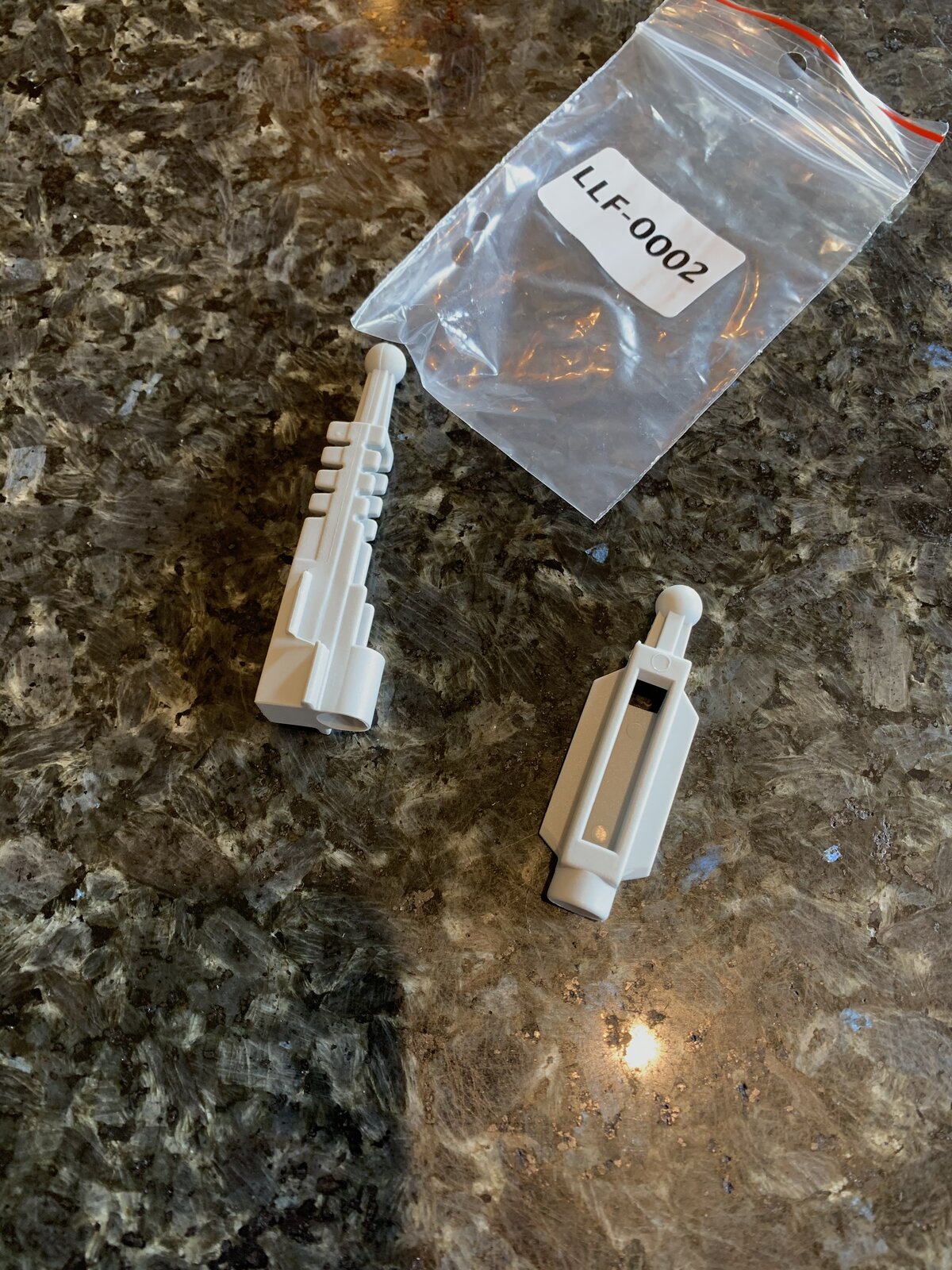

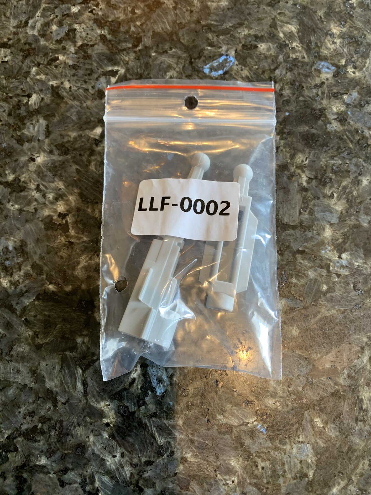

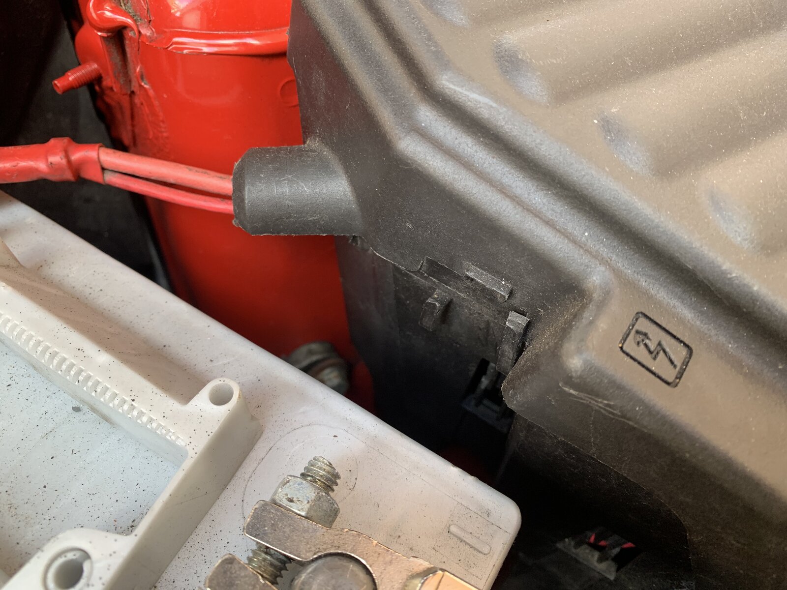

One of them a perfect when it arrived, the other was fine in terms of condition but had the common issue when being sent via courier… the adjust had snapped, so the internals were moving about freely. Brilliant!

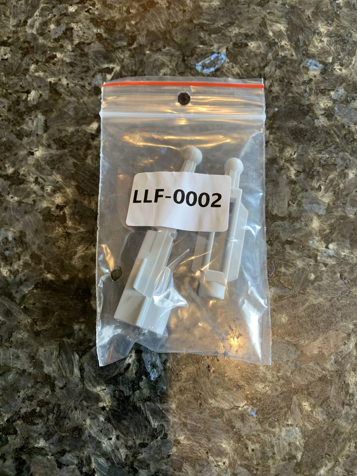

Picture of the problem below; there Is a mount/clip which should pop into that white socket on the left, but it had snapped and was moving about in the headlight.
All was not lost though, as I managed to order this kit for all of £2.49 which included a new one.
New item against old item…
Then set about fitting the new adjuster mount. Was a bit fiddly, but I got there!
Voila! One brand new working headlight…
I’ll get a photo of the other side too when I get round to fitting them!

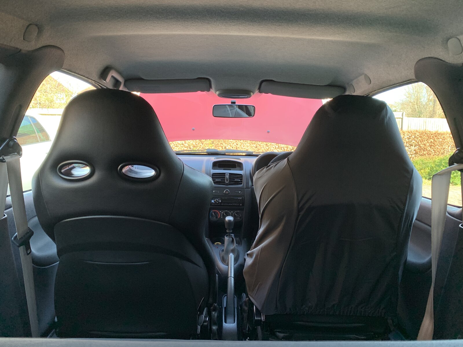

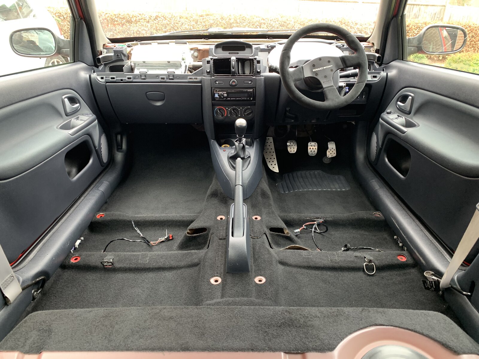

Last weekend, I got round to fitting the lowered seat adapter onto the passenger side Recaro (details above).
So I set about doing the same to the driver side today.

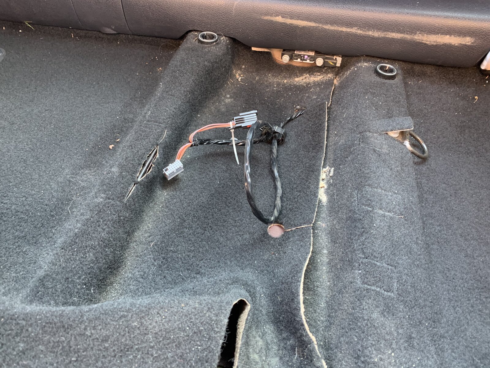

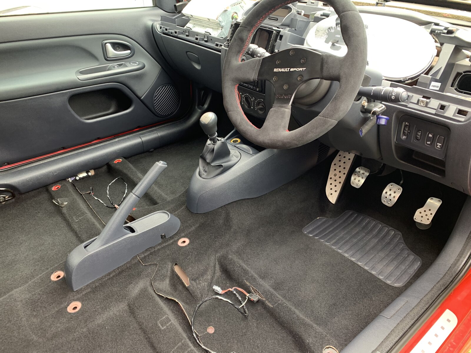

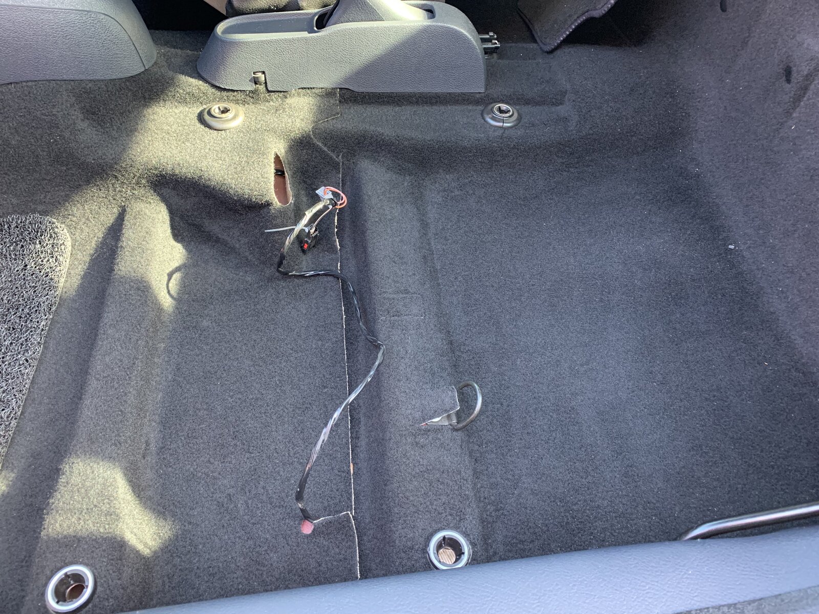

I actually ended up taking both seats back out, because when I was doing the passenger side last week, I decided to remove the spacers/grommets that the seat rails rest on. But I wasn’t overly happy that it was essentially metal on metal with nothing in between. I bought some rubber washers during the week so that I could rectify this, so out they both came, along with the rear bench!
The pictures make it seem reasonably clean, but it was actually filthy in here! The passenger side looks cleaner because I started hoovering this last weekend when the seat was out, but under the driver seat was horrible, and there was all kinds of crud/dust under the rear bench!
Spent the next 2 hours hoovering, taking the opportunity to get it as clean as possible before putting the seats back in.
Once I was happy, I gave all the interior plastics a clean with Poorboys Natural Look Dressing. The really nice part was that I could clean all the nooks and crannies that would otherwise be covered by the upper dash. A surprising amount of dust gets underneath the upper dash, so it was nice to clean all that up.
Then sprayed some Autoglym Autofresh and left it at that whilst I swapped the adapter over on the driver side Recaro.
This is how it was looking. Much, much better!
This gives a much better idea of what the drop is like on the new adapters…
These are the rubbers washers for mounting the seats back in the car, given the spacers (pictures of these in an earlier post) have been removed.
View from behind now both seats are fitted and bolted up…

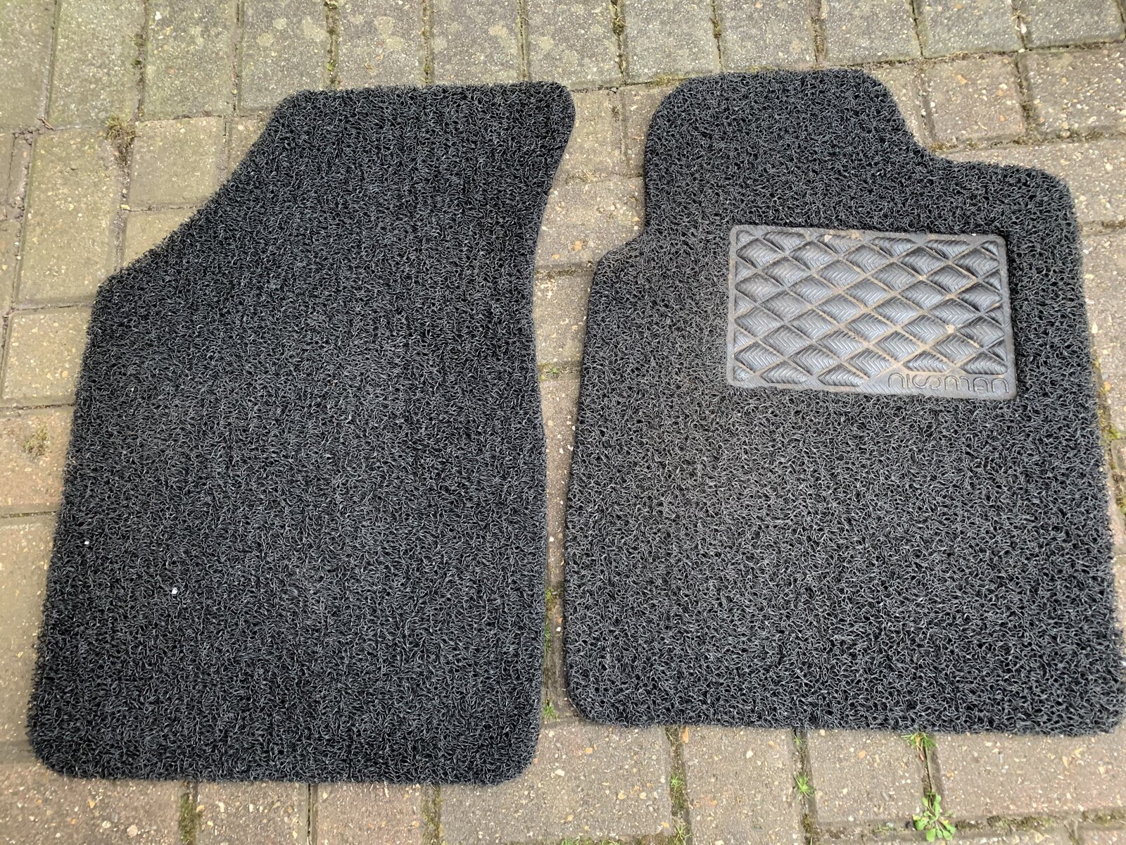

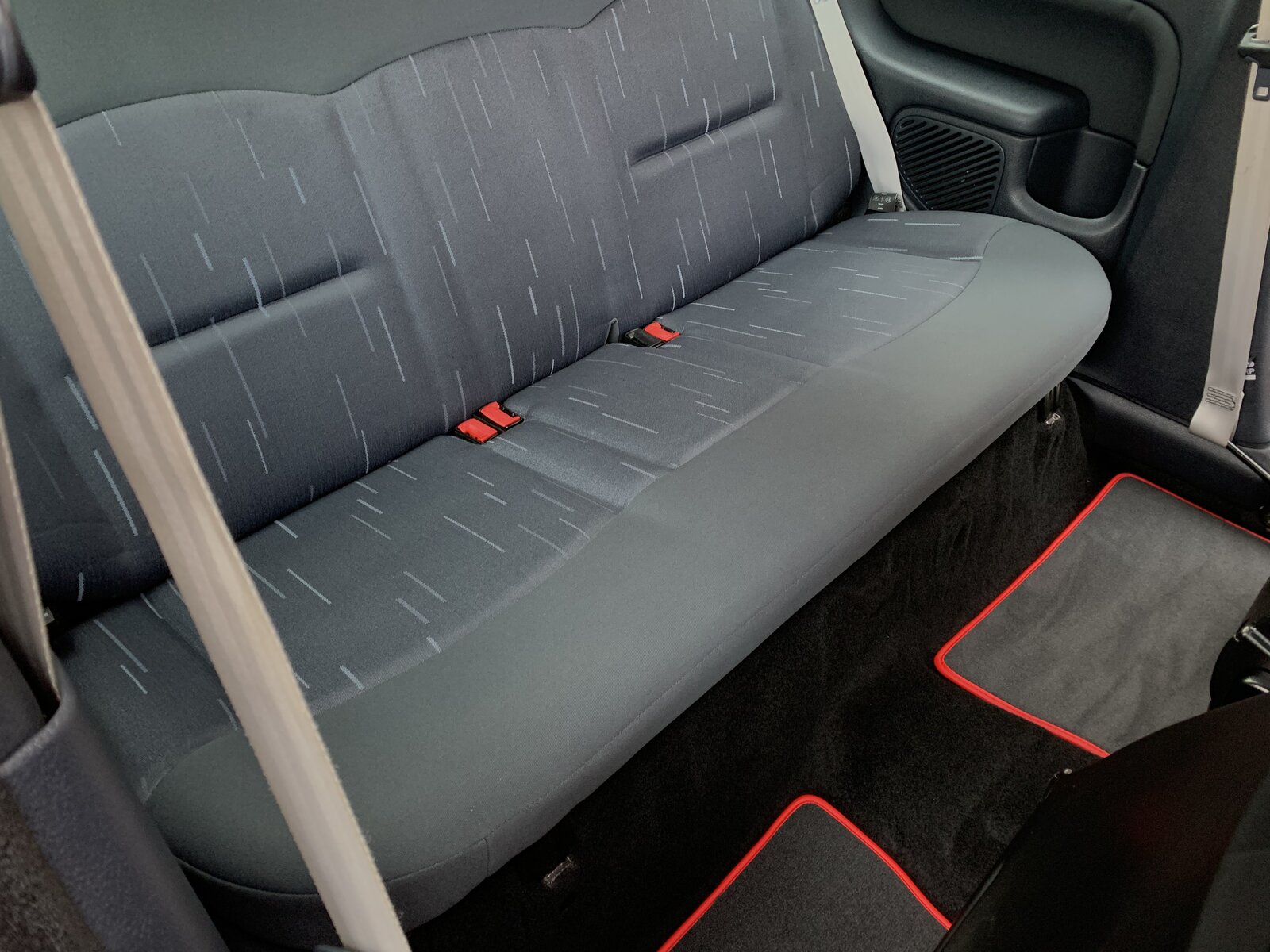

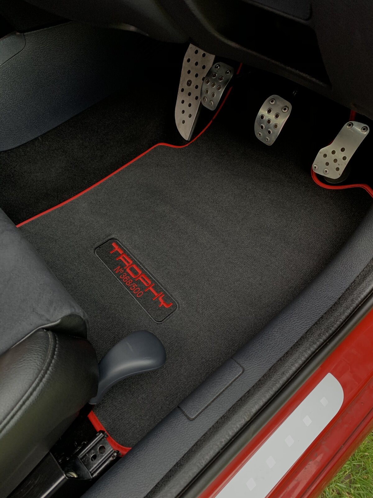

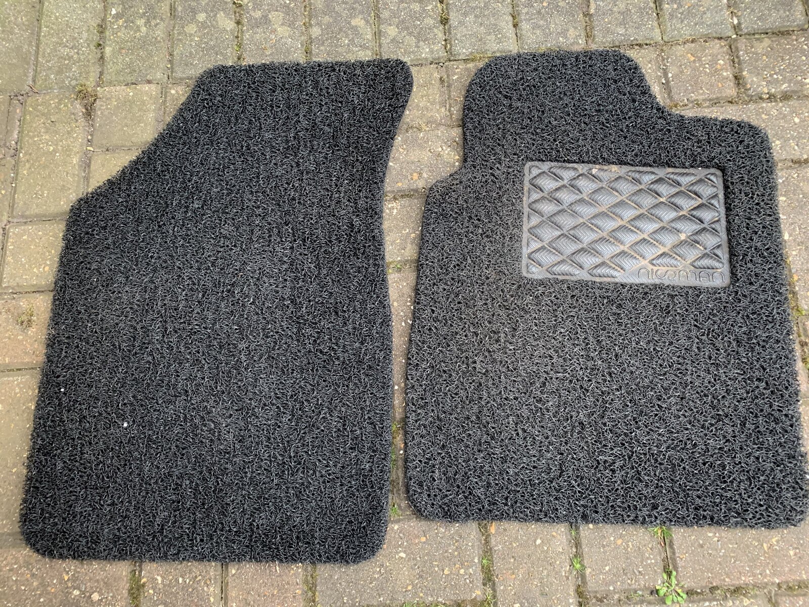

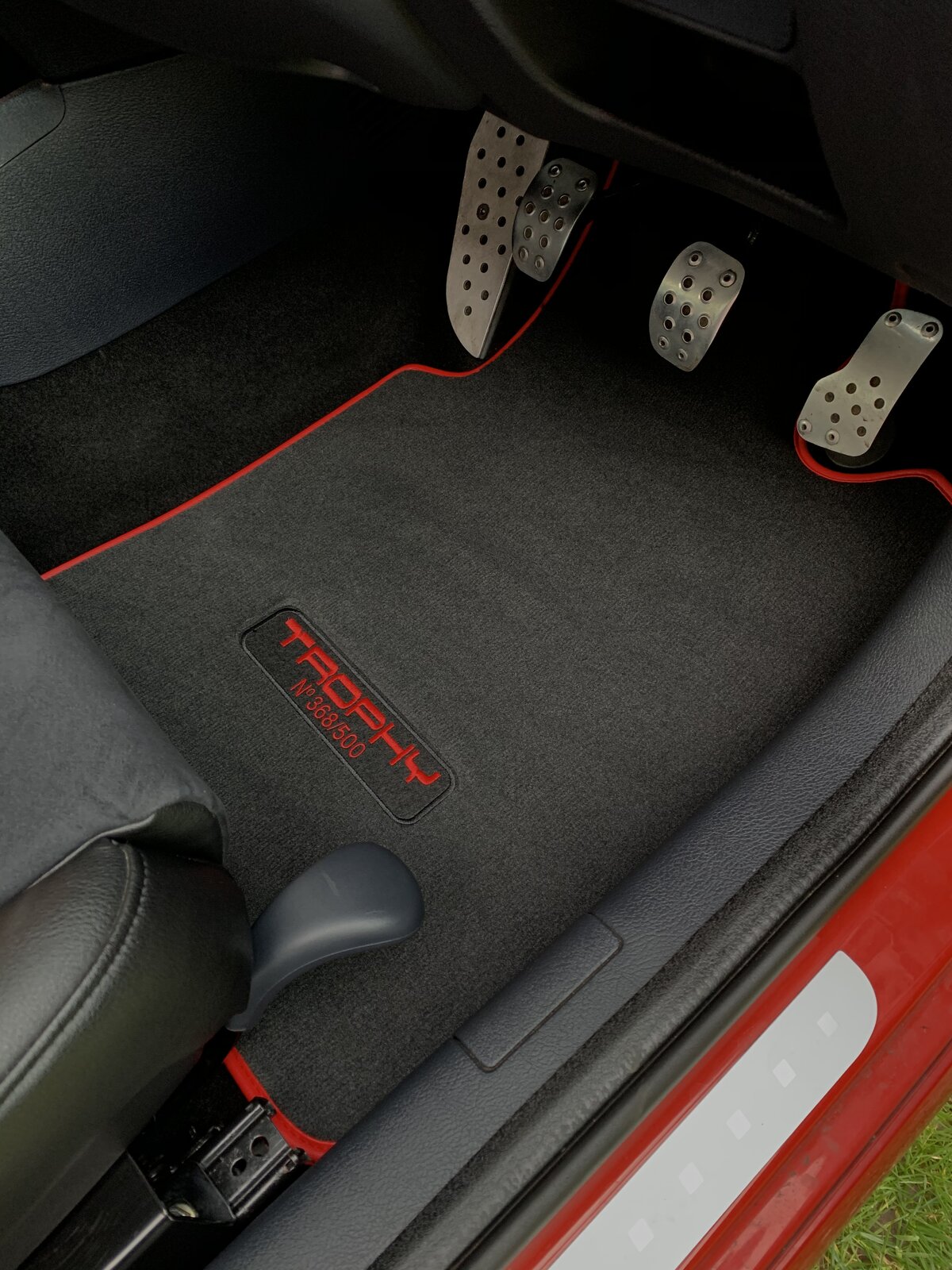

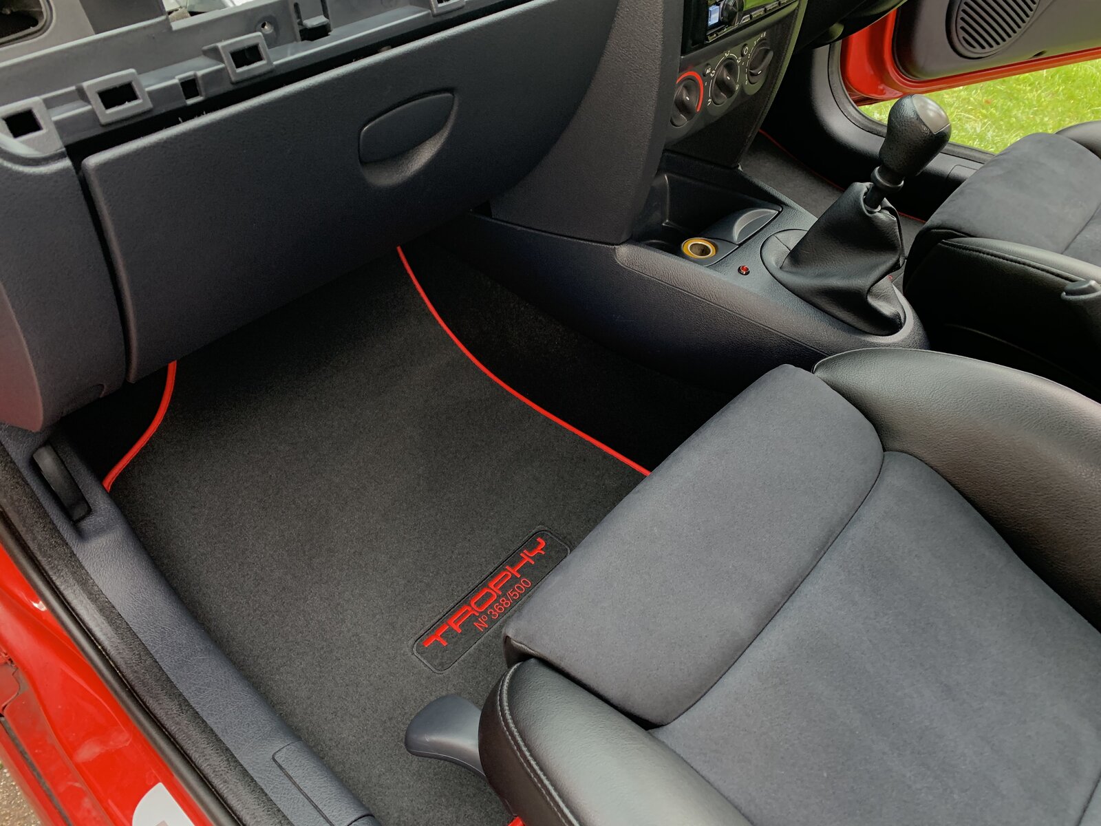

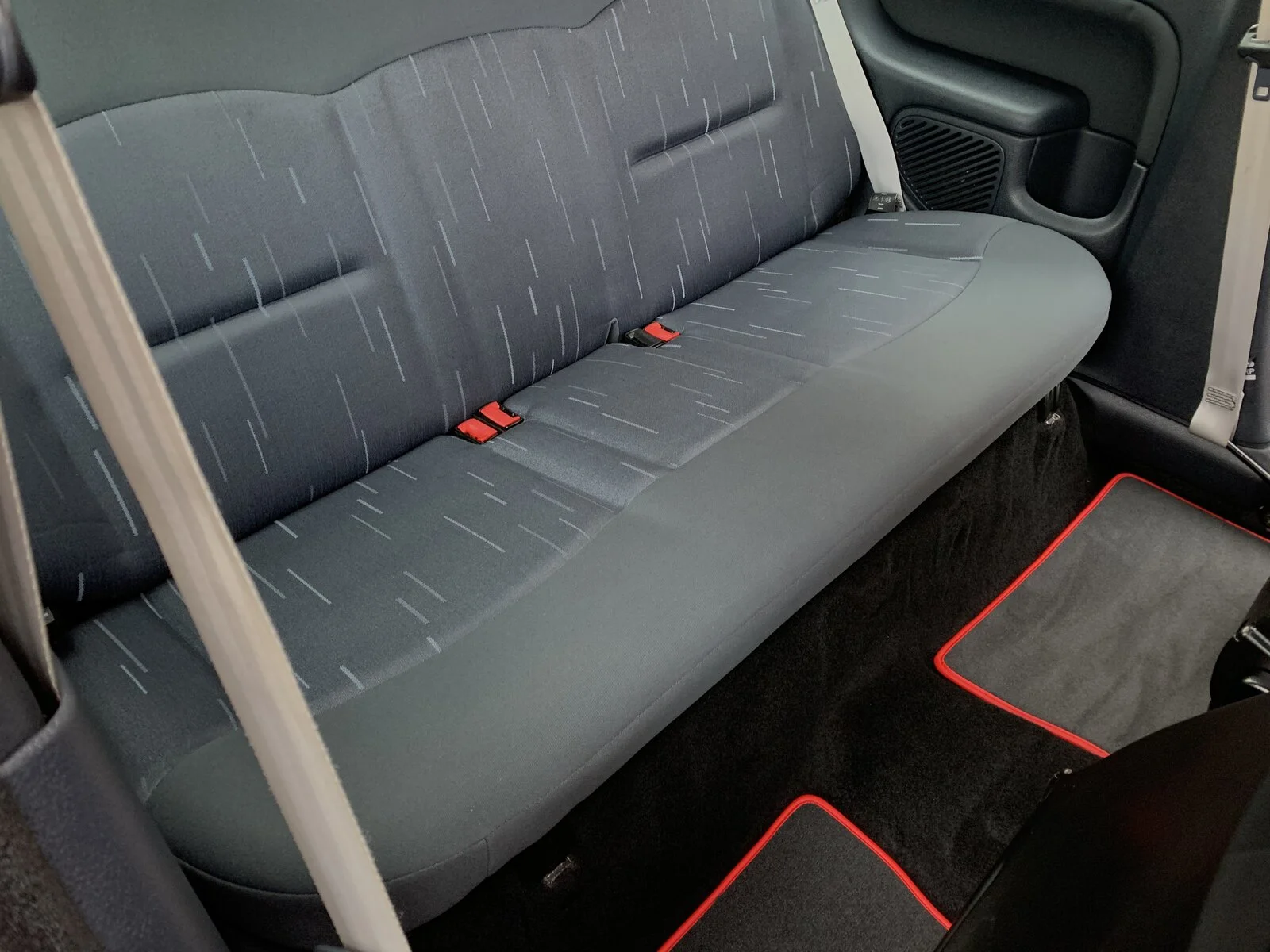

Finally, to finish off the interior, binned the horrible mats that were in the car, and fitted my new custom ones!
Old…
And new…
And just some photos of how the interior is now looking after all the jobs from last couple of days (ignore the fact the upper dash is not fitted, waiting for the vents to be sorted first!).
Old…
And new…
Where did you get the mats from mate?
Looking good @Ash J
One of the first mods I done with the Dci surround on the clocks. Very easy job and so effective.
Only thing im not sure about is the mats, For me Its too much red, Possibly if you got the pipping black but for me its OE Mats
Nice updates! How difficult was it to remove the upper dash? A lot of clips to potentially break?
Great updates Ash 👍
Thanks mate :)
As always it’s the attention to detail that makes your cars and ownership updates, nicely done 👍
Appreciate the comments Tim :)
Got them from Autostyle. If you ring them and say you want mats for a Clio Trophy with the Trophy logo and number, they will know what you mean. You can customise them with any colour etc. Not sure if they will be open at the moment obviously.
Looking good @Ash J
Thanks Marc.
Yep the clocks make a big difference I think.
Not a fan of the OE mats personally, because of the silver. All down to personal preference, I was thinking black piping, but went for red and I actually like it! Appreciate it might be too much for some though!
You can have the upper dash out in 10-15 minutes. Really not a difficult job; 11 screws to move, and then you just pull the whole upper dash towards you and lift off.
There is a guide here: https://cliosport.net/content/guides/fubar/ph2_dashboard.pdf
One tip from that guide... you don’t need to remove the screws at Step Six; the panel on top of steering wheel just pops off (y)
Ah I should've known there was a Fubar guide, another thing on the to do list then, thank you!

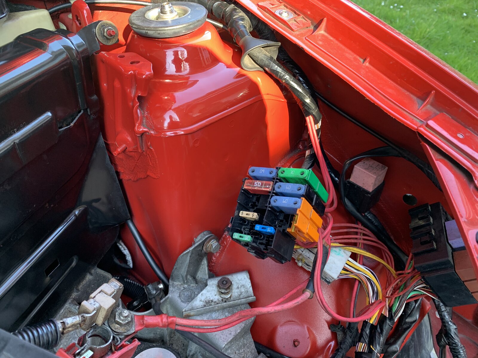

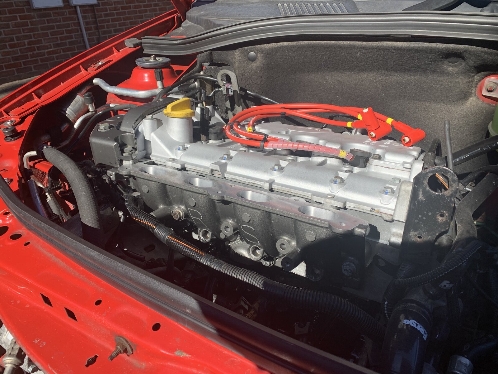

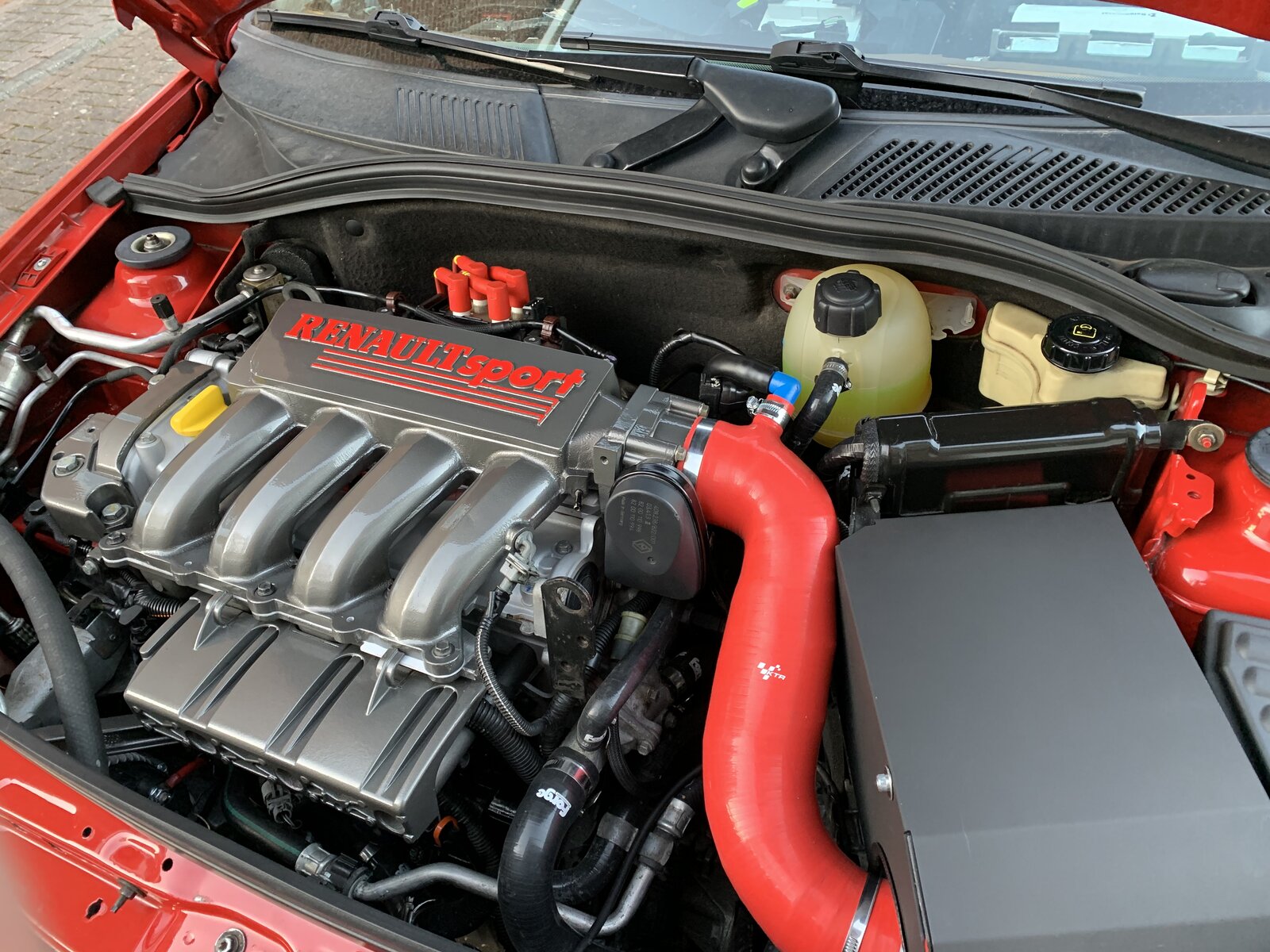

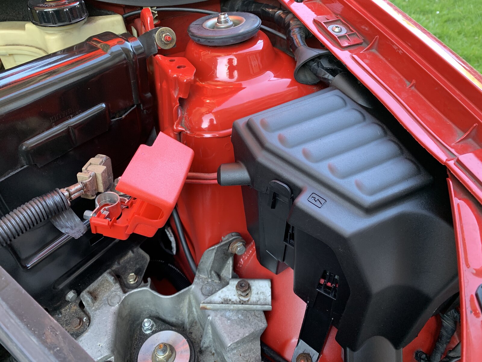

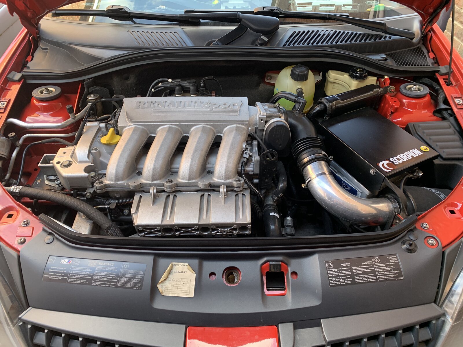

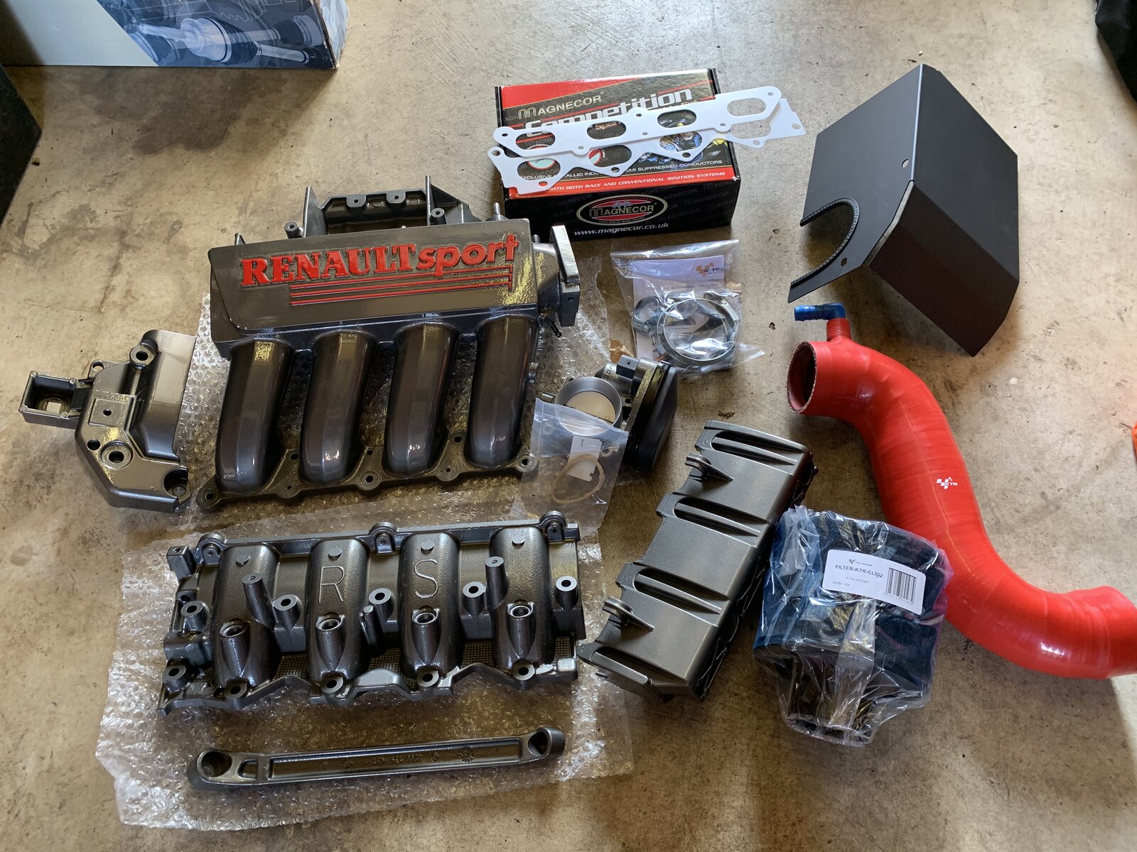

So I have been tidying up the engine bay over the last two weekends.
Some pics of how it was looking before.
Silver inlets
Fatty (I think?) induction

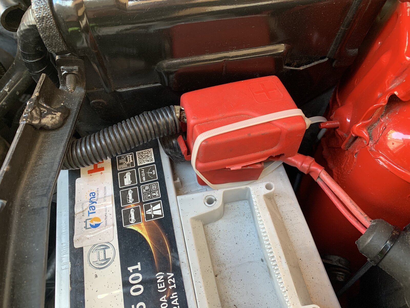

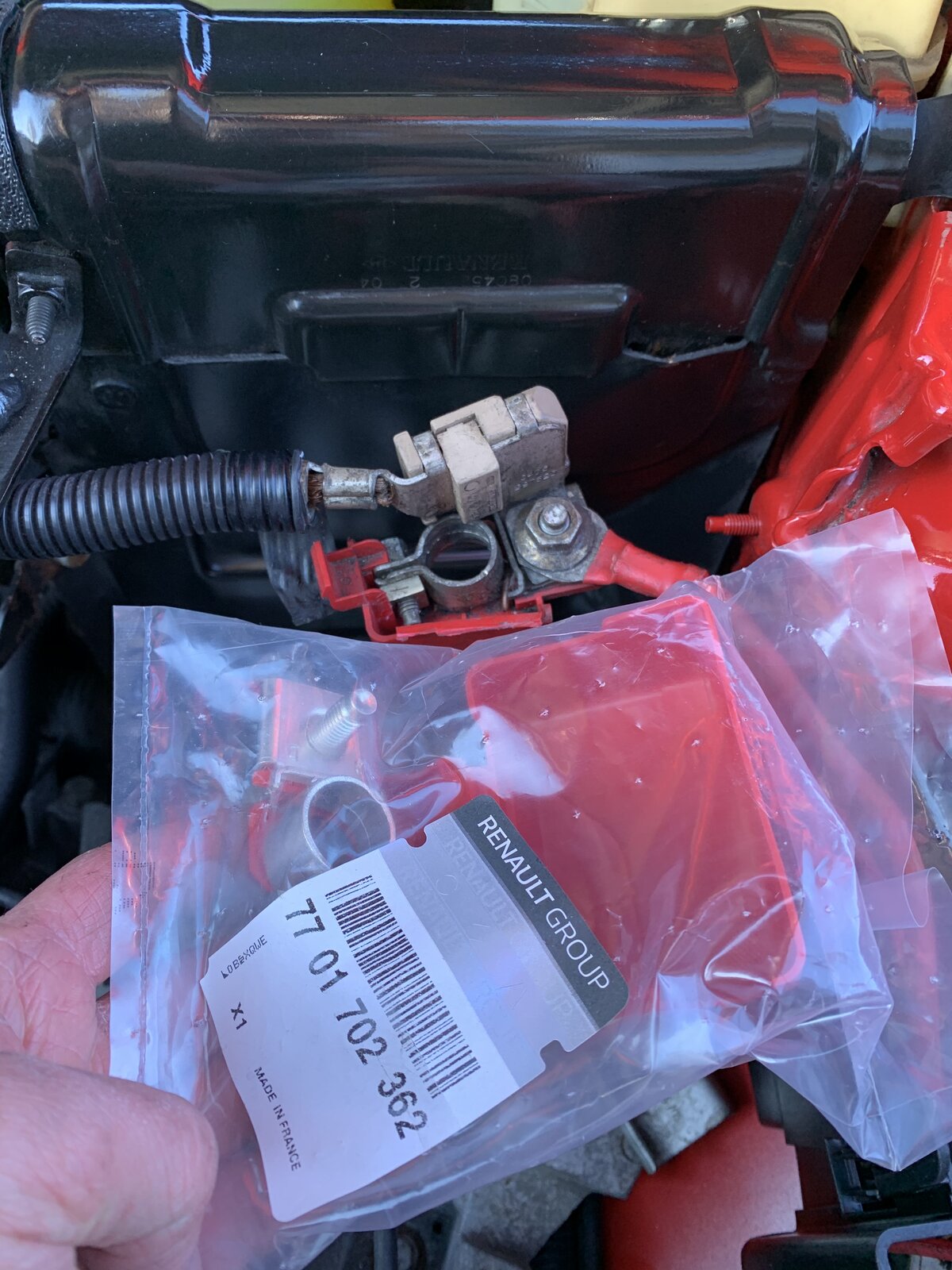

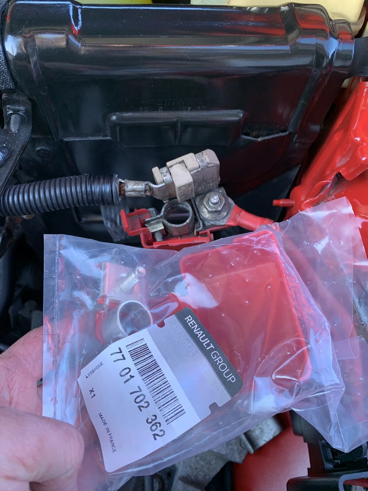

Broken fuse box
Broken positive battery terminal
Small battery cover
Parts ready to be fitted…
Painted upper inlet (port matched etc)
Painted RS lower inlet (port matched etc)
Painted throttle body
Painted engine mount bracket/cover
Painted alternator support bracket
KTR PTFE inlet gasket
OE inlet manifold breather gasket
Magnecor red ignition leads
KTR induction kit
Battery cover

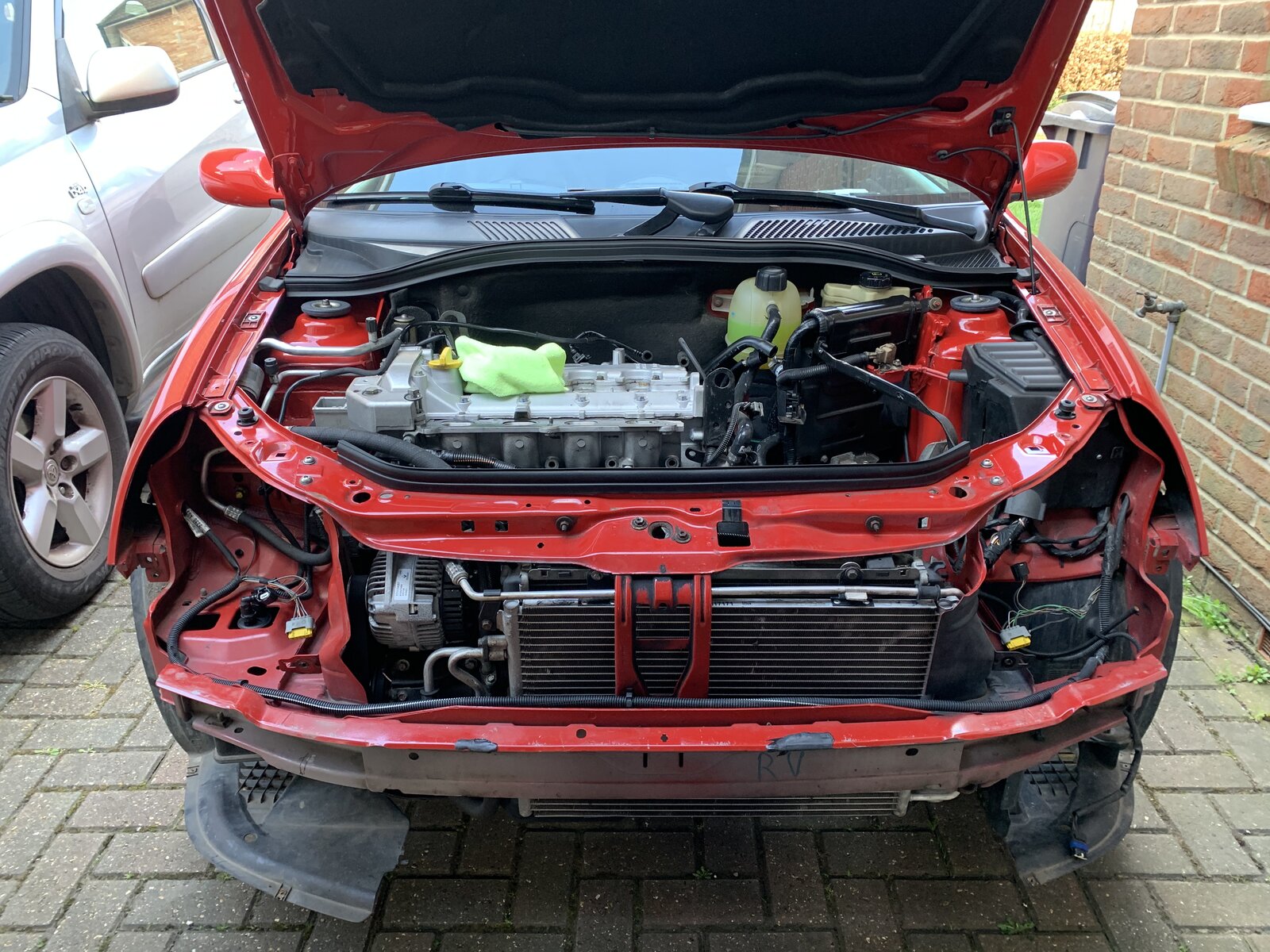

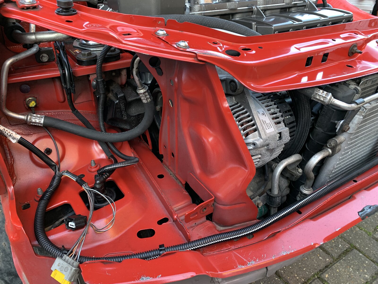

Made a start last weekend, and got to the point of removing everything apart from the lower inlet, leaving it like this…
Headlights also removed as I am swapping these over too.

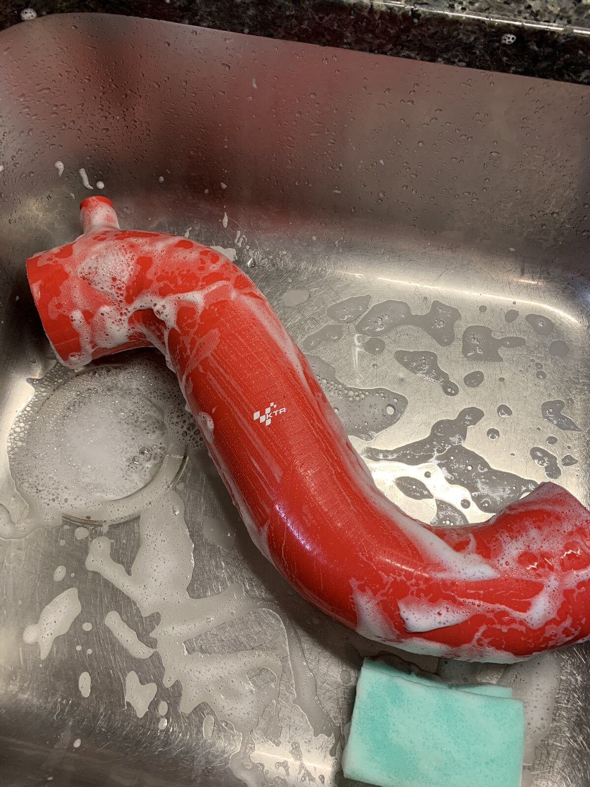

The KTR induction hose I bought second hand, so I gave it a bath to clean it up. The filter and fitting kit are brand new from KTR.

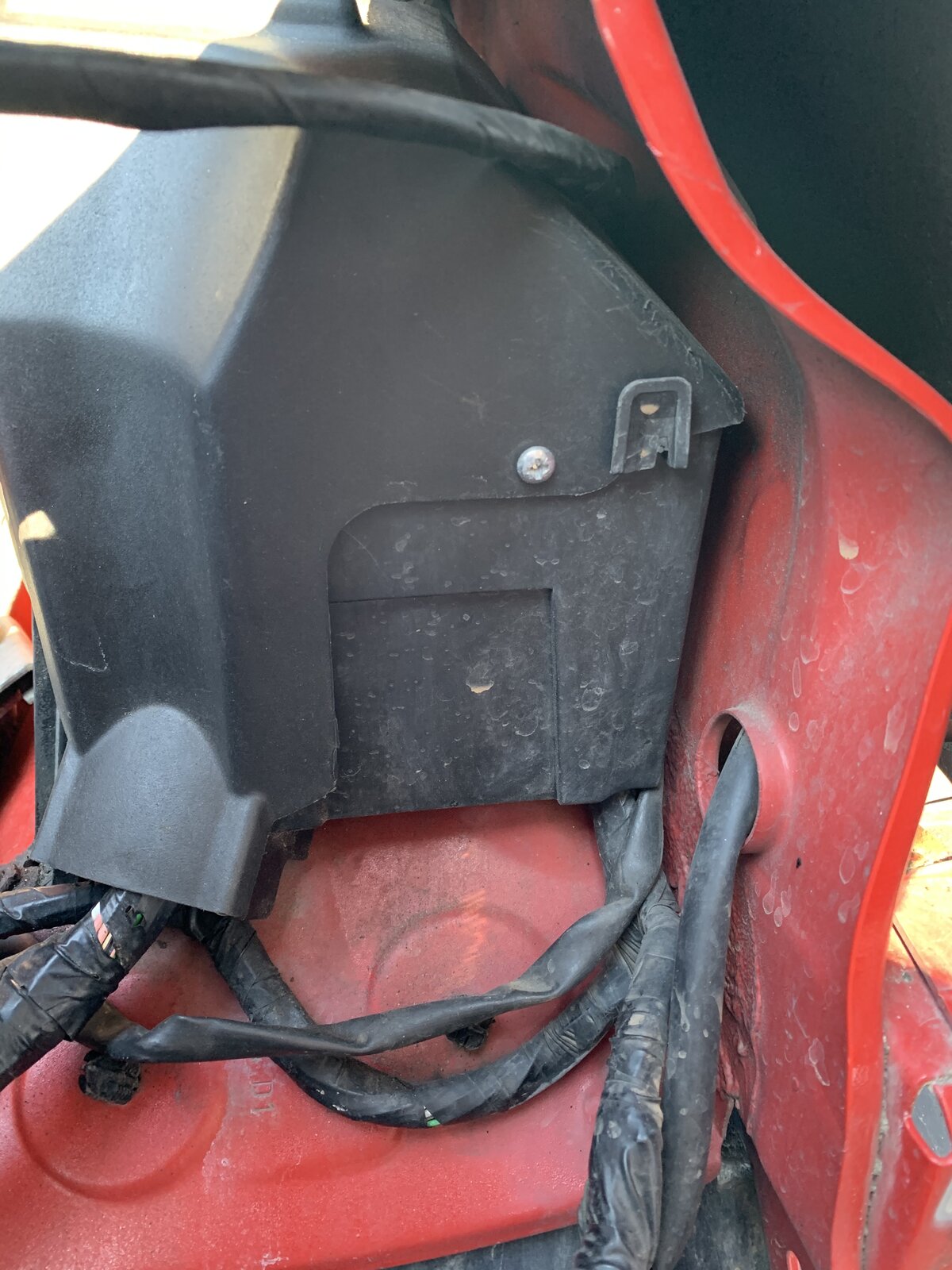

The fuse box clip was broken as shown above, so I set about looking for a replacement and found a brand new genuine one which I snapped up. Also found a brand new genuine cover so I bought that too.

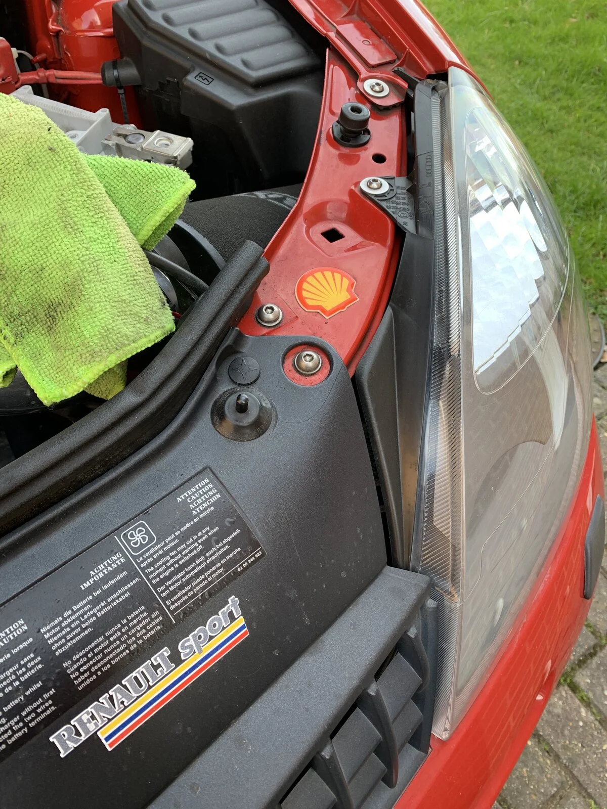

The cover was being held on by a screw behind the headlight…
I removed the old fuse box, then took the opportunity to give everything I could see in the area a good clean up…
Then is was time to fit the new fuse box and fuse box cover…
Much tidier, couldn’t be happier with the outcome.

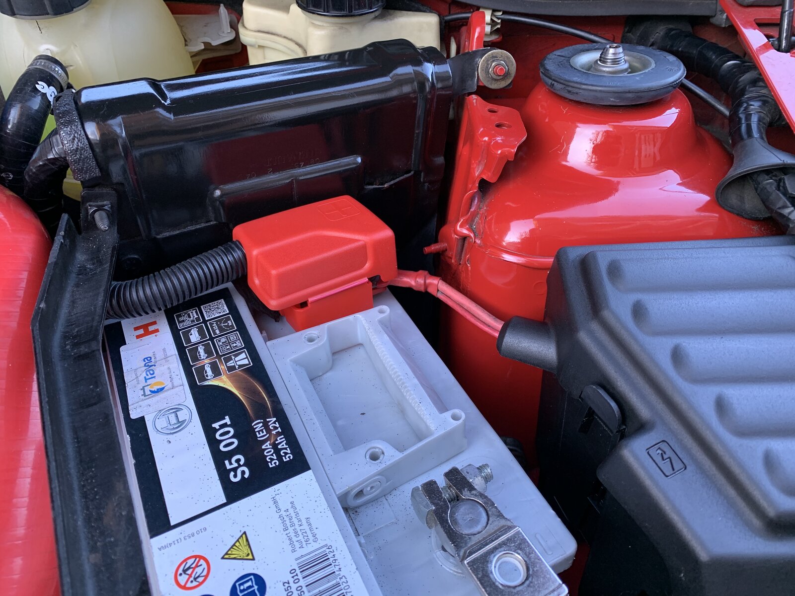

The pics with the fuse box above shows the new battery terminal too. Couple of additional pictures…
Decided to then have a clean behind both headlights whilst they were out. No before pics, but these are after cleaning. Honestly is so much cleaner than it was!
It was then time to get my pair of brand new headlights ready to put on the car. Went for a pair of genuine new black insert ones to replace the standard grey inserts, just personal preference. I bought brand new uprated bulbs to fit at the same time, and just had to swap the headlight levelling motors over from the old units.

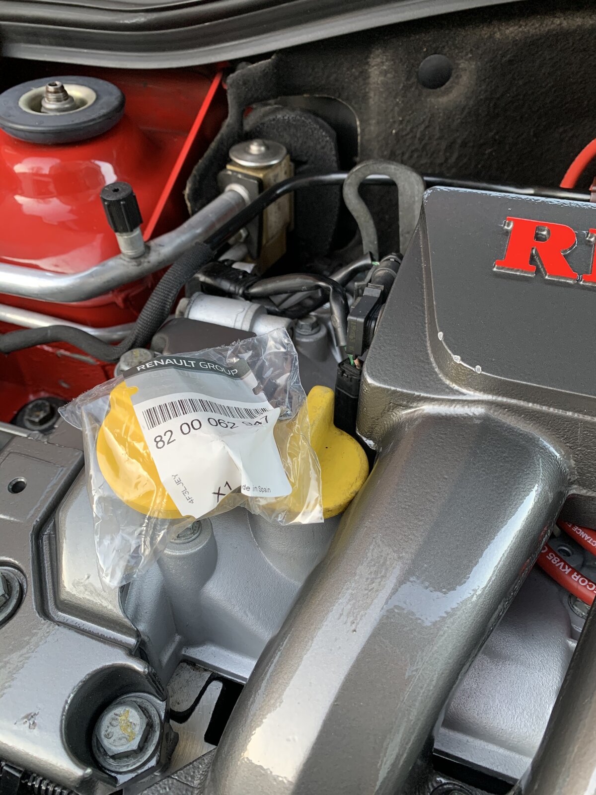

And then today I finally got round to continuing with fitting all the engine components.
Eventually got the lower inlet off (very tight fit!) and swapped over for the new one straight away…
I then set about fitting all the rest of the parts (no in between pics) and this was the end result…

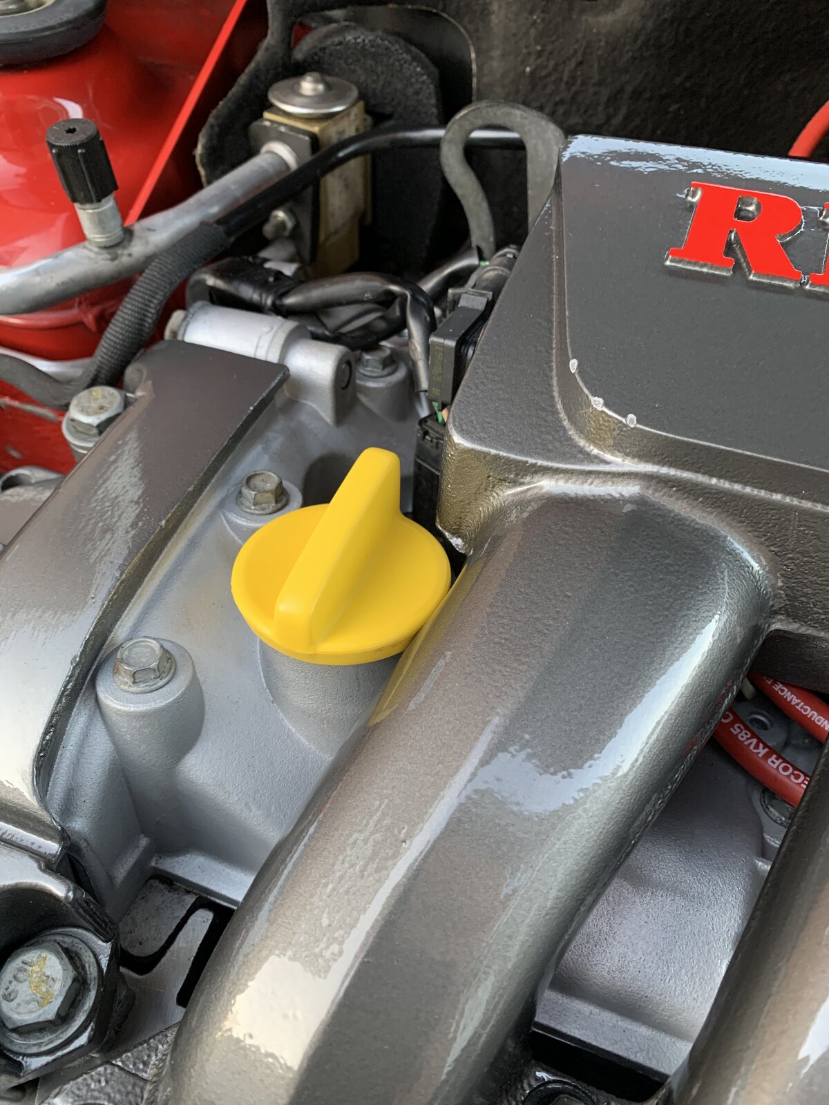

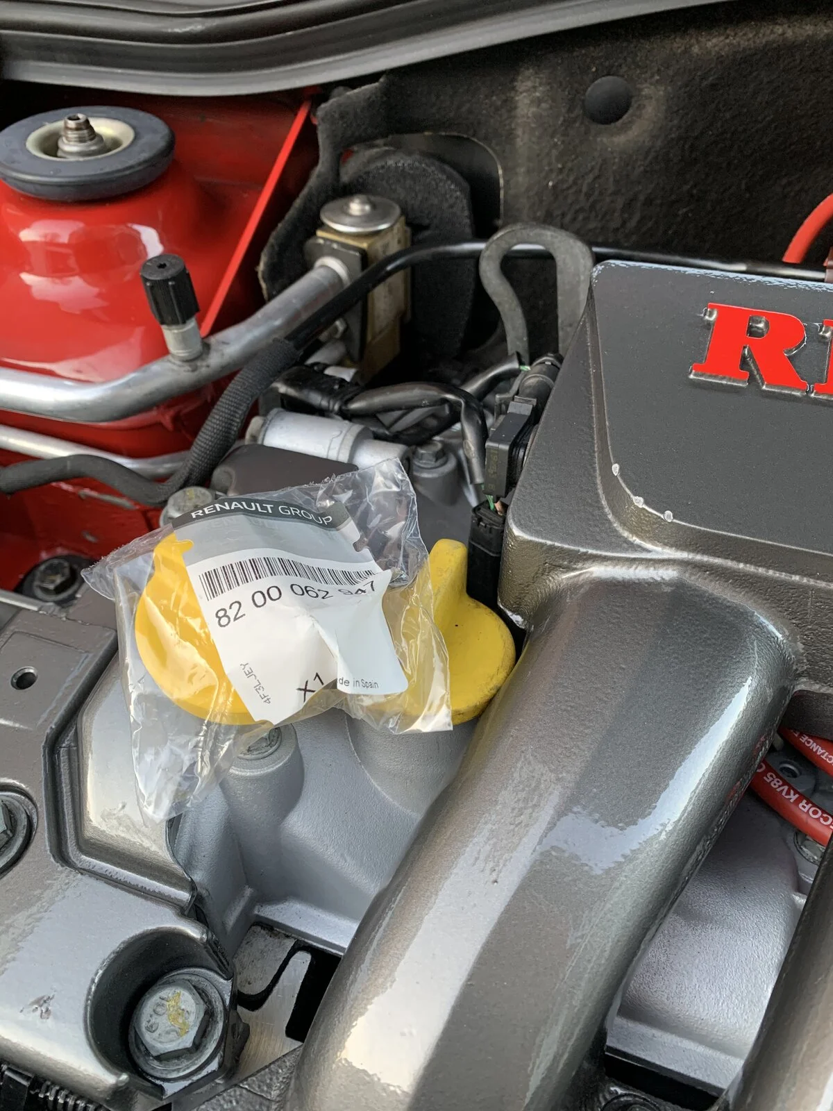

Finishing touch was a new genuine oil cap…
Got both new headlights fitted up, looking much nice in my opinion with the black inserts (and the fact they are brand new!).

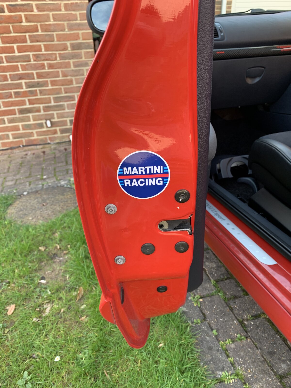

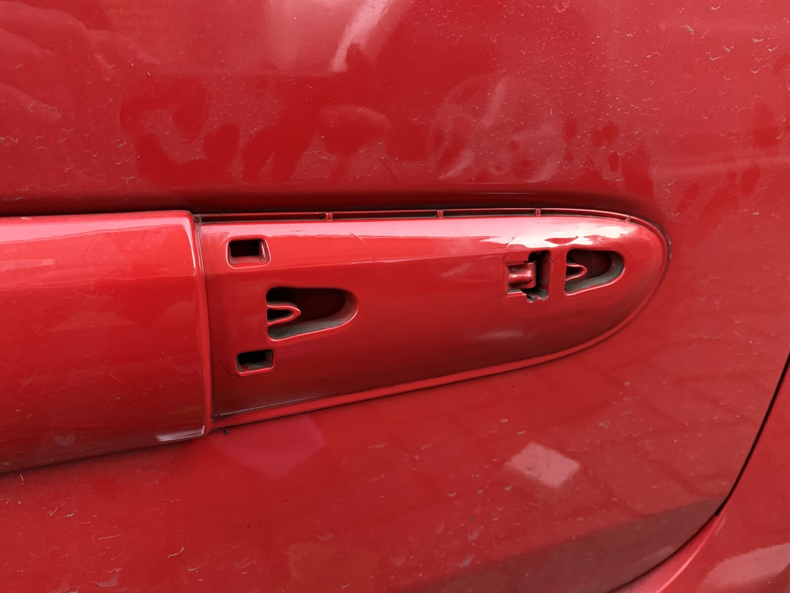

Final job was to fit my new door bullets I had made. I know these will be marmite, and I wasn’t sure they would work myself, but I’m actually really happy with how they have turned out! I appreciate some people won’t like them and that is fine! Also cleaned up behind them before fitting as it was filthy!
I have left the front bumper off as I am going to take the opportunity to have a clean of everything else at the front end before putting it back on, so please ignore anything at the front end which has not been cleaned yet, and the filthy arch liners too as these will be coming off to be properly cleaned!
