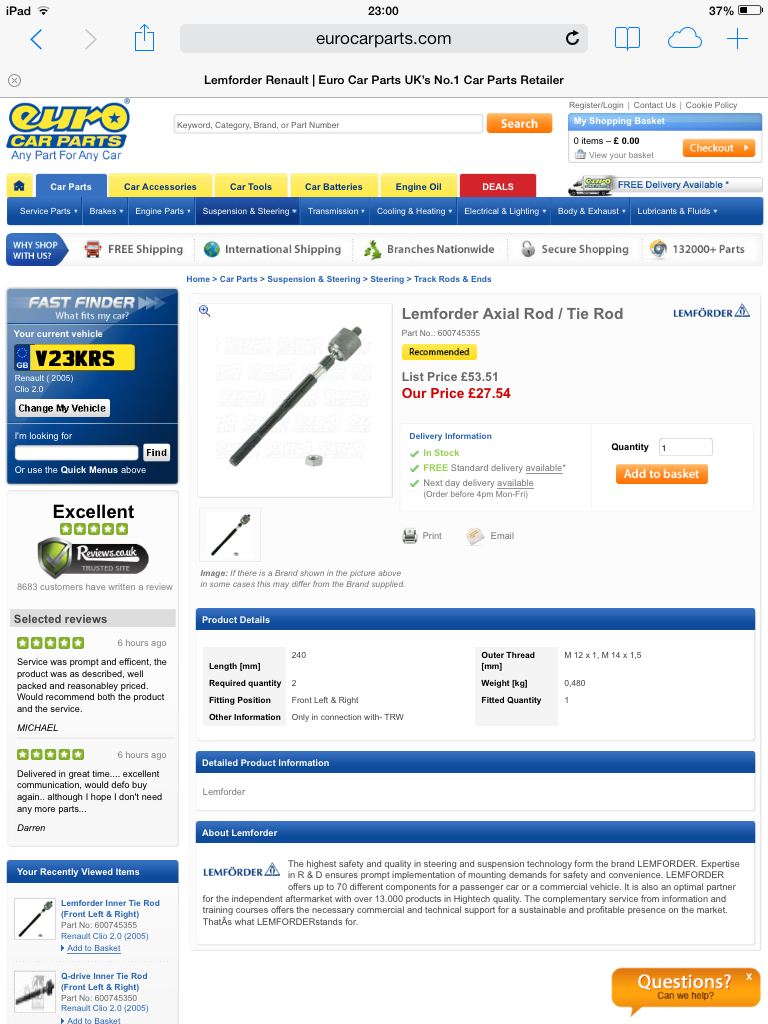

Quick question are these the correct ones? I heard theres two different sizes, cheers.
Got a feeling you can only get Cup/Trophy ones direct from Renault but not 100% sure at all. Hopefully Fred, Steve, Andy or Dan will be along to answer your question mate.
I bought lemforder ones from ECP and they were 270mm long. Cup suspension ones should be 330mm long
