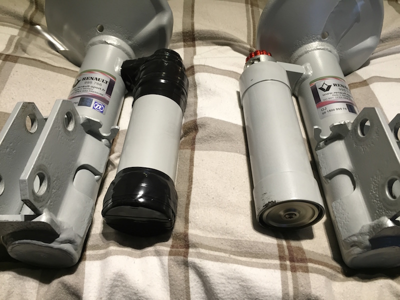

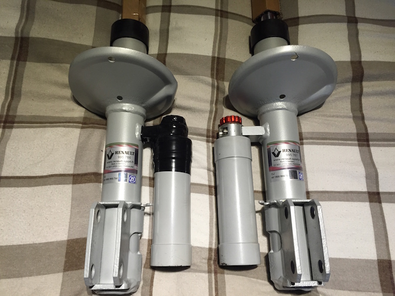

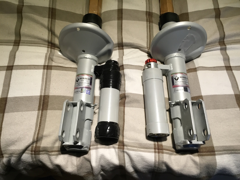

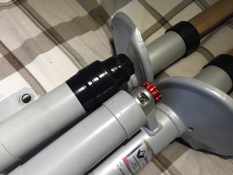

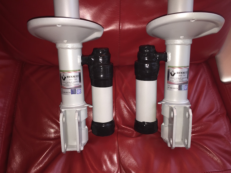

After months of testing and looking for something i have found the best thing to protect my front sachs dampers.
I have used non adhesive, water tight/proof, air tight silicone tape and its truly amazing on how good this stuff is.
I have managed to get my hands on 7 rolls of the stuff to change it every year and also put on my spare set.
Going to be sending a couple of rolls to @TonkaTruck so he can test this stuff also.
MarcB
  Too Many
You my friend are uniquely OCD in a good way.
Have you seen how bad these can rot with salt and road grim ?
I have seen at least 2 dampers that needed wielded as they snapped due to the elements and the metal rotting away
With spending near on £1K on a refurb i think £45 is a small price to pay :up:

I never bought mine from Ebay, I actually got it from a friend who used it years ago on a pipe that broke under his sink.
I have tried and tested this stuff in the shower and sealed a few items and it works a treat.
I have a mixture of black and red tape and the best thing about this is its non adhesive so there is no stickiness at all and no mess.
Its truly magic
