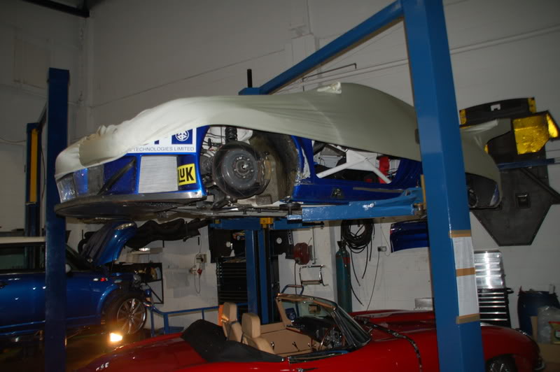

we can have a look homer, we're in stafford too
our boys have a fair amount of experience with Sachs suspension, this old barge has a few quids worth of Sachs bolted to it
