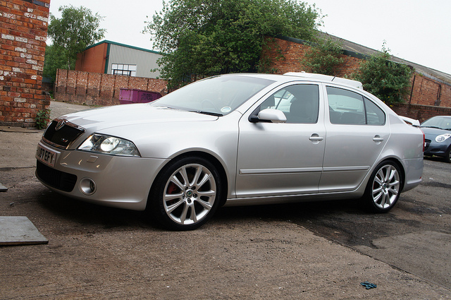

I'm a little behind on my write ups at the moment so spending the bank holiday sharing my latest work with you. This detail took place on Saturday and was my first dedicated Tuition Detail. The owner of the car (a DW member from Leicester) wanted some help improving their machine polishing results and also wanted to improve the clarity of the paint on their car.
The tuition was a full end to end detail process beginning with a full wash and decontamination then followed by machine polishing and looking at how best to finish a car. I also took the opportunity to have a play with my latest toy - RaceGlaze's very special 'Black Label' wax...

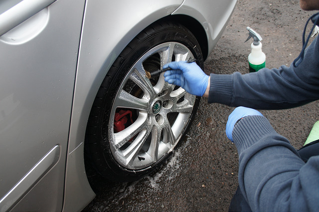

Agitated on the rear of the wheels with Wheel Woolies:
DSC06880 by RussZS, on Flickr
DSC06881 by RussZS, on Flickr

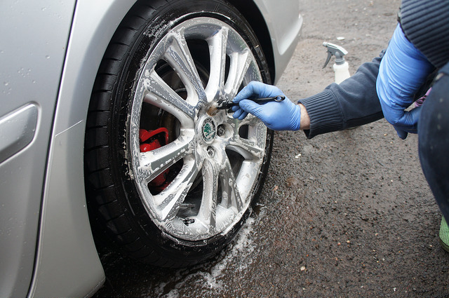

ValetPro brushes were used on the wheel faces:
DSC06883 by RussZS, on Flickr
DSC06884 by RussZS, on Flickr

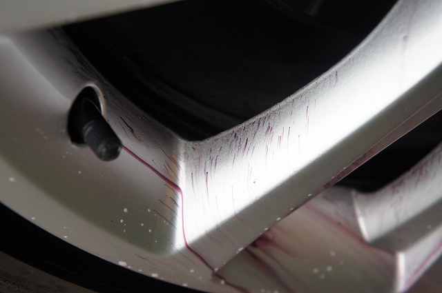

We finished up with IronX to safely remove pittede brake dust from the wheels:
DSC06876 by RussZS, on Flickr

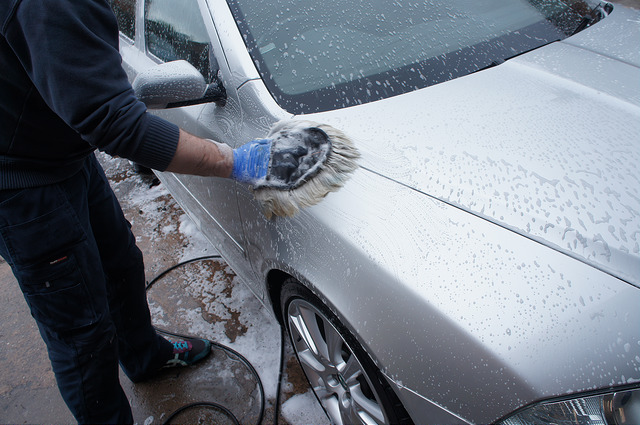

Next we washed the car with Britemax CleanMax and CarPro Mitt:
DSC06889 by RussZS, on Flickr

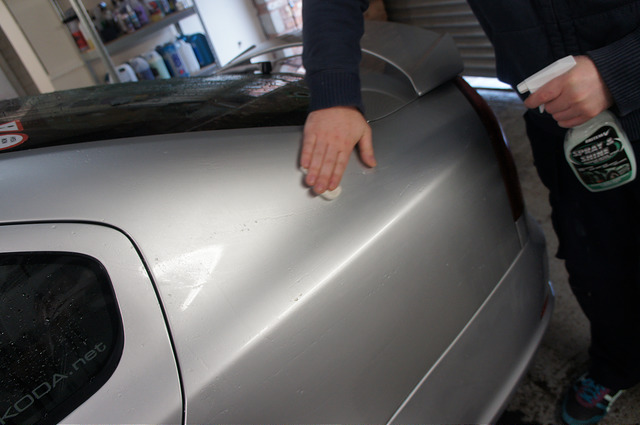

Tardis was used next to deal with a few isolated tar spots. After this we moved the car inside to begin the claying process.
DSC06892 by RussZS, on Flickr
As ever with claying, it was found to be a worthwhile step as even though the tar and fallout has been removed, often residue such as tree sap remains, which must be removed from the paint ahead of any machine polishing.

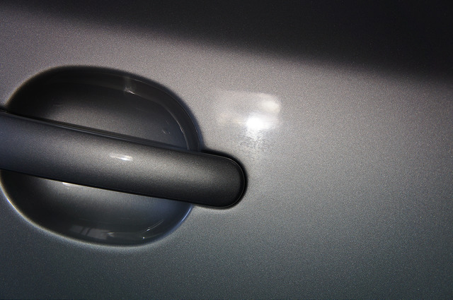

Next up we dried the car and began to assess the paints' thickness and also went about identifying defects. Some of the defects we found:

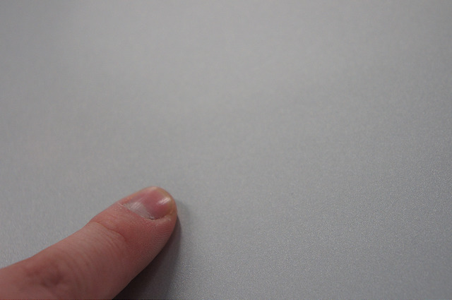

Sanding marks:
DSC06893 by RussZS, on Flickr

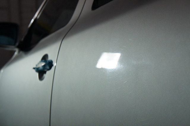

General swirling:
DSC06895 by RussZS, on Flickr
DSC06900 by RussZS, on Flickr

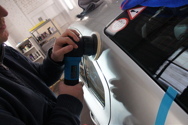

After initially exploring machine polishing - we tested both Makita and Festool Rotary to demonstrate the slight differences and nuances in machines, machine control, defect removal, where and how to mask up edges/rubbers and when etc we decided to explore using a DA Polisher and look at Microfibre polishing.
At this stage it was evident that some of the car had seen some paint and hadn't been finished down properly. We discussed the possibility of looking at wet sanding these panels to improve the clarity but after having a play with a few different combinations using MF pads, we were impressed by the results...

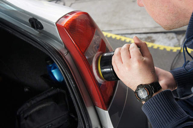

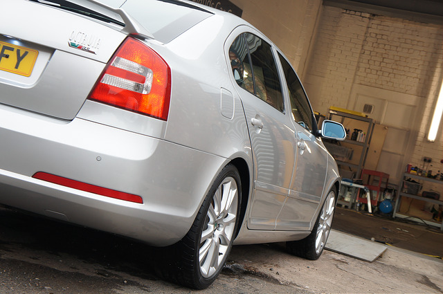

Rear light correction:
DSC06916 by RussZS, on Flickr
DSC06913 by RussZS, on Flickr
On this particular car, this combination gave excellent results, but I did stress the point that the MF option may not be the best choice in every situation, but it's certainly as asset worth adding to any detailing arsenal and shows how DA is just as useful as a Rotary in certain situations. The owner of the vRS also has a VW Mk5 Golf in grey so should see similar results with this combination on that - I think it's a write up we may see very soon... :)

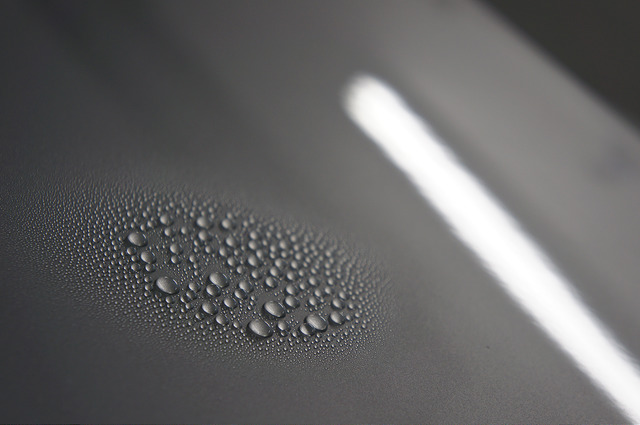

The beadings not bad either!!
DSC06922 by RussZS, on Flickr

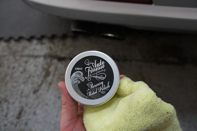

Mercury on the exhaust:
DSC06926 by RussZS, on Flickr

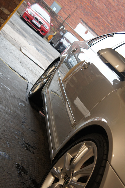

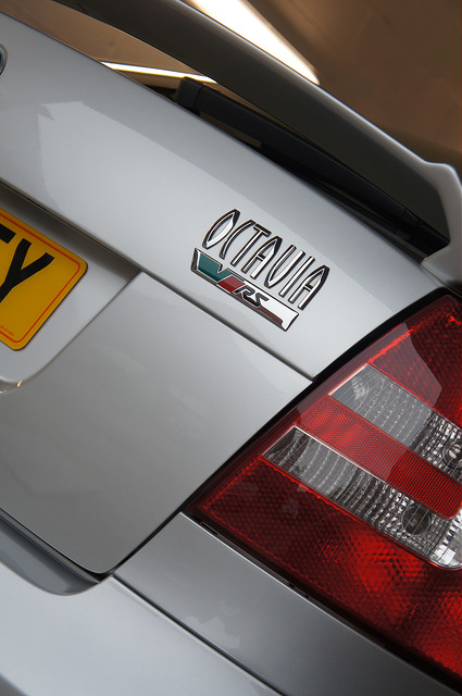

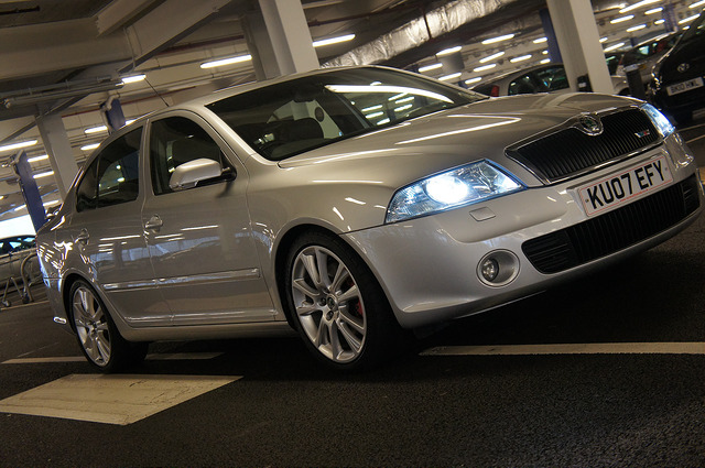

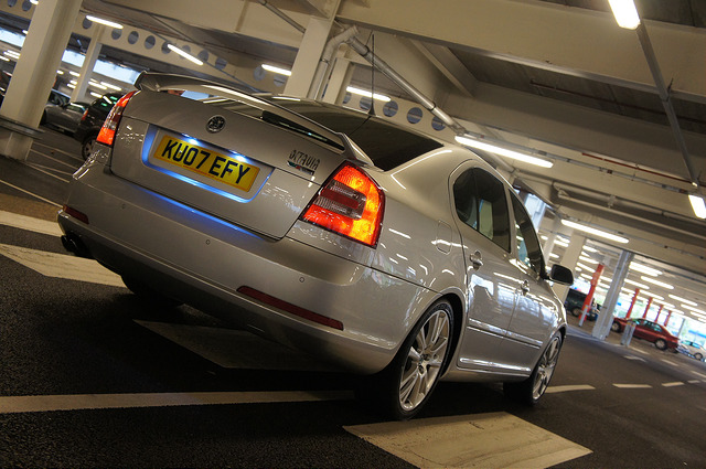

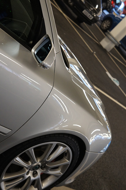

So finally, after 10 intensive hours, we have...

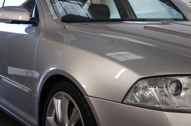

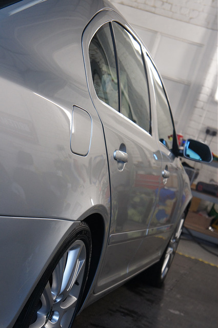

DSC06933 by RussZS, on Flickr
DSC06934 by RussZS, on Flickr
DSC06935 by RussZS, on Flickr
DSC06937 by RussZS, on Flickr
DSC06938 by RussZS, on Flickr
DSC06939 by RussZS, on Flickr
DSC06944 by RussZS, on Flickr
DSC06945 by RussZS, on Flickr
DSC06946 by RussZS, on Flickr
DSC06947 by RussZS, on Flickr
and of course, some Tesco pics to show of the silver's glow!
DSC06949 by RussZS, on Flickr
DSC06950 by RussZS, on Flickr
DSC06952 by RussZS, on Flickr
DSC06953 by RussZS, on Flickr
DSC06955 by RussZS, on Flickr
DSC06956 by RussZS, on Flickr
