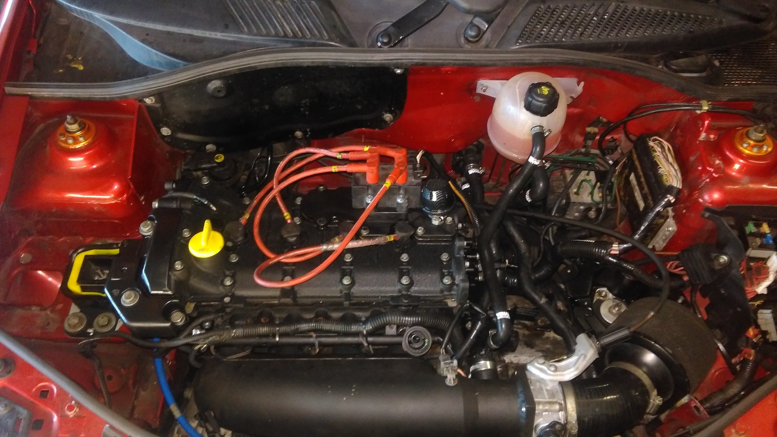

Did you have to reroute the battery or could you use a smaller filter ?
  BG 182
Ok cheers do you have to run a actual cable for the throttle aswell noticed on that pic it has a cable throttle ?
