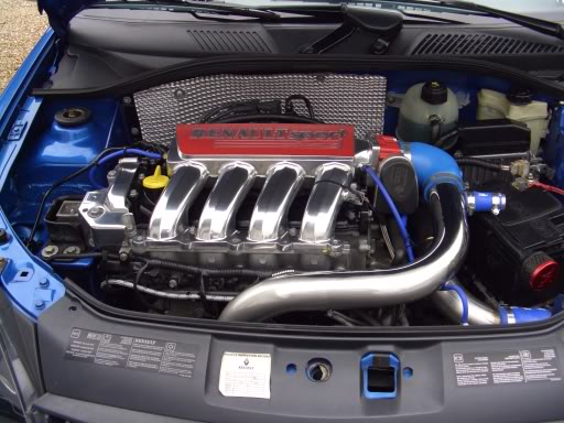

If your prepared to get your hands dirty and get stuck in you could save yourself a fair few quid, the expensive parts are the forged rods and pistons, turbo and ECU, here's a pic ​
looks a tidy install

From what i gather after having a nose round BB's cars at the FCS there pretty similar conversions, the main difference being the coolers.
Without strapping it down on the rollers i wouldn't like to say. Hopefully within the next couple of months i will find out.
