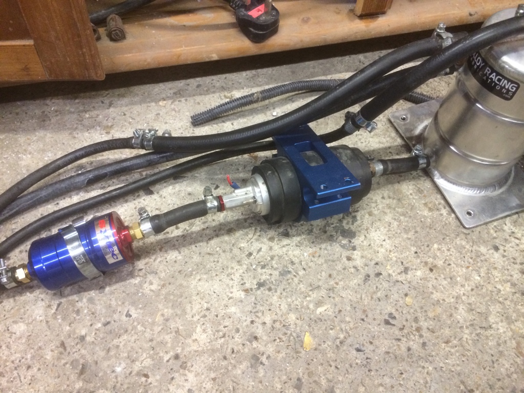

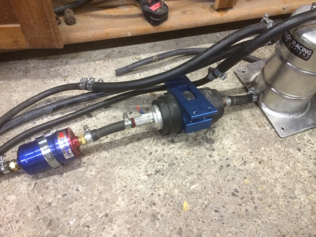

We are not sure it has one?? Here is one end
