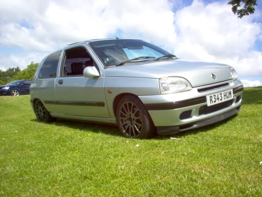

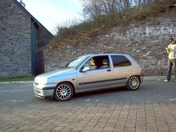

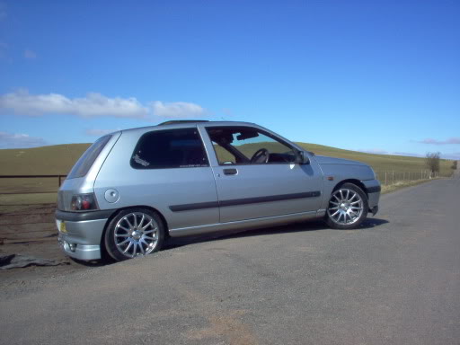

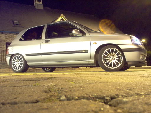

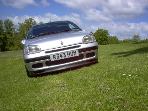

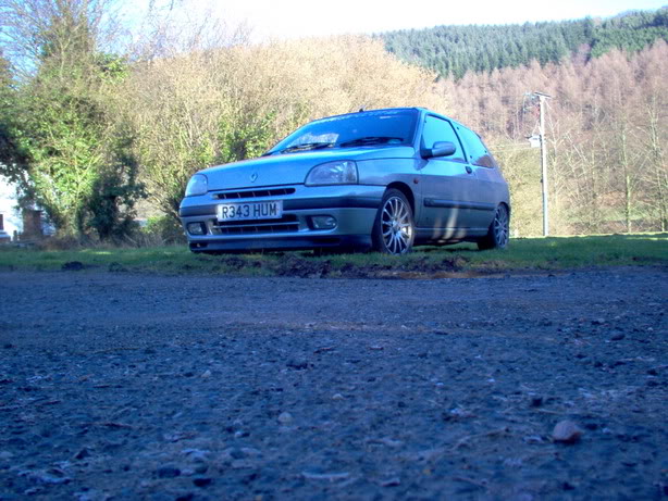

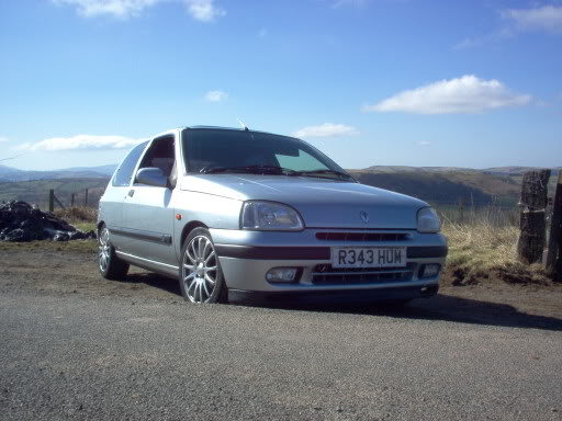

This is my clio.
did look something like this
looks a lil df now thou.
got a valver bonnet valver wings williams front brakes and rsi rear beam to go on and im searching for a turbo conversion!wat u think?
