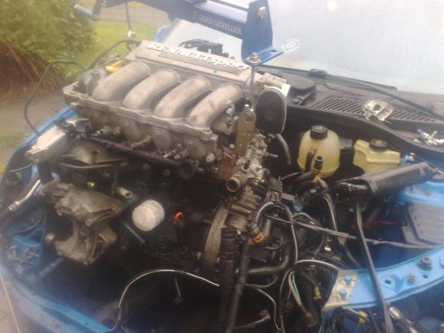

Here is abit of a update went to get some bits this morning like engine stand etc. then got to taking the engine out.

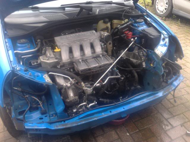

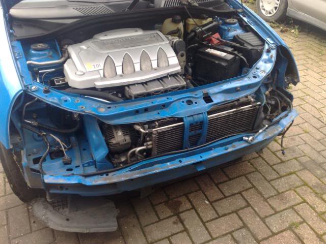

First i took the bumper off and lights:-
Then i took the rad out the beam above:-

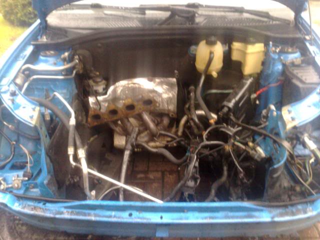

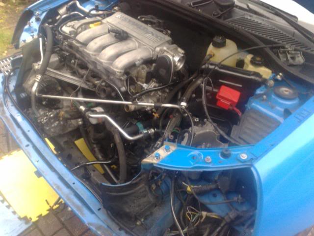

Next took wires pipes etc off dint think there would be so many on a car lol:-

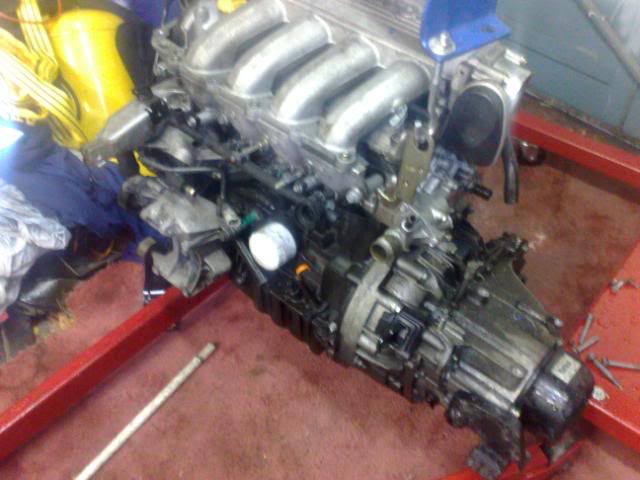

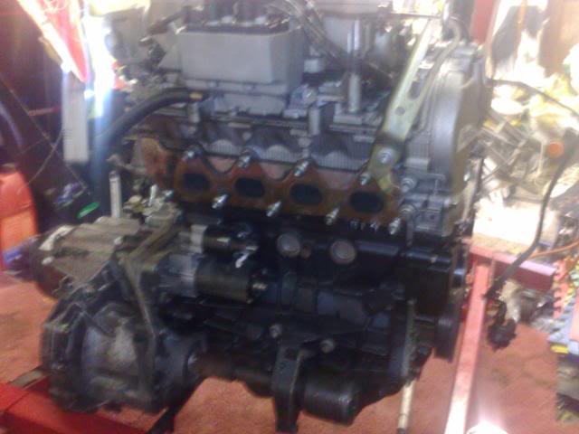

Finely came to lifting the engine out was a very tight fit.
and the engine out of car :p
Sorry bout the pics i had to use my phone. Not very good at making project threads.

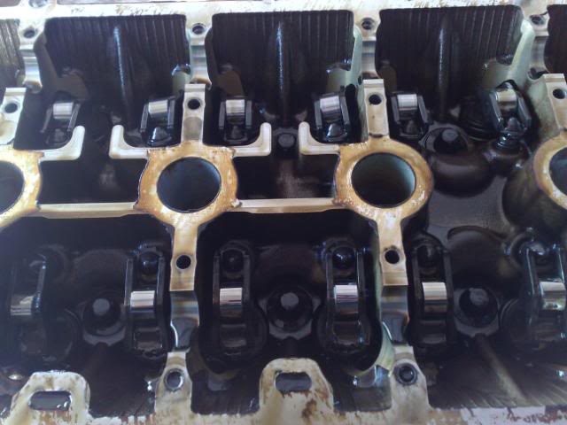

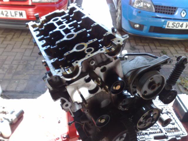

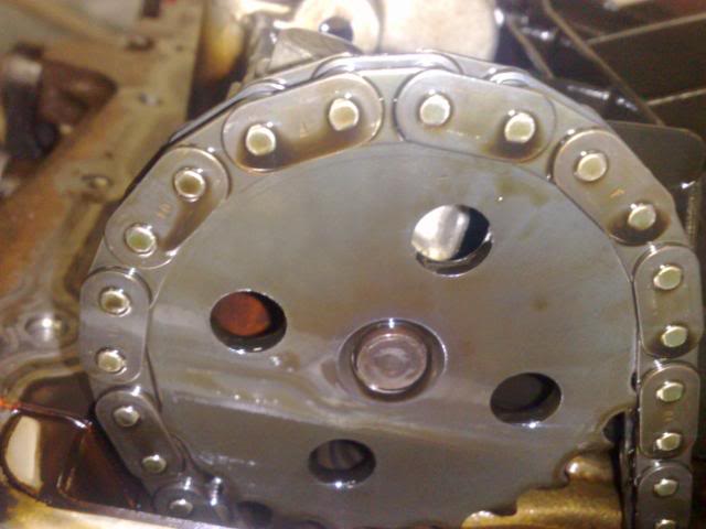

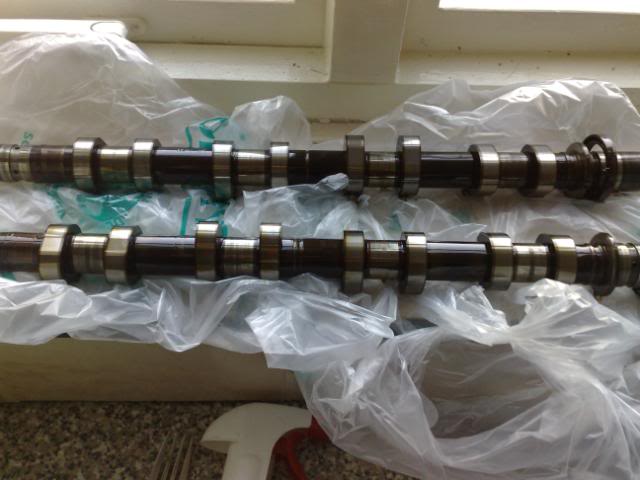

Right here is abit more of a update took cambelt off cams are now out need to take the head off an pistons out in abit :)
Here afew pics:-

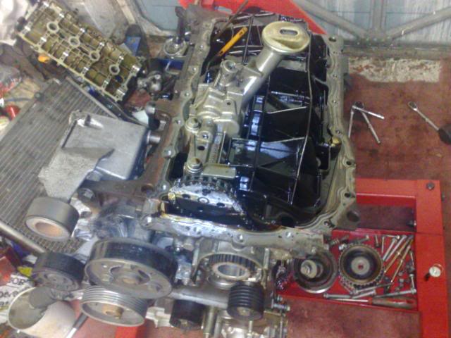

One last update for the day.
Had abit of a accident oops :)
Had the stand on the sump so had to move it, then turned the engine the other way an took the sump off.
Tomorrow all the bits should be here then its old pistons out new ones in:)
