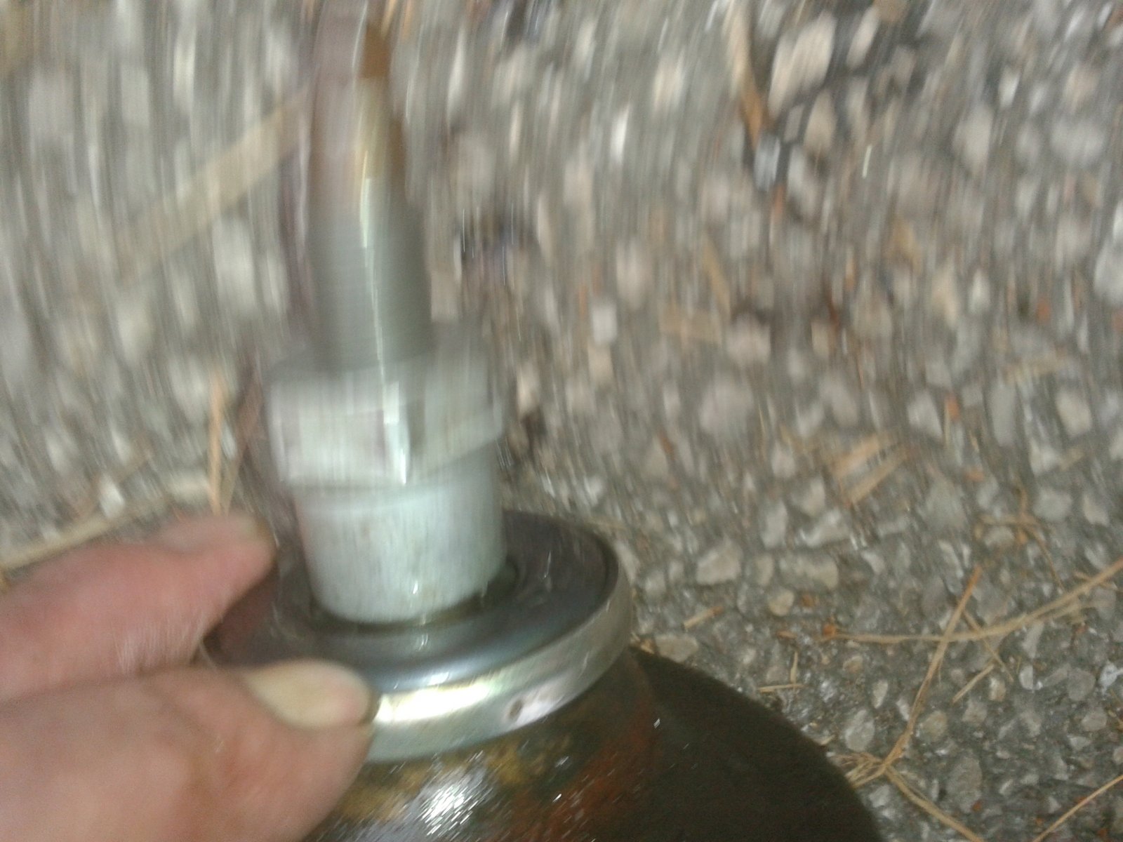

  PH2 172
You have the top mount bearing the right way up?
