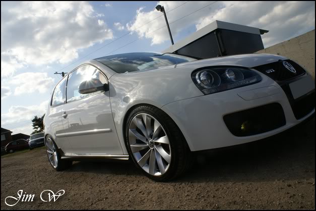

VW Golf GTi MKV – Dodo enhancement detail
A very clean car to begin with. So much so, it was difficult to make much of an impact as it’s been so well looked after already! A single-pass with Lime Prime was used to remove the surface haze and add gloss to the already spangling paint.

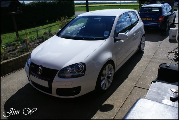

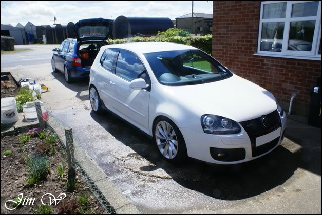

Inspection:

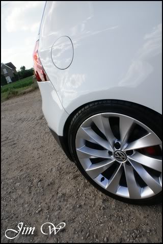

As said, car was very clean. It was presented to me in the garage and I begun to wonder if it was even worth washing it! An ONR wash maybe?
Once outside and the wheels/shuts/crevices were taken a closer look at, a full-wash stage would be needed after all.

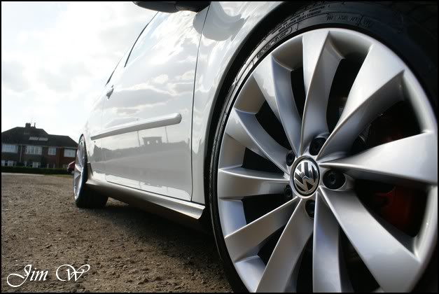

First off, the Scirocco wheels were looked at. The fronts had only just returned from a refurb and, the owner uses most of the kit I do, so, the rears were pretty spanking too!
Requiring only a splash of Tardis to lift a few tar deposits..
Sills and shuts then cleaned with G101 and Tardis.
My new Daddy-sized Born To Be Mild bottle put to use..
Once washed, I went over the lower areas with Tardis lifting minute amounts of tar... Sonus Green clay used to lift a few patches of contaminants but again, only requiring a quick pass as it wasn’t long ago that it was last done by the owner.
Residues rinsed, water-sheeted, towel dried and the blown with the Black Baron Vehicle Dryer to remove water from the window-jams, bumpstrips and badges etc..
Bone dry.

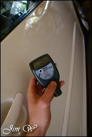

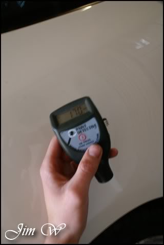

I’d been asked to take a look at a few scuffs on both the O/S and N/S rear quarters where it’d been caught in the past..

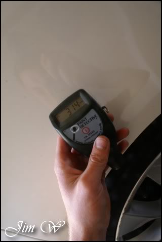

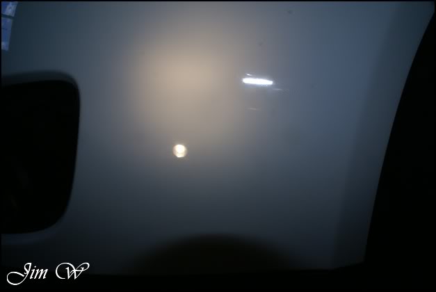

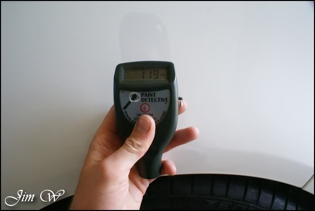

N/S giving a few interesting readings!
Compared to that of other areas on the car:

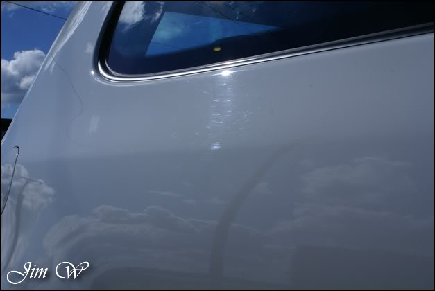

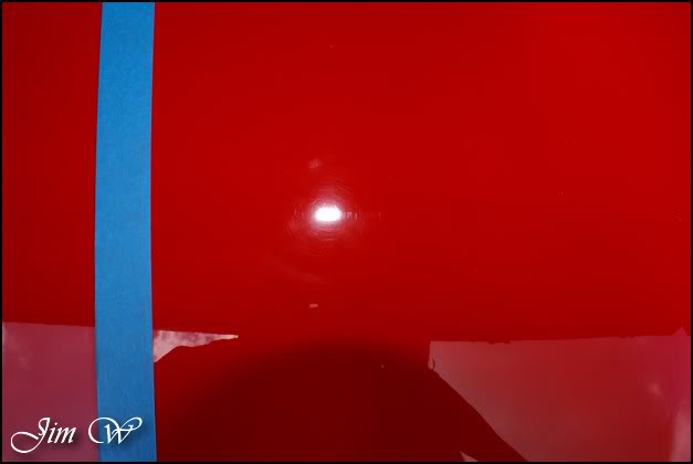

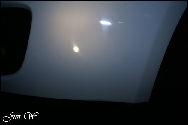

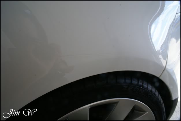

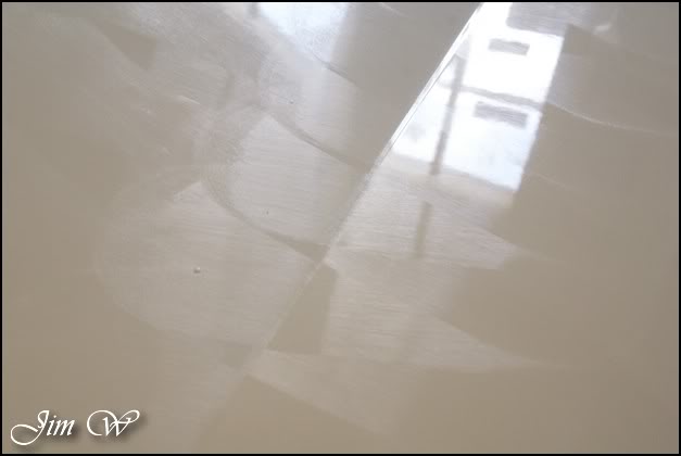

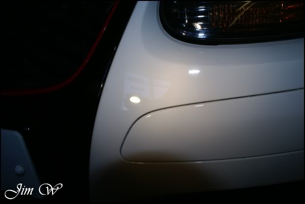

Scuff spotted just above the arch lip..

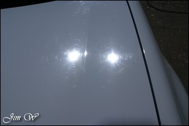

Lime Prime did nothing. Stepped up to Menz 203s on a light cutting pad. Again, very little difference (even with the surrounding swirls...)
Finally finishing on an orange heavy cut pad with IP 3.02. This paint is HARD. If a full correction were needed, multiple hits would be required to achieve the desired results; probably the toughest paint I’ve come across to date.

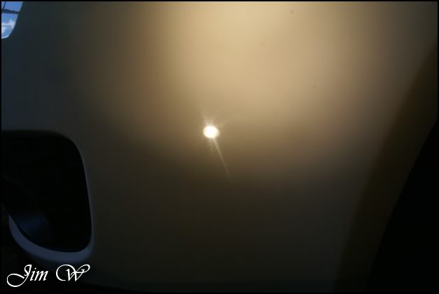

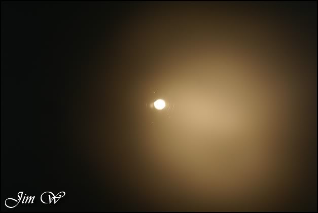

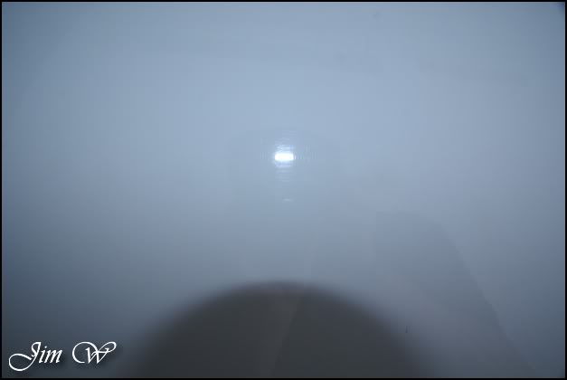

Before:
After:
As you can see, it wasn’t enough to clean the area completely, but, enough to make a difference to the scuff on the arch-lip which was the original plan.

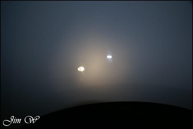

Roof before/after:

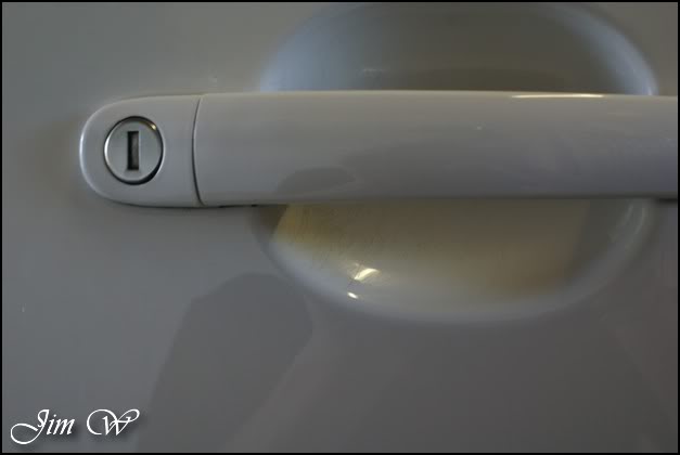

Menz 203s used by hand on a light cut pad to take the edge off the scratches in the door-handle surrounds..

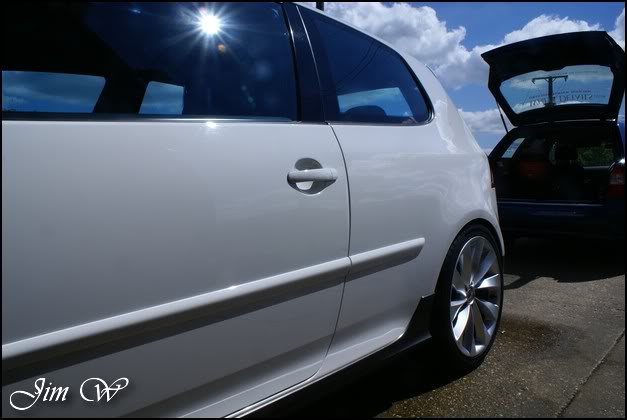

Wax on:
And off:

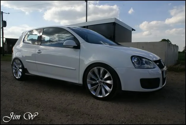

A nicely spec’d model and an absolute credit to the owner.

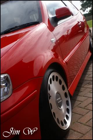

VW Polo 6n2 GTi – Dodo enhancement detail
Similar job spec involved here as the recently worked on Candy White GTi.. Equally as clean, but, a few more defects and holograms to deal with from previous machine polishing sessions.

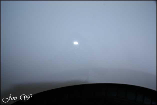

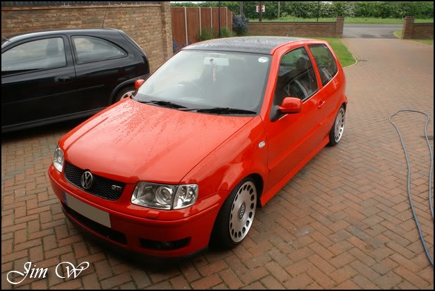

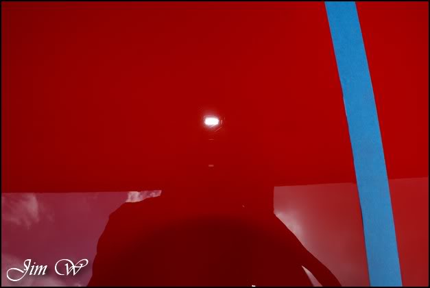

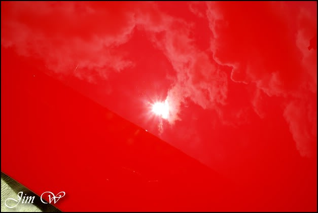

Before:
After:

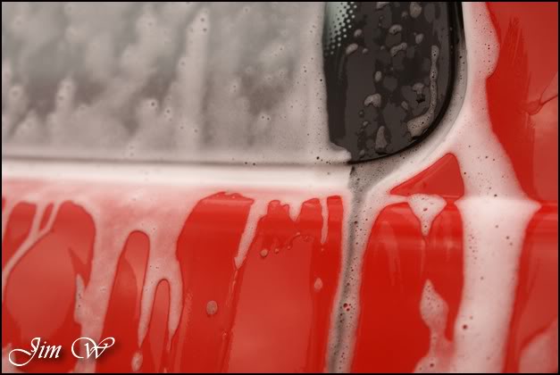

Intricate areas (badges, gaps, seems etc) cleaned whilst the foam dwelled and finally washed with the two bucket wash and Dodo’s Born To Be Mild shampoo.

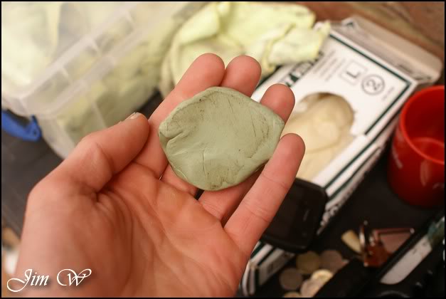

This was about the worst of the pick-up seen from the claying stages.. Said contaminants were removed from the rear windscreen which had never been done before (as it shows)

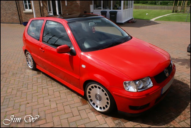

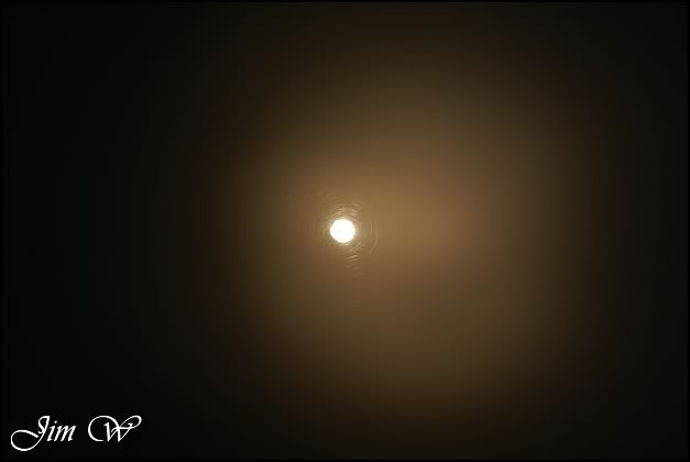

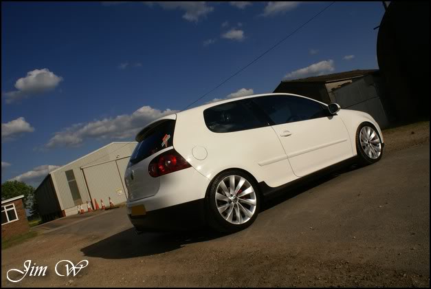

Once blown and dry, the vehicle was left stood looking like this:

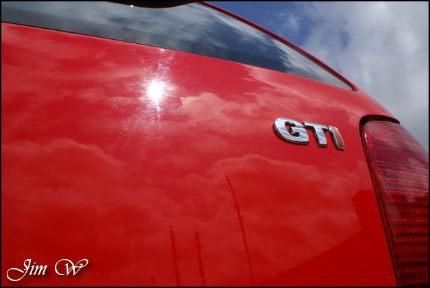

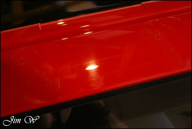

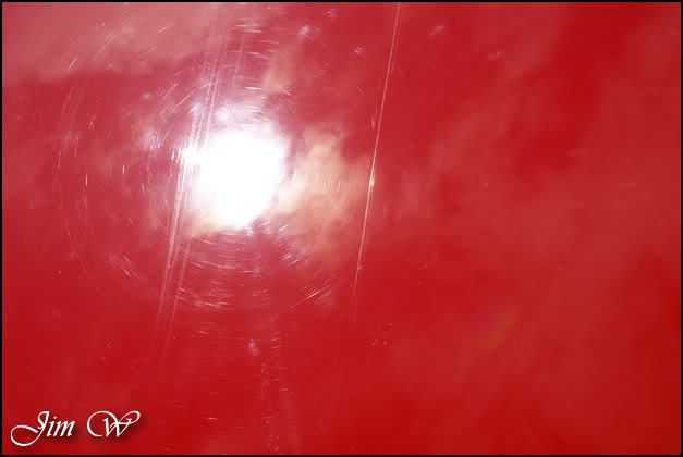

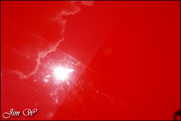

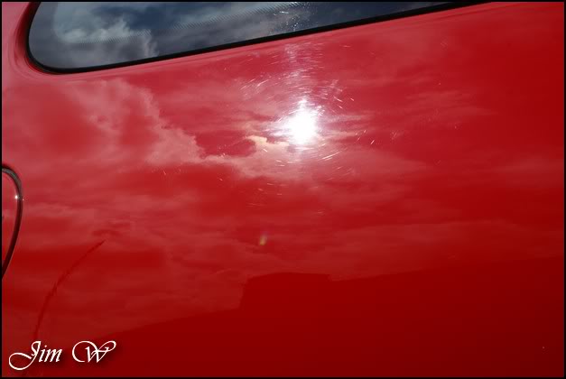

Some nice scratches that were created by a pheasant’s belly! (Bonuses of living in the countryside!)
3m polishing pad, Dodo Juice Lime Prime. GO!

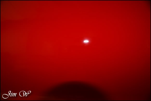

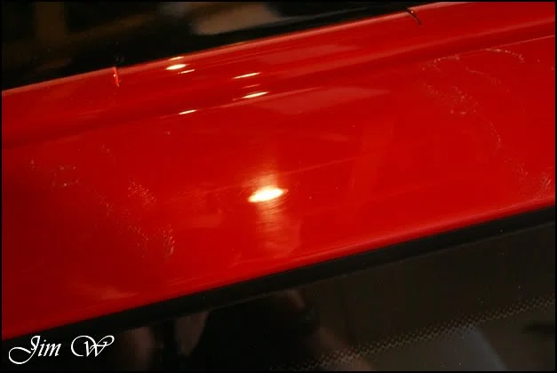

Bonnet before:
After:

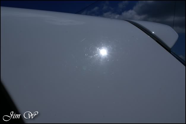

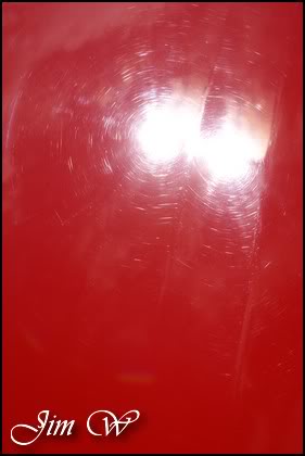

Removing the haze, but, a fair few other nicks left in the paint.
50/50:

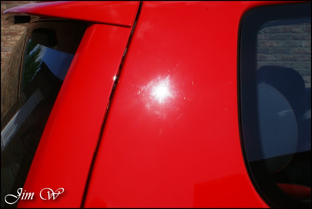

To fully remove the strange machine hologramming (they weren’t buffer trails as such, more like clay marring?), I stepped up to Menz 203s on a green Hexlogic cutting pad.. This to re-hit the scratches left by the pheasant, too.
Before:
After:
Before:
After:

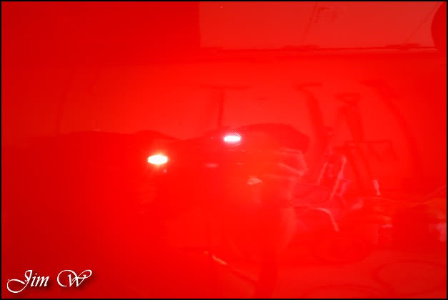

High up on the roof line..

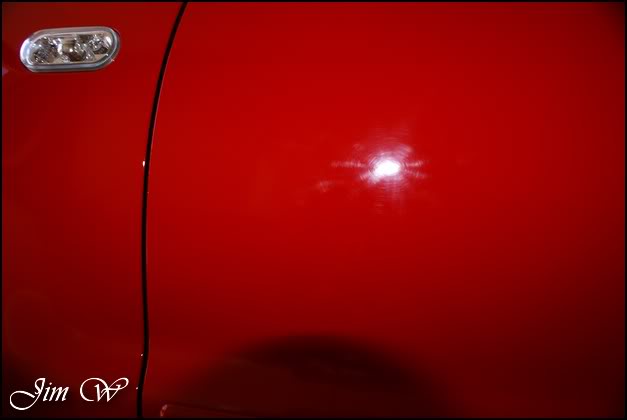

More strange marks on the lower quarters..

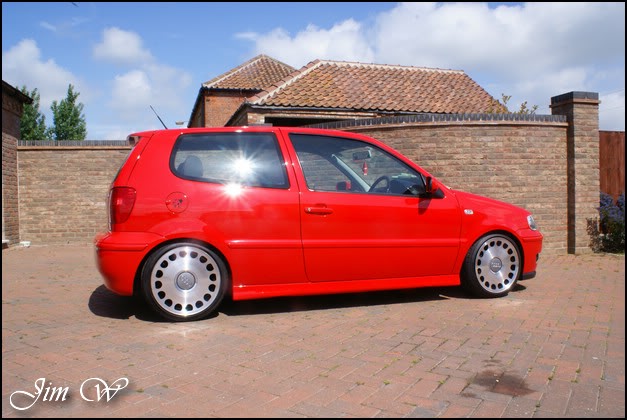

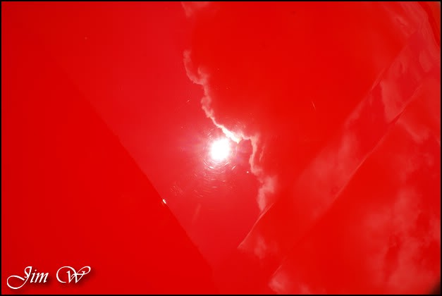

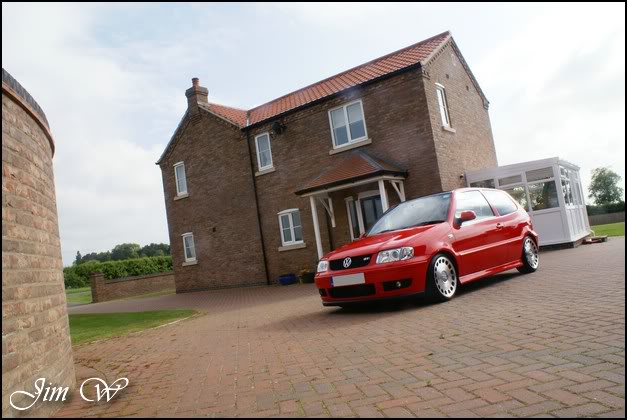

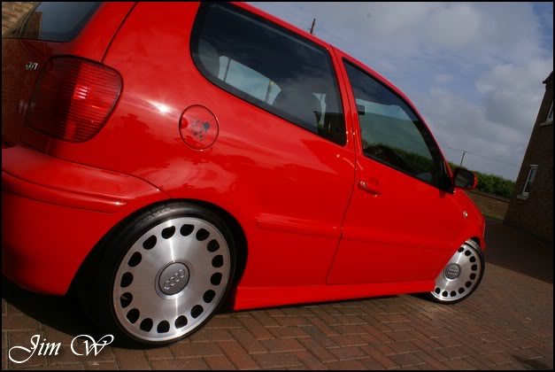

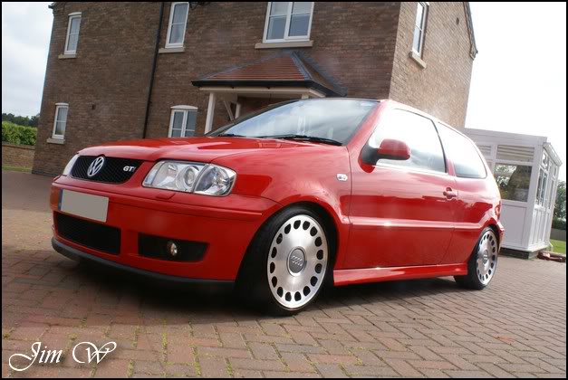

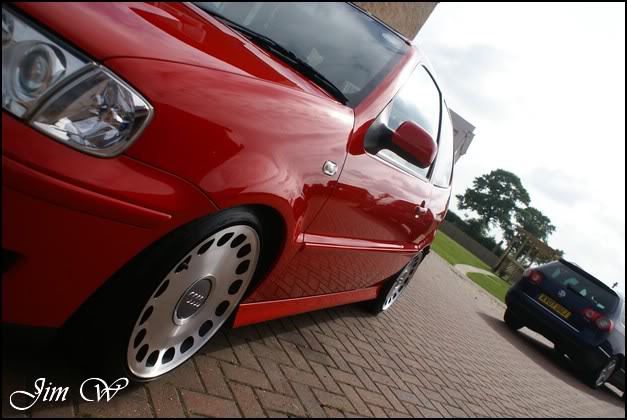

As the sun was beaming down I rolled it outside to check how she’s looking..

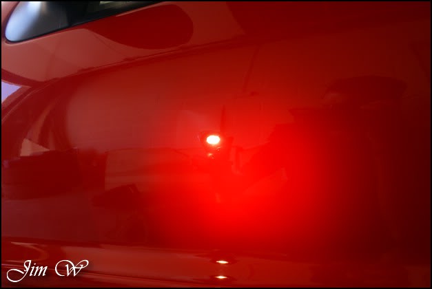

The O/S C-pillar hadn’t cleaned up as well as I’d hoped; Menz 203s and the Green pad used to fix this nicely..

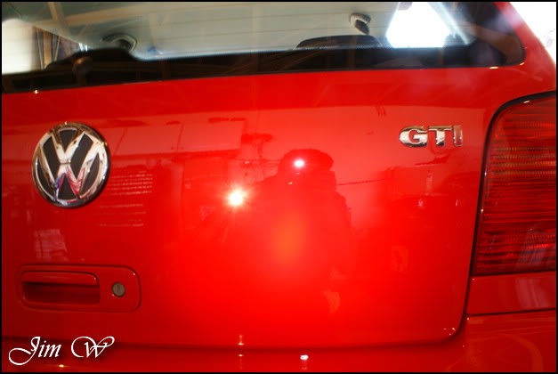

Tailgate also fully 203s’d:
Areas that had been machined properly received a glazing of Clearkote Red Moose Glaze. The vinyl roof was cleansed by hand and Dodo Juice Lime Prime Light. Wax of choice? It had to be SuperNatural. Trimmings were done. Dressings applied and glass cleaned. Finished.
Lovely little car!!

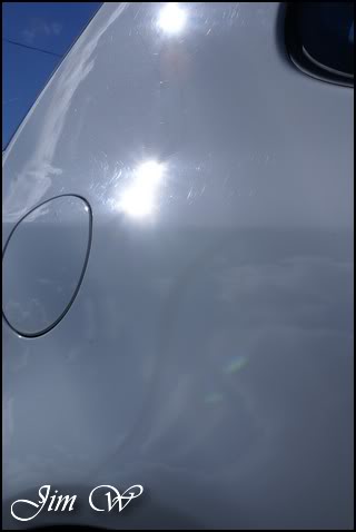

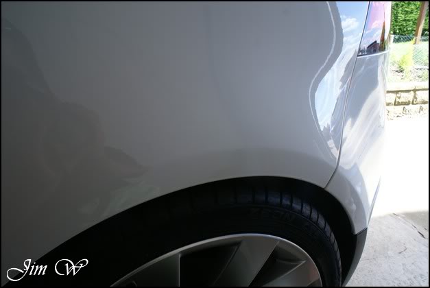

Before:
After:

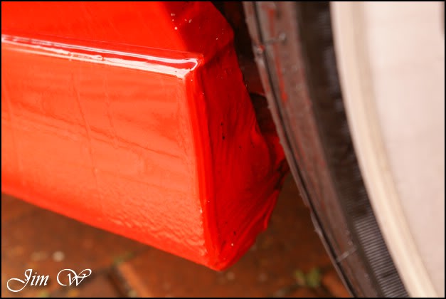

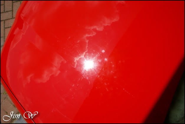

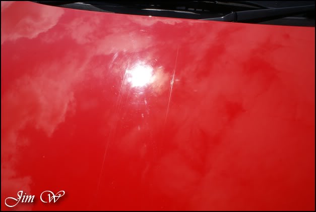

Bonnet before:
After:
50/50:
Before:
After:
Before:
After:
