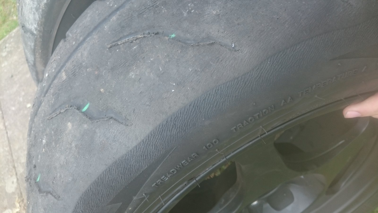

I'm running R888R's on a set of 15's on my 182 with standard cup suspension. During a track day on Friday, I noticed that I seem to be wearing the sidewall slightly. I run the tyres at 30psi hot so I don't think it's because the pressure is too low?
I'm wondering whether it's because the standard cup suspension is too soft for the tyres and whether something stiffer might help? I don't care about 'lows' and don't want a cheap nasty set of coilovers so I'm looking at the Cooksport springs, do you think a set of these would help?
Has anyone else come across this issue?

You need more negative camber basically.
As the suspension is rolling to one side it'll be getting more positive camber leading to sidewall wear.
A set of springs and some camber bolts would be the best place to start.

One of the shocks was leaking for an MOT 4 years ago so presumably replaced or ran out of fluid but other than that, could be original!
I should have added that I'm already using camber bolts and had it set up on a proper laser alignment with as much negative camber as possible, I think it was about 1.5 degrees from what I can remember... Would the springs help or do you think I need more negative camber as well? If so, how?

Going with lower springs will automatically give you a bit more camber, so that would be the first thing to try. Then get the alignment done again once lowered. Max out the camber bolts really.

As above, new shocks, lowering springs and re-alignment and you'll be sound, maybe change the tyres as well as they look near done. I can get up to - 2.40 with AMAX springs and camber bolts

@STEVE.M What are standard pressures for R888R's? I definitely don't have blankets... I ran the older set of R888's a bit higher and the middle wore down first so did a bit of research people suggested 30 hot but maybe the new tyre type needs to be a bit higher...

Thanks, I'm already running eibach camber bolts at max so I'll up the pressures a bit and look at springs. What's the next step for more negative camber? Top mounts?

I agree. On a track you push the limits of the suspension much more beyond its intend design....road.
Get the alignment checked, adjusted with camber bolts and youll see an immediate improvement. When I had my 200SX, I updated the suspension (Nismo) but all was not right. I got a proper alignment check and it made a world of difference.

34 front, 30 rear, cold, they won`t roll on the sidewalls to disintegration that way.

Have you kerbed the wheels badly? That could have thrown the alignment out. I doubt it myself.
Probably needs more camber..........or you need to turn down your enthusiasm :tongueclosed::up:

The tyres have been pushed (full marks for that) whilst under inflated.
It`s all very well setting your pressures immediately after putting in some laps, but if you then faff about checking your wheel nuts, oil, coolant levels & your email, they will be lower when you eventually go back out.

Sadly I think you're right, thanks for full marks though! I checked the pressure this morning and the front is down to about 20psi, but it's much colder than it was on Friday when they were at 30 hot.
I was wearing out the middle of the tread on my last set at 36 hot so I think I'll aim for 33 hot and see what happens there. I guess I need to try and warm them up a bit more gently... What's the best way to do this other than just taking it easy for the first few laps, I was lapping in the 54's on Friday, would a couple of laps at 60 seconds be enough to get them a bit firmer?
I've not read about a clio running them this high or having issues warming them up before? It'd be interesting to know what pressures others are running hot and cold to see the difference they get on track?
I set my r888 cold pressures to 22-24psi front/24-26psi rear depending on conditions and have never had an issue like the OP's.

Anyway, it's tyre temperature that's the key thing. Pressure is used as a "tool" to get to the temperature.
90-100c degrees is what you want across the whole tyre on an R888.

You definitely do not want 34PSI cold. Mental suggestion. Aim for around 30PSI when HOT. As in just come off track and set them straight away.
This is what I did but they seem to be rolling over too much, what do they drop down to cold and how do you warm them up slowly? I'm thinking I need to aim for a bit higher to prevent them rolling over before I get heat into them.

I set mine around 23psi cold. Do the sighting laps. Then a steady first session. That seems to get them to about 30 when hot on my setup. I then just monitor them throughout the rest of the day and keep them at 30. Often don't even need to touch them unless the weather changes a lot.
If you're going to focus on track days though, rather than road driving, you'd feel a huge benefit getting some decent coilovers. They're not cheap but they will transform the car.
Never EVER set track tyre temps cold , they will change depending on track temp for starters. look at body roll , whilst you can use springs to counter this thats not the way you should be doing it .
