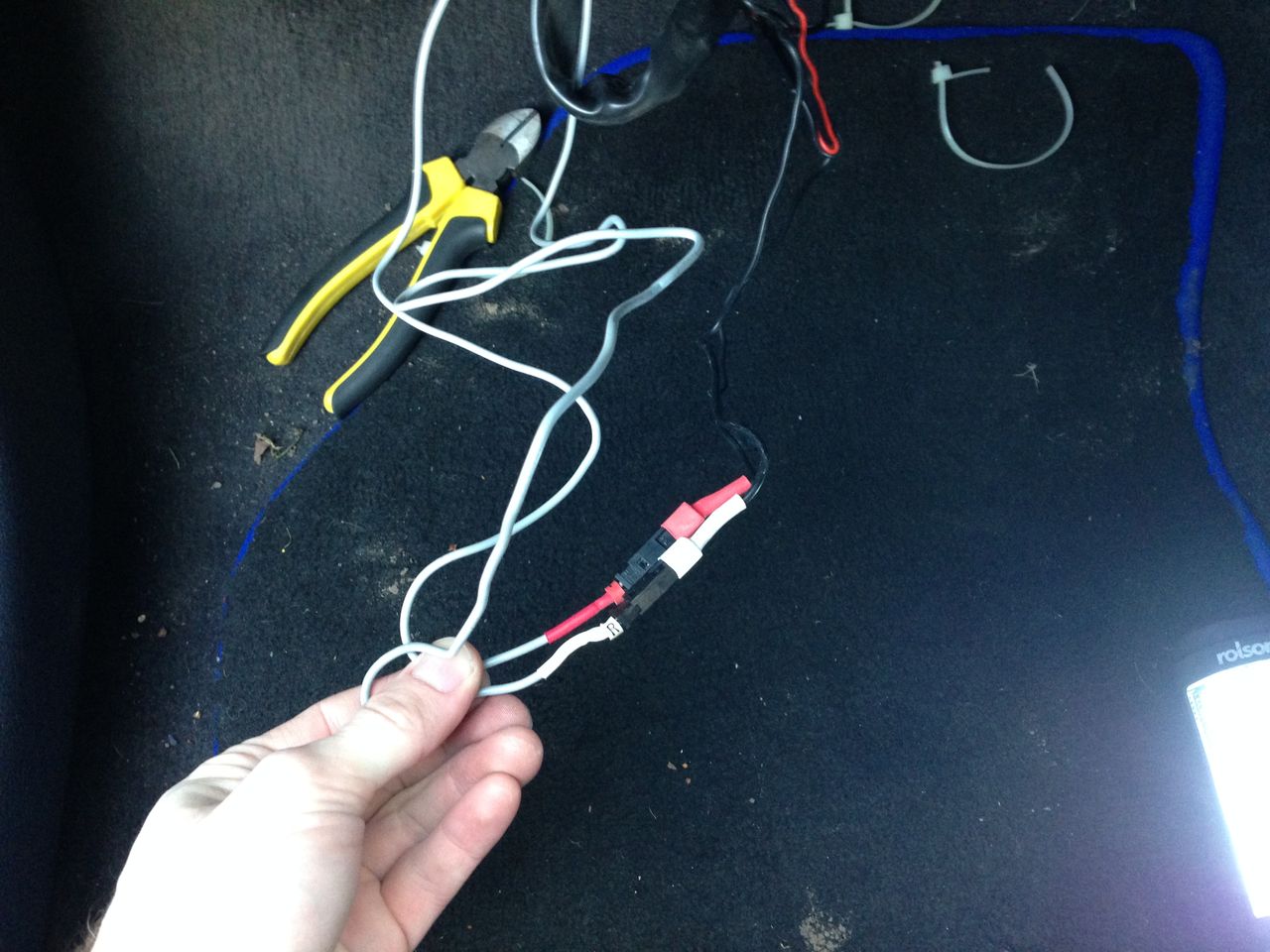

I did this today...
My alarm was right on the floor of the chassis underneath the centre console. In this thread, the alarm can be seen under the passenger airbag: http://www.cliosport.net/threads/ph1-ph2-dash-conversion-full.583827/ Not really a surprise tbh given that most 172/182 alarms are dealer fitted so each installer might route wires slightly differently (though annoyingly I only found this out having removed the upper dash & airbag to find an empty void)
Swapping the red & white wires was really easy. They have quick release connectors on them & in the whole alarm loom there was only one pair of red/white whites so it was really easy to identify. Just trace the grey wires from the ultrasonic sensors all the way back to the alarm loom and where the 2 grey wires become red & white, swap them over.
  172
I did this today...
Most threads seem to suggest the alarm is under the passenger airbag (e.g. picture of it in here: http://www.cliosport.net/threads/ph1-ph2-dash-conversion-full.583827/ ) but annoyingly I removed the dash & airbag to find an empty hole. My alarm (and this is a guess) seems to be on the floor underneath the centre console, maybe 20cm forward of the OBD port. Happily where all the individual wires from various sensors joined into the alarm loom was behind the glovebox next to the relay box. Not really a surprise that the same alarm could be installed differently, given that it was a dealer not a factory option.
Swapping the red & white wires was really easy. The grey ultrasonic wires turn into black wires halfway along the loom & have quick release connectors so you don't necessarily need to go removing everything to find the little box of electronics that is the actual alarm. The quick release connectors have white & red labels on them.
Red to red and white to white = 80% sensitivity (shown below)
white to red = 20%.
