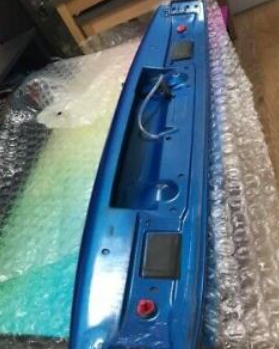

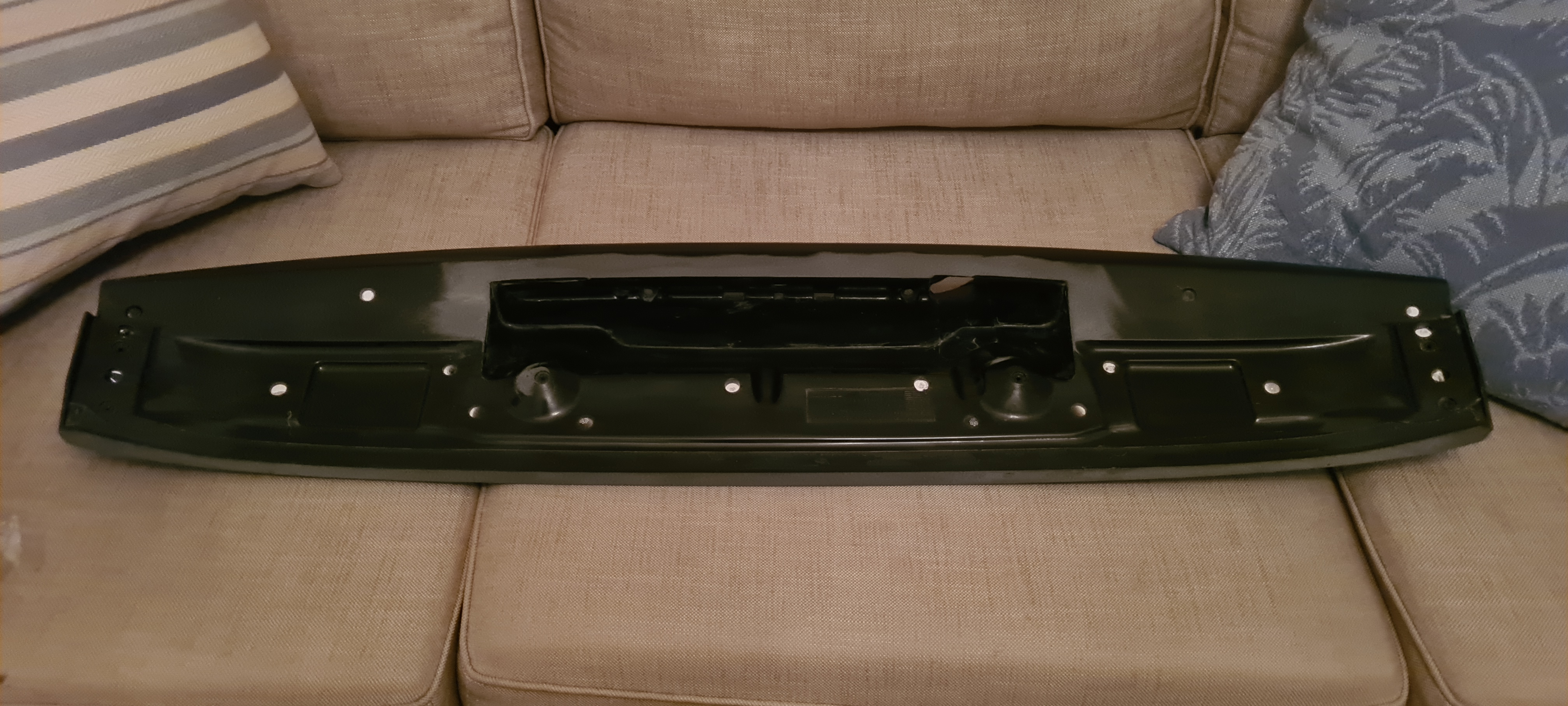

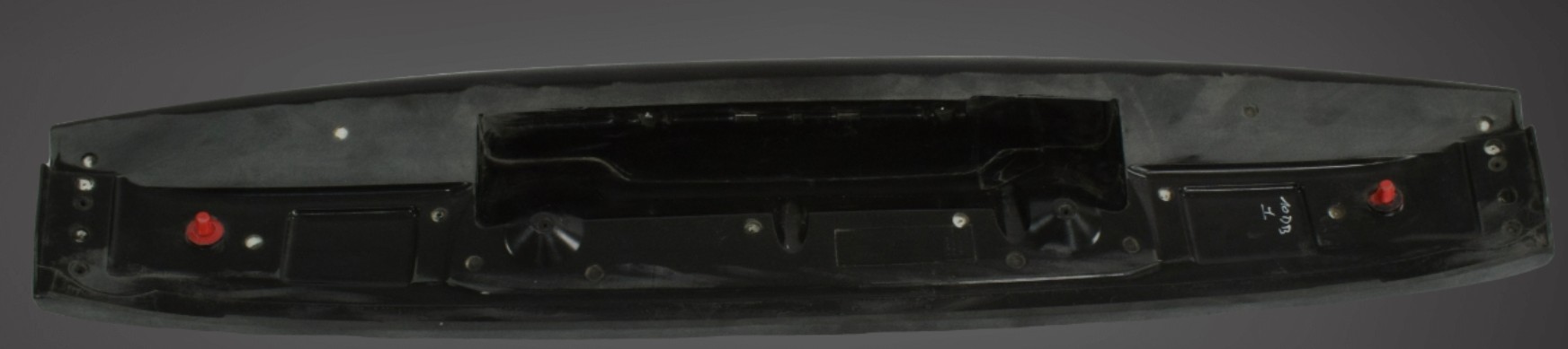

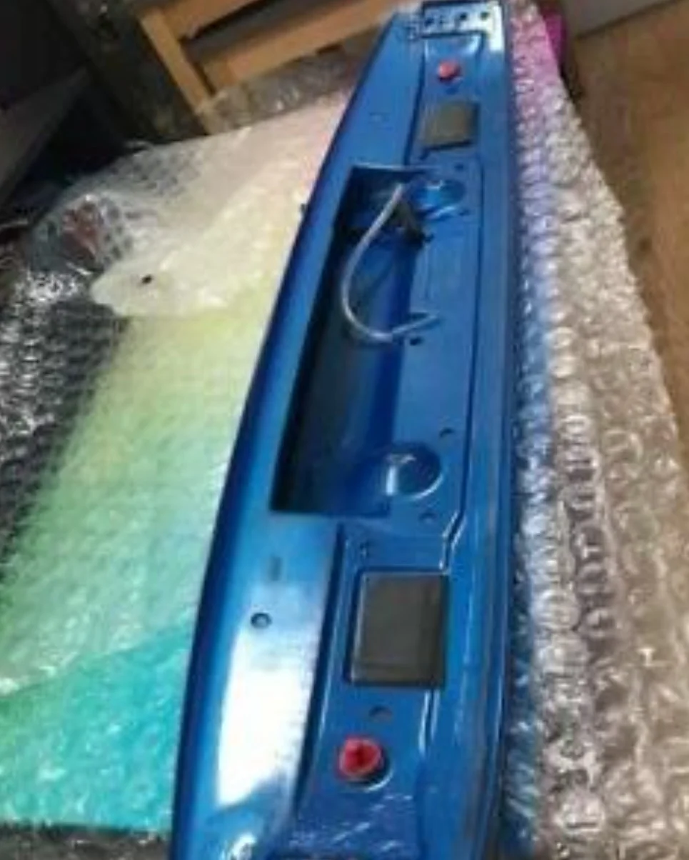

Found a disparity between the sample pictures on the website and the one I have received.
It seems there are 2 red dowls(?) That are missing. Both on the right and left hand side.
I currently do not have a car on hand to reference. As prices for clio 172/182's are unrealistic here in Australia after the virus that shall not be named ran its course. So after selling my last inferno 182 cup. I've just been collecting parts for my next project.
I've found a single sample photo online that had the red dowls. But just want to make sure that's the actually the case.
So people, please share all photos you have of standard spoilers, cup spoilers and v6 spoilers if you have any.
Bonus points for underside shots that show mounting locations, and possibly the red dowls

They're not needed. They're just locators.
The spoiler is held in by the screws on the side

Do they serve as locating tabs for installation mainly?
Just worried they serve an integral part in the structural integrity.
The spoiler received just seems to be blanked off.
as above absolutely fine without them they just locate it. just make sure its sitting nice and square and all the shut lines are good before giving it a final torque (dont need to go tight with them, seen people crack them)

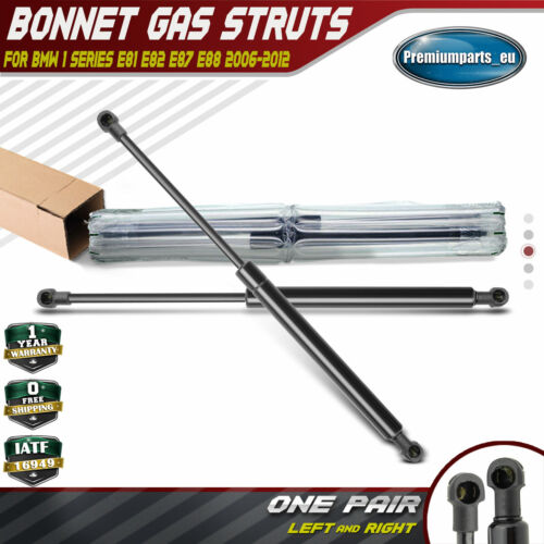

Yeah they use shorter gas struts which were apparently a fortune but I'm sure people use a BMW 1 series strut which was cheap and fits, there will be a part no somewhere.

Haven't bought myself, but from previous research, you need 1st generation BMW 1 series bonnet struts. Something like this:
