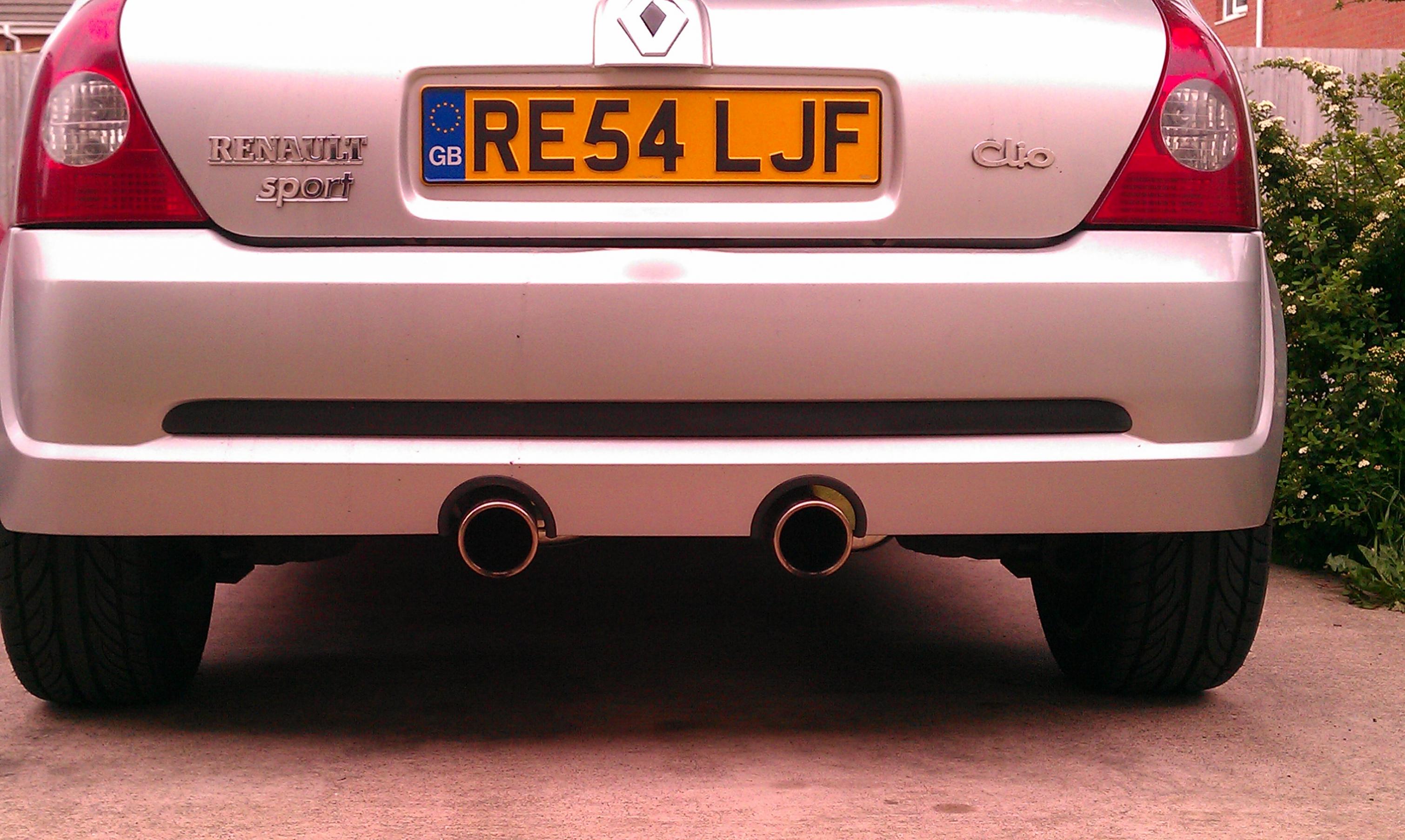

My rs192 went on ok. No probs with it knocking or rattling. The right hand pipe sits slightly lower but is marginal. Like the other guy said its not leaking and sounds good so I'm leaving it alone.

The tailpipes stick out about 3/4 inch
