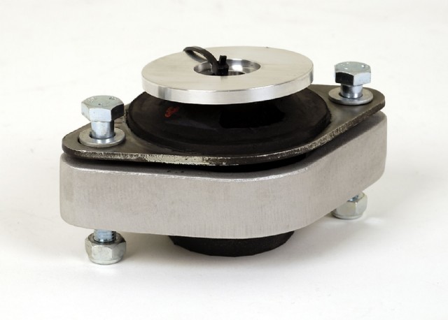

Re: Upper gearbox mount- turning upper nut looks like its going to rip the rubber mou
With the Vibratechnic mount all parts are on top of the battery tray!
You don't need to remove the battery tray for the mount change either.
The mount goes on the top. It is an easy job if you think it all through and the top 18mm nut comes off. Not easy when the top nut won't come off, but then it isn't difficult to take all the frame off and dismantle it in a vice. Put the frame back on first then fit the mount last as that way it's easier to get the three 16mm bolts in the gearbox housing.

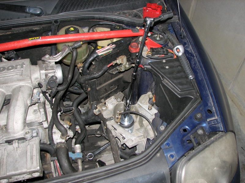

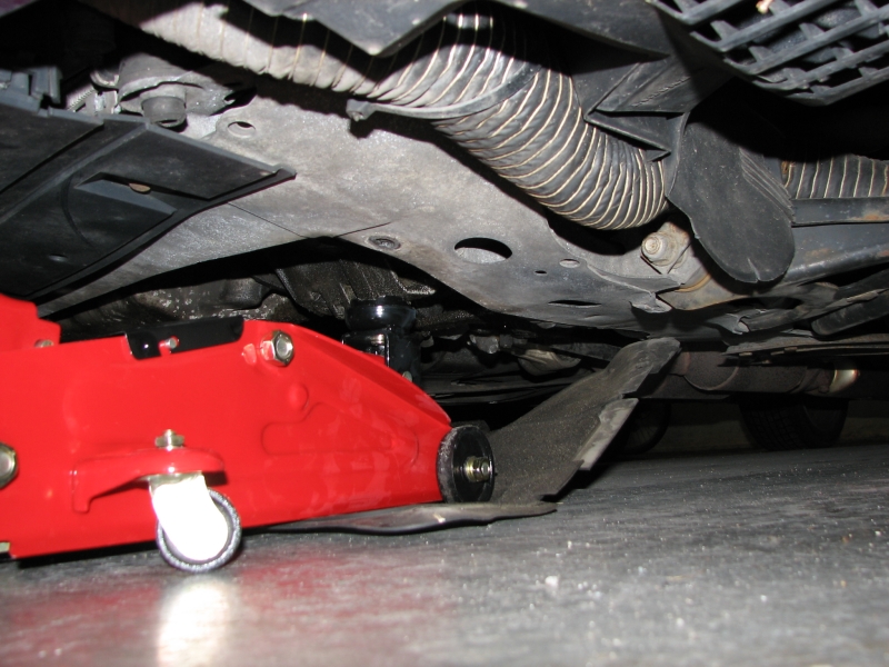

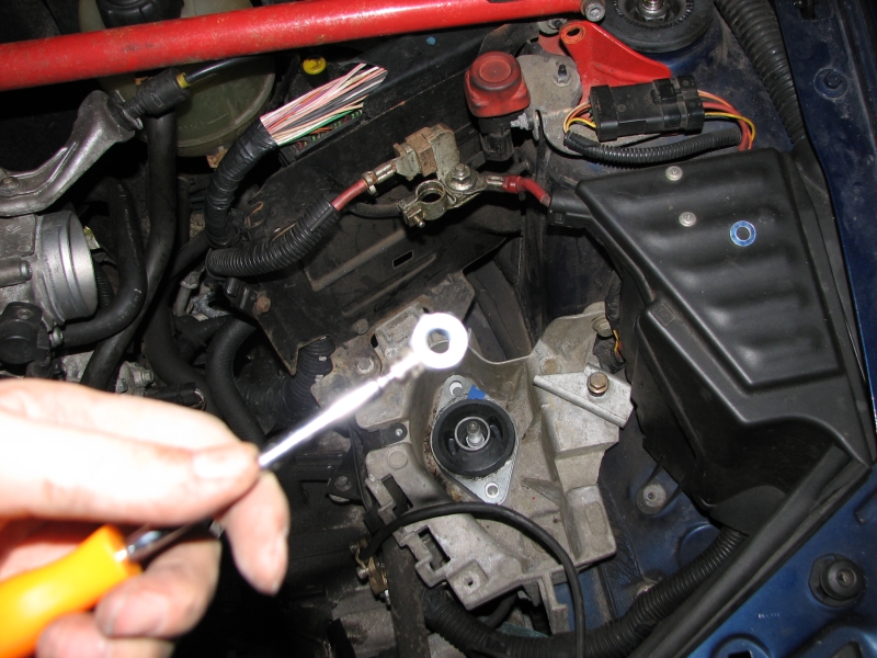

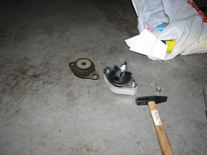

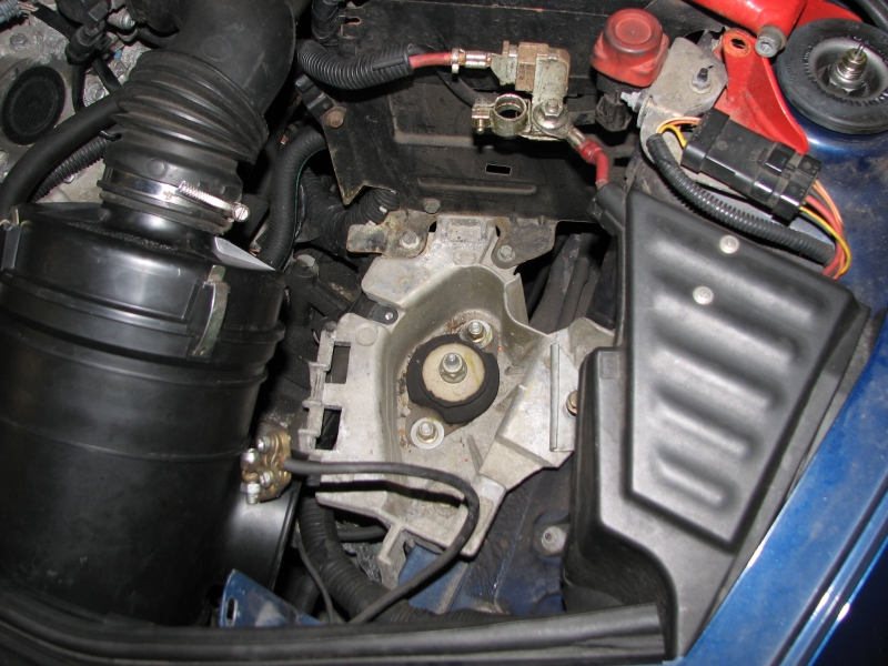

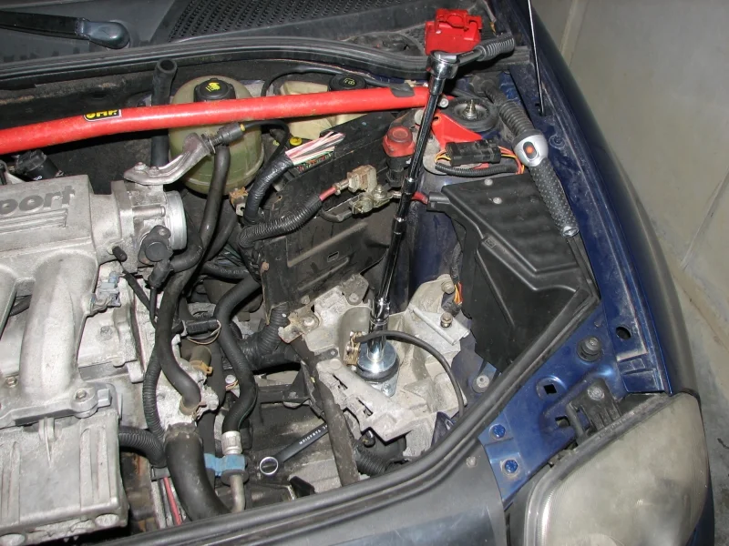

This is how I did it following Fred's instructions
Used the large torque wrench to loosen the 18mm nut. Then I undid the 2 13mm nuts and caught the bolts underneath.
out with the old in with the new
Magnet on a stick came in handy many times while working on the car. Used it here to help position one of the 2 small nuts that has to go underneath the battery tray. For the other one I had to stick my hand down that hole :mad:
The whole shaft kept turning so I had to block it with a spanner. Took me a while to position the spanner correctly
Jacked the gearbox up again and tightened everything.
  172 Ph1/Scooby MY00
What's all that weird ducting do in the bottom picture?
