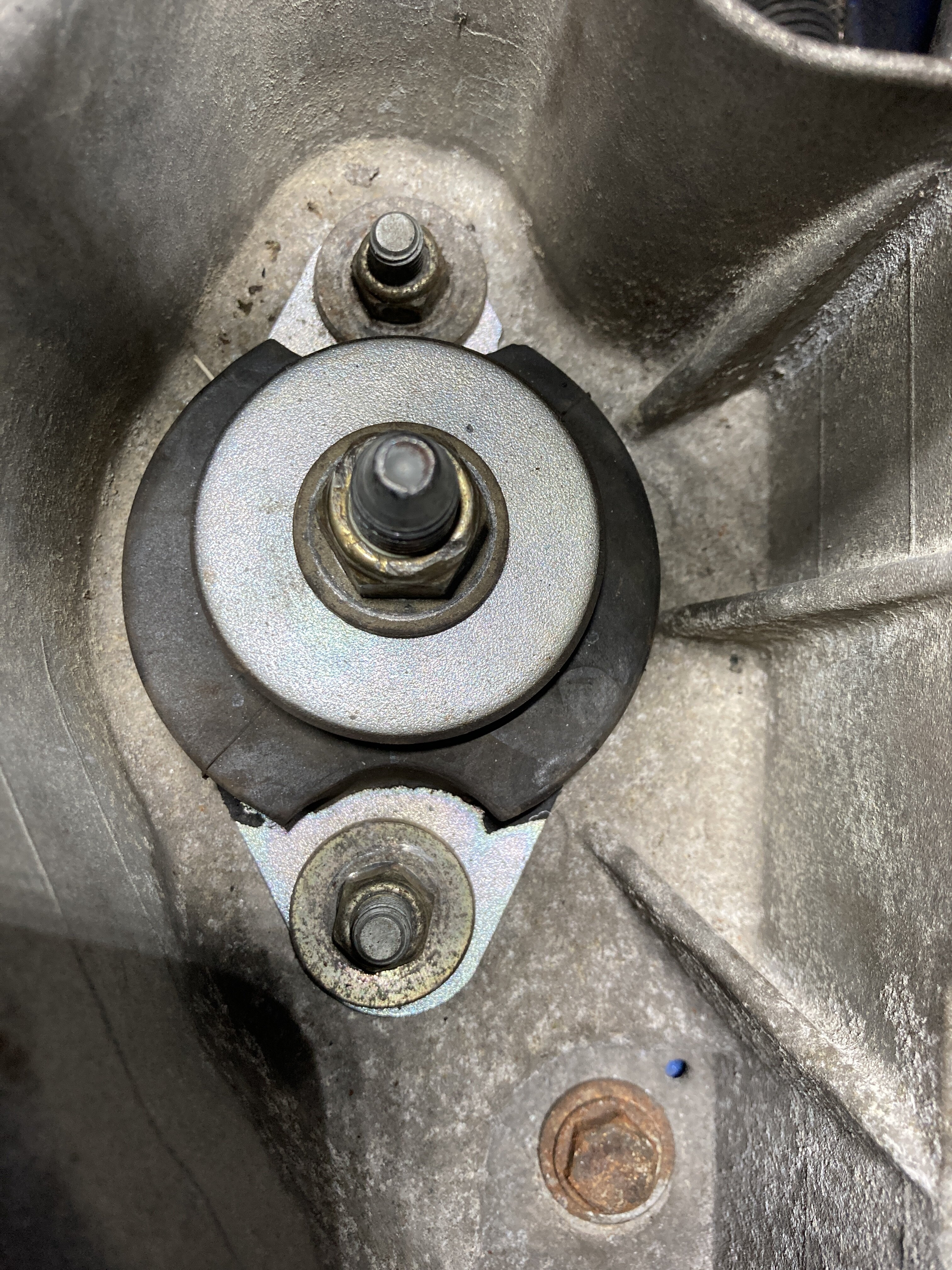

Please could someone whose done it, confirm the two smaller nuts (13mm) on the upper gearbox mount are definitely 62Nm?
"Upper Gearbox Mount:
- Central nut: 62N·m
- Mount to Gearbox: 62N·m"
(posted on the sticky so probably won't be seen, hence posting here as well)
Thank you

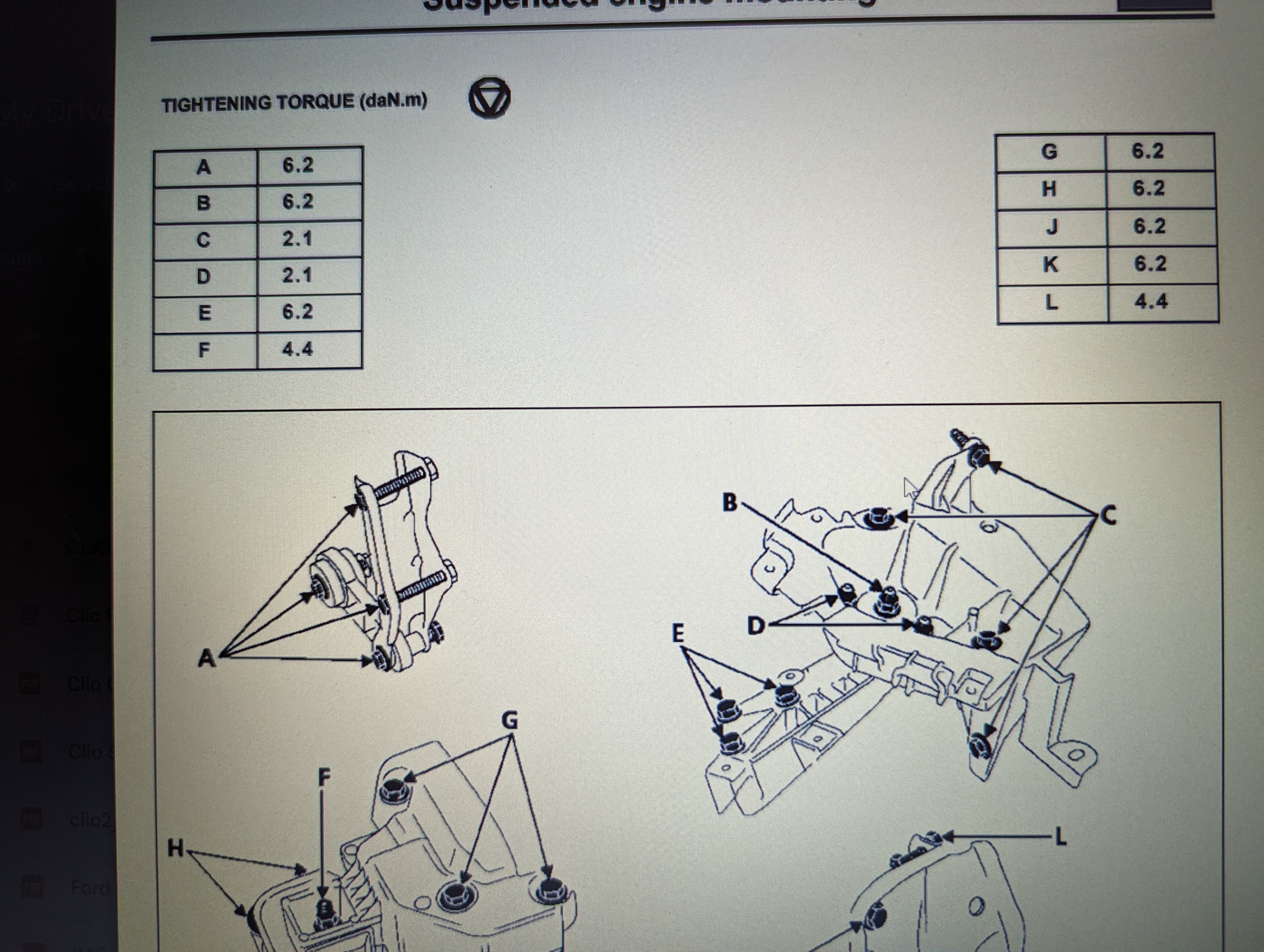

Just found the spec in the workshop manual.
It's 21Nm
Doh! Started torquing them and didn't feel right, may have done a bit more than this. Best to leave slightly over-torqued or re-torque correctly d'you reckon?
What have others torqued theirs to? The sticky will need updating as others may also follow this guide.

Just nipped up will be fine.
