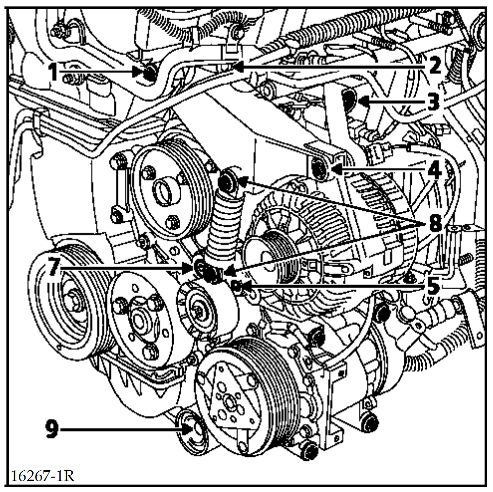

1. Alternator upper support mounting bolt - 38Nm + 0.4
2. Alternator upper support mounting bolt - 32Nm + 0.3
3. Alternator/block tie-rod mounting bolt - 62Nm +0.6
4. Alternator upper mounting bolt - 32Nm +0.3
5. Alternator lower mounting bolt - 38Nm +0.4
A lot of the bolts in the illustration won't apply to you but bolt number 3 goes directly into the block so i'd say 62Nm is where you'd need to be on all the other bolts from bracket to engine block.
The rest are between 32 & 38 Nm but you'll have to use your judgement.
alright thanks!

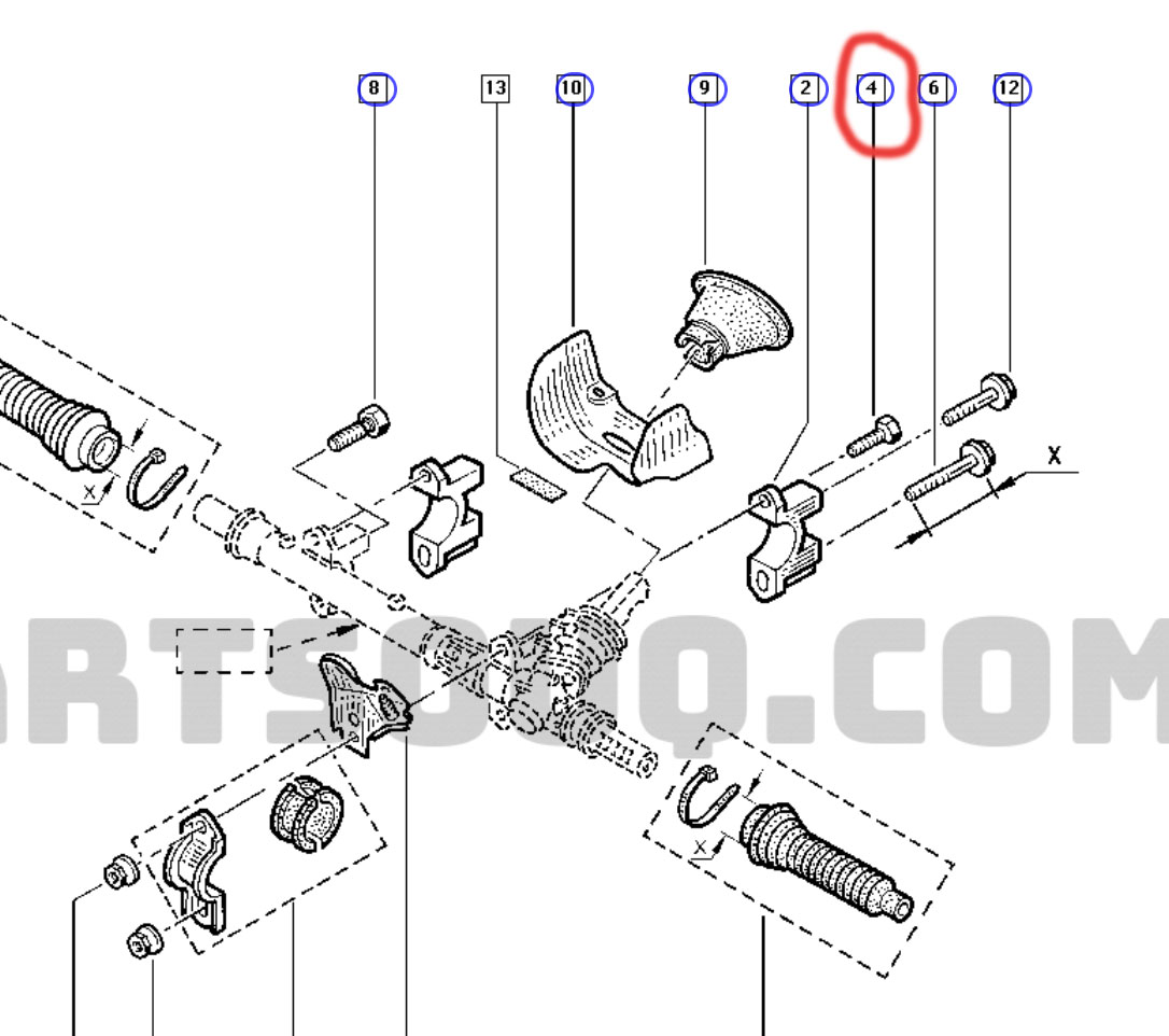

Another one that was hard to find were the 2 top bolts (M8 x 35mm 8.8) on the steering rack that hold the bushes in place. These bolts also attach to separate brackets holding the power steering pipes - number 4 in this illustration. Torque for these bolts are around 25-30Nm - Thanks to @JamesBryan for the info.
Please don't confuse with the steering rack bolts (M10 10.9) which hold the brackets to the subframe - numbers 6 and 12 - those are 50Nm.
Only Renault could design a bracket requiring 2 different size bolts with drastically different tollerances lol

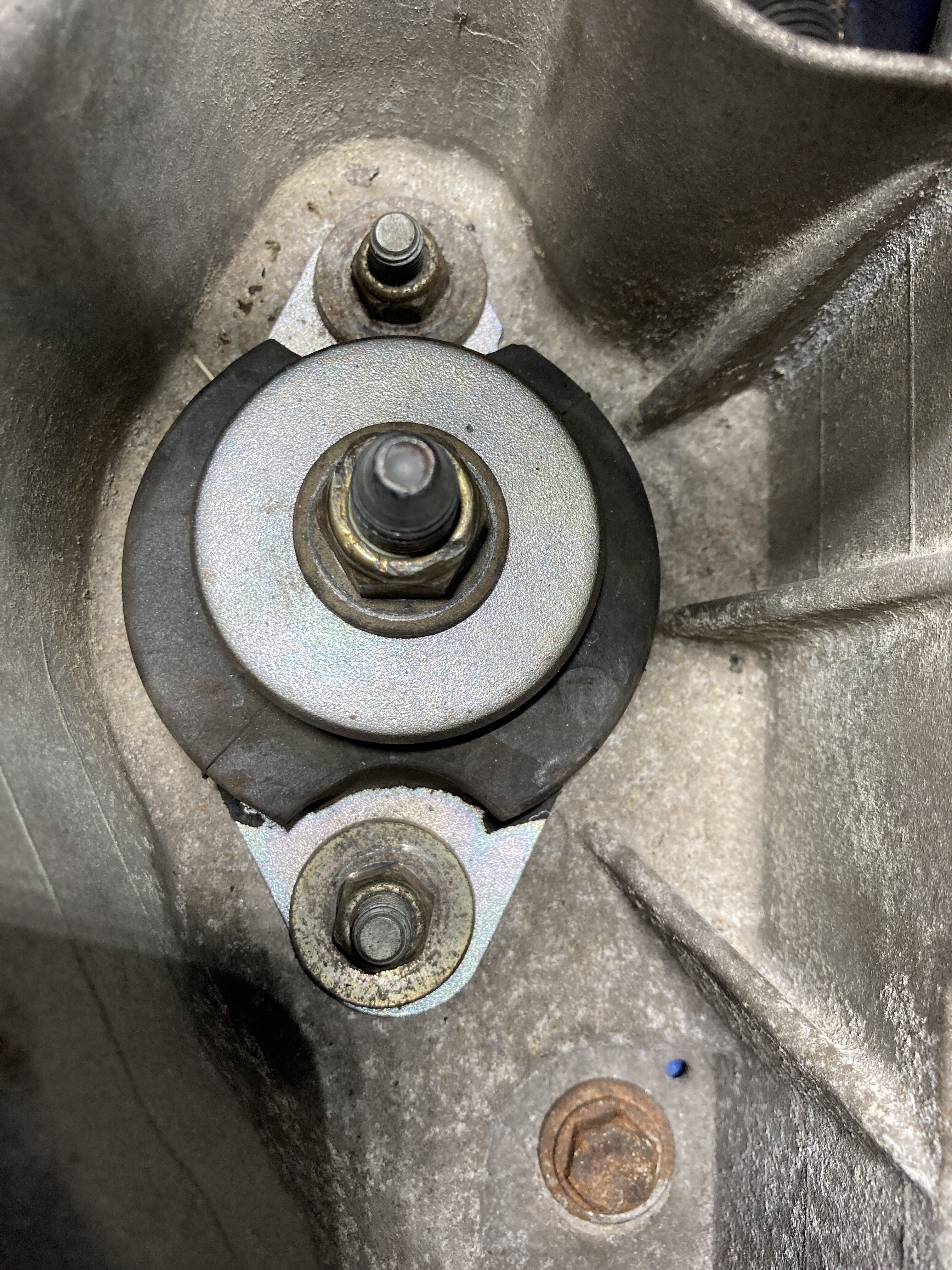

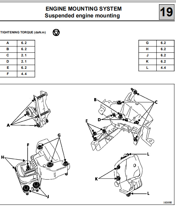

Please could people confirm that the two smaller nuts on the upper gearbox mount are defo 62Nm?
"Upper Gearbox Mount:
- Central nut: 62N·m
- Mount to Gearbox: 62N·m"
Thank you
2 x smaller nuts to Gearbox: = 21N·m
Central nut: 62N·m

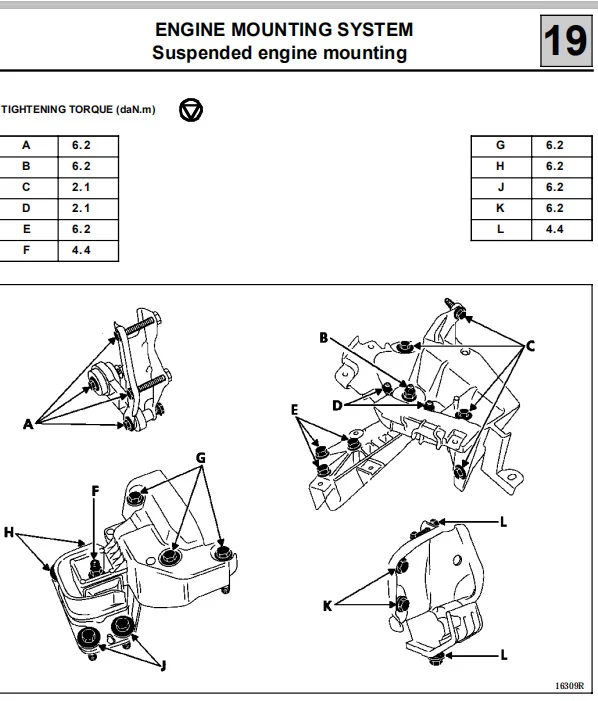

  • engine mount bolts torque 6.2 daN.nm = 62Nm (Left Sided Mount) 1 daN is equal to 10 newton.webp
Central nut: 62N·m
Thanks @Colin-S

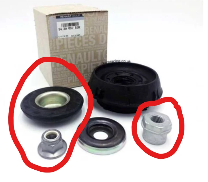

Apologies for the resurrection, but wanted to get some definitive answers for:
Front strut 'compression' nut/spacer & front strut top nut in engine bay. Have found conflicting info for both online - some have the compression nut listed at 20nm and top mount at 65nm, and vice versa (KYB have one set of values and autodoc have another, for instance).. while others have no torque for the top mount and just nip tight etc. All depending on where you look.
those question marks are the ones that bite you. front hub nut at 230nm is a one-time nut, dont reuse it. and skip forum tables, pull the real spec from the FSM
