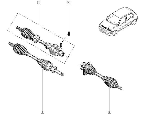

If its a JC5 130 you have a choice of 2 driveshafts
182 TROPHY N/S 8200372167
182 N/S 8200352043

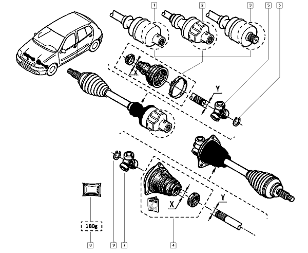

there are 3 multiteeth splines available for the 182
22 teeth 7701638463
29 teeth 7700113959
30 teeth 7701056850
There are over 20 different n/s shafts for the 172 / 182 in total

I Like the pic lol but i aint a clue what the parts are haha. im female give me a break lol
